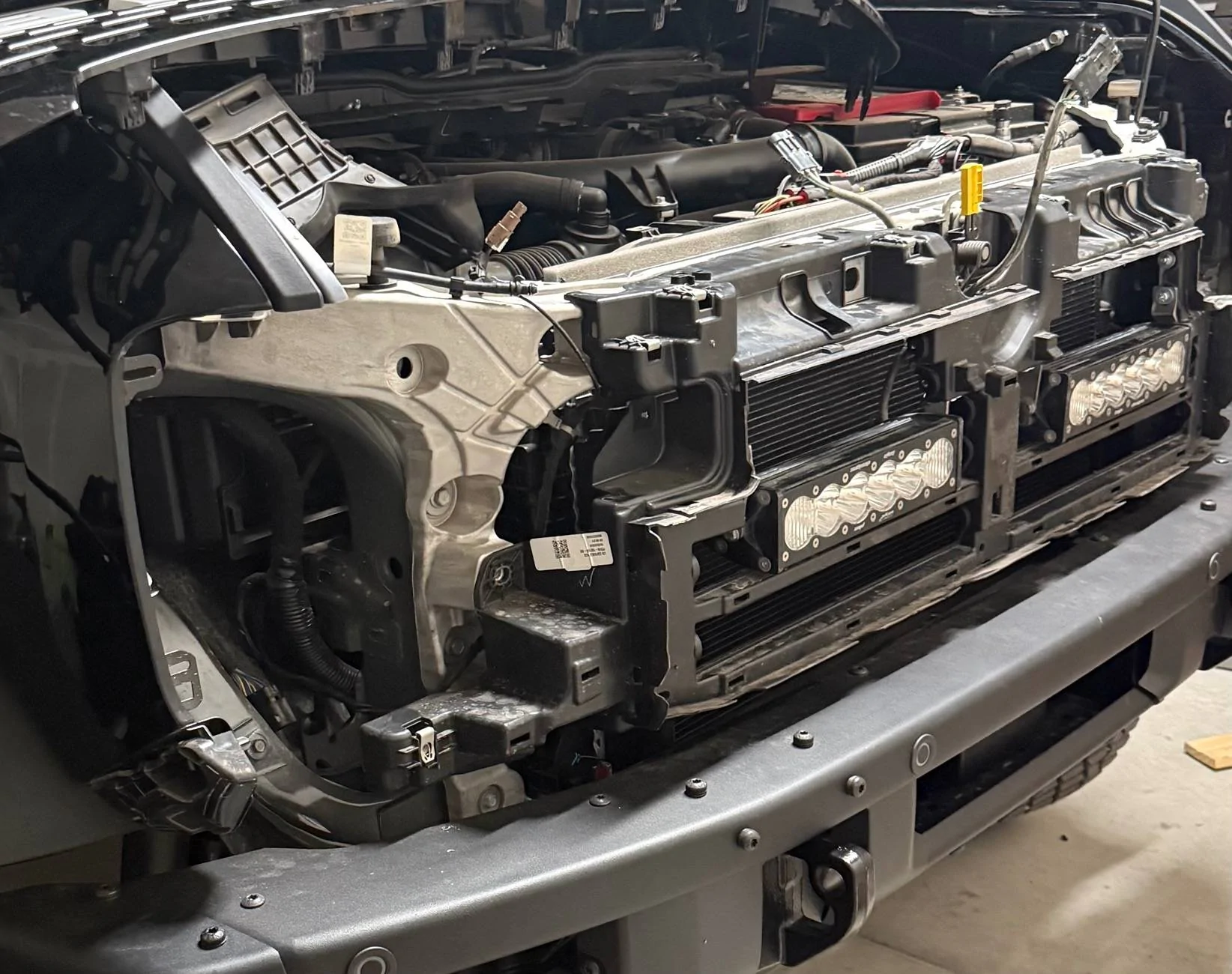

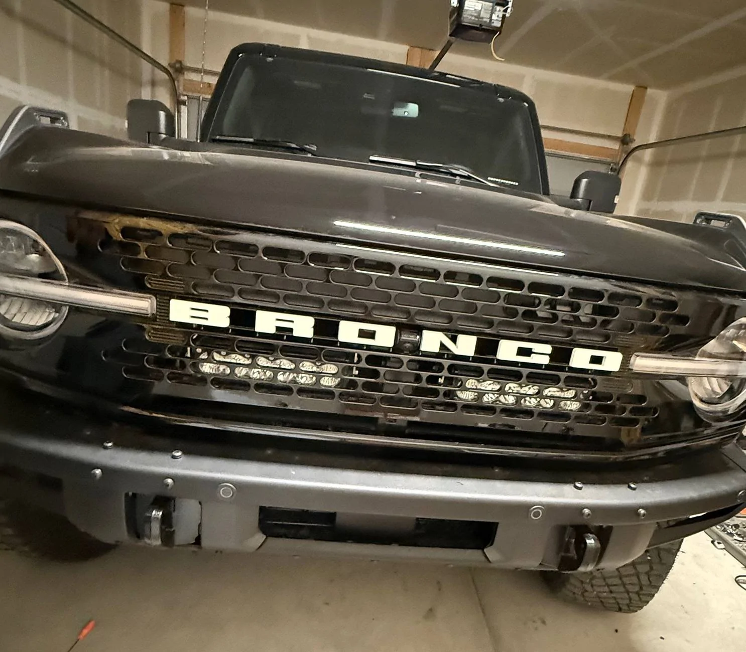

@Baja Designs Onyx6 10” bars mounted behind the grill:
If anyone was curious if this is possible, it is! Needed to fab up some janky mounts that I used on one of the old Raptor pickups, but they ended up fitting quite nicely. Now just waiting on the new headlight switch setup for the fog lights and we’ll run them with the brights, using the fog lights turning “off” to trigger the relay and kick these on.

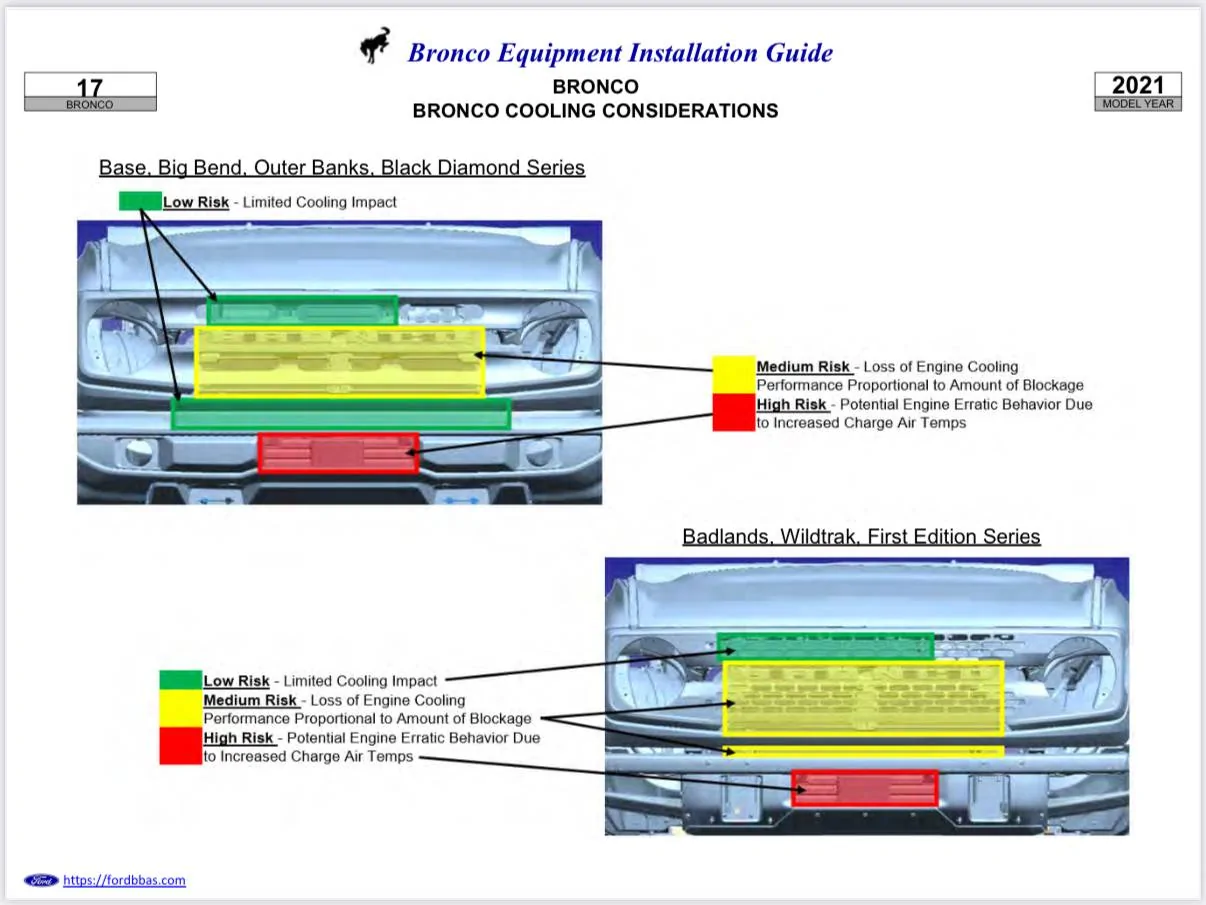

Please keep an eye on your temp gauge & performance - you installed them in the “Medium Risk” zone. See attached pic from the Bronco Equipment Installation Guide.
One of course would assume there is some blockage but I didn’t know this diagram existed. That’s pretty cool! Thank you for sharing.
I wonder how much of a difference there is between the lights where they’re behind the grill and likely blocking more “effectively” compared to a winch where it’s technically blocking more of the grill, but air can more easily get around it.

I installed the Ford Performance winch on my Raptor and there is no difference in temperature parameters pre/post install.
Attached is the full Ford Equipment Installation Guide for further reference - there’s lots of good stuff in here…

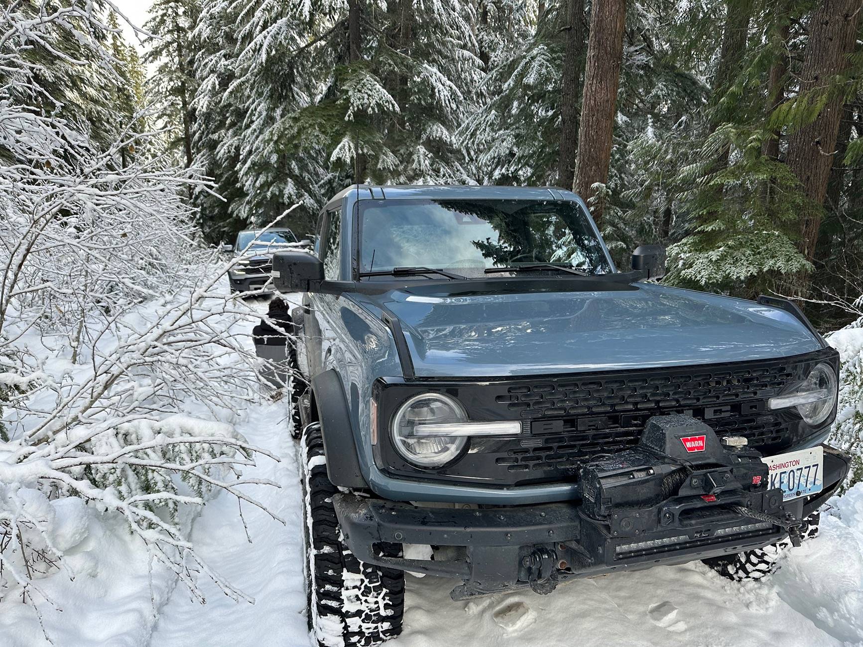

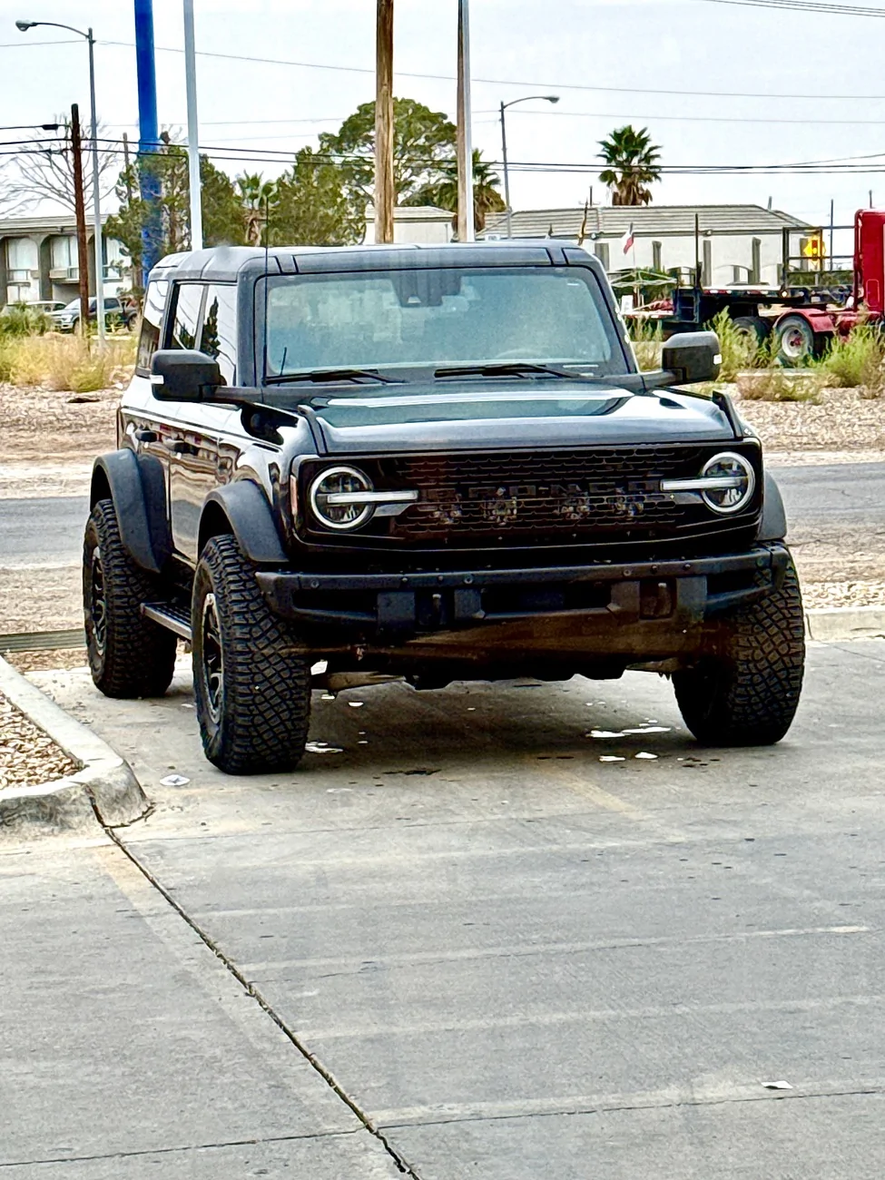

Hidden is definitely the way to go with these lights. On the white bronco I don’t mind them on the bumper as they’re circles so they match the headlights and between them and the winch they block the body lift gap. But! There won’t be a front winch on this one. So keeping it clean.

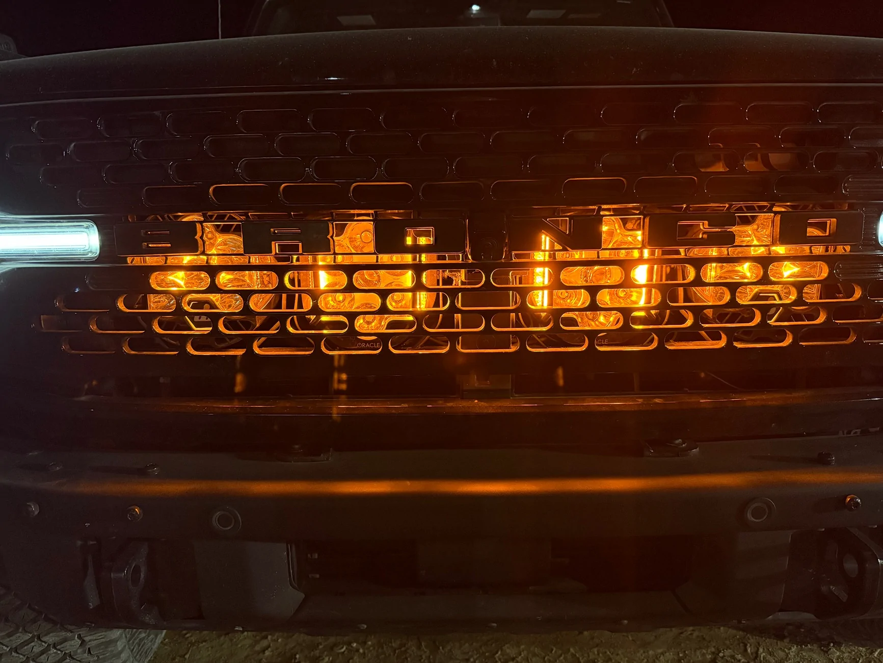

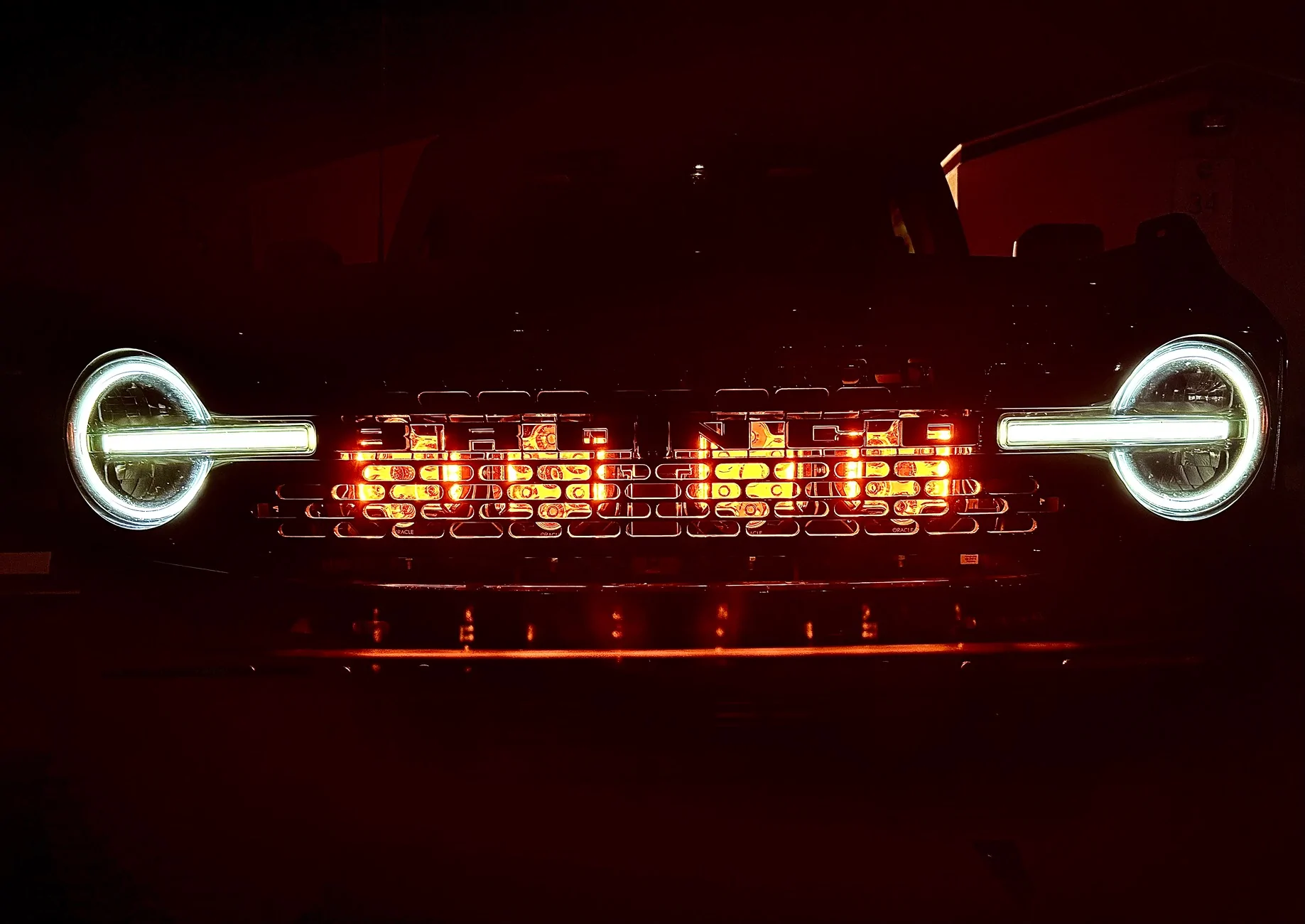

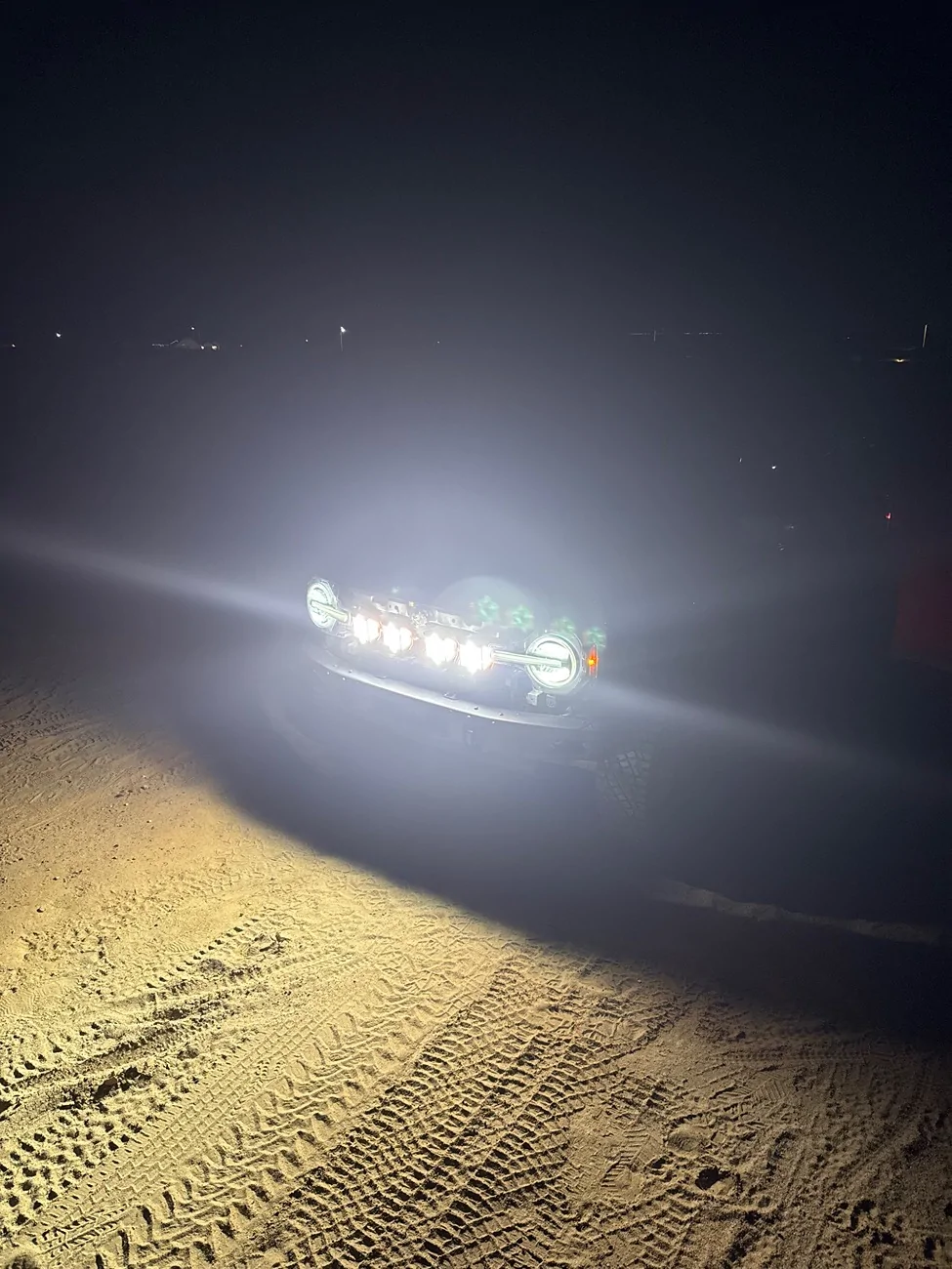

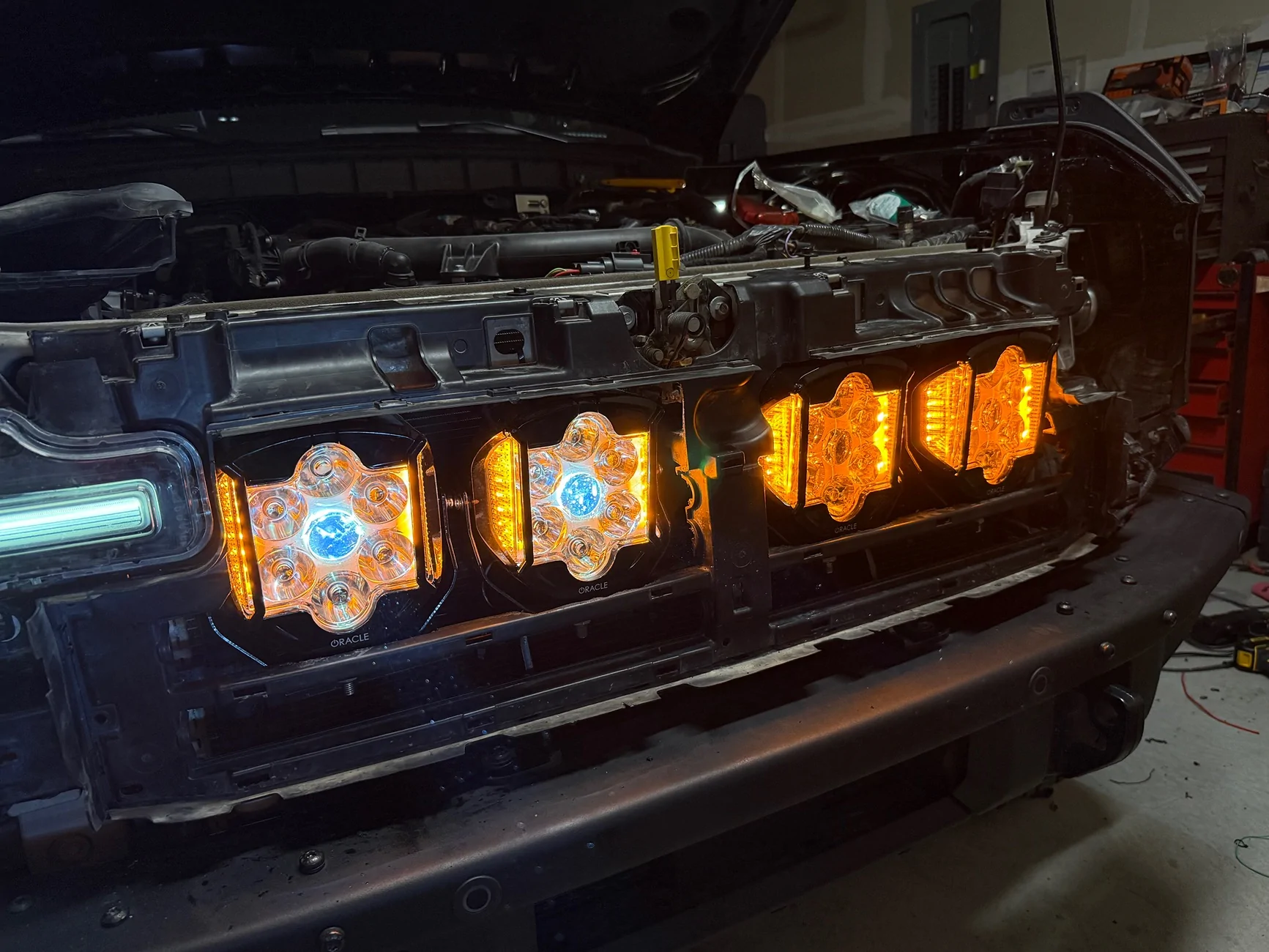

Thanks! I did swap things up a bit and now have four Vega7’s in there.
No shadows
Used a normally closed relay tripped off the fog lights (that don’t exist but the wiring is there. Just had to enable with forscan) so when the fog lights turn off with the brights, the big lights turn on.
