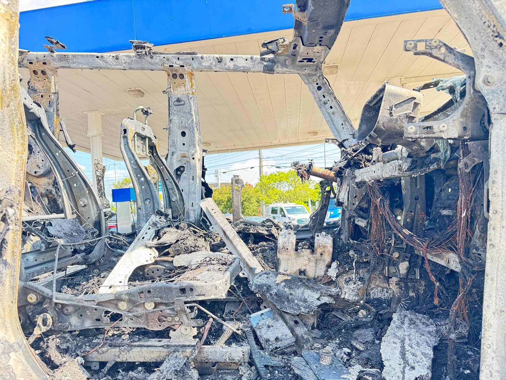

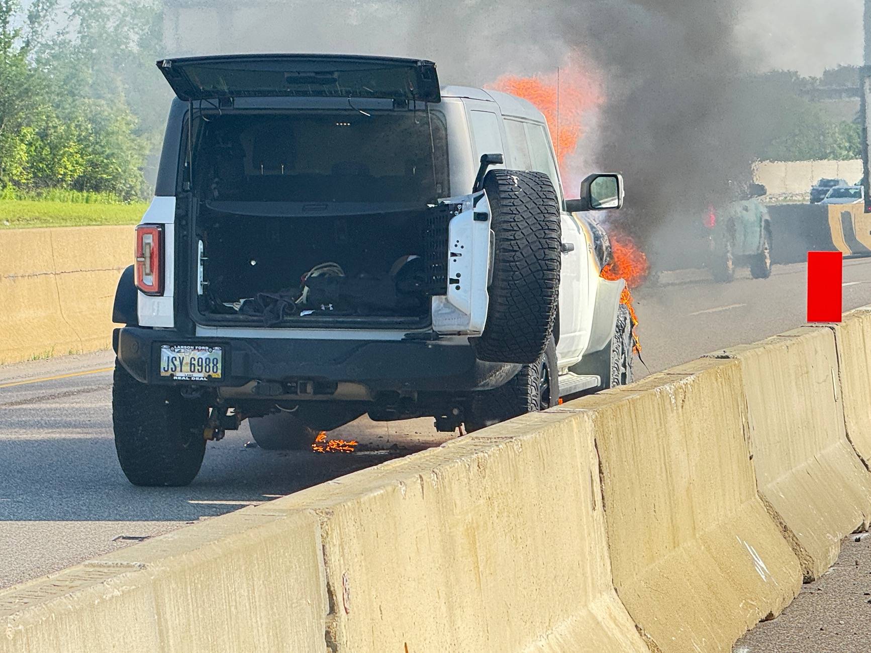

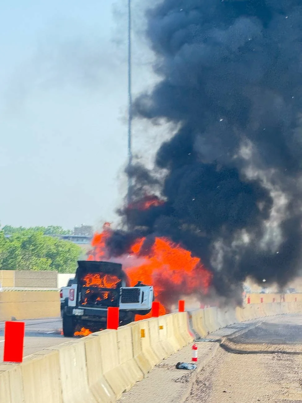

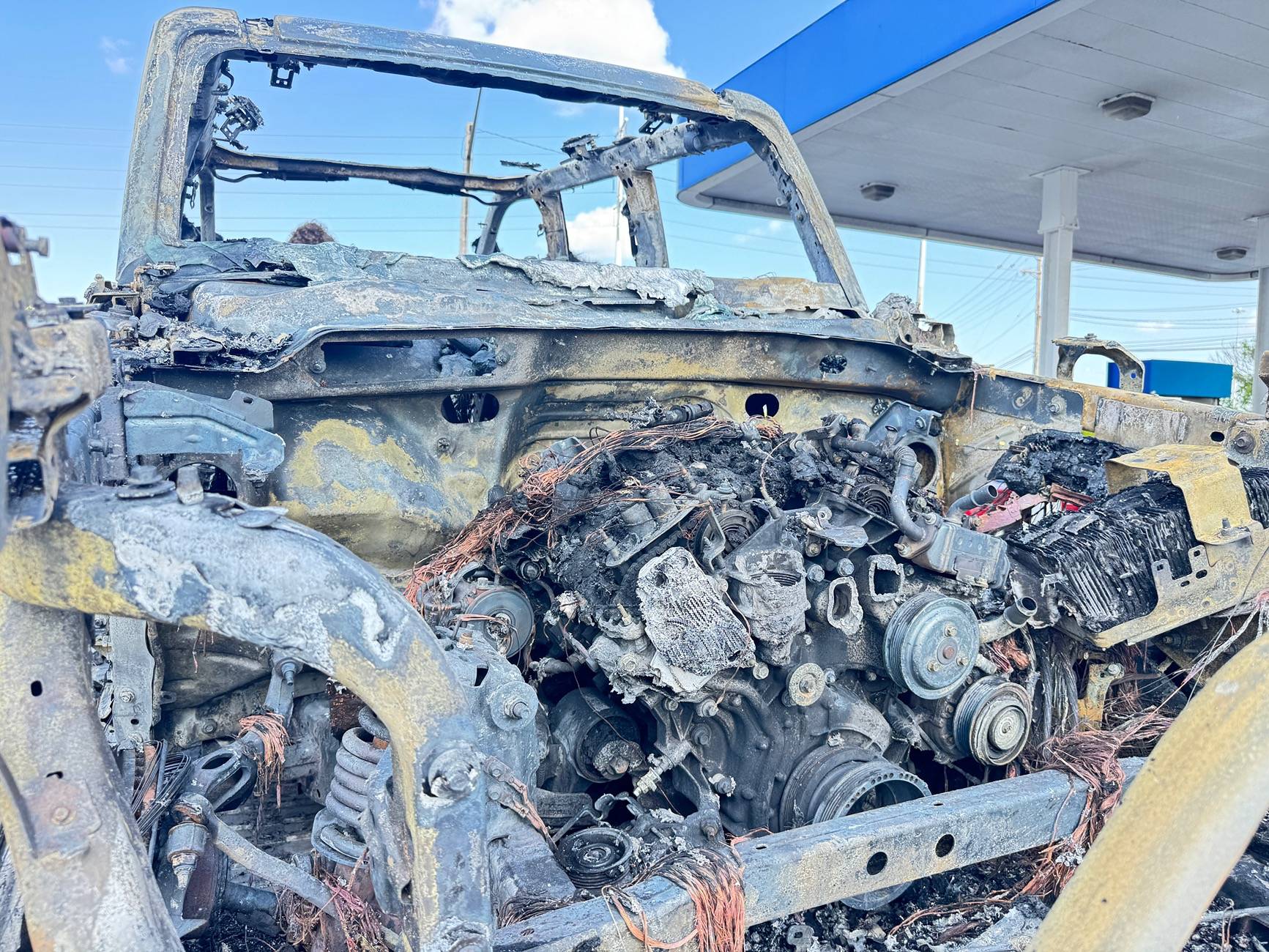

I was driving on the interstate in a construction zone where I-271 went down to a single lane in my 2022 4dr Bronco Wildtrak they had somewhere over 70k miles. I am the original owner. I was going approx 40mph and felt/heard a strange thud coming from the passenger side front of the car, but the Bronco didn’t go up or to side like running something over or a pothole. I continued to drive for maybe 20-40 seconds and the car behind me started flashing his lights. He couldn’t pass, so I was puzzled, but thought I saw some smoke. Pulling off to the closed lane, smoke and flames started to rise from the passenger side of the engine conpartment. I grabbed some things and got away from the vehicle. The construction workers unloaded three or four small fire extinguishers to no avail. I have no idea what happened, I would suspect there was a fuel injector problem. Who knows, I suspect one day there will be a recall. Keep a fire extinguisher in your Bronco. For me, that was my first and last Ford.

High pressure fuel pump is on the back of the right head but it's unlikely it was exposed enough to take a direct hit from road debris. Other possibility is something hit the right turbo oil drain tube, cracked and oil blew back onto exhaust kicked off the fire which eventually got to the fuel lines feeding the HP pump. Not going to stop without a ton of water/foam especially when it got to the fuel tank. Don't know how much is left in the engine but I would look to see what is left of the right turbo drain tube. If it looks like there was a break or damage not related to heat, that might be your cause.
