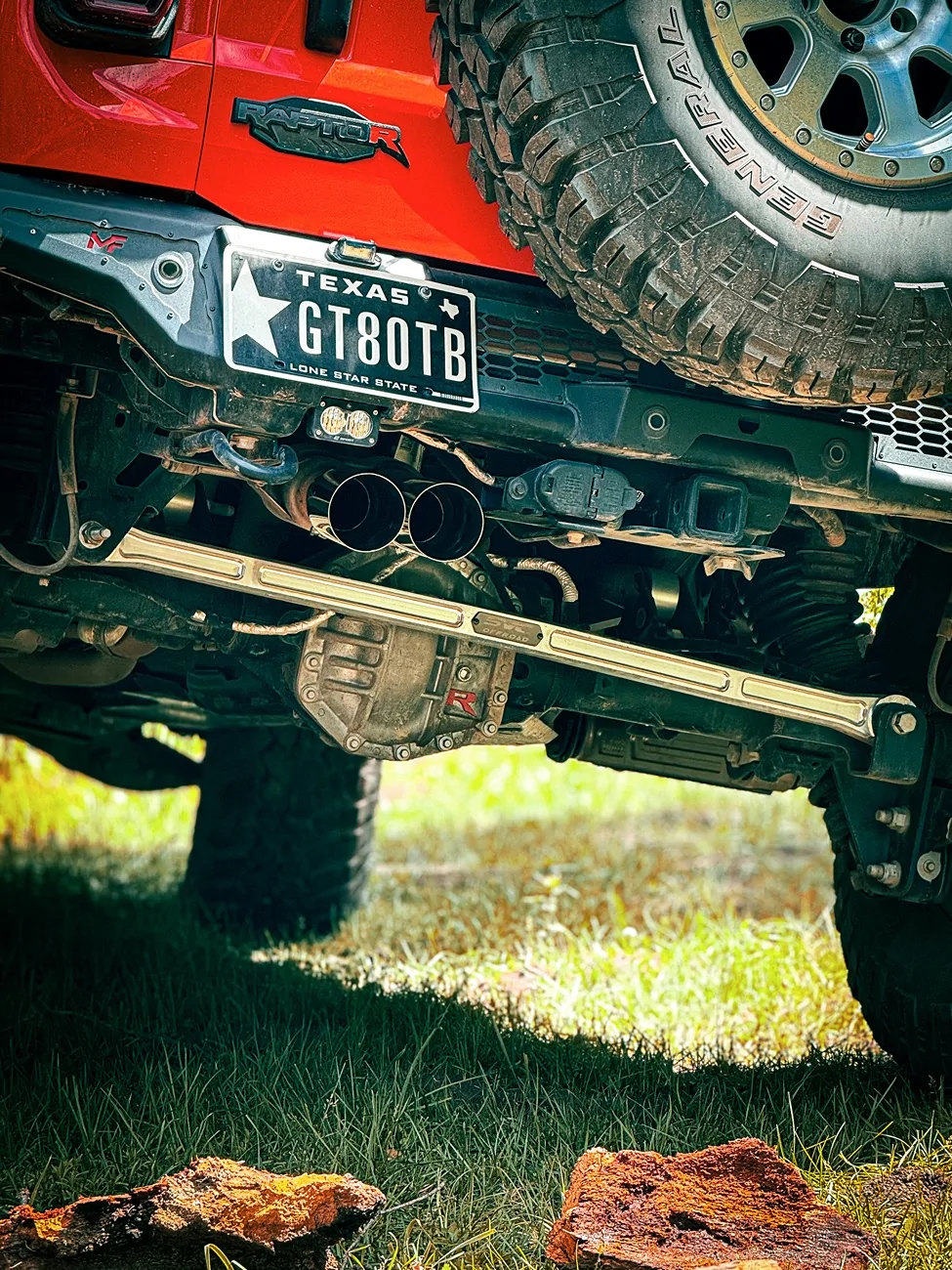

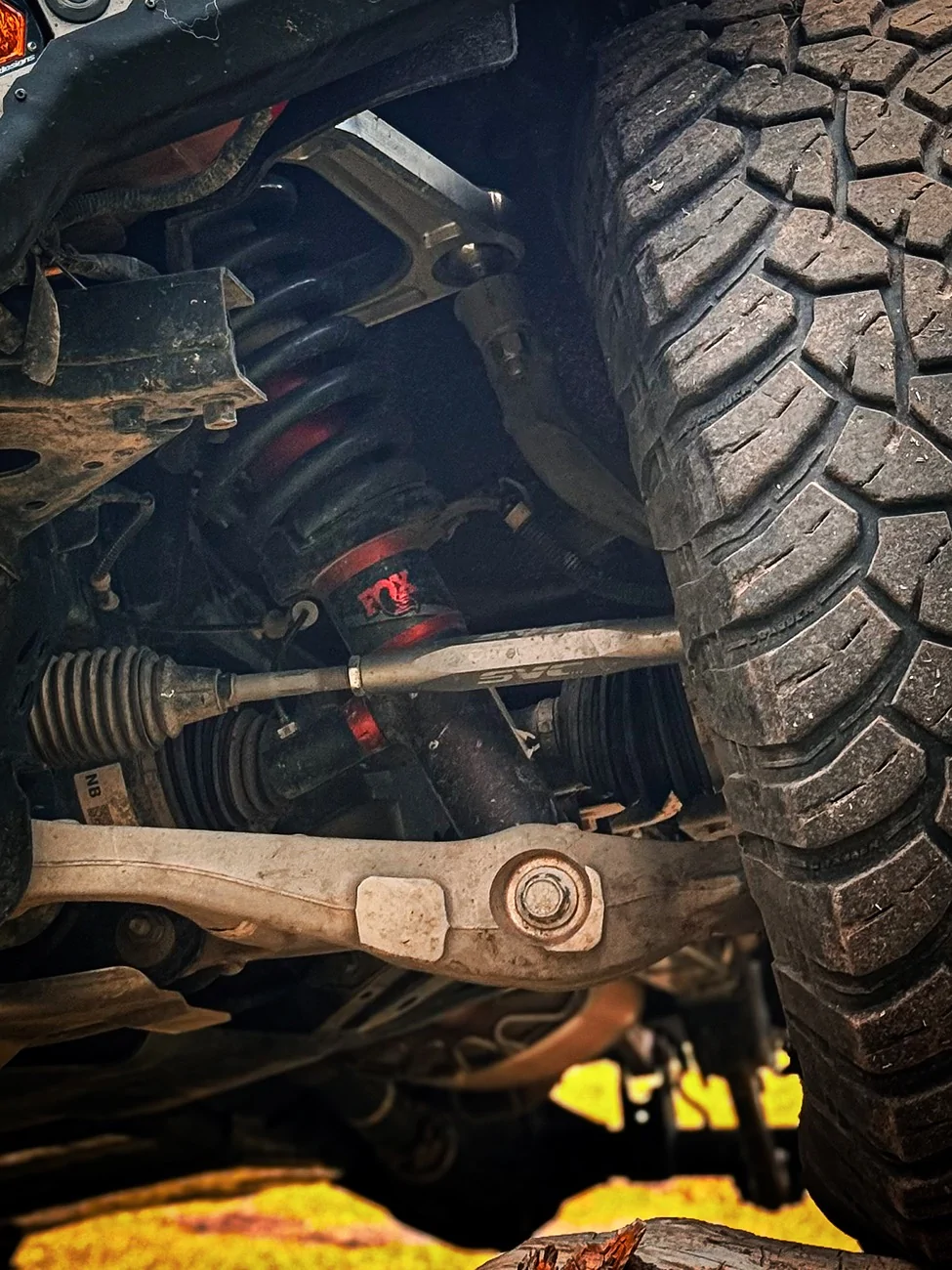

I’ve been waiting a long time and hoping SVC @SVCOFFROAD would start releasing more for the bronco raptor. Like many companies it seemed like they had some hesitation committing to the platform. But now SVC has released Tie Rods, Rear Links, Upper Control Arms, Panhard Bar, and soon diff cover (for the regular Bronco as well). I was super happy they did a raw aluminum and they all look great! The most noticeable upgrade was the tie rods which removed any slip from the steering. The UCAs/ links seems to add a little more movement front and rear. I’m hoping the diff cover comes soon because I need it.

What do you mean by “tightening” the steering?

By tightening I mean previously I could feel a little play in the wheel before it would “catch” and start actually turning the wheels. With the half ties when I start turning the wheel it feels like it is “catching” and turning immediately.
