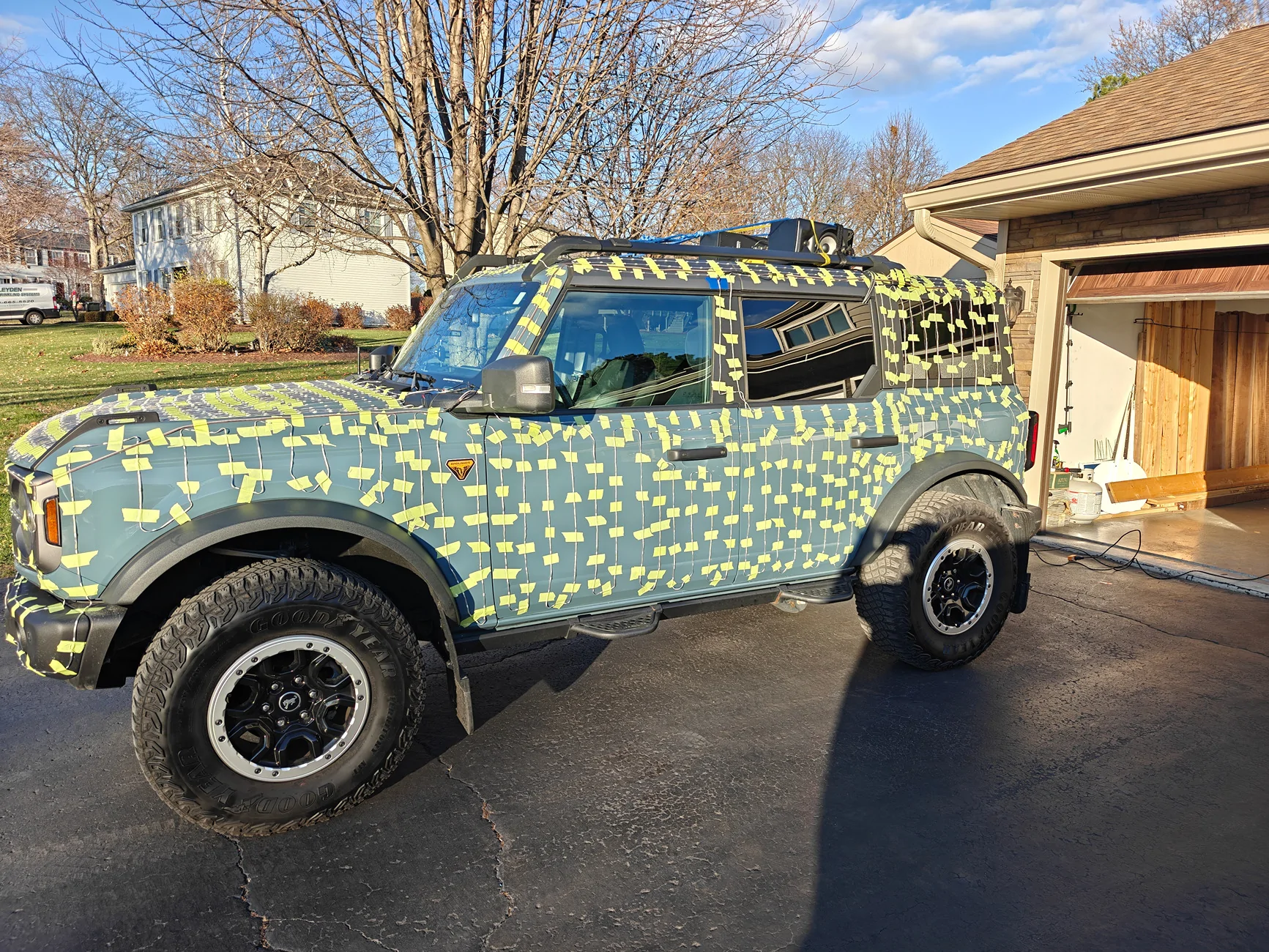

How did you hang up the lights?
2 giant rolls of waterproof painters tape. I had one guy asking about it that thought I was driving a camulflaged prototype because it just looks ridiculous during the day. 😂 I wish the waterproof stuff at least came in blue, but you work with whatever you can find.
How would someone without OCD program this?

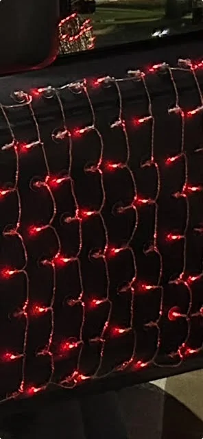

I saw someone do a ton of lights, but used little suction cups, and they are holding strong!
Edit: Zoomed in on a pic I took, you can kinda see them.
You mostly program it like you are mentally ill. Basically a giant excel spreadsheet with the bronco set as the background and individually number each pixel one at a time in whatever box somewhat lands under a led in the background image. Then chain things together in xLights.

Fantastic work! What light kit did you use?
It isn't a light kit at all. it is 4x 1000 count 12v ws2811 pixel LED fairy light strings purchased off of aliexpress and then paired to a falcon controller and controlled by xLights. Took about 2 weeks of work to get it on the car and make it all go.
