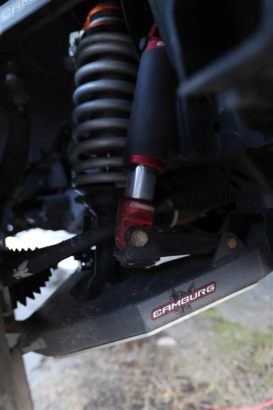

Looks like a Camburg lower control arm is need, but what is needed for the upper bracket? Is that also bolt-on or is it welded to the frame?
In their first photo they show two different styles.
The one with the rod ends on top/bottom is their flapper style bumpstop. It is mostly designed for their suspension kit as they use this on a few different model trucks.
The second one is a more traditional bumpstop and has a strike pad on the bottom. It is usually mounted using a special can that I’m sure Camburg also makes/sells. Or perhaps it is designed to work with an existing fox or king style bumpstop can. These types of cans need to be welded to the frame. In some cases companies will make a bolt on mount to install the can.

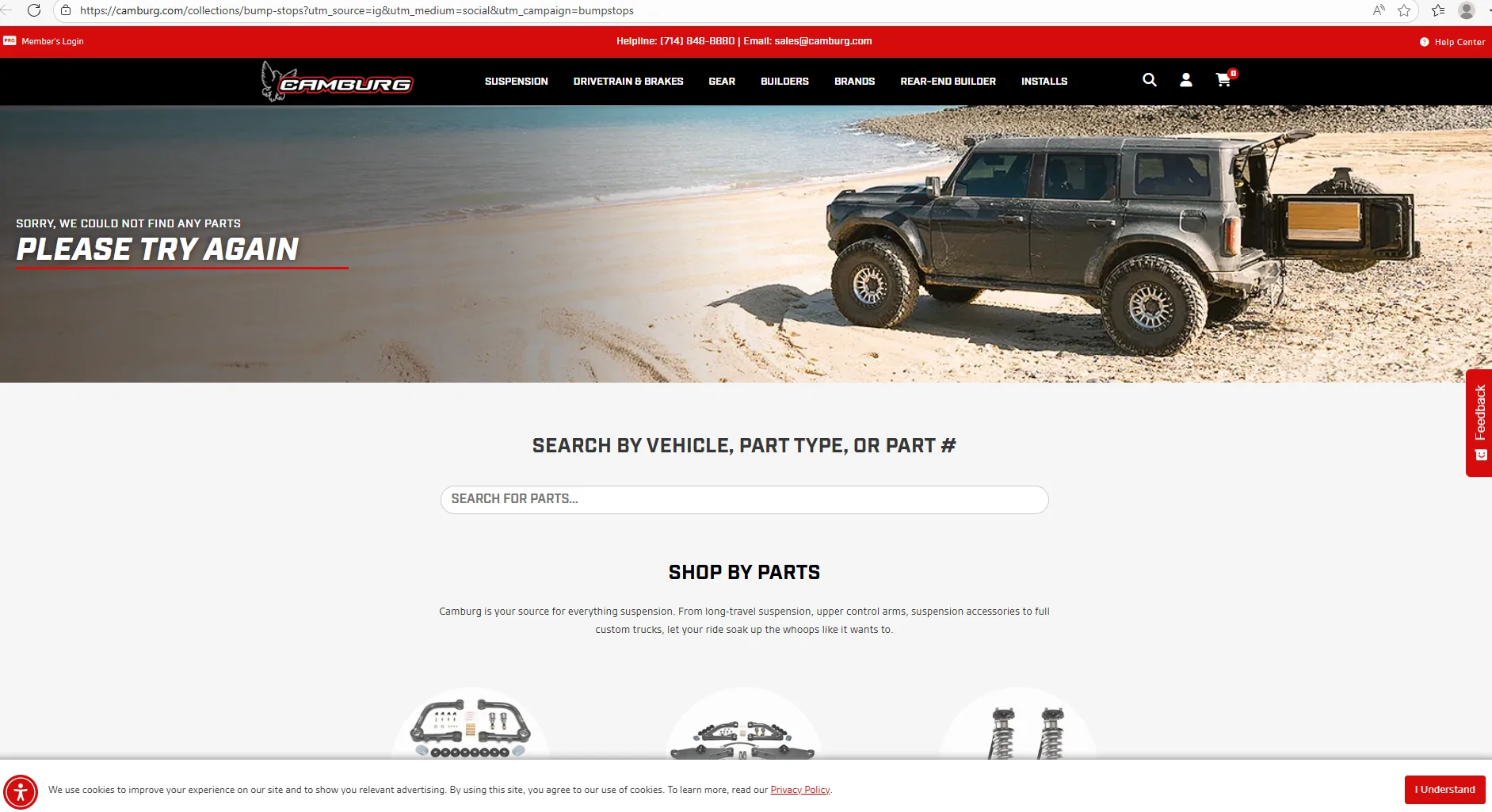

Well I couldn’t find them on the website. I must be bad at internetting.

UPPP found it, use their search, search bump stop, click on the 108 results, go past page 2 where they have fox bump stops with their pad. page 3 and beyond.

I had searched “bump bronco” (without quotes) and found no results. Still don’t see Bronco specific kits but I’ll keep clicking around.
Top bracket is welded to the frame, the slapper bolts to the lower arm.
