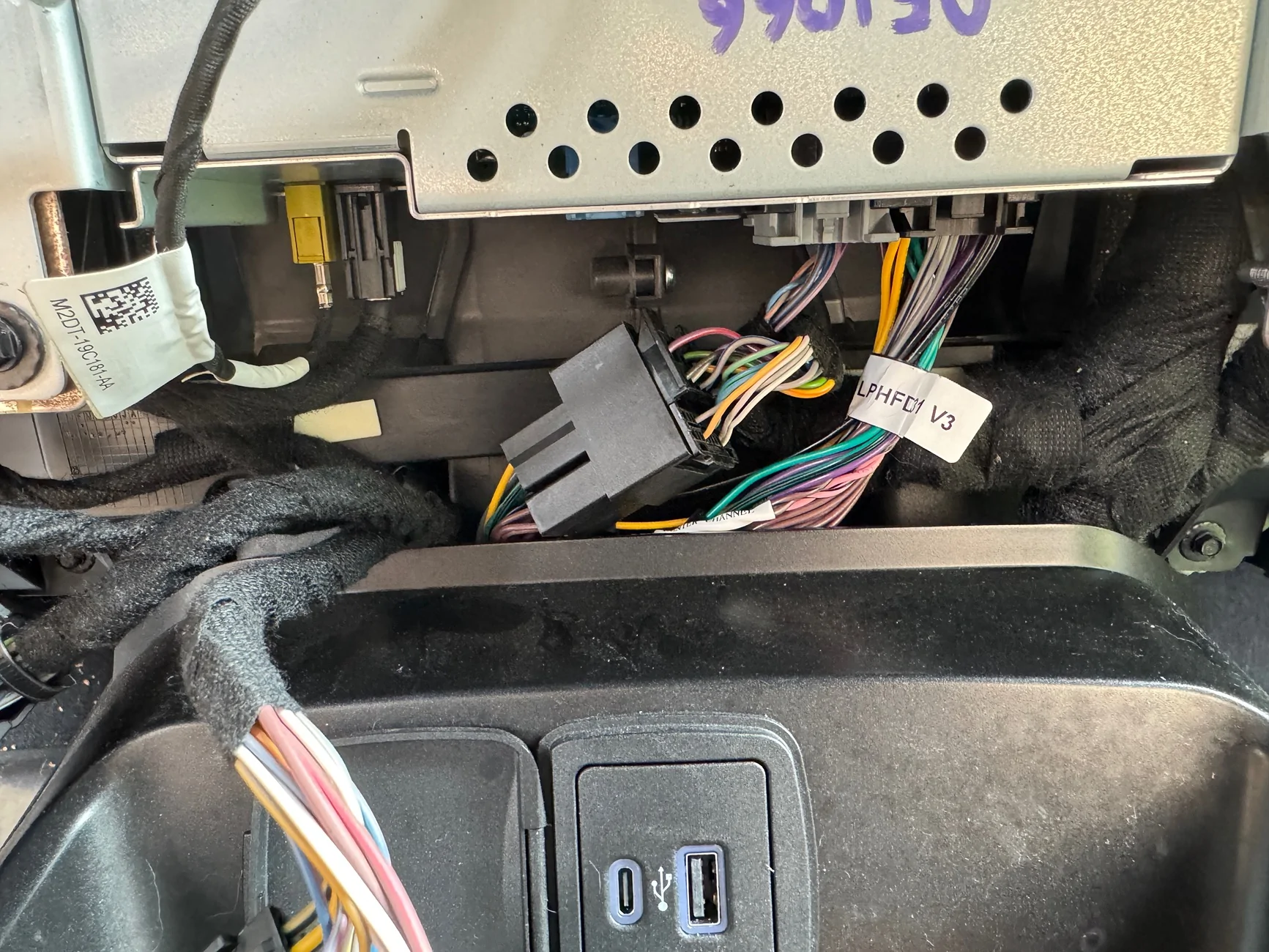

The first thing I did was to swap in the forward dash piece from a B&O Bronco to allow factory fit of a center channel speaker. I’m using the JL Audio 4” along with a pair for the rear pods. A set of MB Quart BS1-316 3-ways are up front as well. The subwoofer will be a 10” tailgate box.

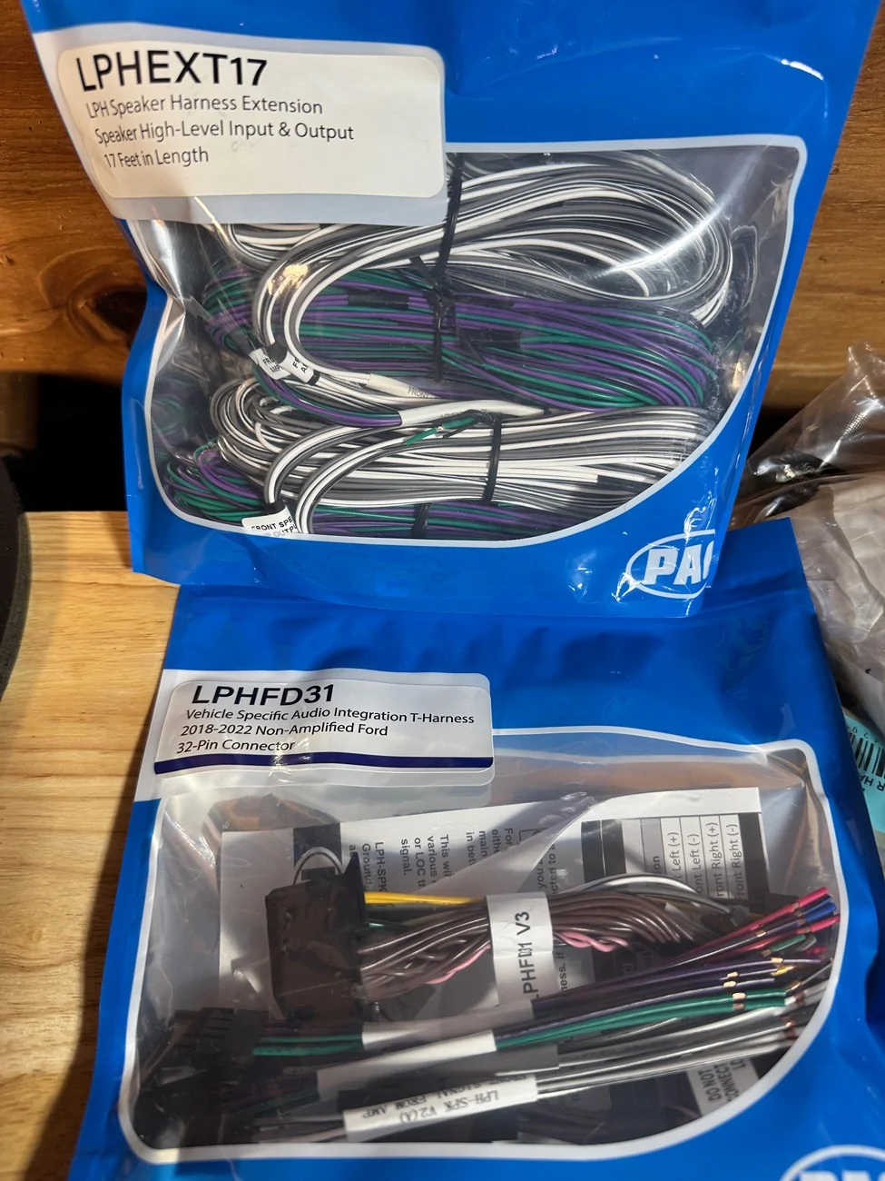

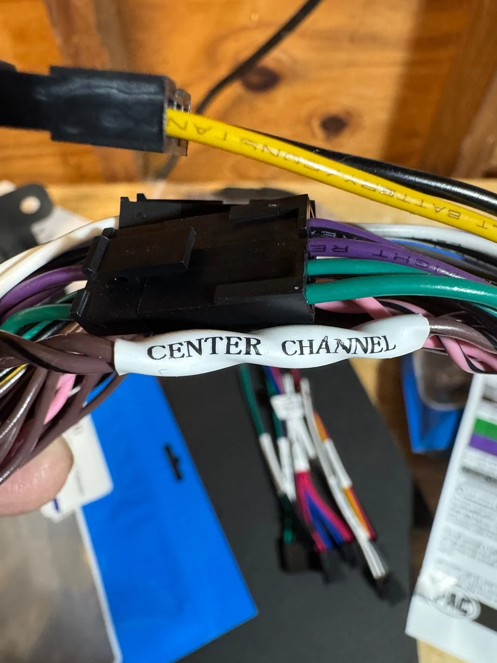

The T-harness is a PAC LPHFD31. I note that they have a twisted wire pair nested in the harness marked “center channel” with no reference to it in the instructions. That harness will feed an AudioControl D 6.1200 DSP amp that has worked well for me in several cars. Because this is a hobby for me, I like to make a series of upgrades in order so I can try to hear the improvement as I go. The MB Quart (and rear 4” JL Audio coax) speakers are already a worthy upgrade for the base system’s sound. Now I need to hash out several questions as I go.
1) I’ve not yet found a true pin out diagram for both ACM’s (base and B&O) but the speaker diagrams I have seen seem to show pins 2,3 and 7,8 on connector C240A for the kick panel - front - speakers and 5,6 and 9,10 for the rears (base) and pins 2,3 and 7,8 for the rear speakers (B&O).
B&O center speaker output pins are 5,6 on C240A - so a direct swap will be a problem - which (along with rear speakers) is driven by the ACM and not by the B&O’s DSP amp out back. If this is so, a simple swap-out of ACMs won’t work. First if I want to retain my rear speakers and second the C240A harness pin out is different for the two models.. It seems that at best with a pin swap in the harness itself I would have a front 3-channel setup as the B&O ACM would be sending its “rear” speaker signal to the “front” speakers and I could add wires up from (freed up after pulling out the left rear base’s 5,6 pins) pins 5,6 to the new center channel speaker in my base Bronco. Anything more and an external amp might be required.

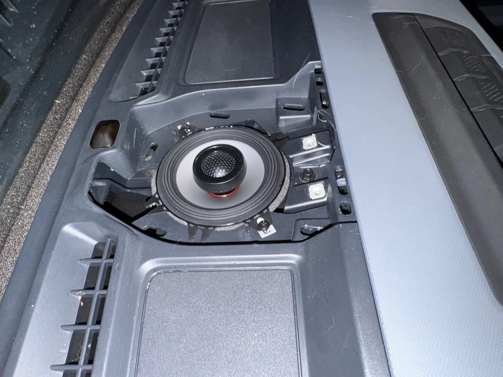

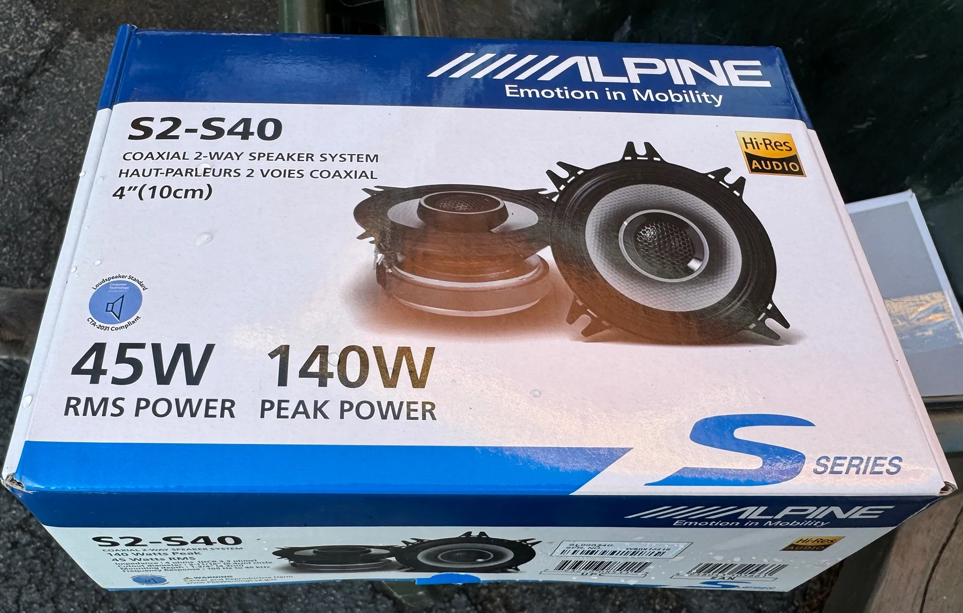

I always replace dash center drivers with a quality mid range driver like Scanspeak 10M in Bronco or Hertz MP70.3 in Mustang.
The DSP tune i everything but few aftermarket DSP amps have capability to handle center corectly as true independant active signal VS same as oitboard mids.
Im my Mustang with Audison 8 channel it did work well but had to cut 8-12 db for good balance with outboards and play with polarity because DSP was inadequate for center. Was a pita to get it right.
In Bronco the Scanspeak 10M is perfect and makes a huge difference as I discoverd trying different drivers incl Hertz DCX100.3, Hertz MP70.3, and finally keeping Scanspeak 11M. I for one cannot match the B&O engineers DSP tuning haha.

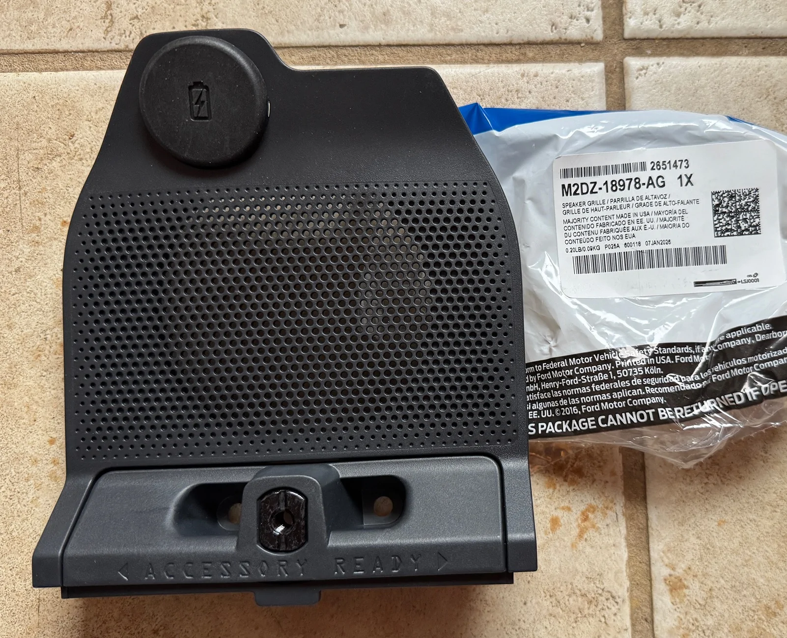

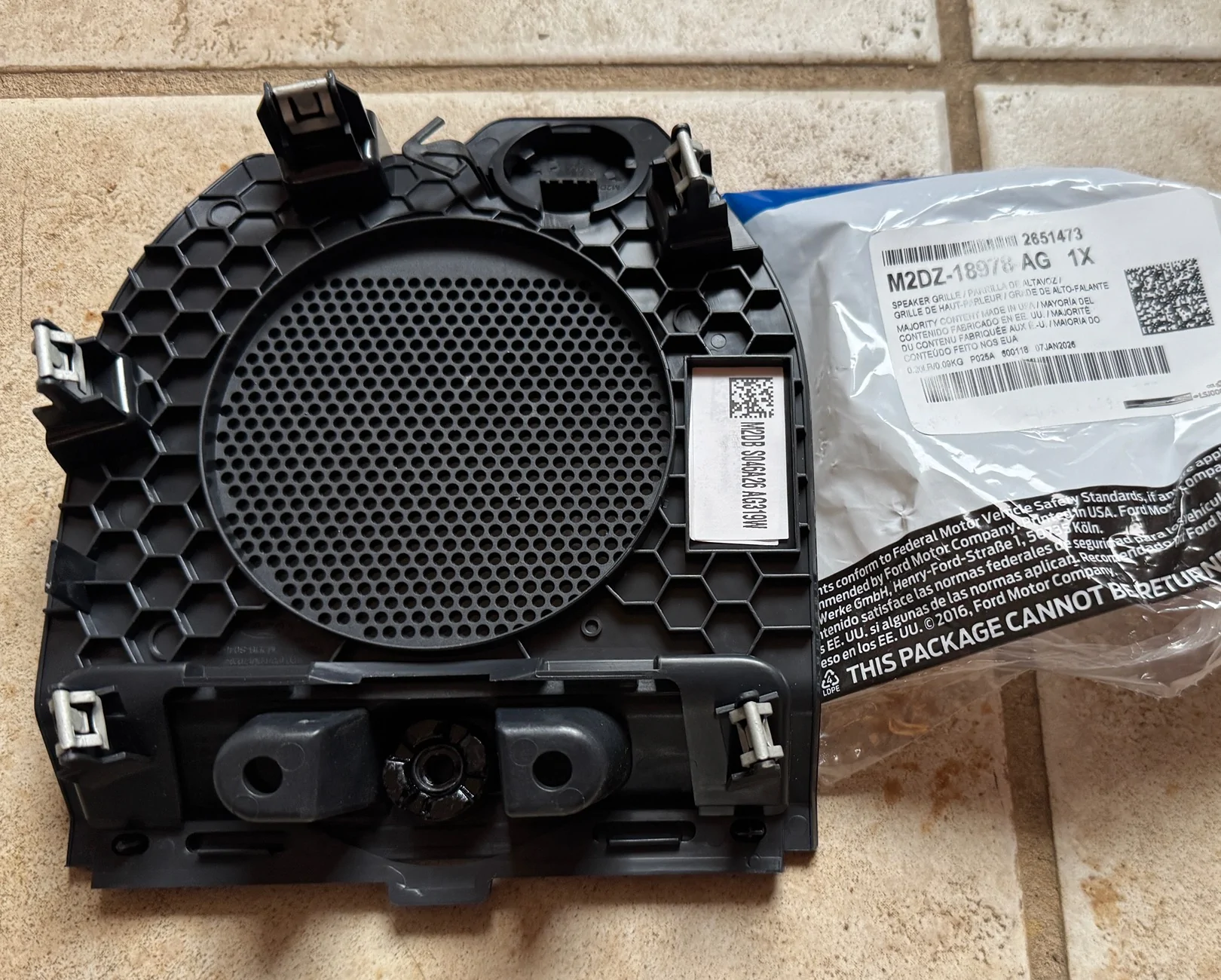

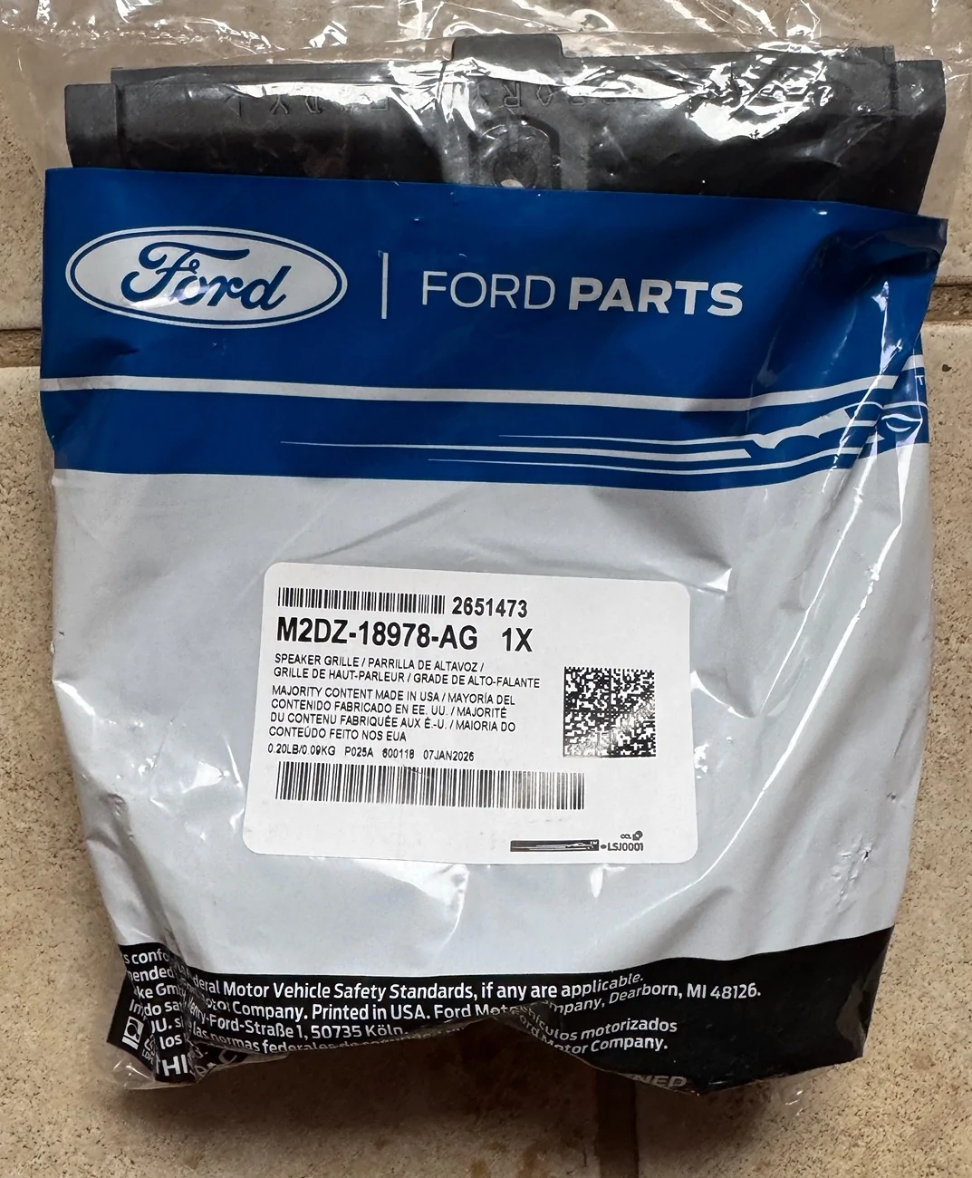

Here’s the center speaker grille in its package. Notice that it comes with the “accessory ready” piece. Yes, that piece is different on a B&O Bronco.

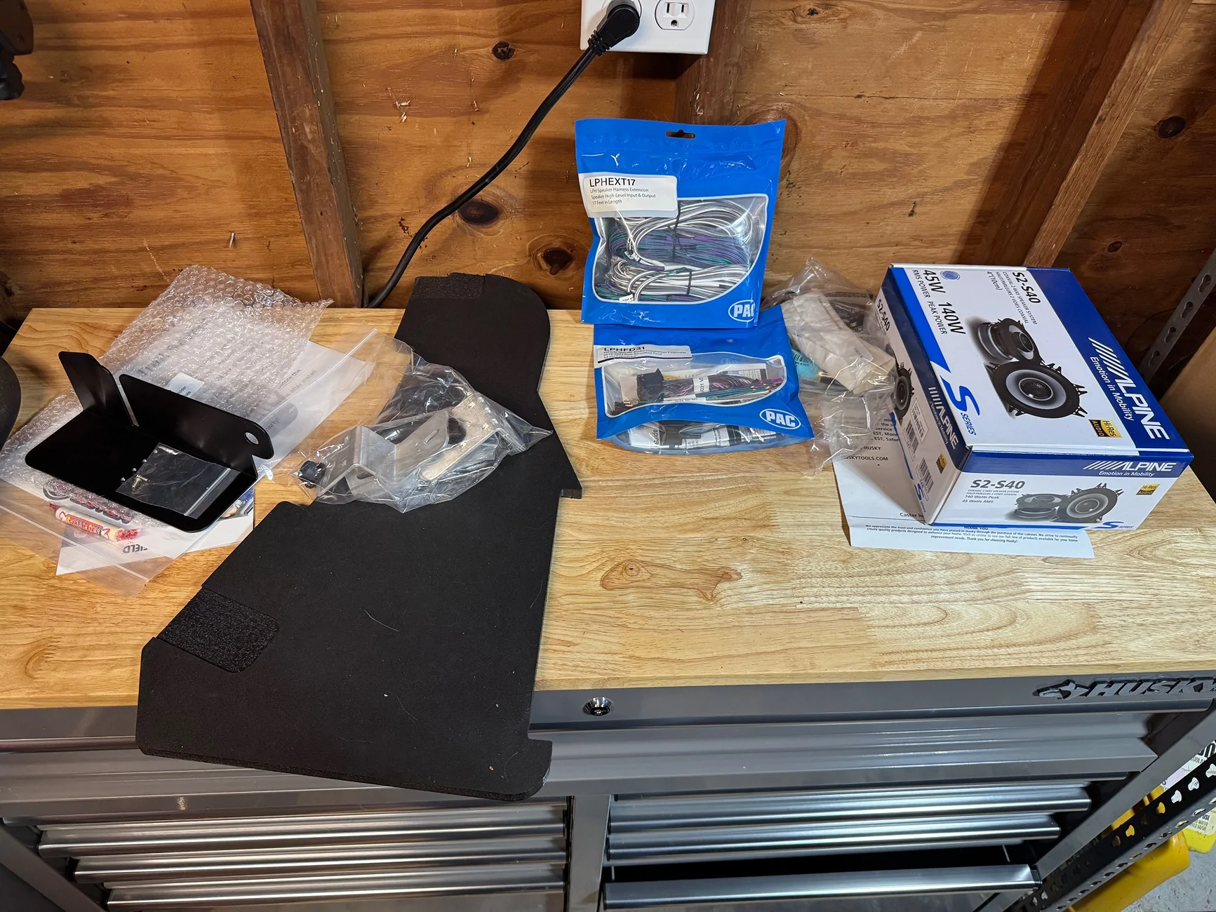

So I have been acquiring the rest of the needed system for my 22 BD. I've already done the dash upgrade and changed the rear pods to 6.5" 2 ways. I would like to do the center channel upgrade for sure, but do you have to add the B&O ACM to get the center channel to work? I'll be using an Audio Control DM810. How do you like your MB's in the rear? Thanks for any advice!

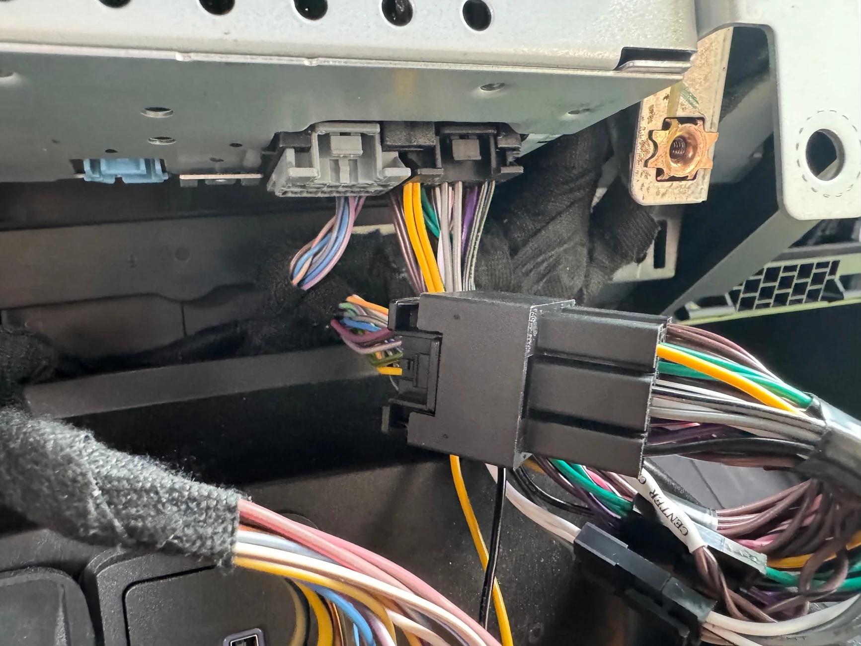

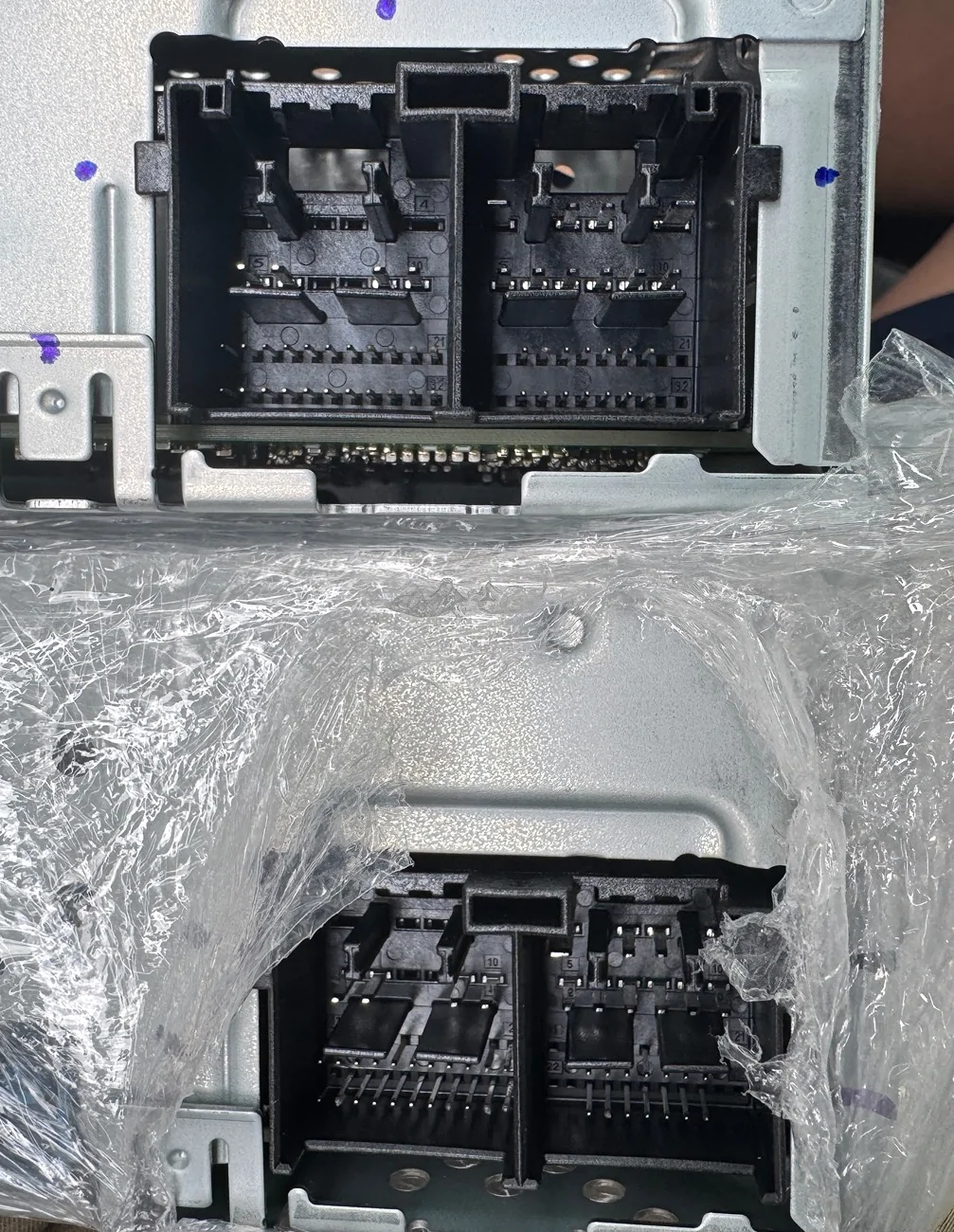

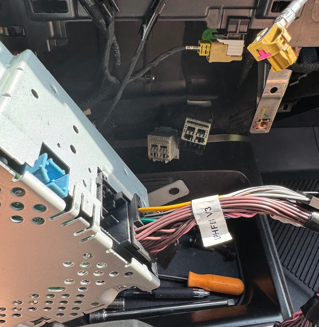

I finally found some time and a nice day! I compared both ACMs and saw that they share identical pins in their harness recesses. All the fun here is in the black connector. I’ll be interested to see if I can code in the proper front and rear speaker outputs. This would change the B&O setup where the ACM sources just the center channel and the rear left and right speakers. It’s possible that I’ll need to swap some pins in my adapter harness to get just the stereo rear speaker outputs signal back to my DSP amp. That would also require me being sure that I can render those to be full range by coding. More to follow!
Ford Bronco Audio Upgrade for 2021 Base 6-speaker: add a center channel and get HD Radio? Detailing the ACM from a B&O Bronco IMG_6732
Non B&O ACM on top, replacement B&O ACM on the bottom. The pin layout is identical.

Note the use of an adapter harness on the black connector. I’ll try first to get the stock speaker layout to function - no center channel just front and rear stereo. Later I will disconnect those small connectors to insert the extension cables and route those to the right rear where the DSP amp is going.

The blue jack is not used and it will be coded out - turned off - in FORSCAN.
Ford Bronco Audio Upgrade for 2021 Base 6-speaker: add a center channel and get HD Radio? Detailing the ACM from a B&O Bronco IMG_6739
B&O ACM is in place. I also ran a length of speaker cable down from the center channel speaker and coiled it in this general area for when I do the DSP amp and want it to feed a center channel.

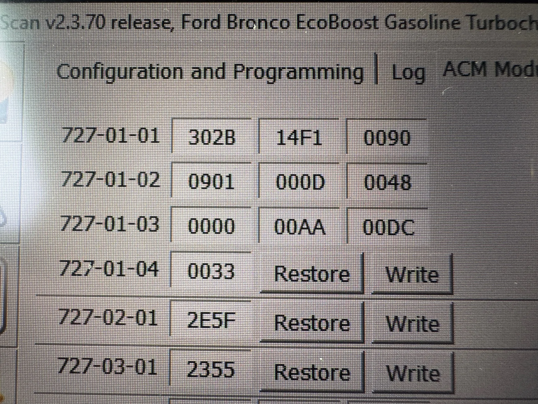

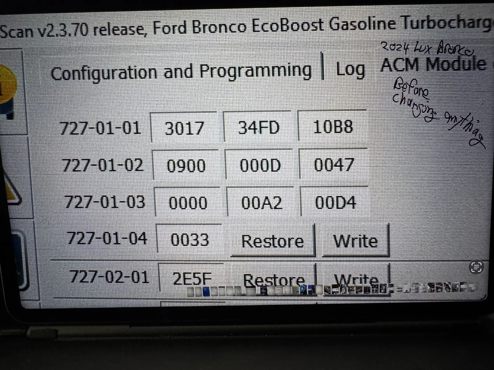

I did some Forscan work this evening. I learned a lot in this thread: https://www.bronco6g.com/forum/threads/how-to-forscan-audio-speaker-mods.71145/
When I first powered it up I had no sound and the volume control stayed at zero. However, now it appears that I got the Lux (B&O) ACM to operate like the non-B&O ACM by using coding choices for the non-B&O model - specifically by telling it to turn on the internal amp and send signals to speakers 1 -4. Becuase my Lux ACM is out of a 2024 Bronco I needed to turn off the ESE in Forscan just in case its trying to do that in my 2021.
Ford Bronco Audio Upgrade for 2021 Base 6-speaker: add a center channel and get HD Radio? Detailing the ACM from a B&O Bronco IMG_6776
How my ACM came to me - out of a 2024 Lux Bronco.
Ford Bronco Audio Upgrade for 2021 Base 6-speaker: add a center channel and get HD Radio? Detailing the ACM from a B&O Bronco IMG_6805
Note the changes made. This is now set up like the old ACM was. Changing the B&O ACM to XX2B - 14XX got the front and rear speakers to play. I may try out XXXX - 28XX to make the rear speakers full range. As 14XX the rears are tweeter only, a high pass signal. XXXX - XXX1 told the ACM not to “Enable A2B Output from the ACM“
