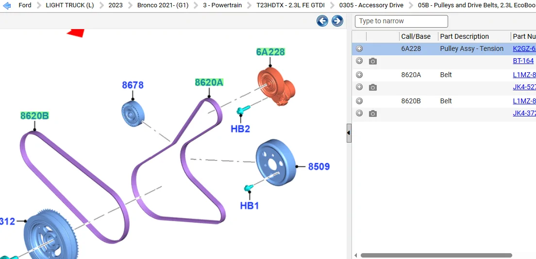

both belts ? ac belt is probably a stretchy belt --so one time use.
other belt --turn tensioner and follow underhood sticker
Ford Bronco 2.3l belt replacement HELP. 1760309777381-in

the second one, behind the first belt :)
