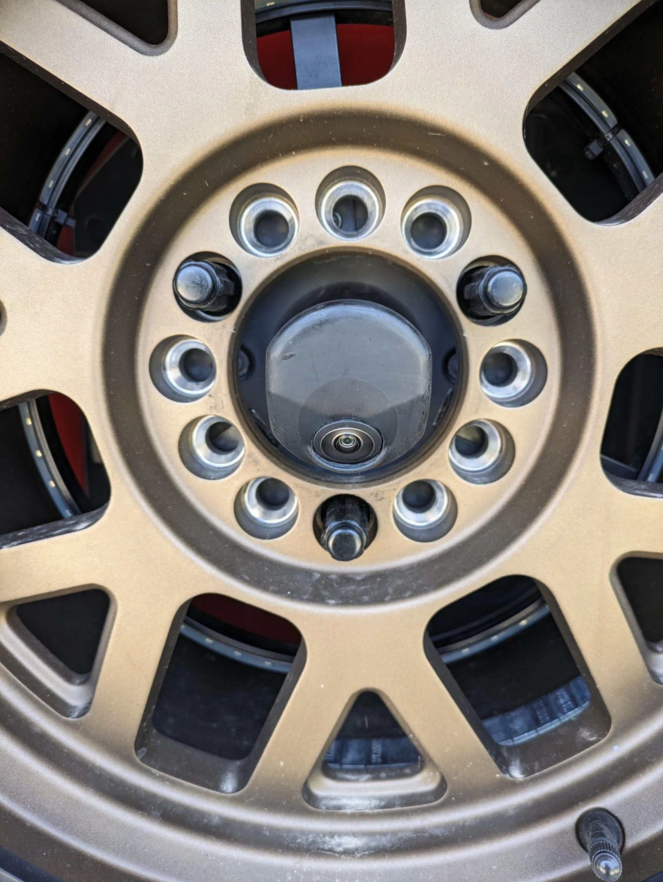

Weld Racing Wheels - Cinch 17x9 0 offset - these are drilled for both 139 and 135 patterns.
How exactly did they do this since the patterns are so close? Is each hole slightly larger or is there some other magic? I zoomed in on the spare, but couldn't really tell.
I'd love to do the same to my Black Rhino Primm's and run them on either our 2 Door or our Raptor.
Ford Bronco Hot Pepper Red Bronco Raptor teams up with Weld Racing Wheels and Mickey Thompson Tires PXL_20230726_170641681

Not what I expected, but makes more sense now. Thought they were already modified in the original pic and couldn't figure out how that was working. Thanks for the pic!
