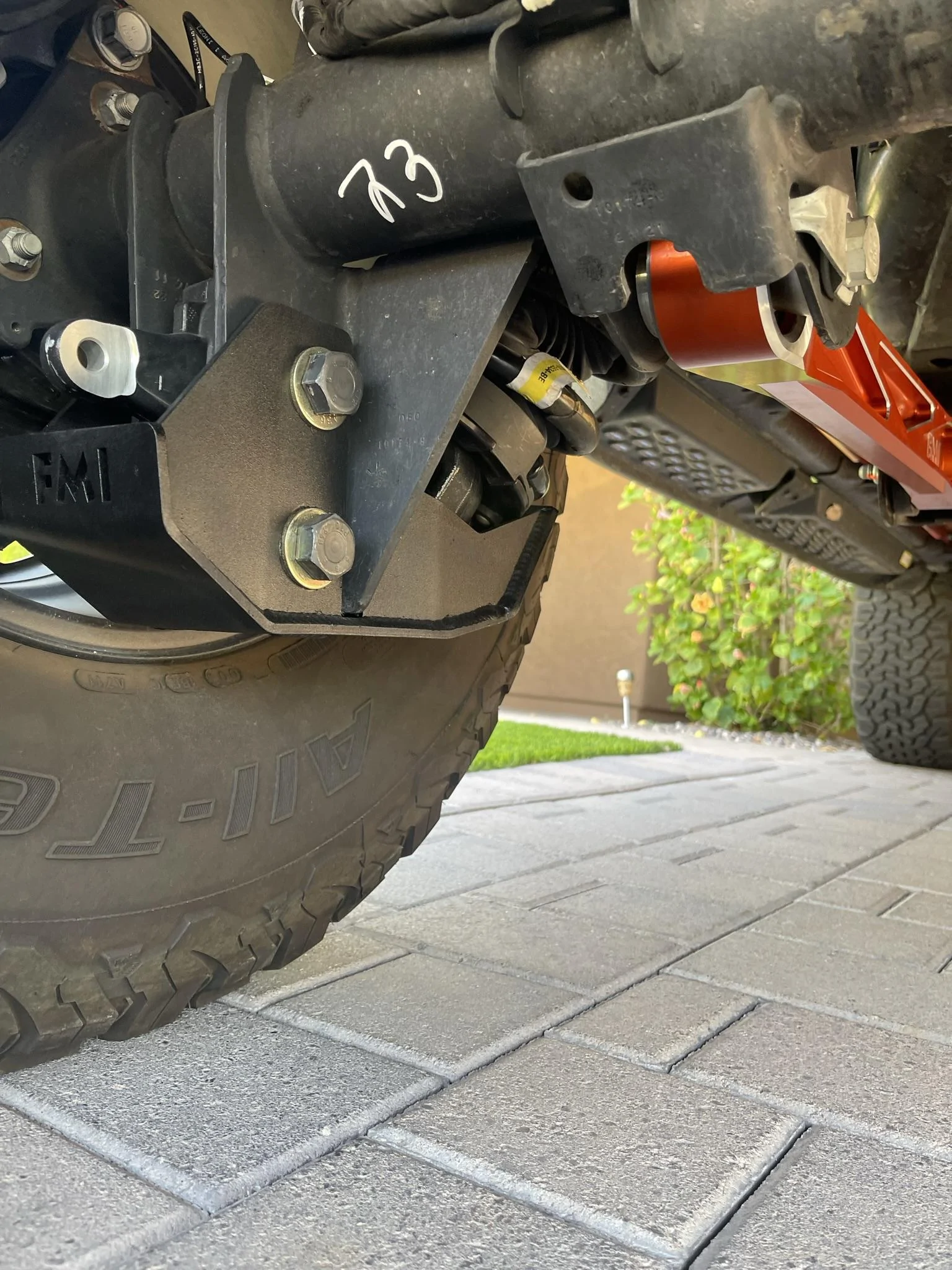

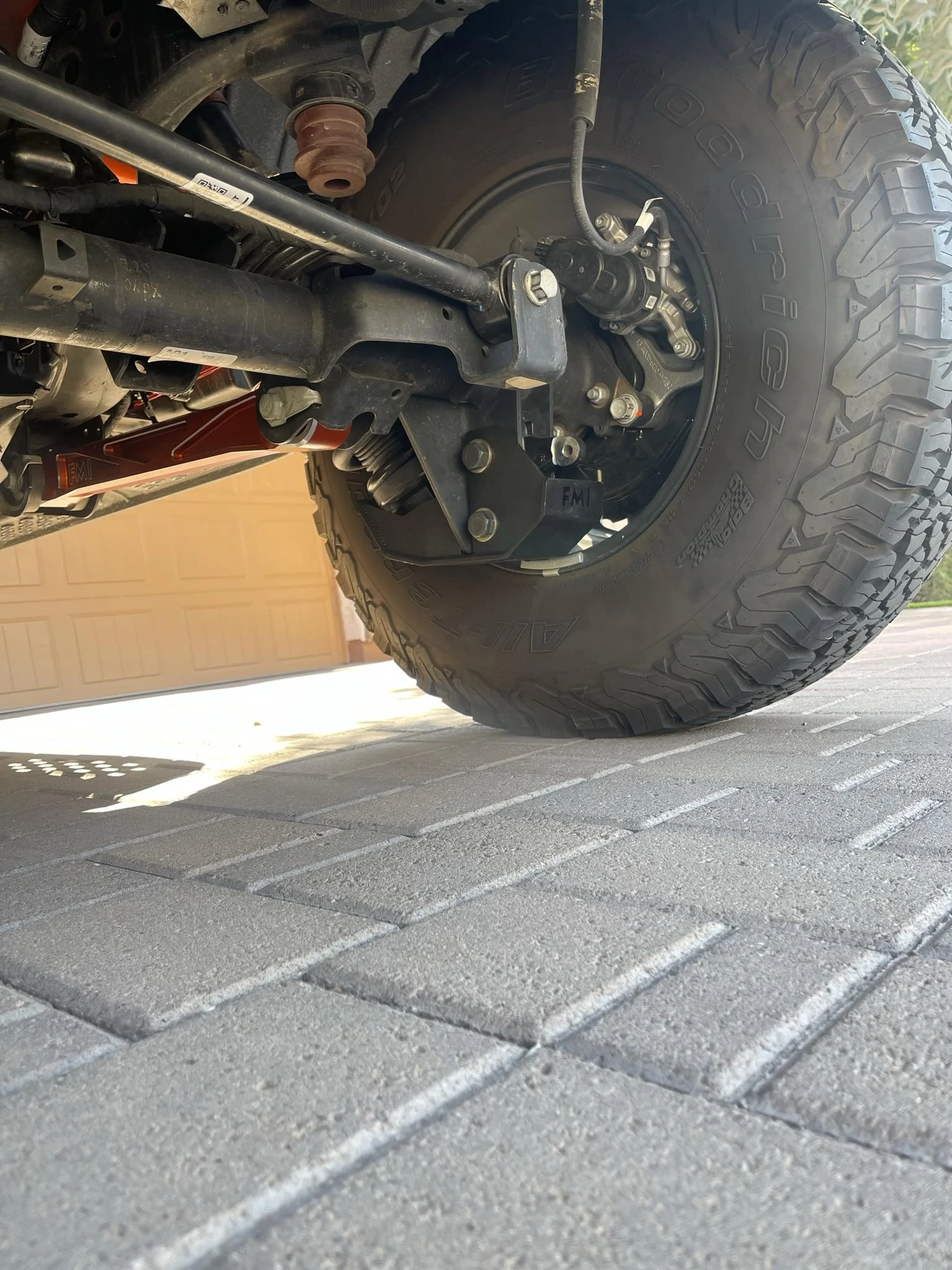

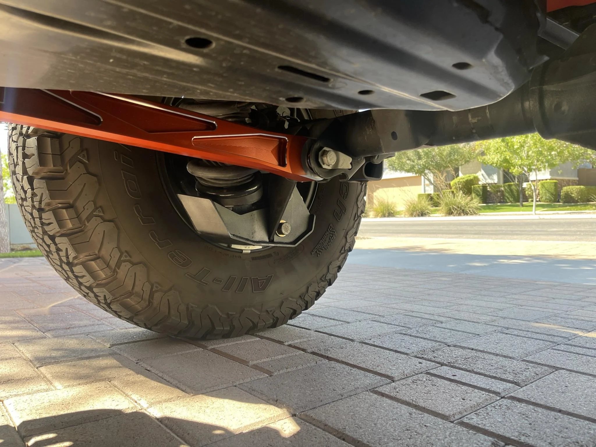

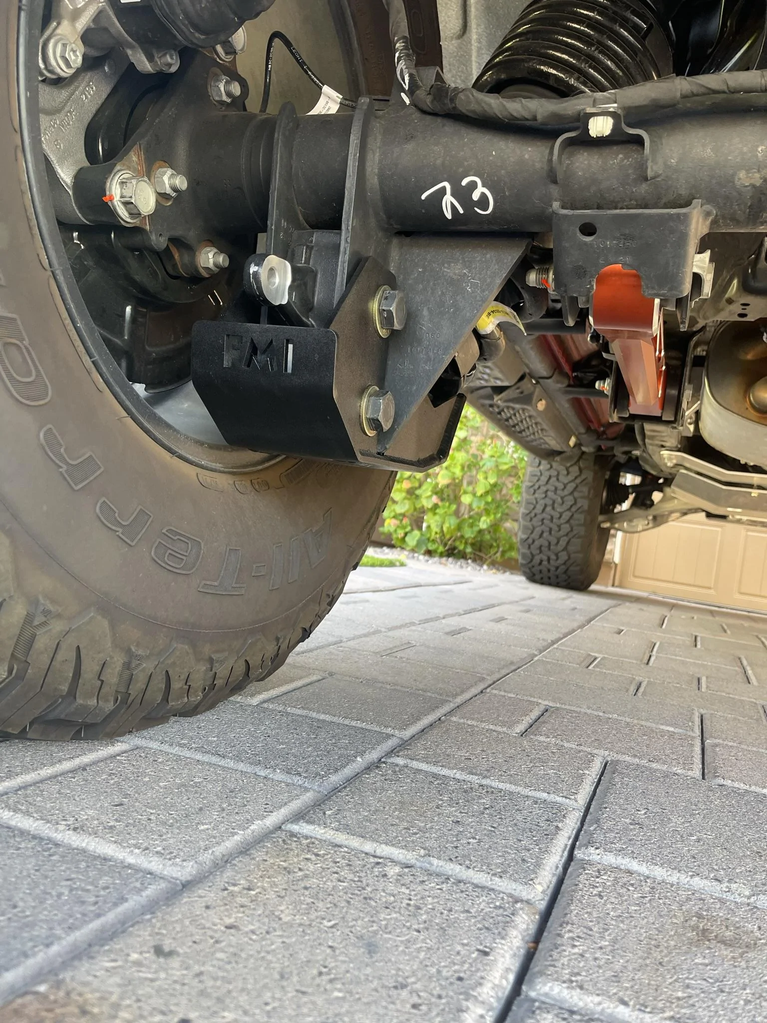

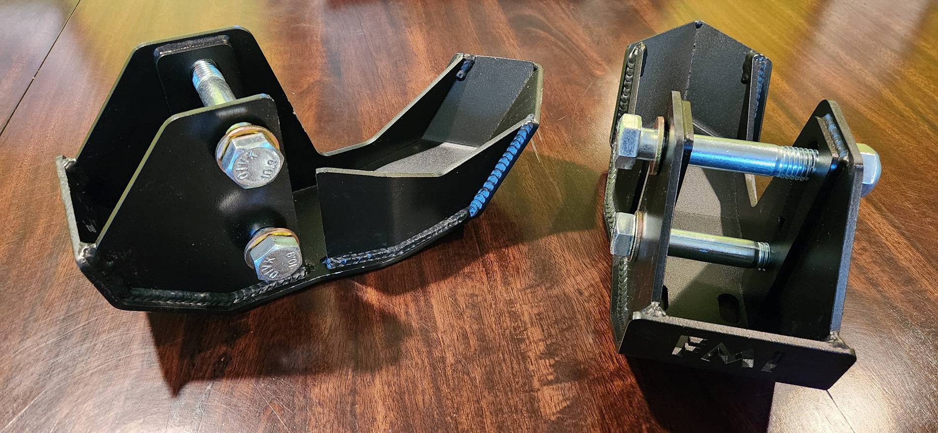

We just got done test fitting our new Bronco Raptor rear shock skid kit. it was a little tricky to get something that works with the floating rear lower mount and would still be strong but I think we have something that will work great. Check it out. We are doing the first production run of these now. Let us know if you want to get some from the first batch. We also have a lower arm frame guard coming next week too.

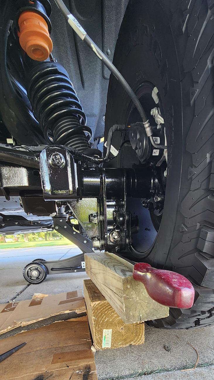

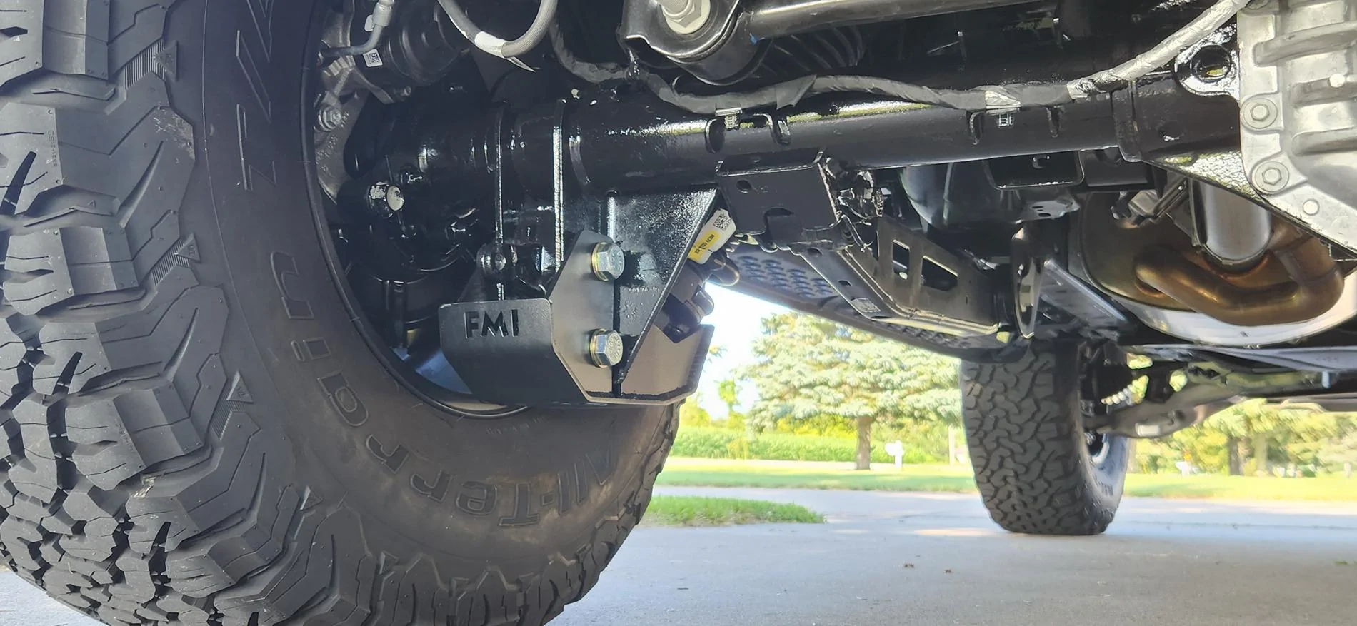

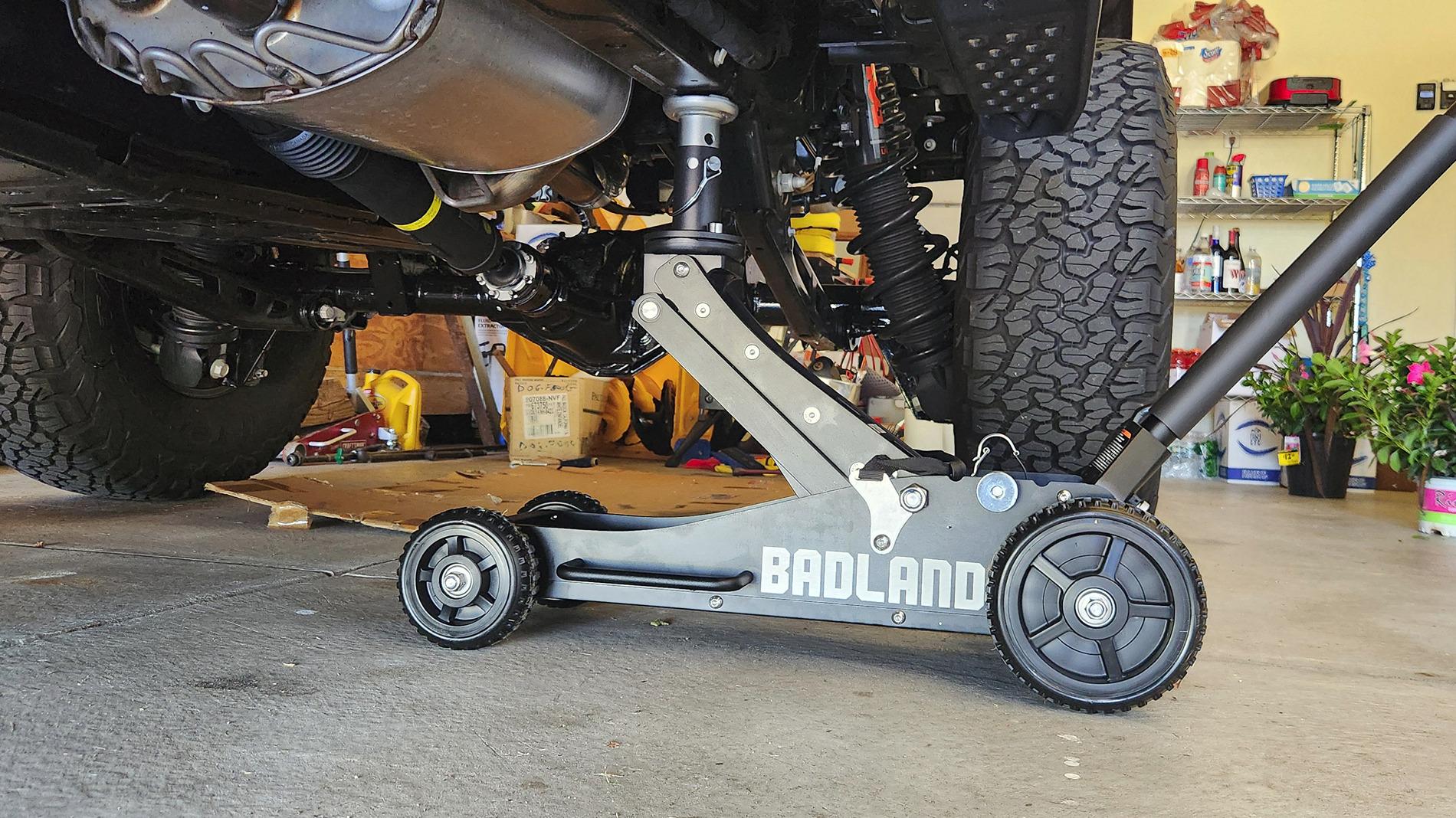

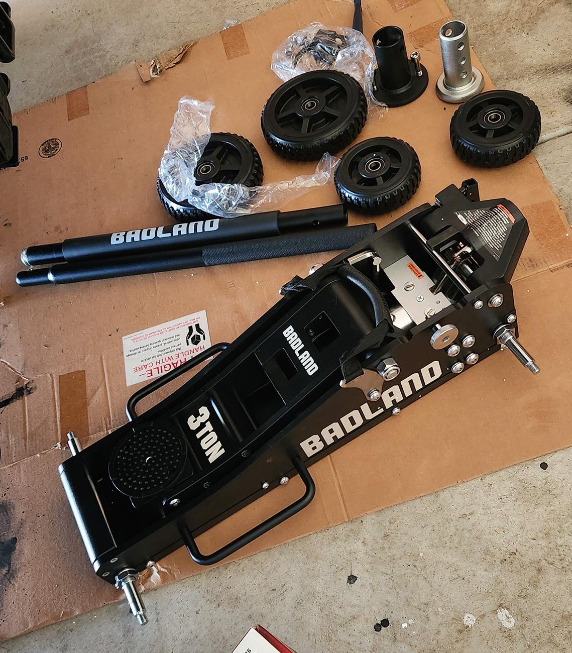

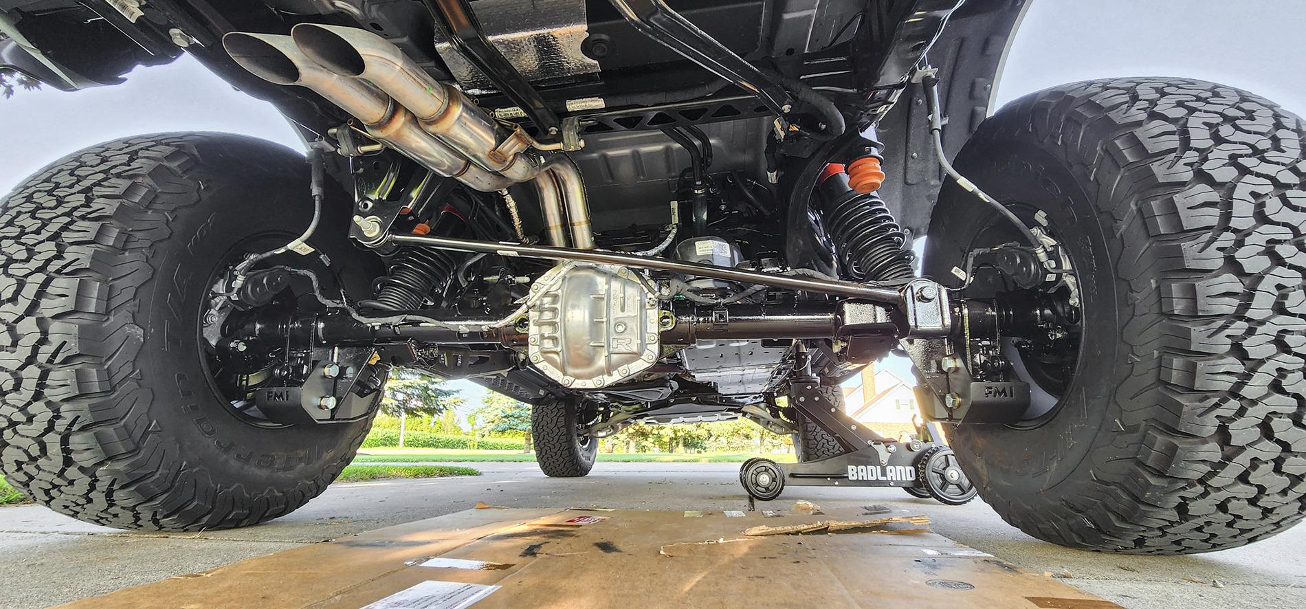

I just installed a pair of these skids with the wheels/tires on but with the respective side jacked up in the air as Greg mentioned. Thanks Greg for having well done fixtures - this one was a close fit!.
I purchased a sweet jack from Harbor Freight that made the job rather simple.
Ford Bronco Bronco Raptor Rear Shock Skid kit by Foutz Motorsports 20240726_155014
Ford Bronco Bronco Raptor Rear Shock Skid kit by Foutz Motorsports 20240726_161754
It was easy to obtain full droop. I found that you want to back off just a hair and let the tire just touch the ground such that you can't spin it. That alleviates pressure (upward or downward) at the mount and allows you to slip the bolts out, slide the skid into place, and then install the new, supplied bolts. I put a couple of blocks under the assembly and fine tuned with a pry bar to make it even easier.

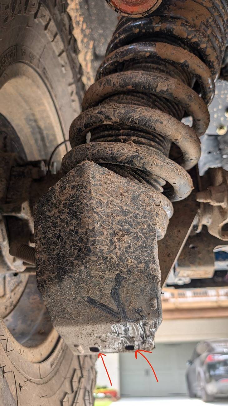

How do these drain? I'm in the PNW and mud and water are constant. Will the shocks just be sitting in a bath of mud and water all the time?

There are drain holes in the bottom to let the water and mud out. Just hard to see in these pics.

Found a pic of one of mine installed after putting them to the test while wheeling -- you can see the drain holes on the bottom in the arrows I drew on the photo:
