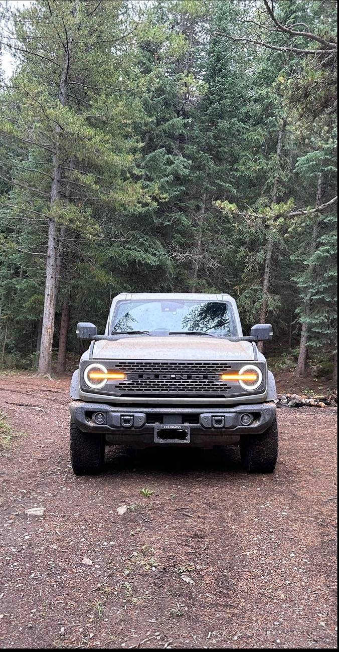

Are they quality? Do they look good in person?
Thank you.
Easy to install with no issues since. I could have trimmed them slightly, but for the money I got the look I wanted. Understated when the bar is white (see pic below) and bright for turn signals.

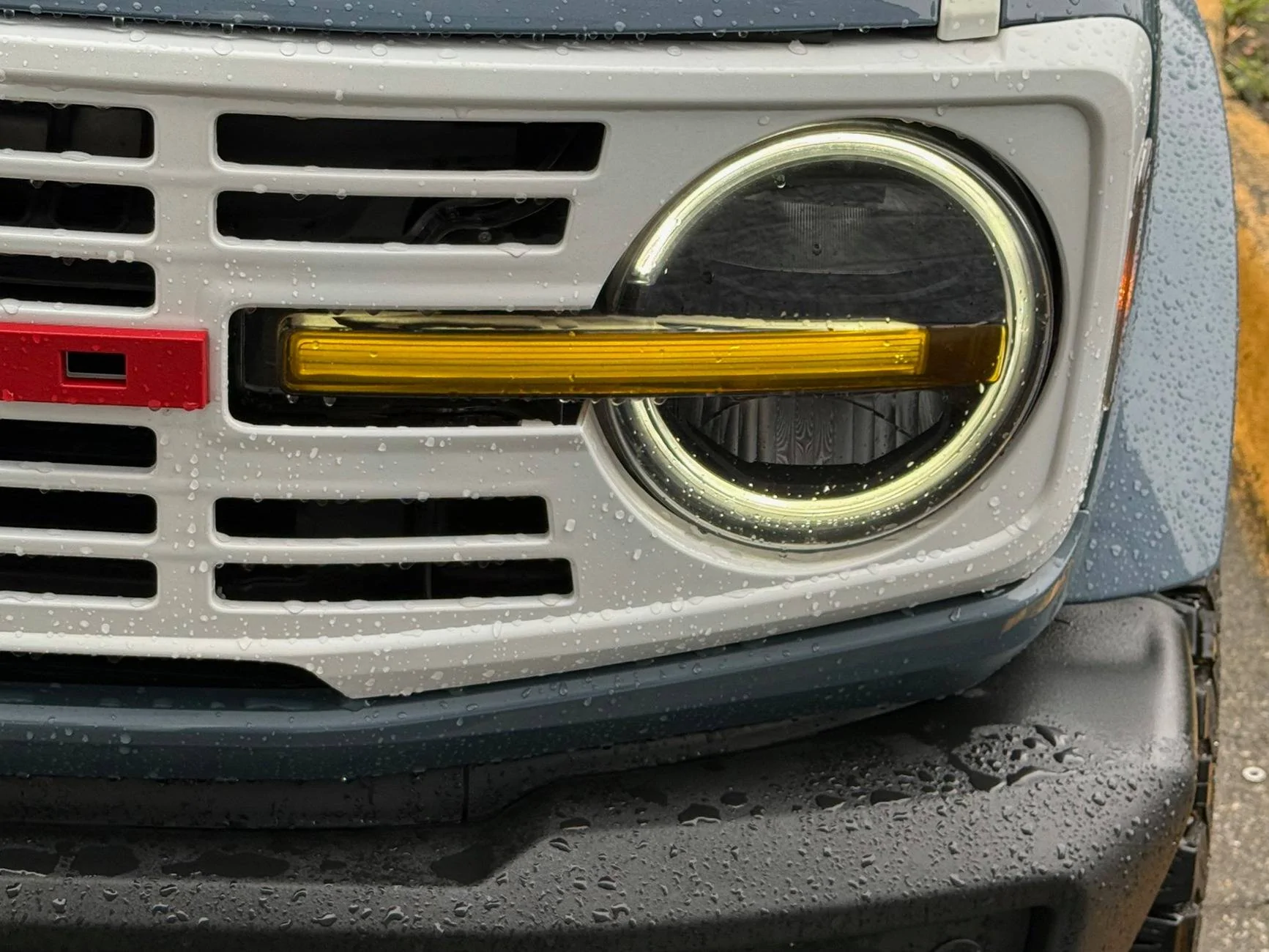

Yes it’s possible to enable the turn signal to remain orange I made an adjustment in forscan. These are drl and once my headlights kick on then return to while which is nice.

Do yours stay on for about 10 minutes after turning the car off? Still don't understand why mine do that.
thepear
Dec 13, 2023
Ford Bronco 4 Door
Yes I had to play around with the settings it would either stay on after the car turned off but didn’t time it and another changed caused them to stay solid amber even while the turn signal was activated. After I was able to get them working properly but it took a few tries.

What exactly did you change?

So I am trying to recall from memory since I did this change almost a year ago but hopefully it will be enough to point you in the right direction and save you some time troubleshooting.
If I remember the correct setting, it changed the DRL to amber ONLY when the car is NOT in park. So Drive, Neutral, and Reverse. Once I place the car in Park the amber lights turn back to white and when the car is off they turn off completely. I think when I was testing it took awhile since it was in park the entire time and when it "worked" the issues above was also present.
In the spreadsheet I think line 44 and 45 are the options. I just cycled through all those until one worked. I remember the wording not being completely accurate so I recommend doing each one. But remember to start the car, place in Drive or Neutral and engage the parking brake. Then test the turn signals to make sure Both sides work. I referenced this spreedsheet:

mine are set like that, orange bar, white halo. they turn off right after i turn my car off. there is a setting for the DRL time out, its in the settings on head unit i believe.

I changed my DRL to Amber as well, and really like the look. I'm having the same issue at night, that they stay solid and don't blink (blink during daytime) . How did you correct that ?
If you did it correctly (set them to DRL) then when the headlights come on (at night, for instance) they'll revert back to white. They should also still blink. What specific change in your case did you make in forscan?
EDIT: perhaps you mean they do revert to white when the headlights are on but don't blink with a turn signal. Either way that's not correct

I referenced the FORscan Google doc. had somebody make the change. They work during the day(Amber, Blink), but when headlights come on they still stay Amber and won't blink.
