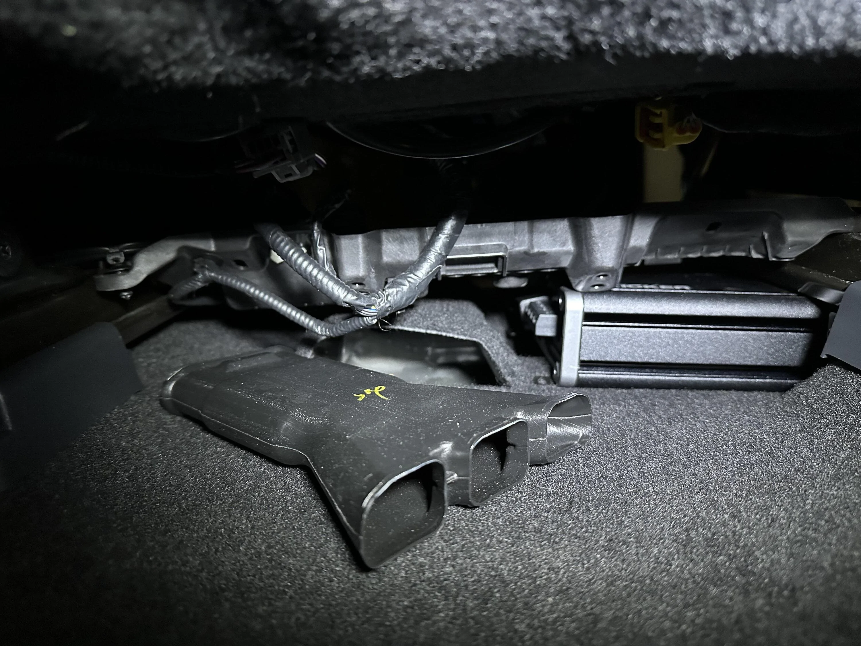

My Kicker 5 channel (same height) lives under my driver seat. Had to eliminate the rear air vent to do it though

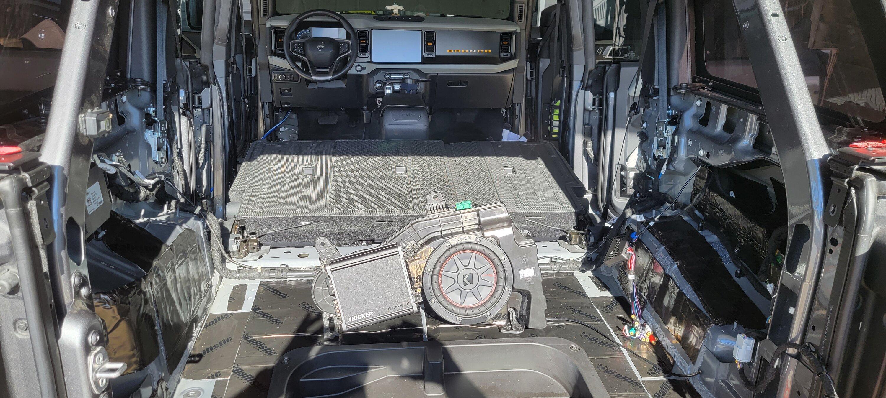

We mounted a Kicker 800.1 in the B & O amp location. It fit fine and sounds great!

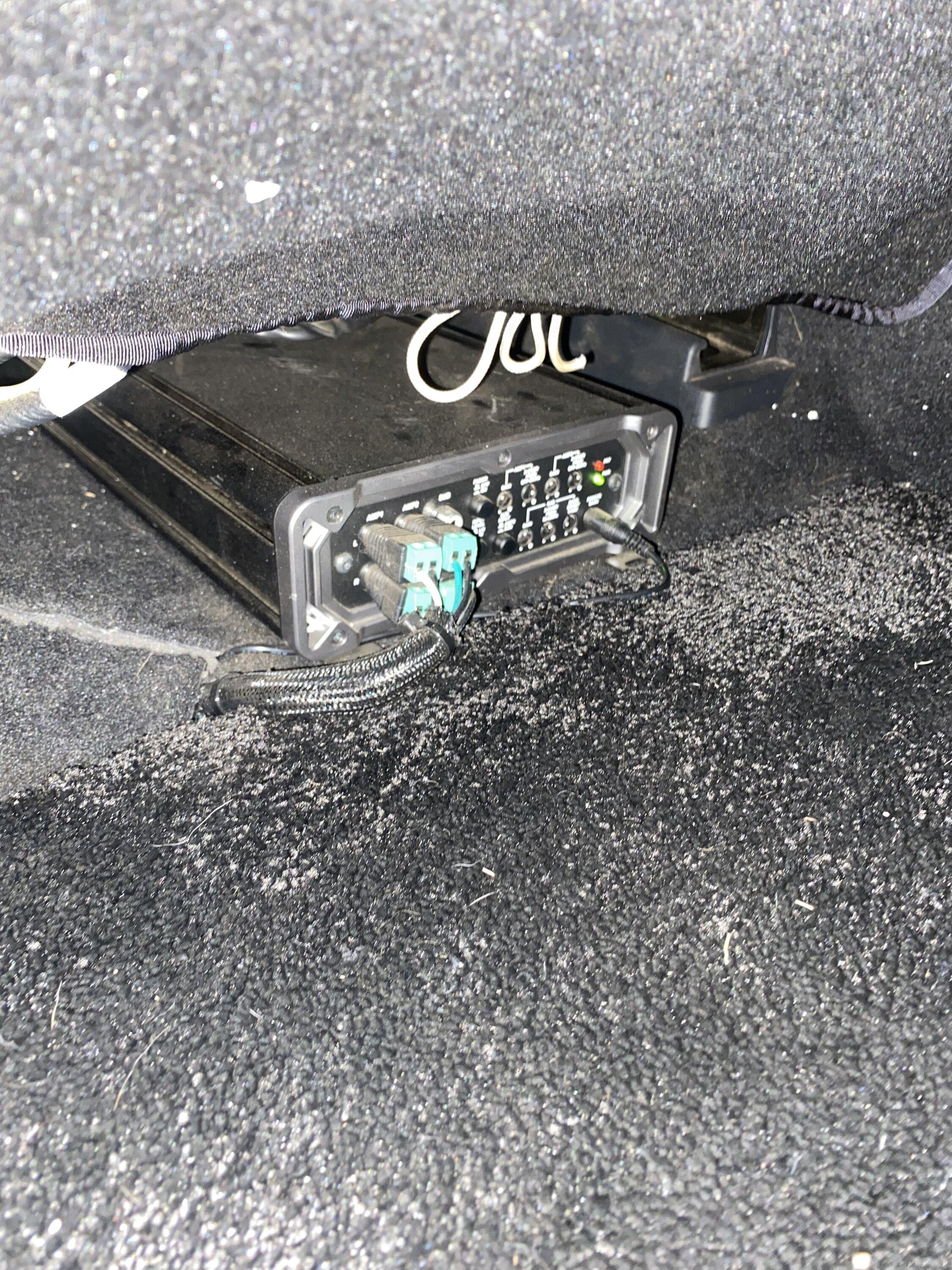

Both my amps are under the front seats. Same, had to lose the heater vents.

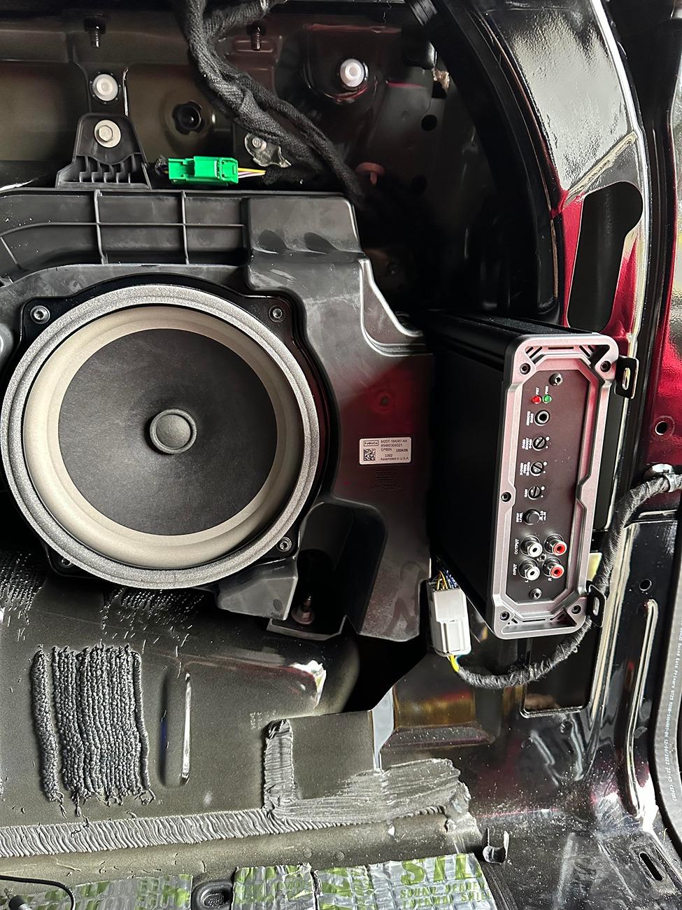

I completely removed the B & O amp and put a Axxess DSP in, the Kicker 800.1 on the sub enclosure, added 2 Euphoria amps (1 under each front seat) for the other speakers.

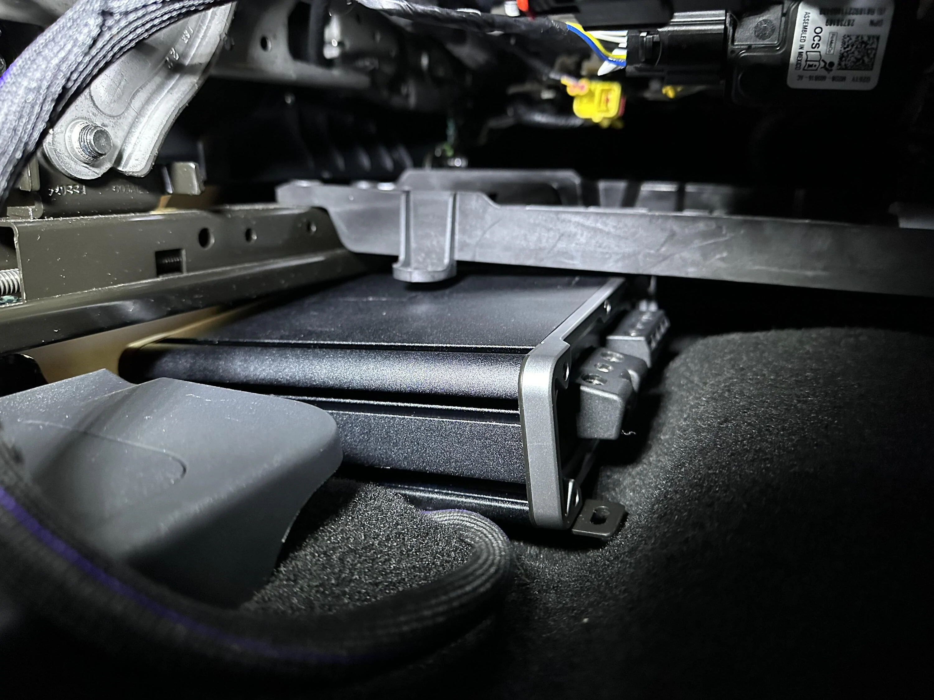

Successfully got the CXA800.1 under the front passenger seat.
I was convinced I was going to have to take out the seat to get it there, but that wasn't necessary in the end. The trick was to take out the air vent which I learned simply pulled right out. I could then push down the carpet enough to sneak the amp under the seat support cross member.
This piece does rub very slightly when the seat is moved forward and back, but it's plastic and does not mark the amp. This support does not move up and down when the seat is adjusted in that dimension.
This amp (8-5/8"W x 2-3/8"H x 6-3/4"D) barely fits in every dimension, but if you have this or a smaller amp rest assured this location will work.
In the following pictures, note that the fit is tighter than it looks especially with the non-flat floor surface. Not much wiggle room in any dimension.
Looking from the front passenger foot well back:
Ford Bronco Amp Location Options front
Looking from the rear passenger foot well forward:
Ford Bronco Amp Location Options back_unplugged
Looking from the side:
Ford Bronco Amp Location Options side
