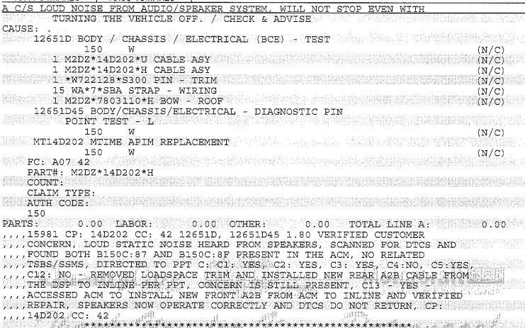

So update...
Finally got it back yesterday. Think the dealer had it a week, but they ended up finding another issue that was unrelated and fixed it as well. Looks like they replaced a wire from the DSP and then another from the ACM and that fixed it(?). The additional issue they found was a water leak from the top of my windshield at the header seal. I had been hearing a clicking noise (now I think it was the butyl strip under the seal touching the metal and getting pulled away, like a tacky sound) couldn't ever figure it out. Turns out the seal between the roof panels and the window frame was no bueno and the seal had sprung a leak. I think there is actually a TSB on this for the 2021 Broncos if I am not mistaken.
Just wanted to post up the aftermath in case anyone else runs into this.
