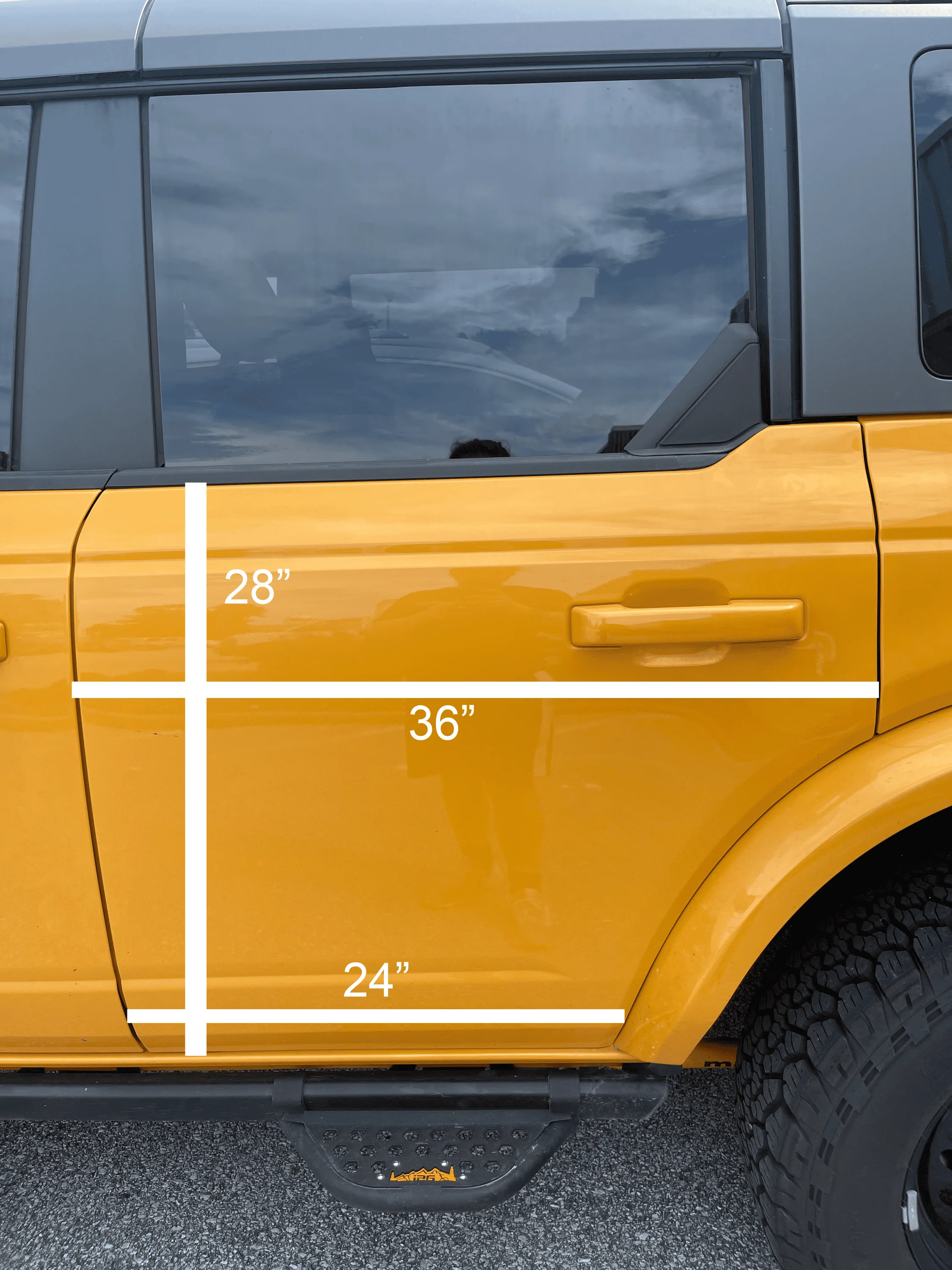

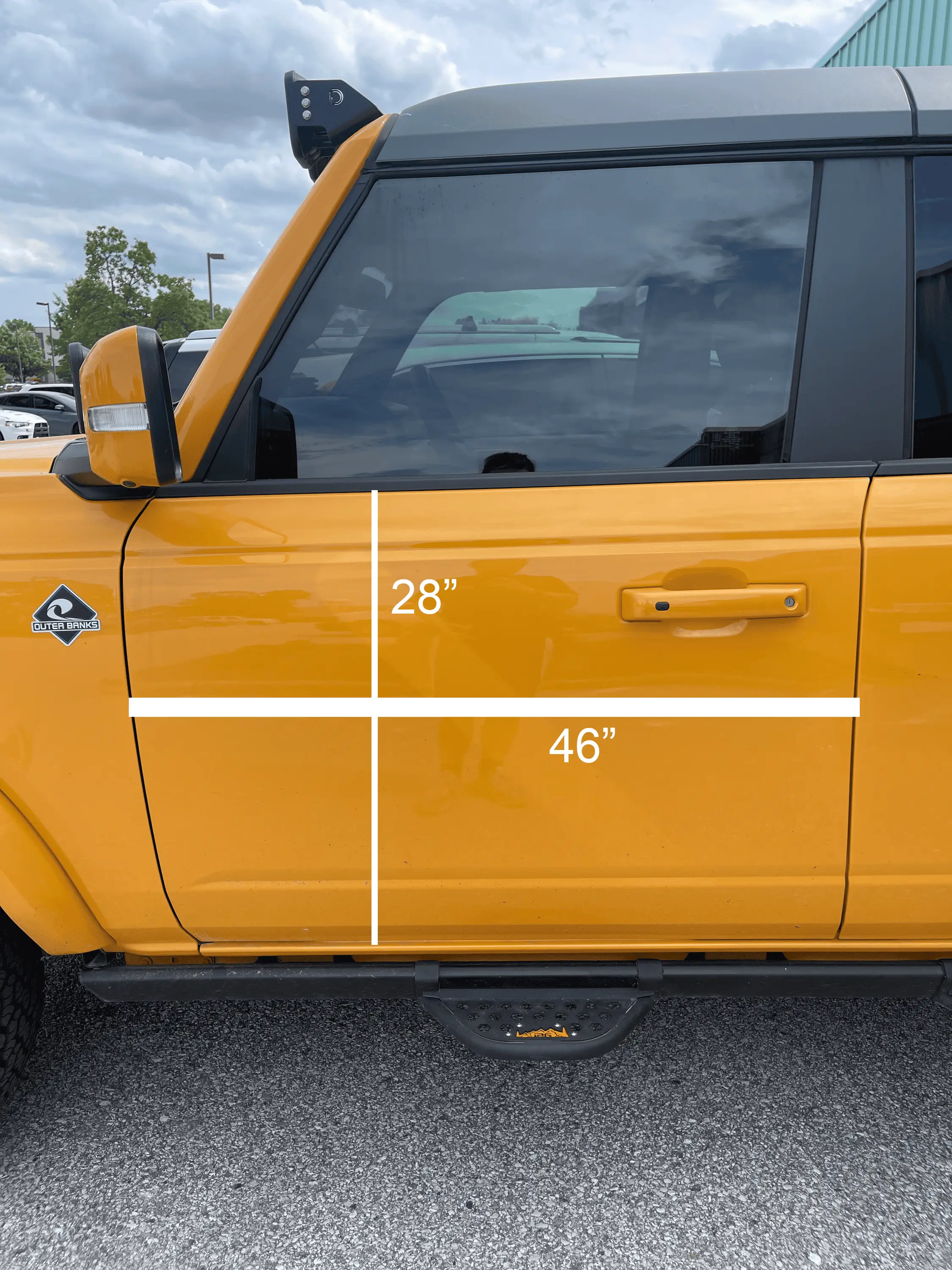

I have a Bronco 4 door on order and should be delivered sometime next week. While I wait, I wanted to make a diy storage rack for the doors but I cannot find the dimensions of all 4 doors anywhere. If someone can please let me know the dimensions it would be greatly appreciated. Also any tips on the best way to make a storage rack would be appreciated as well.

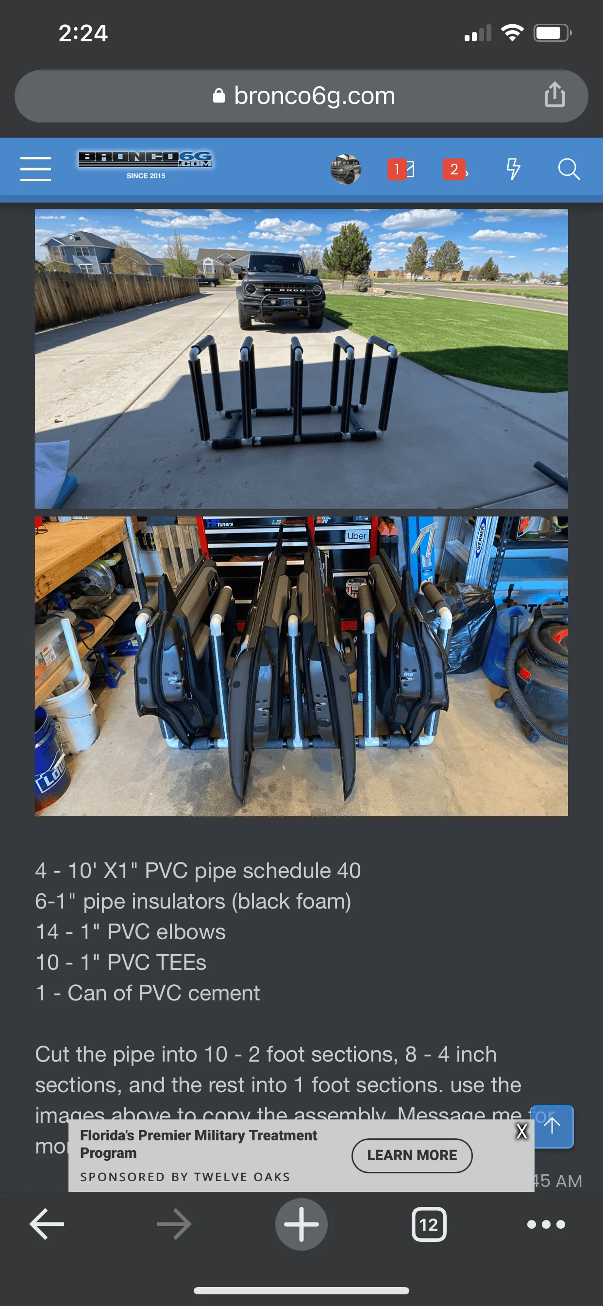

I just built this that another member posted and it works well. $100 worth of material
