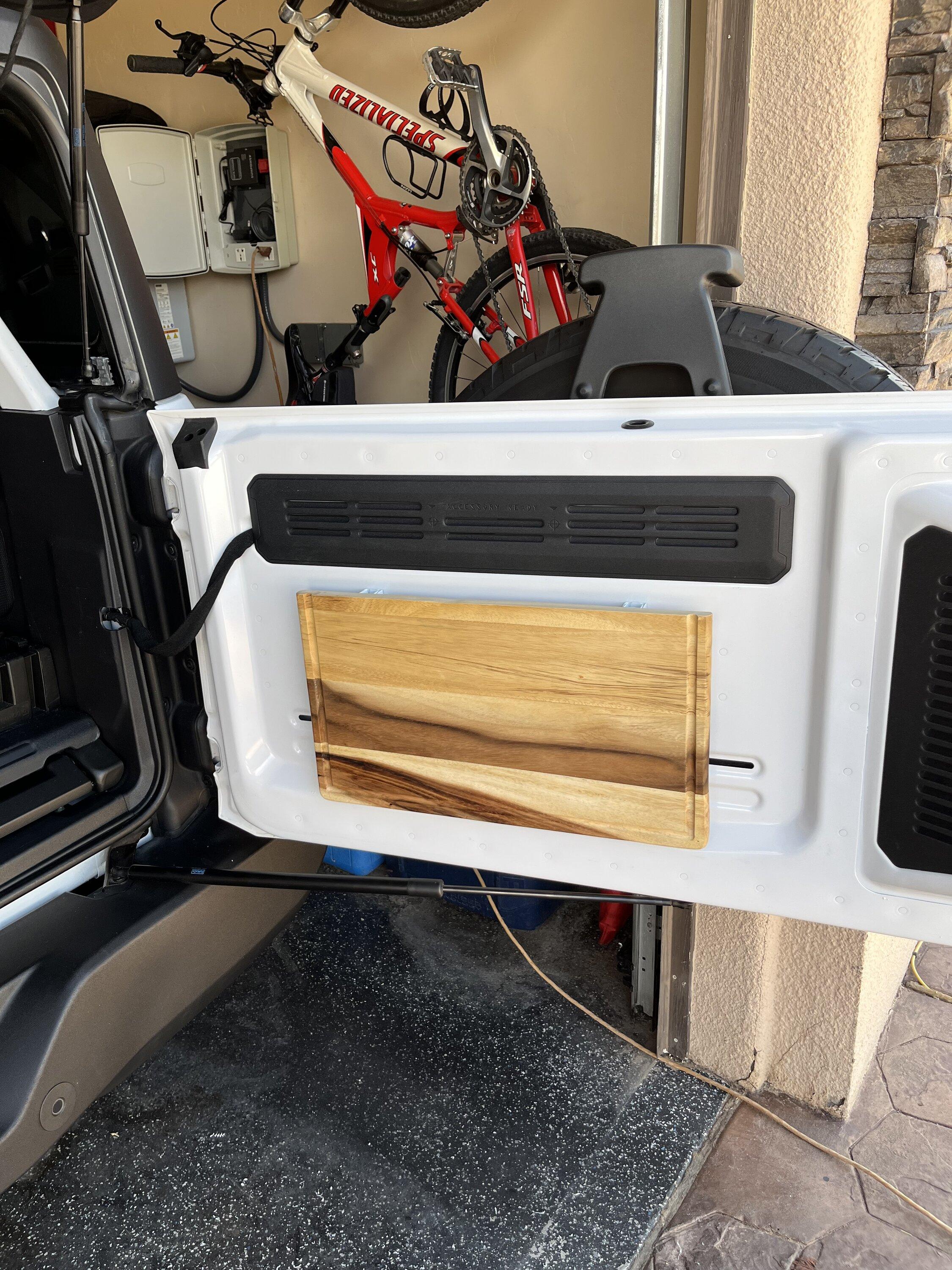

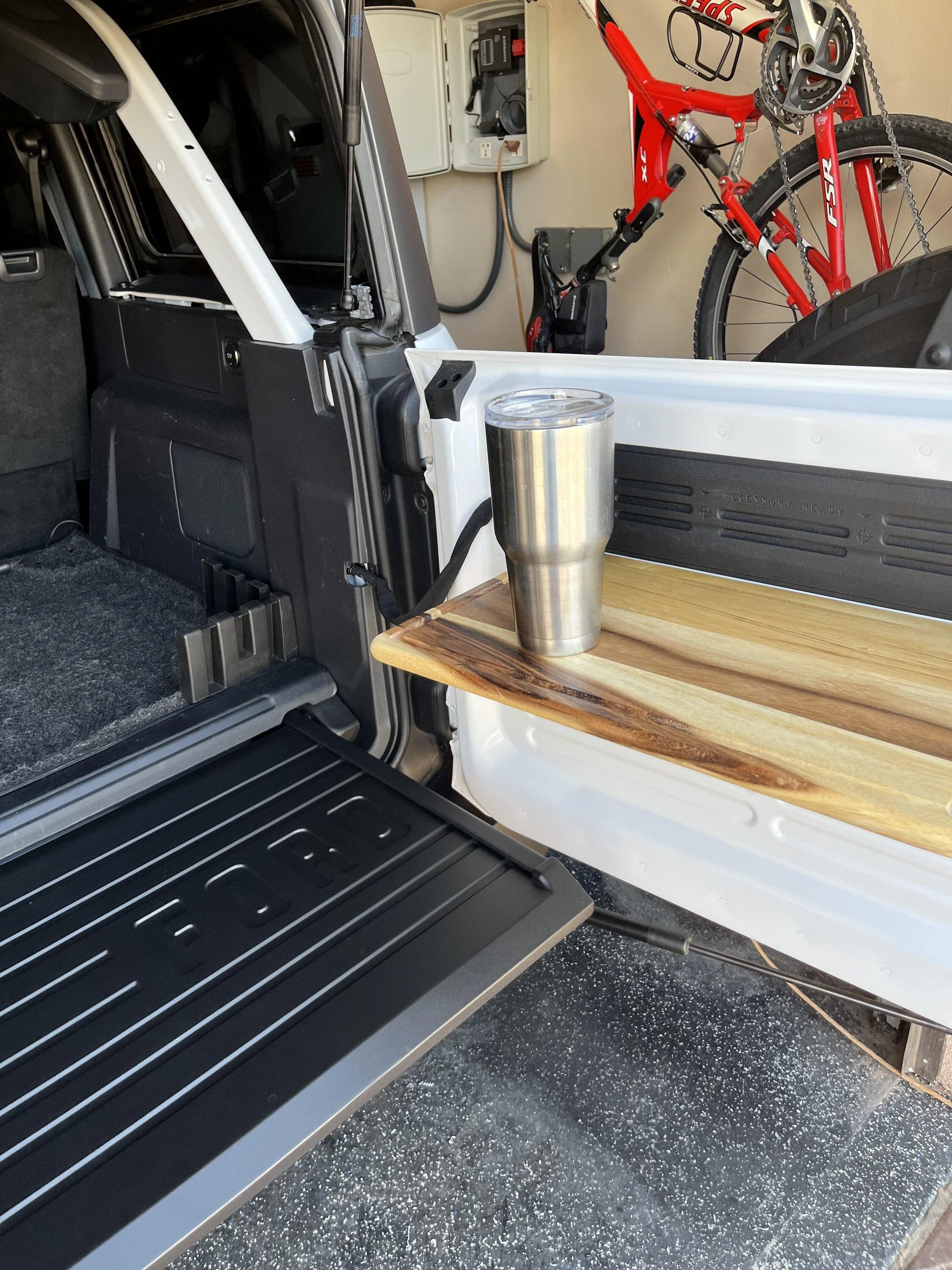

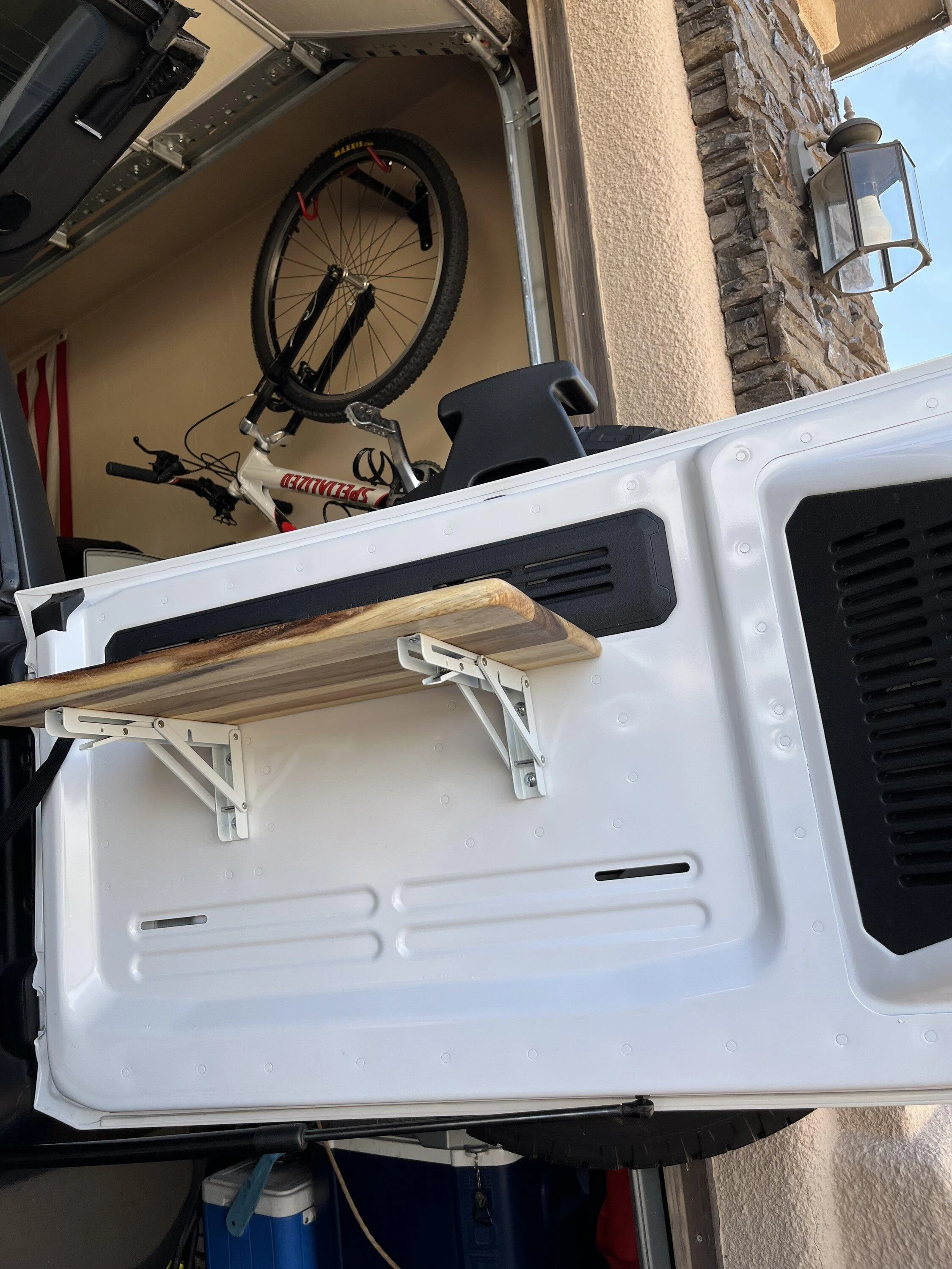

I have a slide out tailgate and I couldn’t find a tailgate table that opened upward. I decided to build my own using a cutting board, folding brackets and jack nuts.
