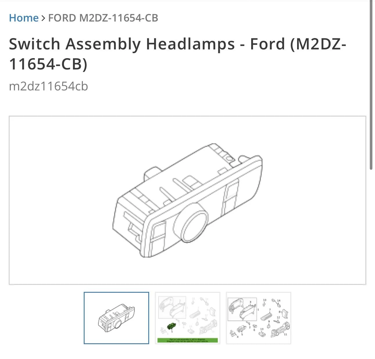

I’ve ordered the headlight W/fog light switch from ford (well re ordered didn’t realize my initial order was canceled due to one part being on back order and didn’t respond to the email 😬)
Ford Bronco Fog light help A6E364BC-93DE-4E6D-8950-4ACCDFF3B839
My understanding with that it’s a basic plug and play (for the switch) and then I would need to go into forscan and enable this feature.

Are all the lights driving lights or are they offroad lights. I'd say wire a pair of street legal driving lights to the fog light switch. 4x4truckleds sells a harness that is plug and play for 1 pair of lights to the factory harness which is located behind the bumper behind the plastic panels on the mod bumper. Pull those panels and you should find a harness end with a dummy plug. You still need to enable the fog light function in forscan. If your remaining lights are off road, you can write them together for 1switch or use 2 different switches, your choice. Not sure why you would need 4 switches for only 3 pairs of lights. If none of your lights are street legal, I wouldn't put any on the fog light switch.
