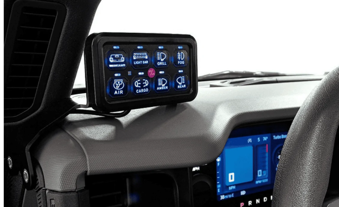

I think he's trying to mount a multi-switch panel, not just a single switch.
This is among the most common, and probably the easiest, but it requires a bracket (You can see it in the picture, it uses the screws that hold the grab bar in)

The one that was posted from the F150 site is also pretty common and not too hard to run either. But it does block that little tray and makes access to the USB ports a bit more difficult.

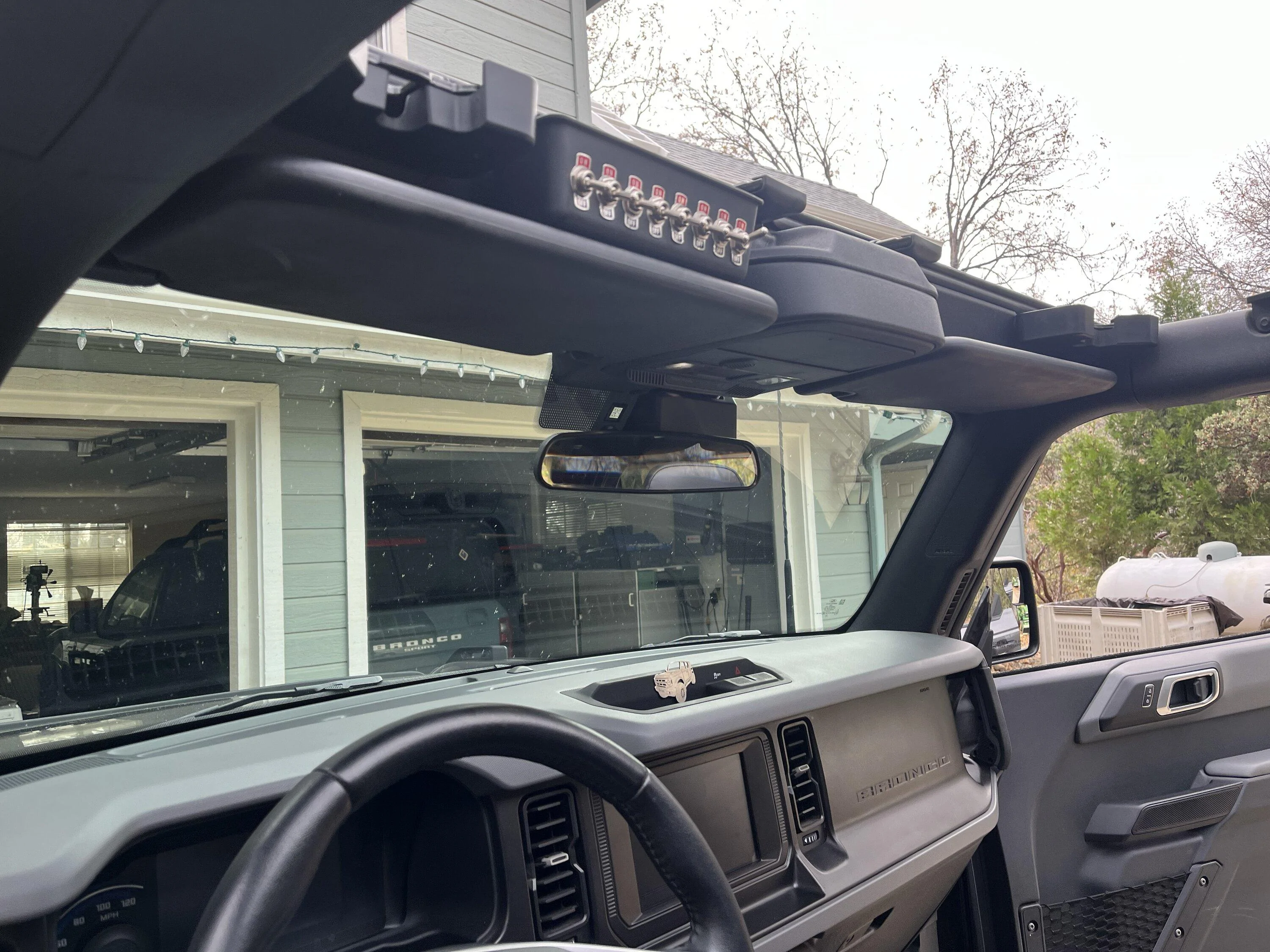

I put mine up top because I didn't want it in my line of sight while driving, but that isn't an off-the-shelf panel and it required pulling apart a lot more trim.
