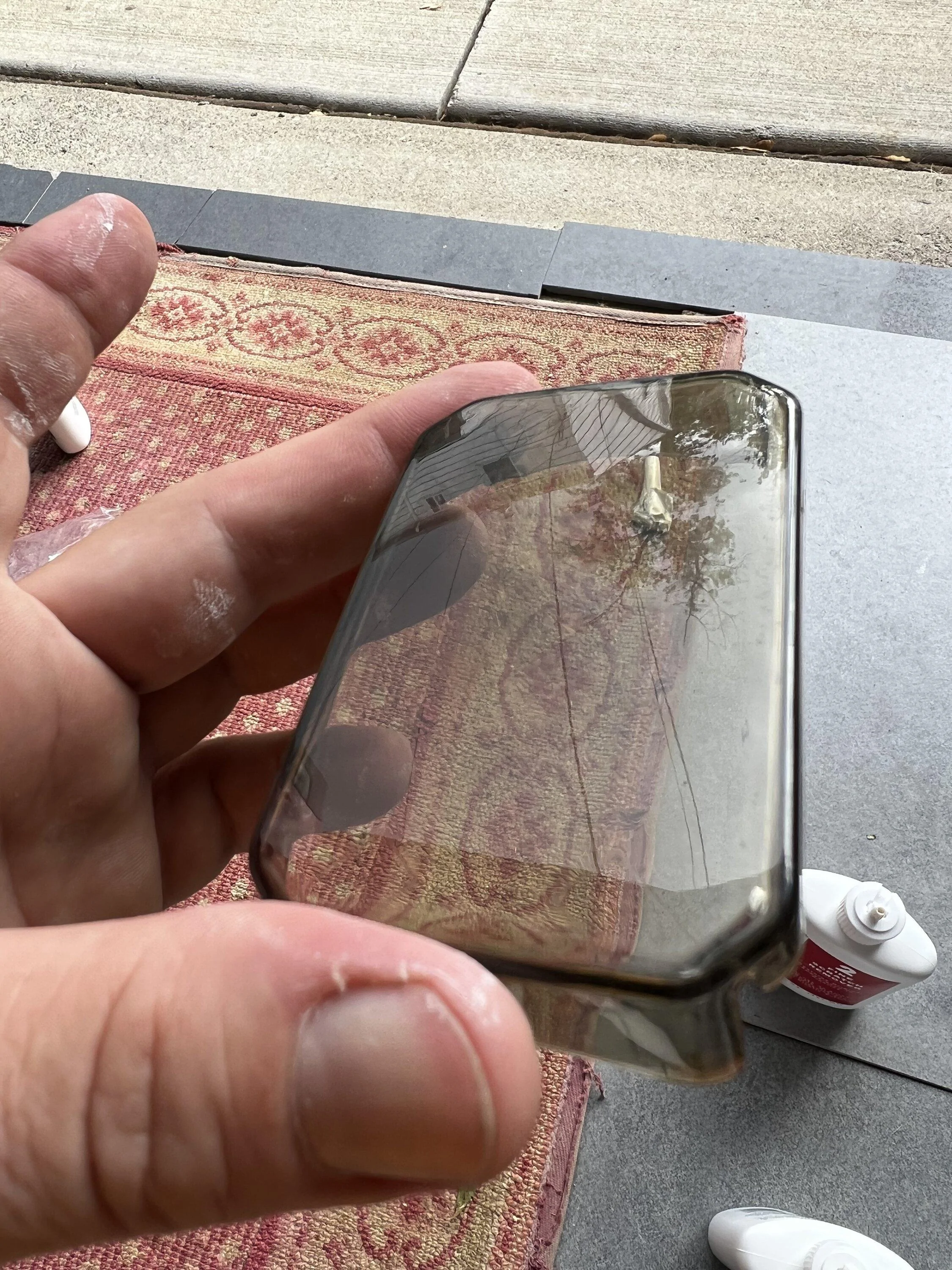

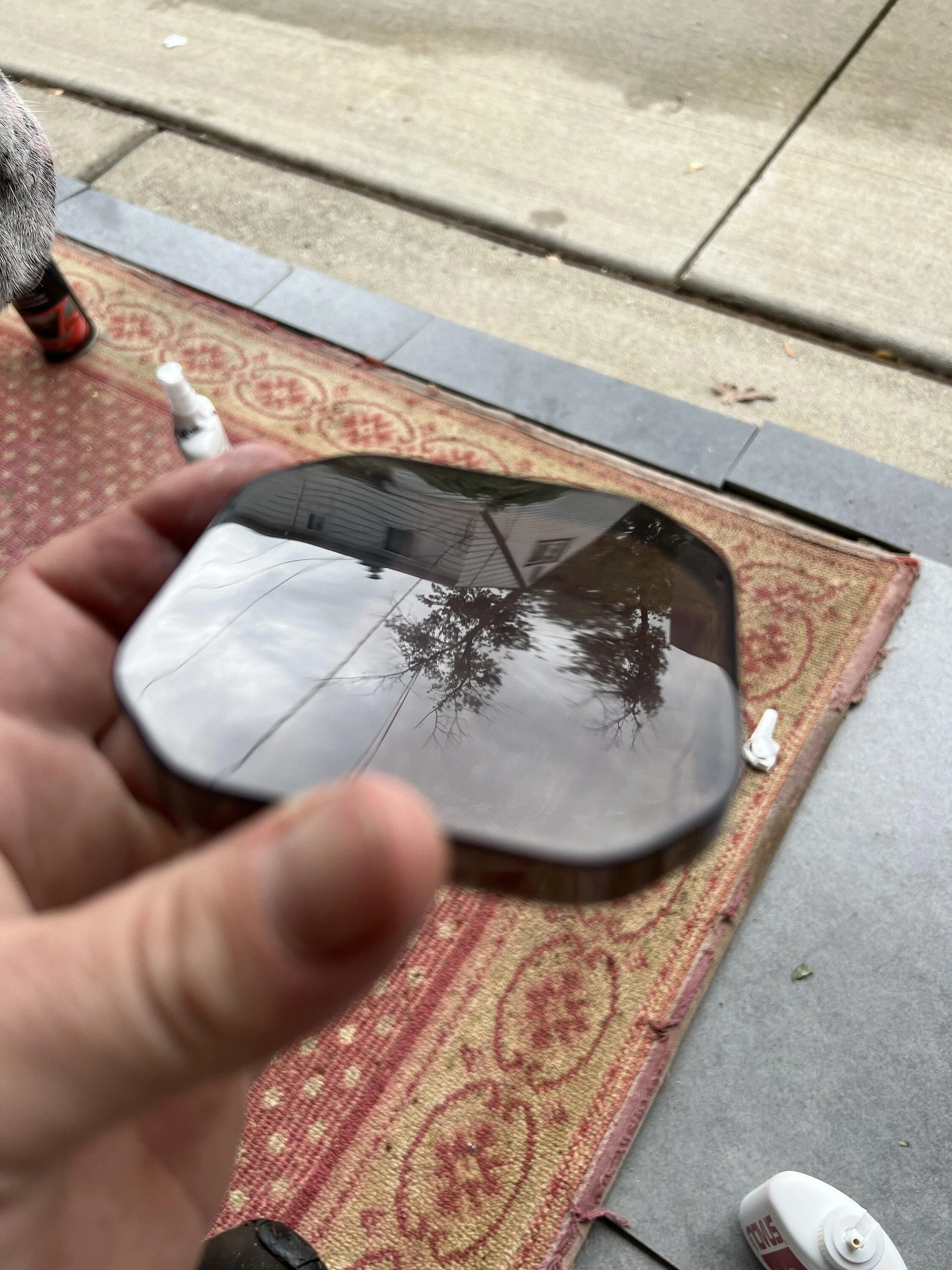

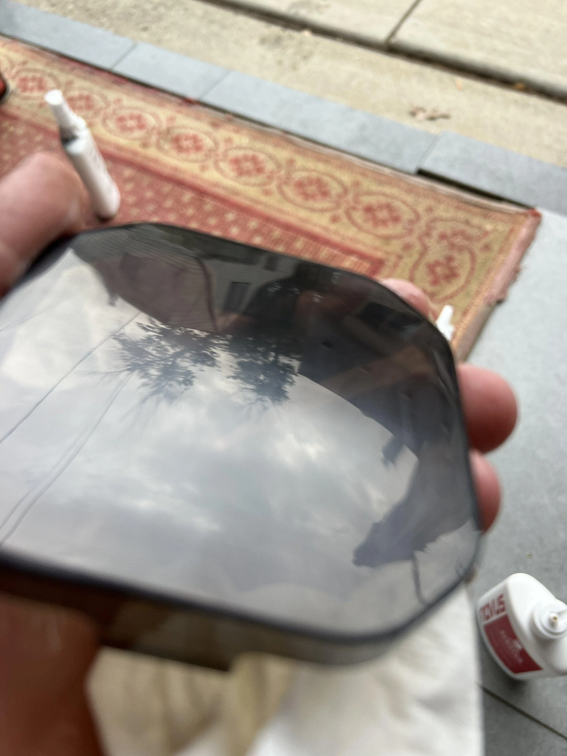

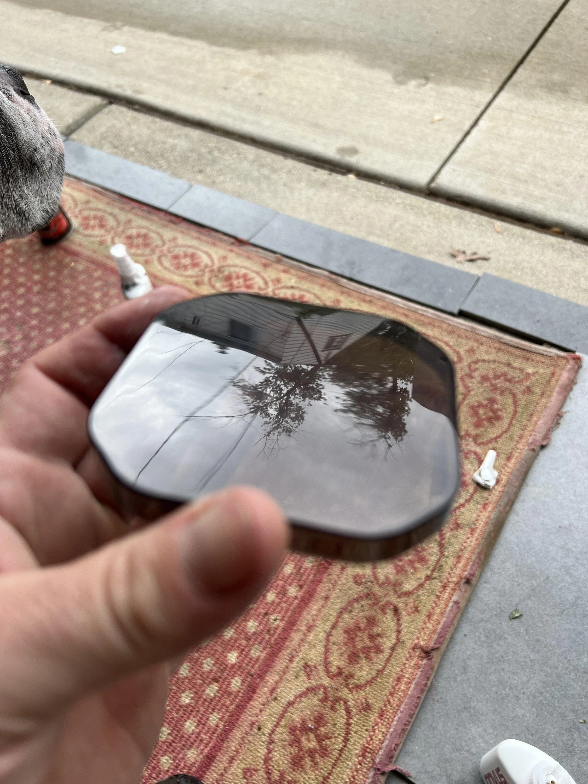

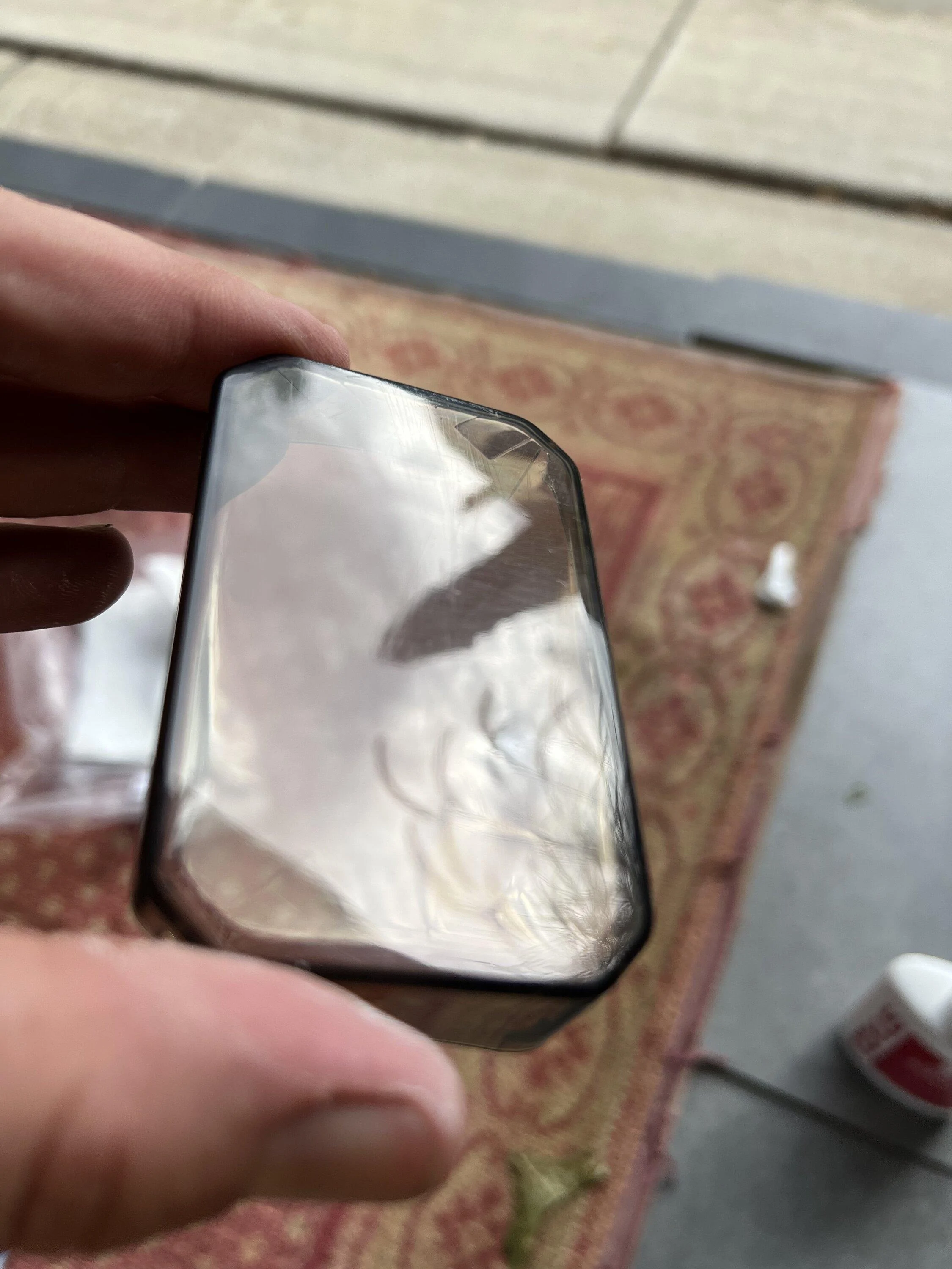

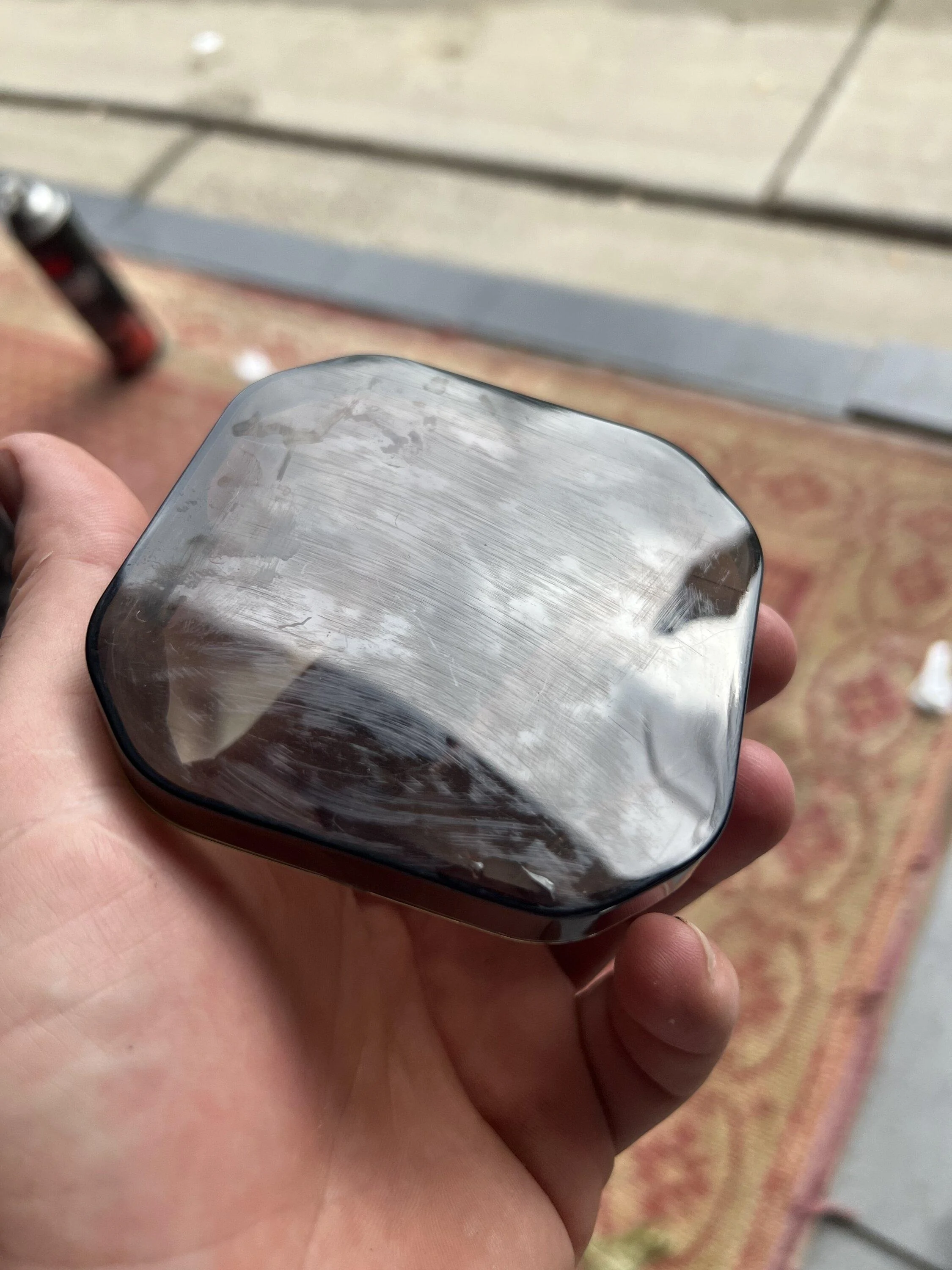

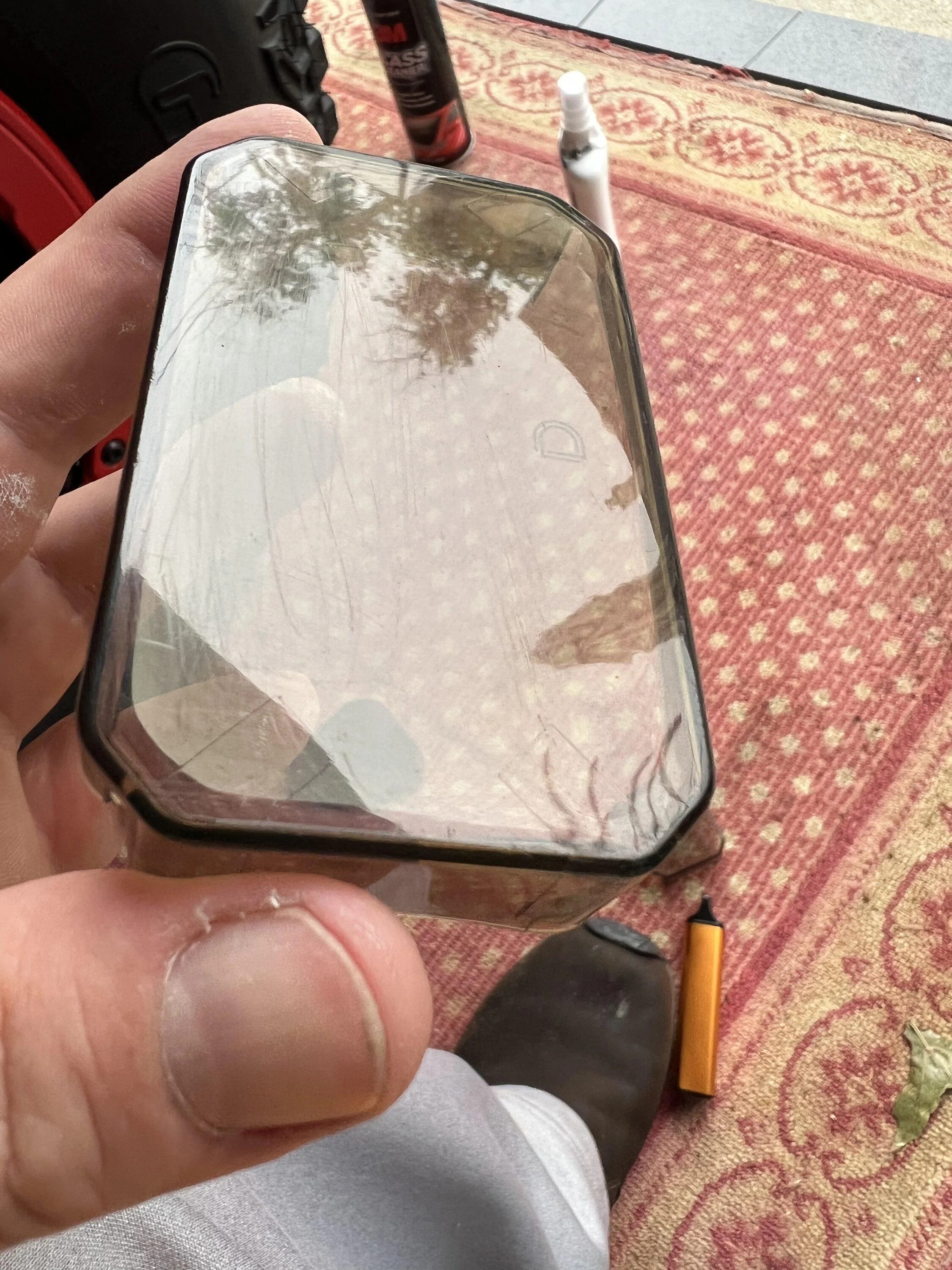

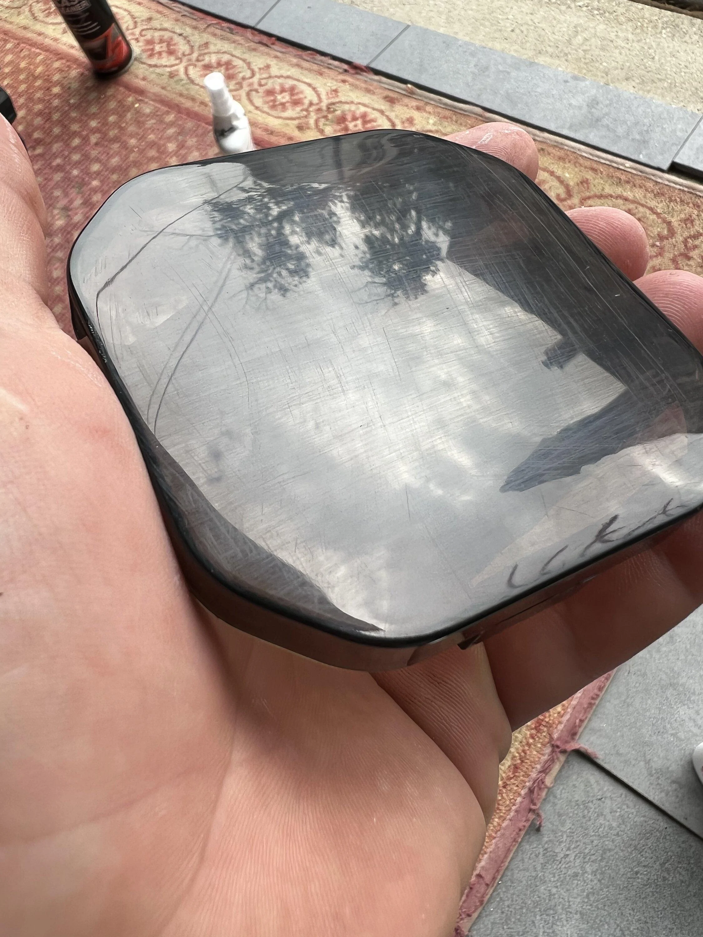

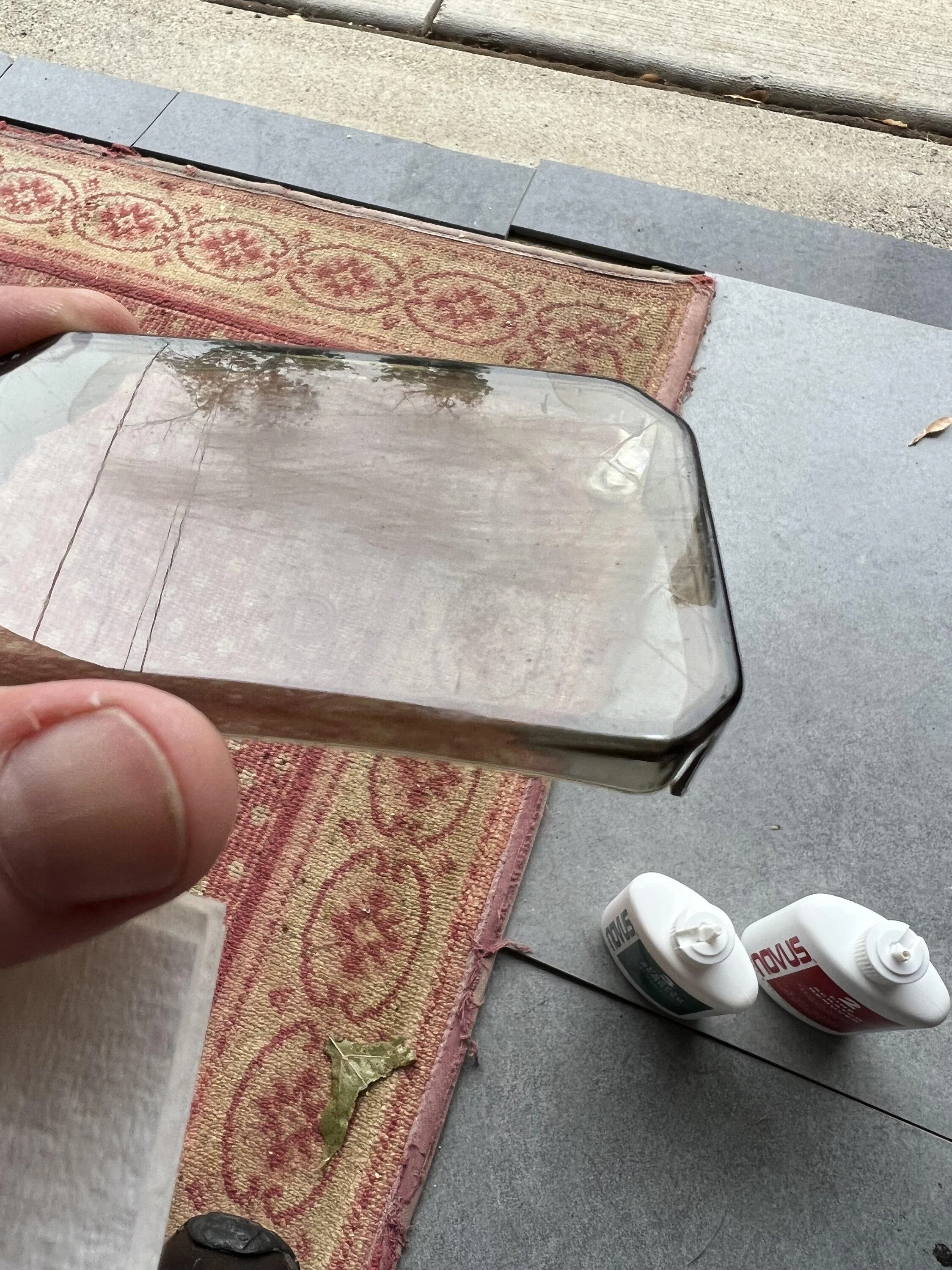

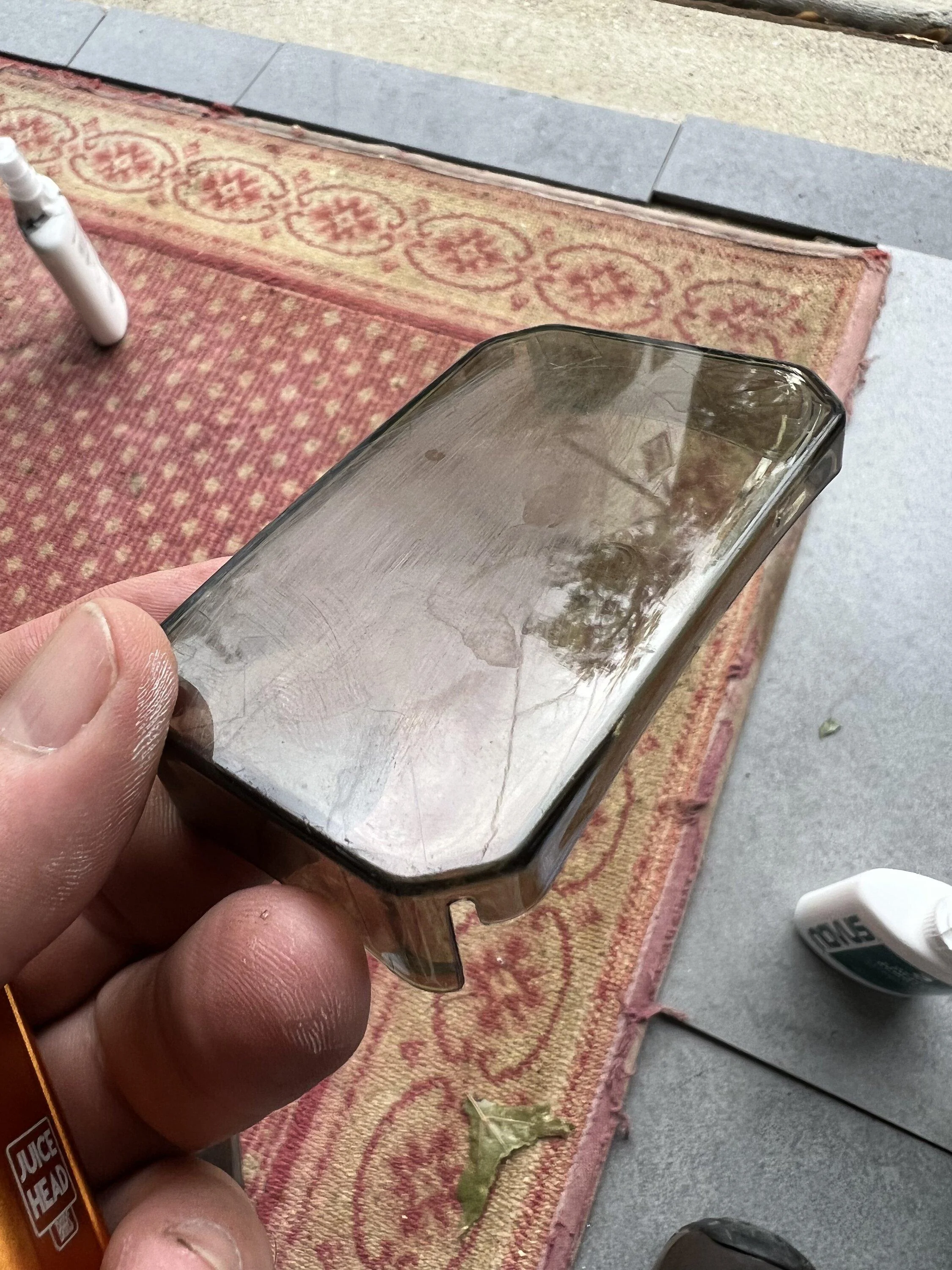

Did my head light and pod cover maintenance today. Thought I’d share for others who like to keep the ole bronco clean.
This is for minor scratches, scuffs, and fogging. Not a lot of work. Just a casual polish by hand. It will bring the shine back, some scratches won’t polish out easily if deeper, but can get the gloss shine back to hide it.
I use Novus plastic polish 1,2,3. 3 for deeper scratches. You work 3 on a 90 degree angle to the scratch. Then 2 for the polishing. 2 is put on in circular motions. This will get the gloss back. 1 is a general cleaner/anti fog.
Link for the product.
8oz bottles $24
https://www.amazon.com/Novus-7100-P...sh&qid=1664139414&sprefix=novus,aps,94&sr=8-2
2oz bottles. $15
I usually just use 2 if it looks foggy or hazy. If the scratches jump out, I’ll start with 3.

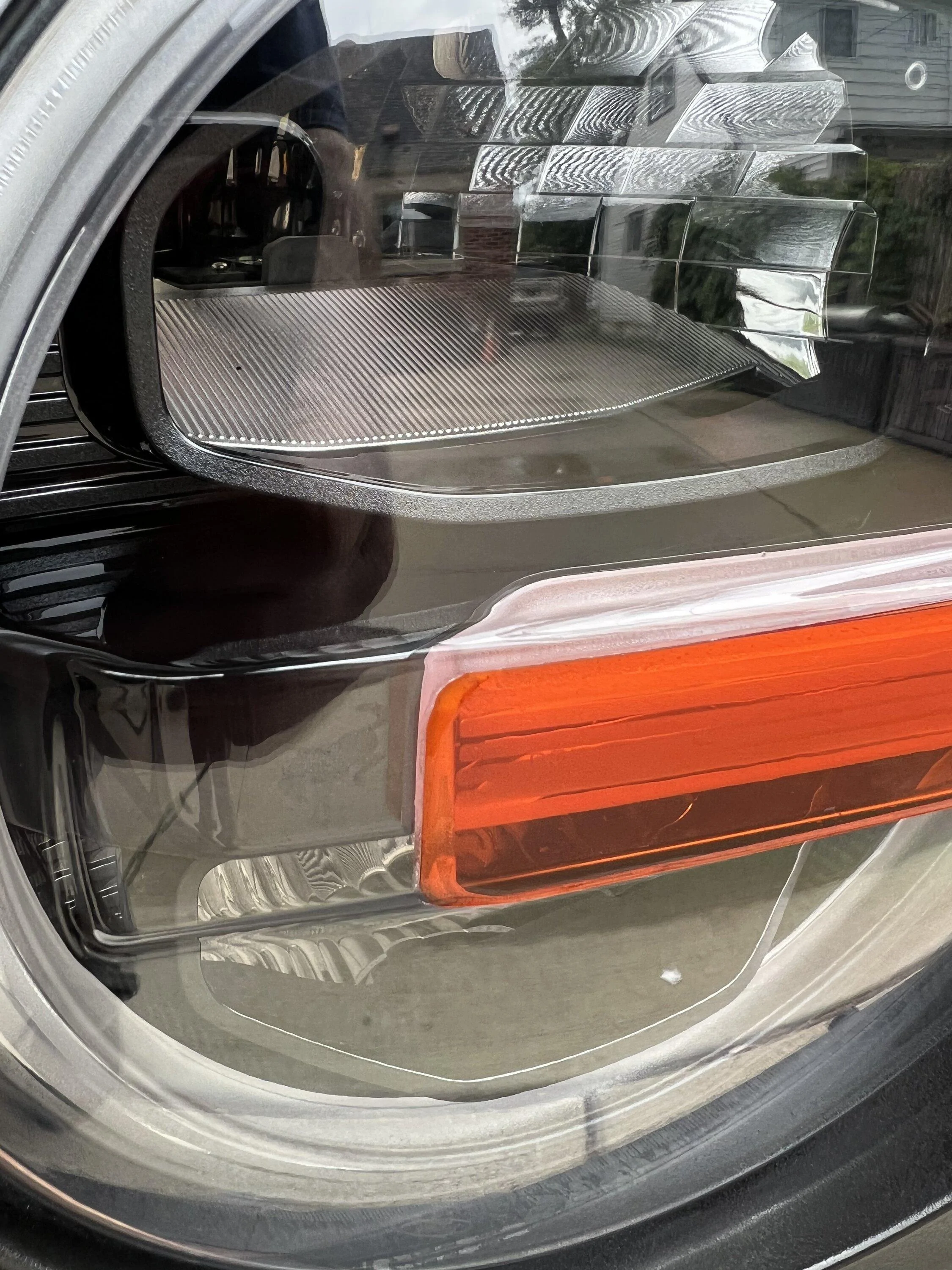

I had forgot to take a pic for the headlights, but this is what they look like after a couple coats of 2.
