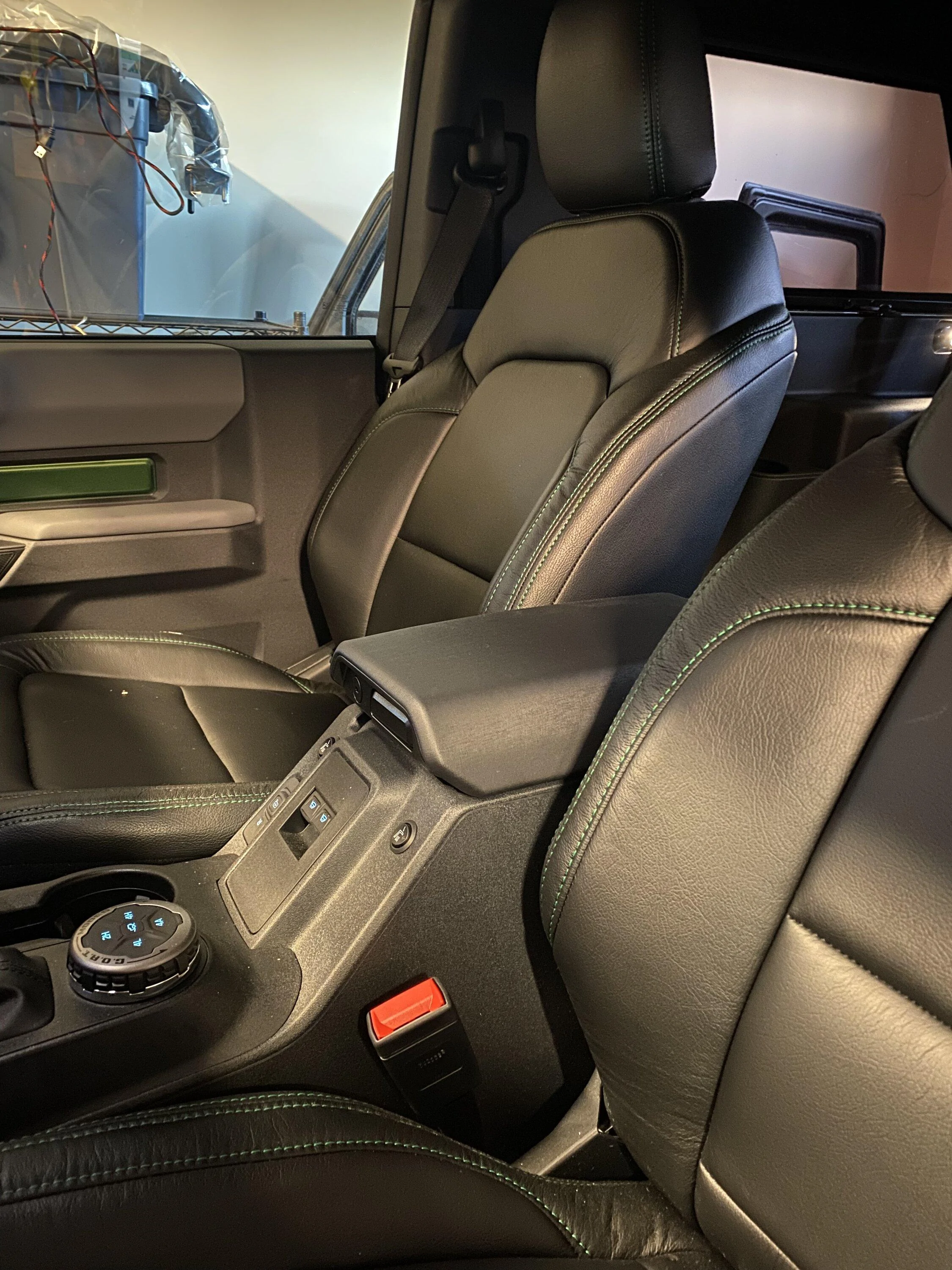

FWIW, I went with Mabett seat covers and stuck aftermarket amazon heated seat kit onto the MGV of my Black Diamond, under the covers. Put the switches in the same place as the guy further up the thread and tapped into fuse #2 with an add a fuse tap and a 10 amp fuse.
I used #2 because it is off with ignition. Could use #3 if you want to be able to have them on all the time...but i figured i would eventually leave them on and come out to a dead battery.

You can actually pry out..a little, the lower edge of the ctr console all the way back most of the way until there is a clip or something...then sort of tuck the wires in behind. I cut a piece of lamp cord (multi strand 12 ga black sheathing) about 2 feet longer than laying it along side looked like i needed. Popped the window switches out using the orange tool that came with the Mabett seat covers...and was able to fish things where they needed to go. I used add a fuse tap 10 amp in slot 2 i think and zip tied the wire so where it runs across above your knees ( inside the panel where EVERYTHING is sharp edged) so it won't cut itself.

Nope, you are simply tapping off the hot side....kinda like making a splitter. You still maintain the integrity of the circuit, you're just drawing off to another fuse.
