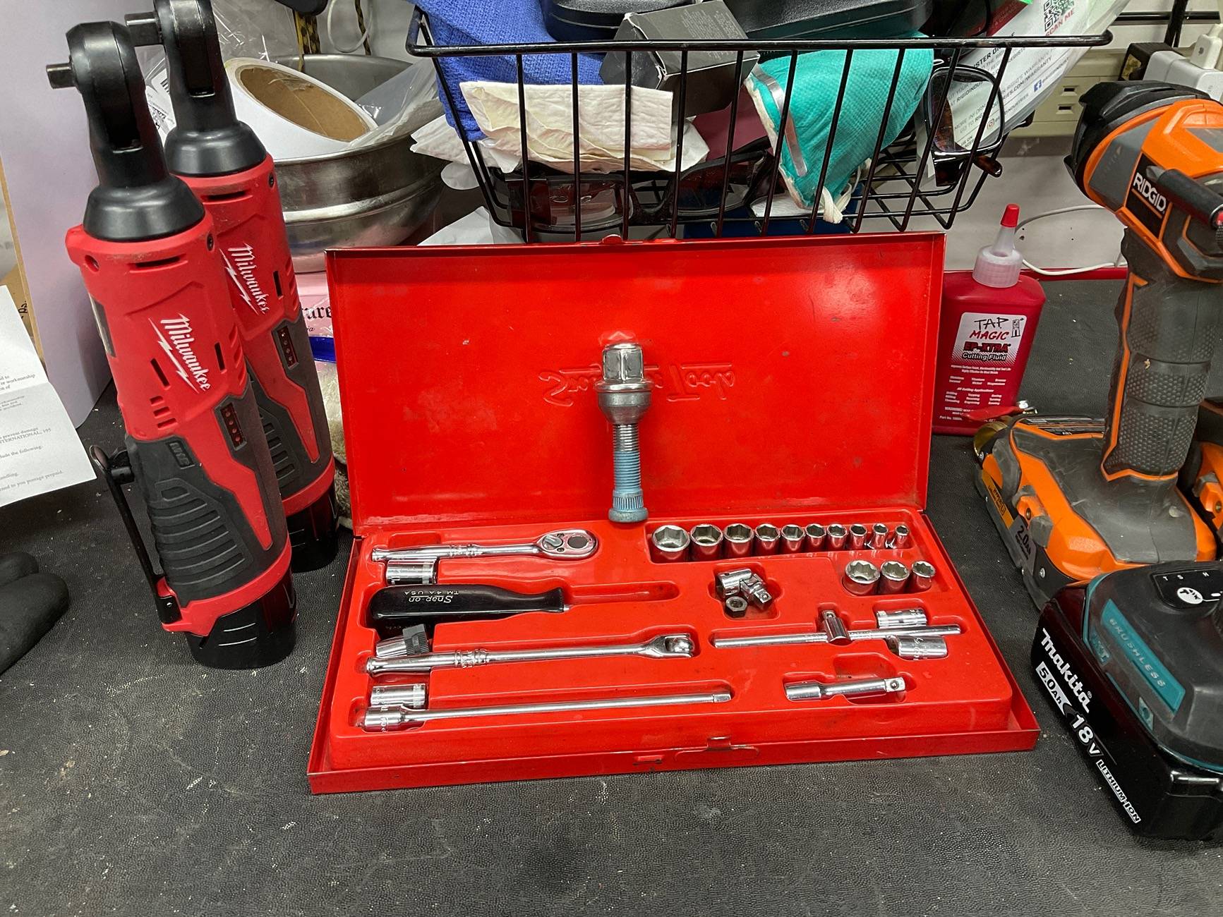

I recently performed the 5000-mile rotation of the tires on my 2023 Raptor, purchased new in April 2024 with 17 miles on the odometer.
I couldn’t remove one of the driver side, rear lug nuts.
I had to use my impact tool and had trouble even using the impact wrench.
I found that the difficult nut was crossed threaded, most likely at the factory.
I ordered a replacement lug nut stud online and replaced the damaged stud and lug nut Yesterday, 12/05/2024.
I feel fortunate in a sense, that I found this problem in my garage and not out on the trail with a flat, it would have been impossible to remove the wheel without advanced tools.
