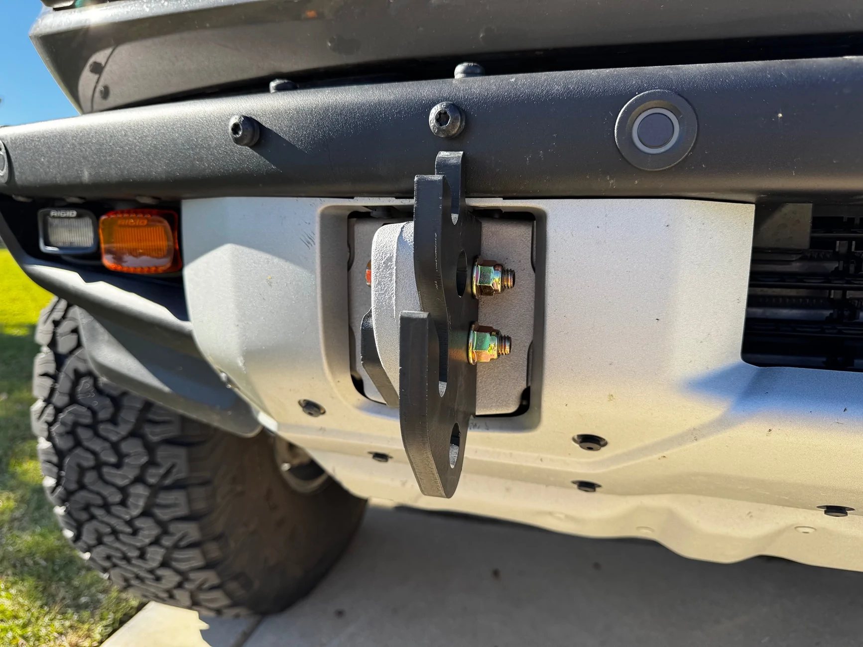

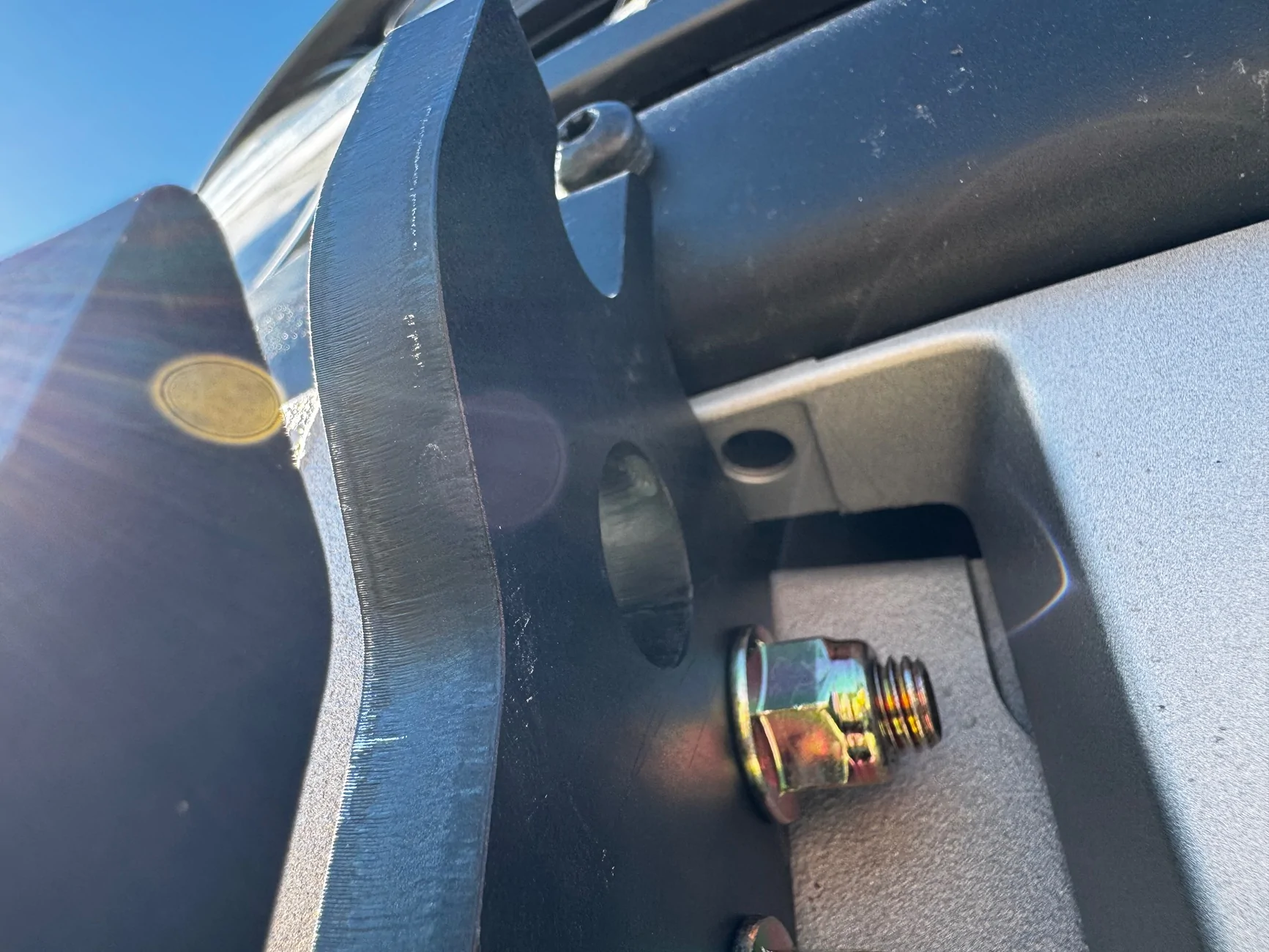

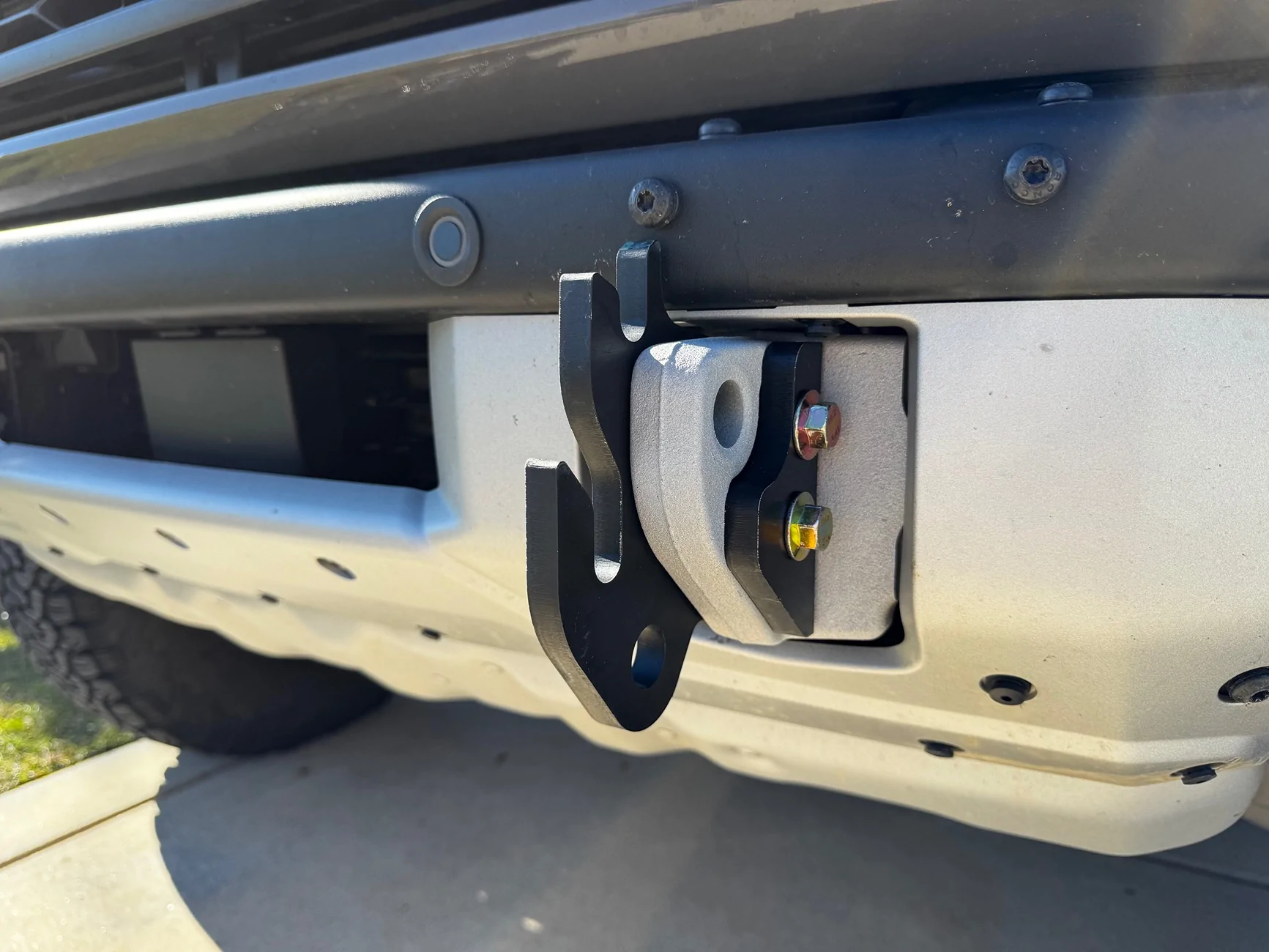

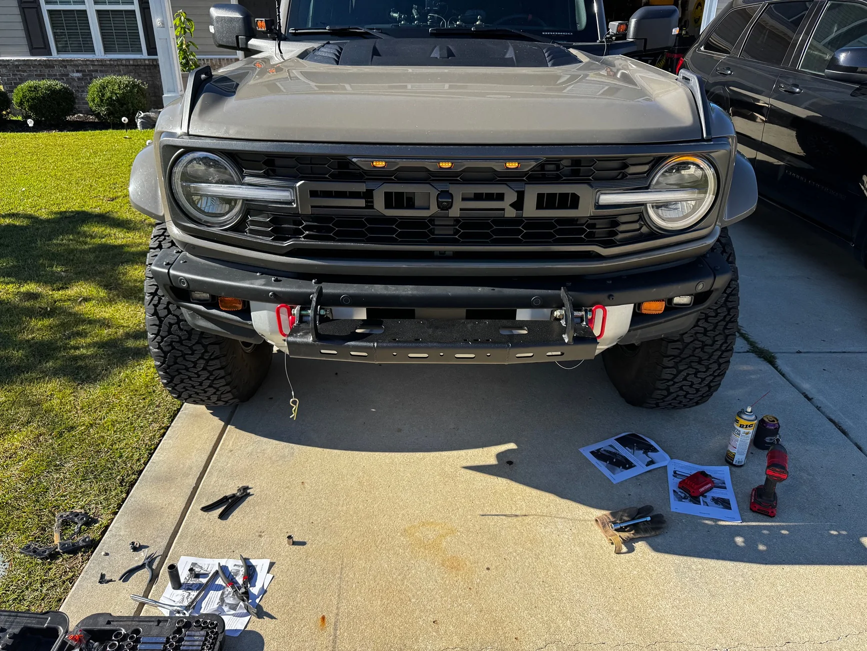

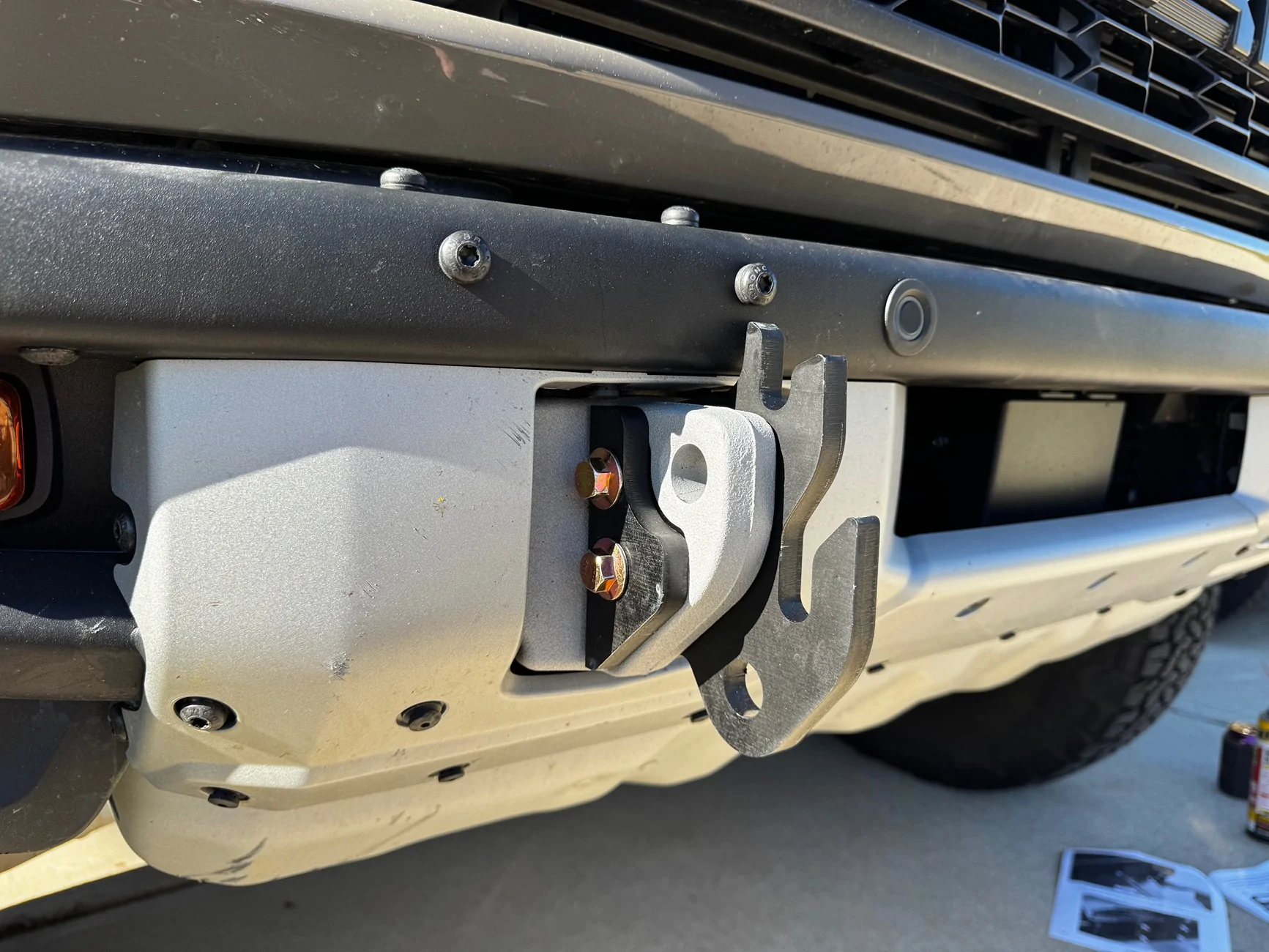

I took the time today to install the @Maximus-3 winch mount saddle with the frame horn reinforcements. The directions that came with the setup are very easy to follow, the only issue I ran into was drilling out the outside holes for the frame horn reinforcements, which was a my drill issue. Now that I killed my drill I will be needing to replace it, but other than that it was a straight forward install. On the Raptor there is a slight difference for removing the trim around the tow points, the directions are for other trim where it is not all one piece, so you will have to pop all of those plastic push pins out ion order to remove it. Side note, if you use your front skid and grind down any of those pins, they are a pain to get off. I used a screwdriver from the backside once I removed the bumper.
Once the reinforcements are mounted and torqued, make sure to put the bumper back on loosely with all 6 bolts, it makes it easier to get them all lined up before torquing them down. Then don't for get to hang the plastic trim piece back in place before starting to mount the saddle plates. You don’t want to put any of the push pins back on yet, you’ll need to be able to bend and manipulate the trim piece to get your torque wrench on the bolts. Once you mount and torque the plates in place, just put the trim back on with the push pins. There are 2 that you will not be able to get back in due to the saddle plates, you’ll see the ones I mean in the pictures.
I meant to take pictures as I went along, but forgot to, the directions are pretty good though and I can answer any questions if someone else needs help.

What kind and size drill bit did you use? And is it only the outside hole that needs to be drilled? I’ve been putting off this install because of the drilling part.

I used a 12.3mm drill bit (31/64 I think), it is a bit for drilling metal from Harbor Freight, just the two outside holes needed to be drilled. The inner frame horn reinforcement bracket bolt went right in. I did use smaller bits to start with, just the 2 sizes down so that it was easier to start each size. It really was an easy job other than my drill failing me.

When you buy the oem winch mount it comes with around 16 heavy duty steel frame reinforcements that are BEHIND the bumper out of sight to handle the loads of a winch, even the tow loops are replaced for stronger ones. How does the mounts that you installed work with winch loads without the Additional reinforcements?
