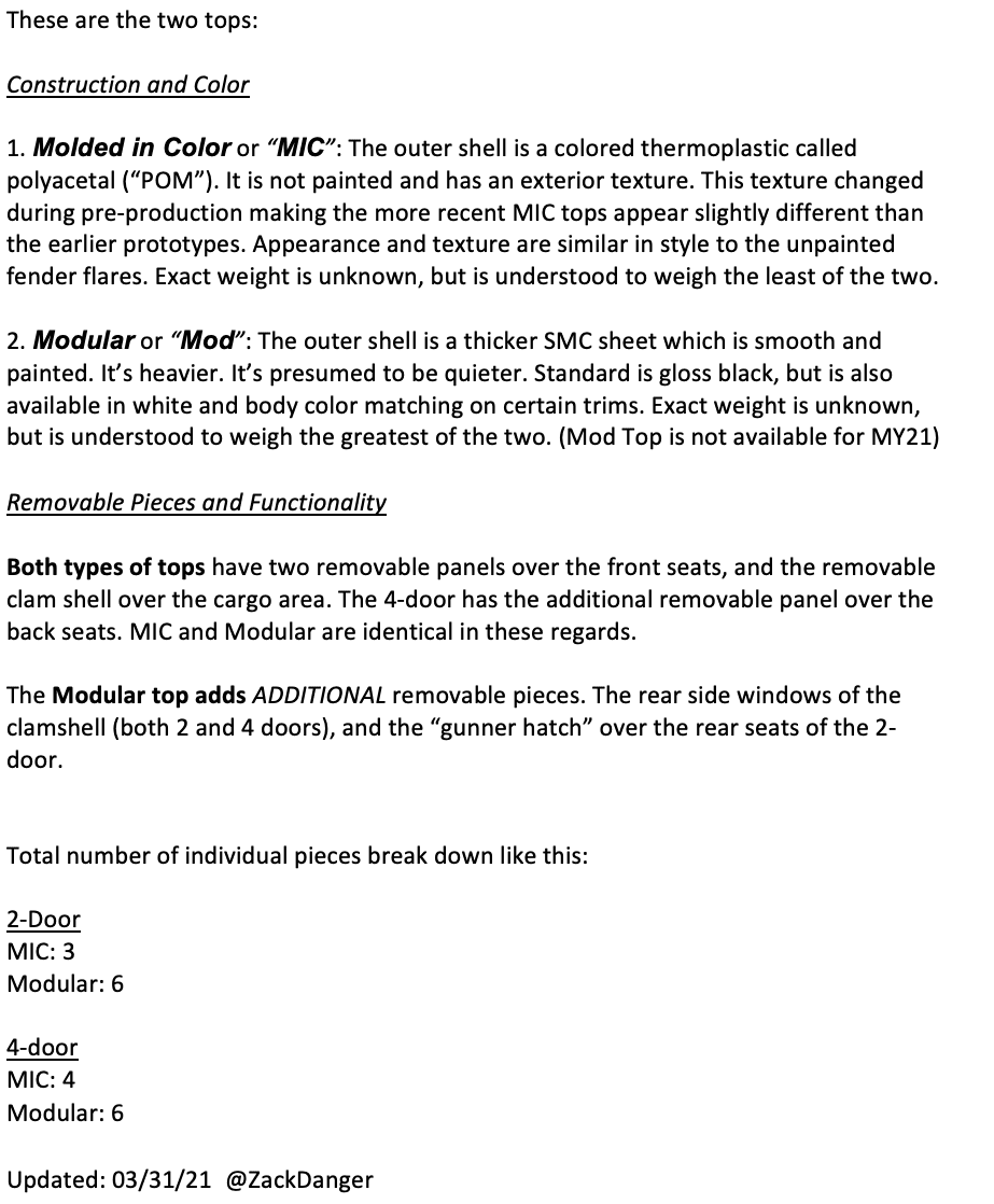

I hate to sound like a moron, but what is the actual difference between the mod versus mic top besides the color? Debating on changing my order.

There is no indication that the MIC and Mod tops have different dimensions. It would stand to reason they are exactly the same in that regard, as they both have to mate up with the same body shell / mounting points.
The *only* difference I could imagine might be a very subtle (mm or so) increase in height if the outer shell is a thicker material.... but practicably they would still be the same.
