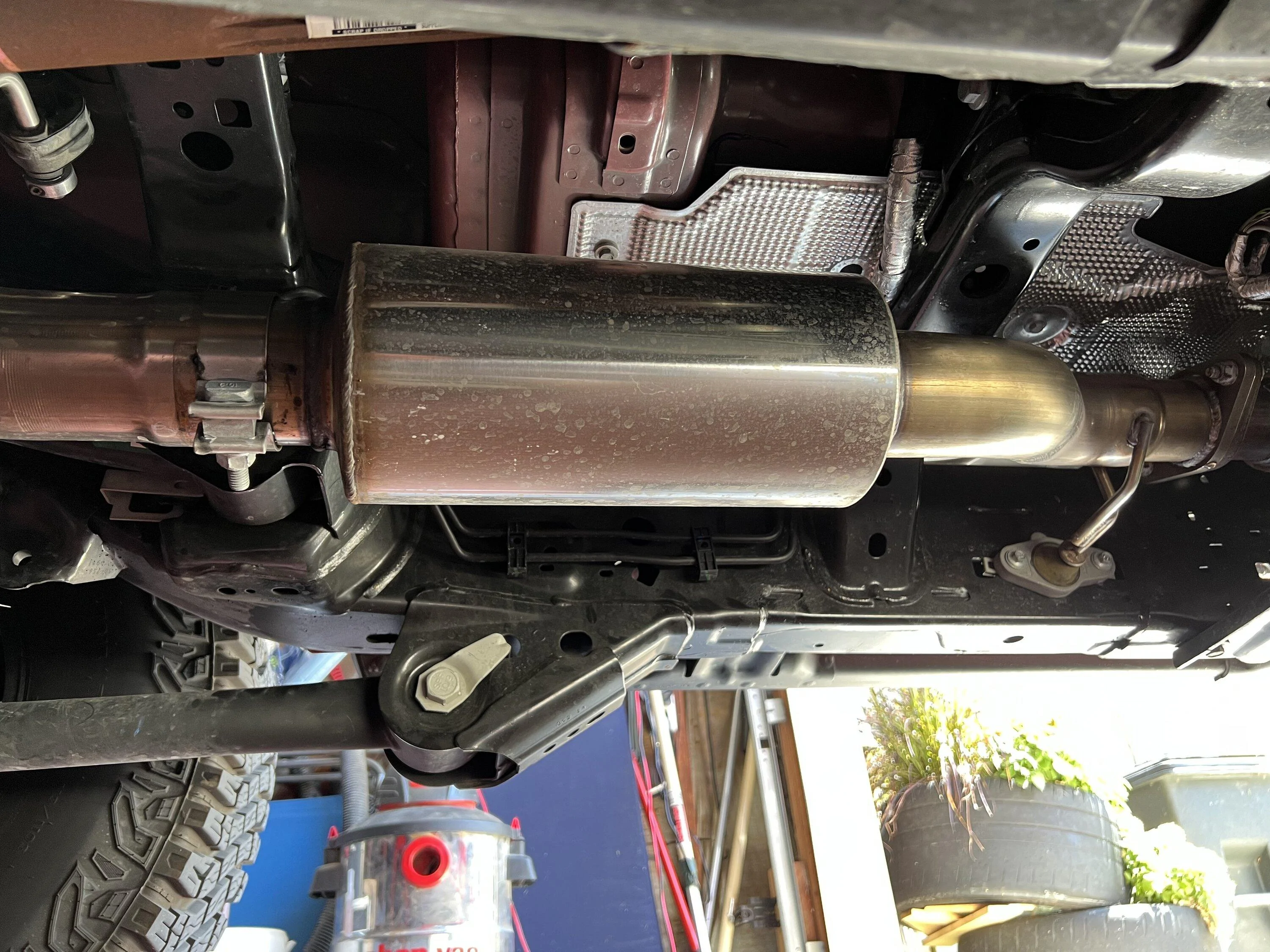

Curious how close the resonator is to the driveshaft as there may be an adjustment issue at hand as it should be splitting the difference between the driveshaft and rear arm evenly. Here is a photo for reference. The flex pipe also doesn't get put into a bind when installed correctly.
