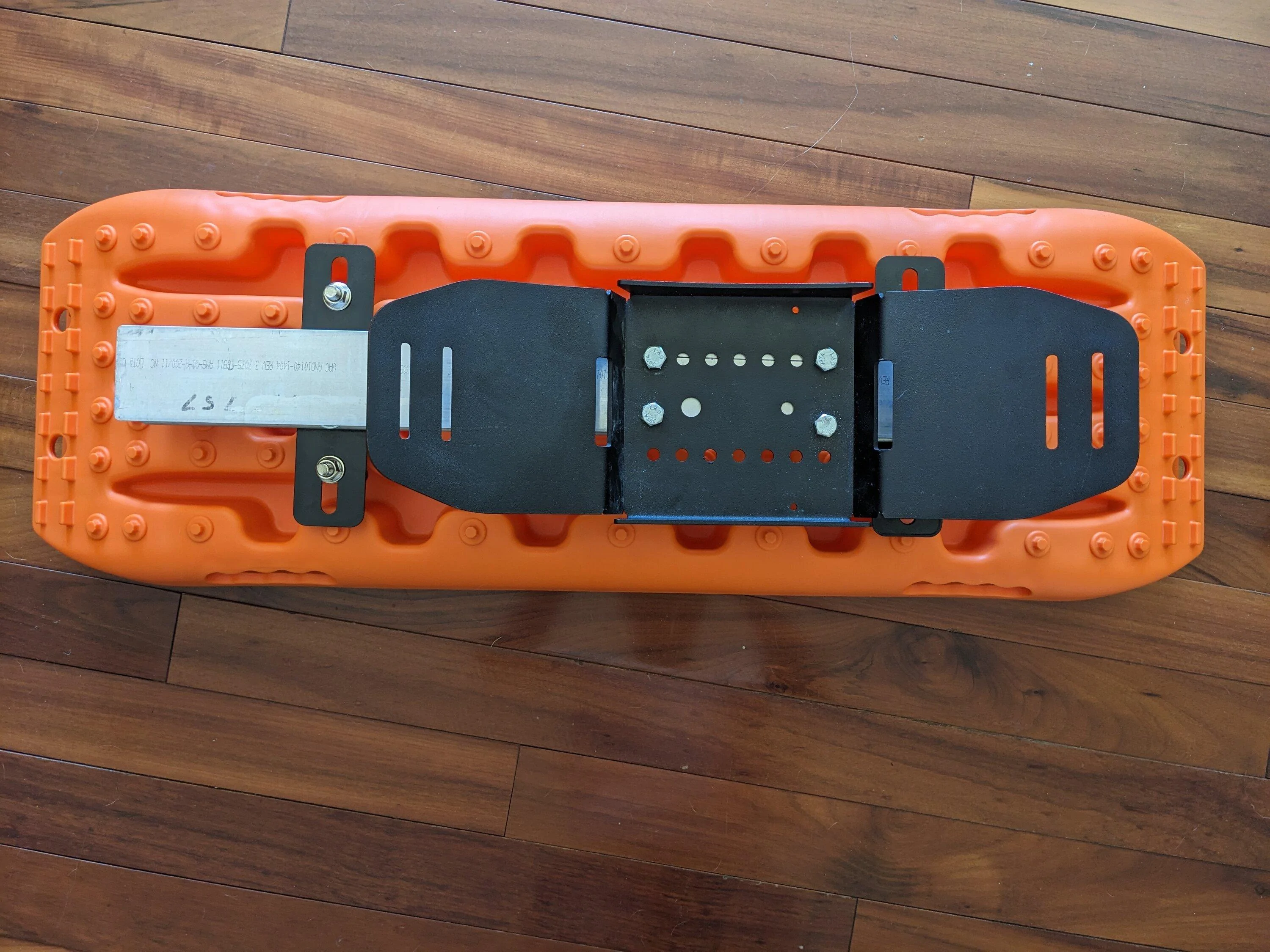

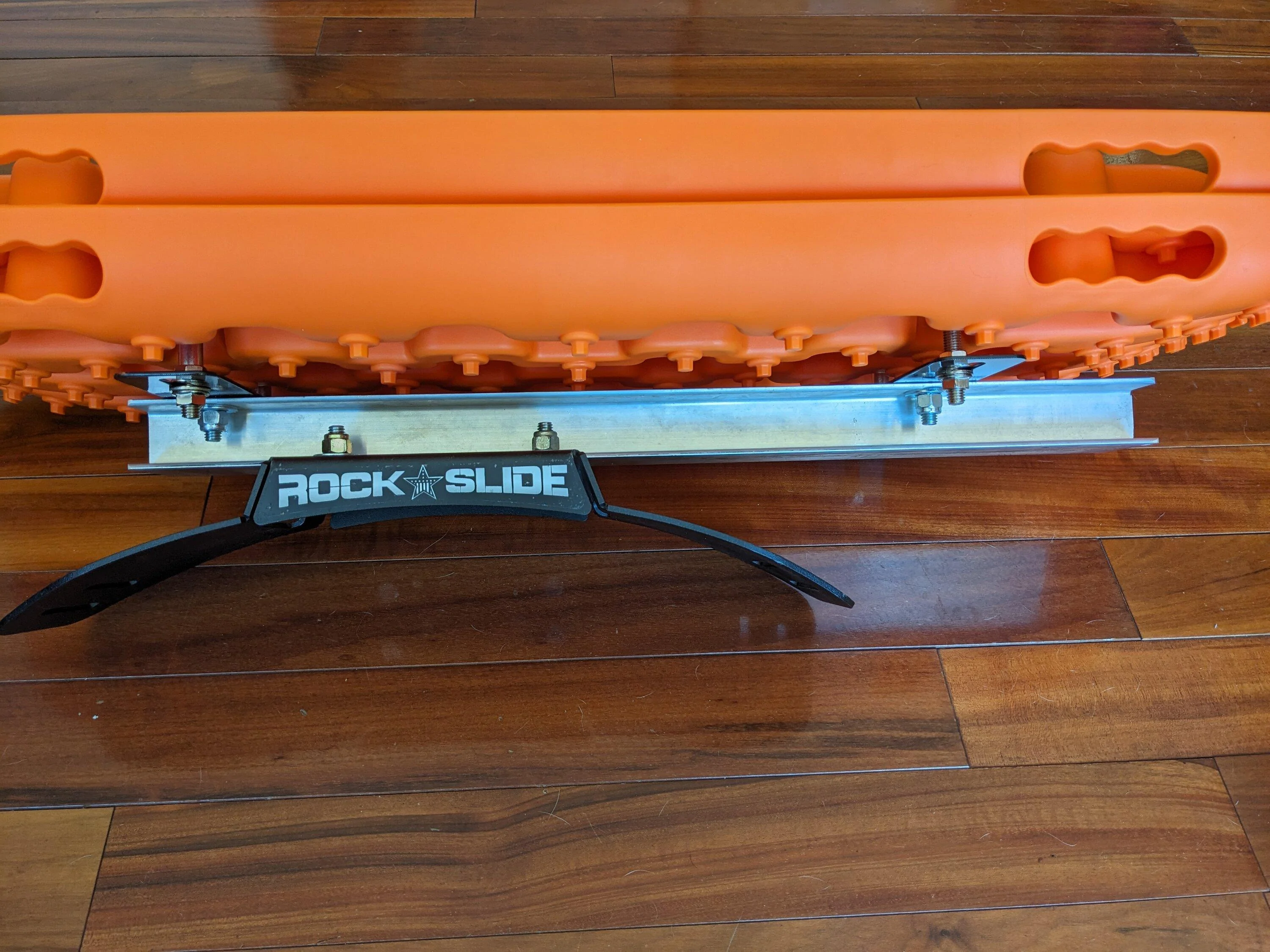

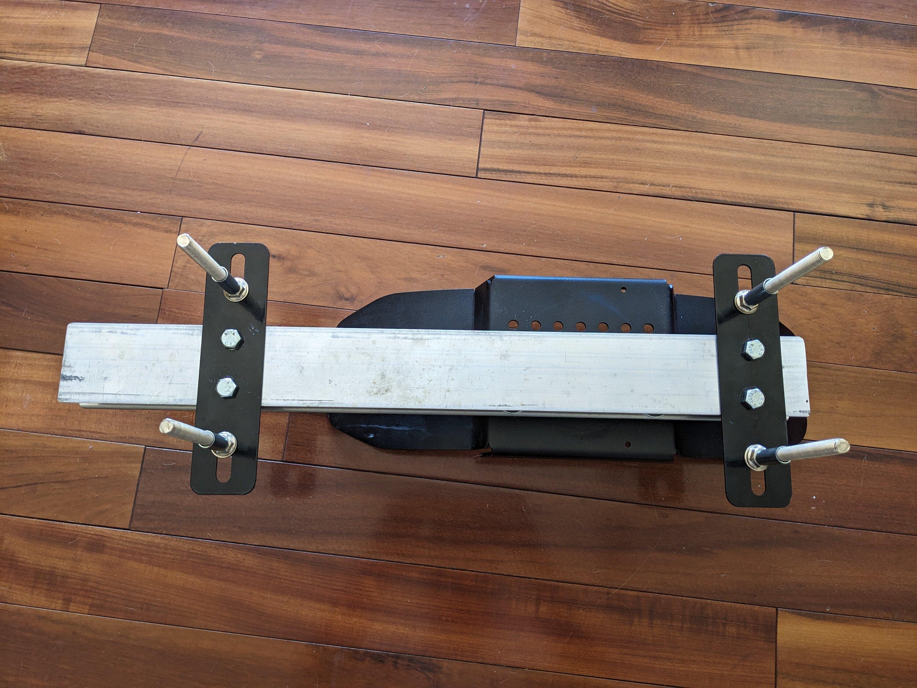

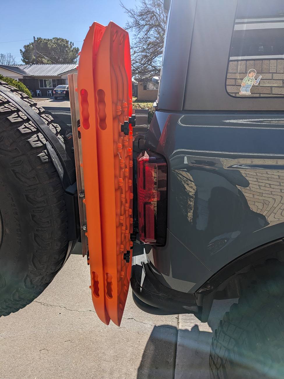

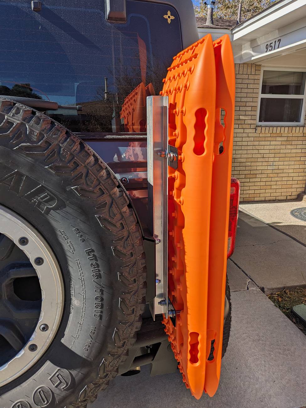

Found some scrap aluminum at work and decided to make a quick and dirty mount for my traction boards. I bought a pair of Rock Slide Engineering spare tire racks from a forum member a few months ago and have been kicking this around in my head for awhile.
All I did was bolt some aluminum I-beam to the rack, then bolted some cheap universal traction board clamps from Amazon to the I-beam. Super easy, just had to drill some holes.
