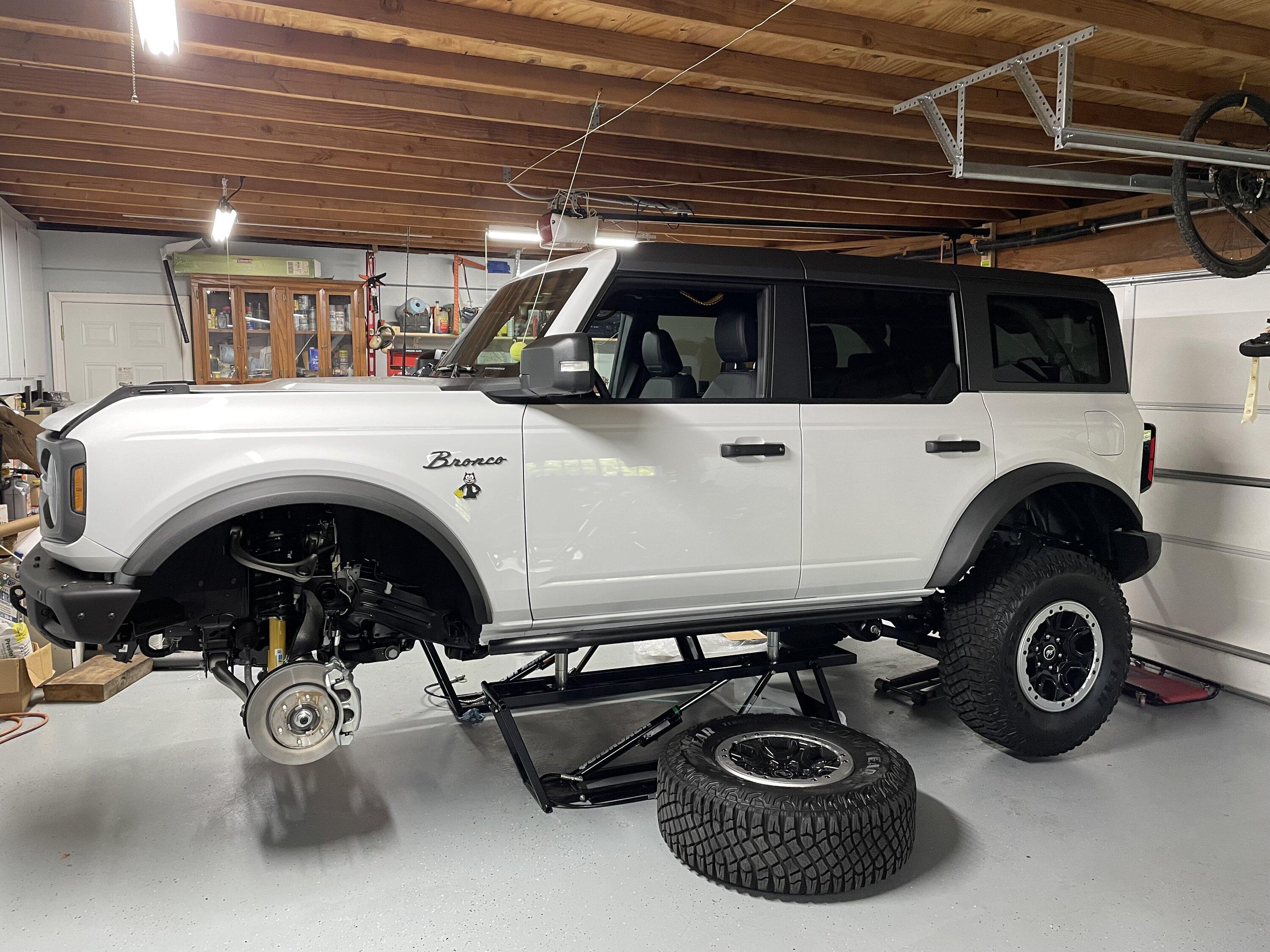

My old 5000 works just fine. The new units raise about 2-3 inches higher. I have the SUV post & it will lift it just enough to clear my 37's (not pictured) It's a good lift. 🤠
I'm just concerned at the Bronco OEM weight is 49XX and with my add-ons, I'll be around 59XX, exceeding QJ5000. I see you have the extra height lifting supports so I'd get those but just unsure if I should sell the 5000 and invest in 7000 or "take a chance"???
Draw your own conclusion. The units all use the same pump.
