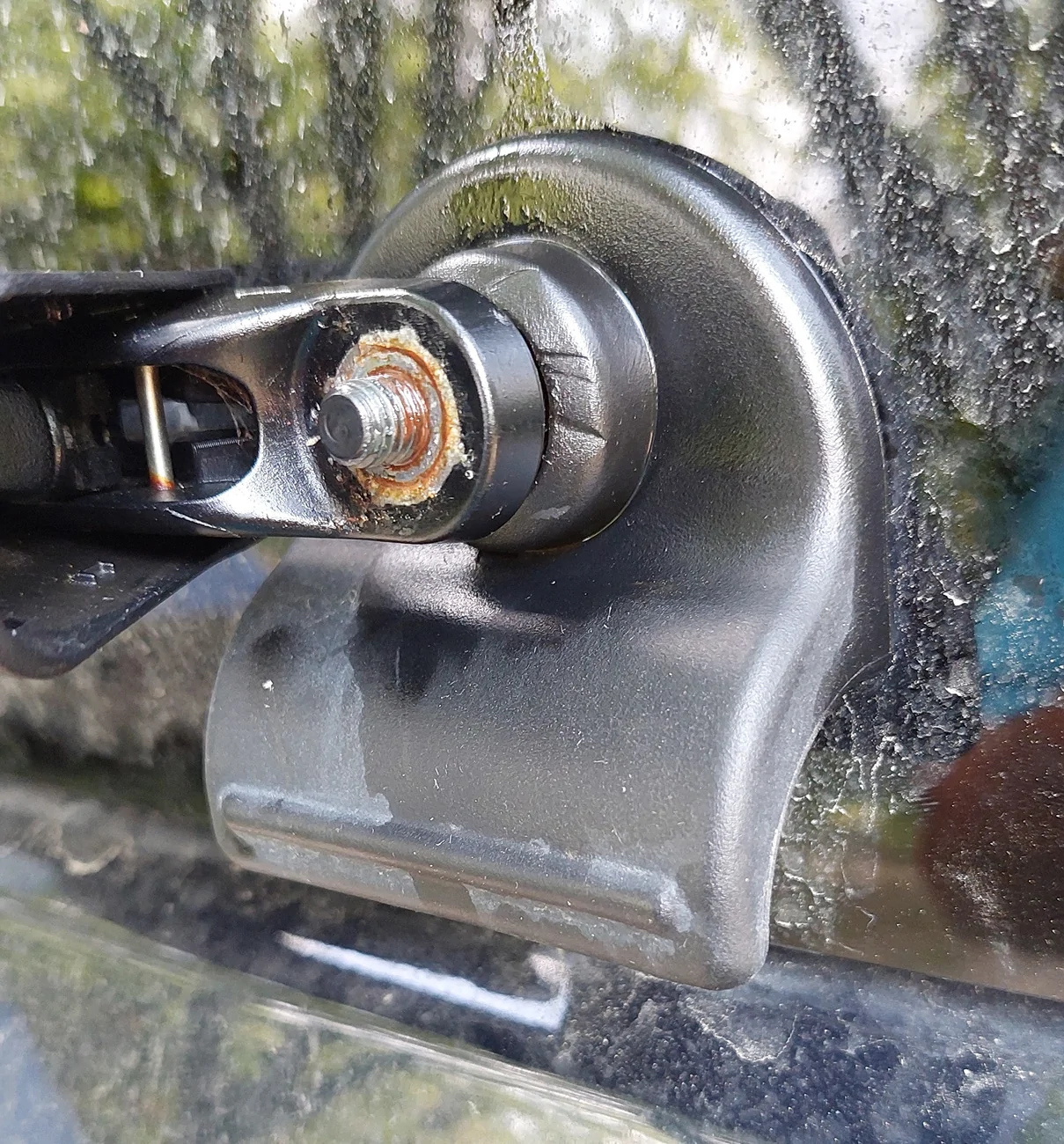

Howdy, My wife has a 2021 Bronco Sport Big Bend and the rear wiper stopped working. If you open the glass on the rear hatch, I can see the motor working, however no wiper. She took it to the dealership and they want $860 to replace the motor - they claim it's binding. But I can't even move the rear wiper manually when the rear hatch glass is open - won't budge. My question is two fold. If I indeed need a new motor, I haven't been able to find one aftermarket - does anyone have a source? $860 for a small motor is NUTS. Also, Is there a trick to get the rear wiper to move manually when the glass is open to see if that's the issue?
Hoping you guys can help!
Tnx,
Jon

If you can see the motor working, then it’s not the motor. You have a seized wiper arm. I would search YouTube for Bronco rear wiper arm removal for a video showing this, so you can remove, clean and lube the arm where it attaches. Unless the arm is cracked, you may be able to repair this with no parts needed.

That's what I'm thinking as well. Just wanted another opinion - thanks!

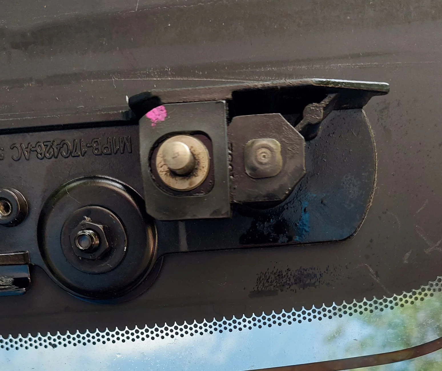

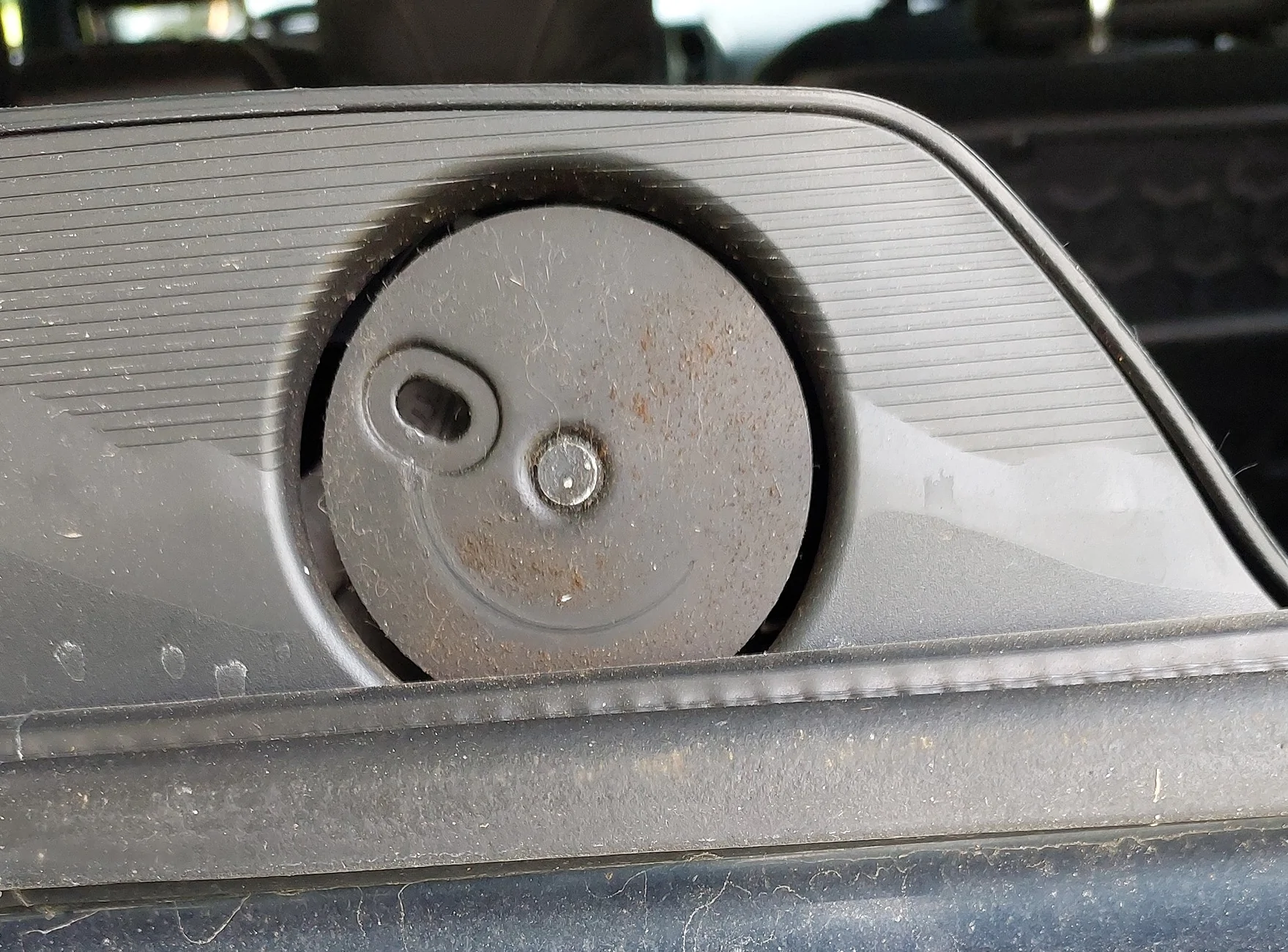

That's not the setup this vehicle has on it. See the pics. The round gizmo is what the motors turns, it goes into the arm assy somehow and moves the wiper. The motor is turning just fine, wiper ain't moving at all.

Not originally, he added that later. This problem is mentioned on the Sport forums. Sometimes removing the arm, cleaning and lubing it will resolve the problem.

I didn`t think I read it wrong , glad to see you changed it to Sport. That first picture you can see a mark where the pin has come out of the hole,so if it still doesn`t turn with the motor off the hatch you need a M1PZ17C426A --or try to free it up and it probably seizes again.
