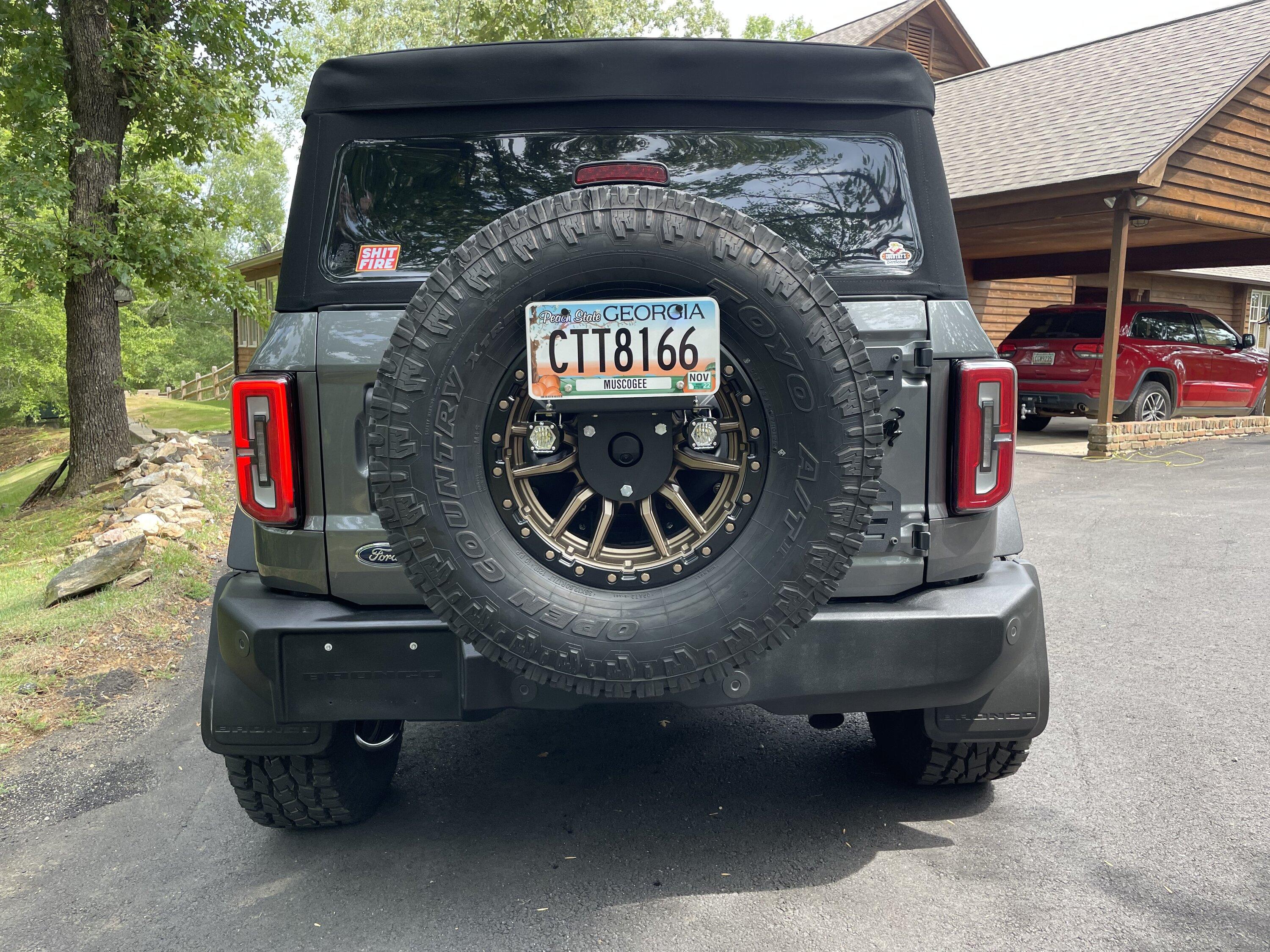

Anybody else have the RTR rear bumper installed? I had it installed but ever since I got it it makes the sensors hyper sensitive because they’re slightly more angled towards the ground compared to stock. Their product shows it retains those sensors but i guess jt doesn’t technically say it “retains functionality.” I love the bumper look but just want to see if anyone else has had this issue with this particular bumper. Photo is just for fun 🤷🏼‍♂️

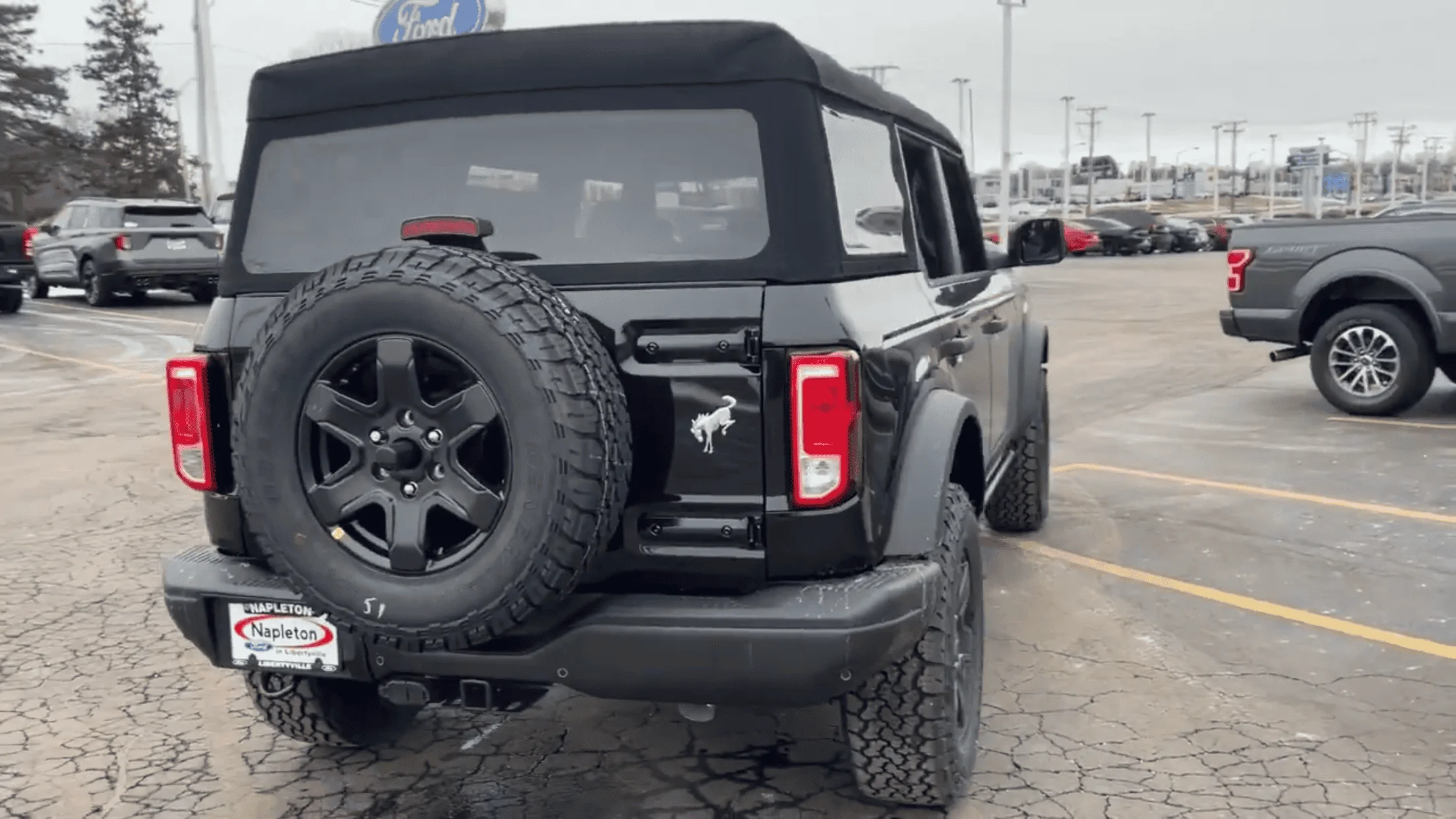

So I think either Ford tweaked the rear bumper at some point or the sensor location changes based on what edition you have. Mine is a 22 Big Bend and this photo on another thread is a 22 Black Diamond. Sensor is in a different location compared to my stock rear bumper and has different angled retainers. You can see mine are just flushed washer looking things.🤔 So trick is where to find these retainers. That’ll probably help my issue.

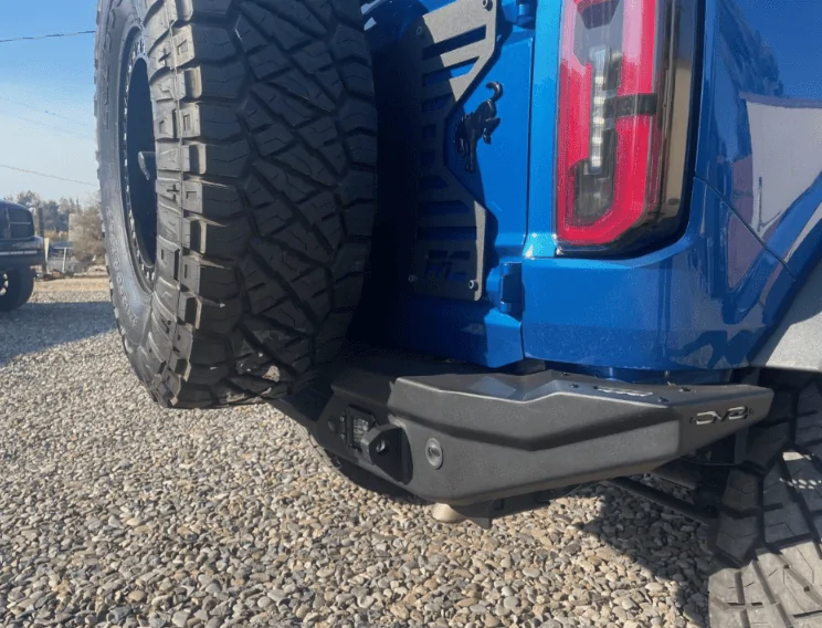

I have a DV8 FS-15 rear bumper that had similar issue. I reused the stock sensor flanges and those angled the sensors down too much. The cracks in my driveway would trigger the warning. I pulled the stock bezels and found some rubber grommets I had that fit the opening so I trimmed the inside to fit the sensor.
Now my bezels point straight back and operate the way they did with the stock bumper.

My stock bezels were angled. And the only way the lined up and fit into the bumper pointed them down. Once I removed those and put the grommets in there it stopped being so crazy.
Found a pic of the bumper right after I installed it. You can see the bezels are angled and aim the sensor too low
