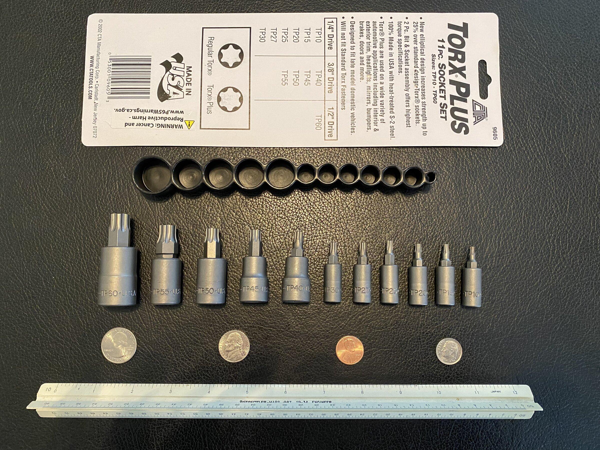

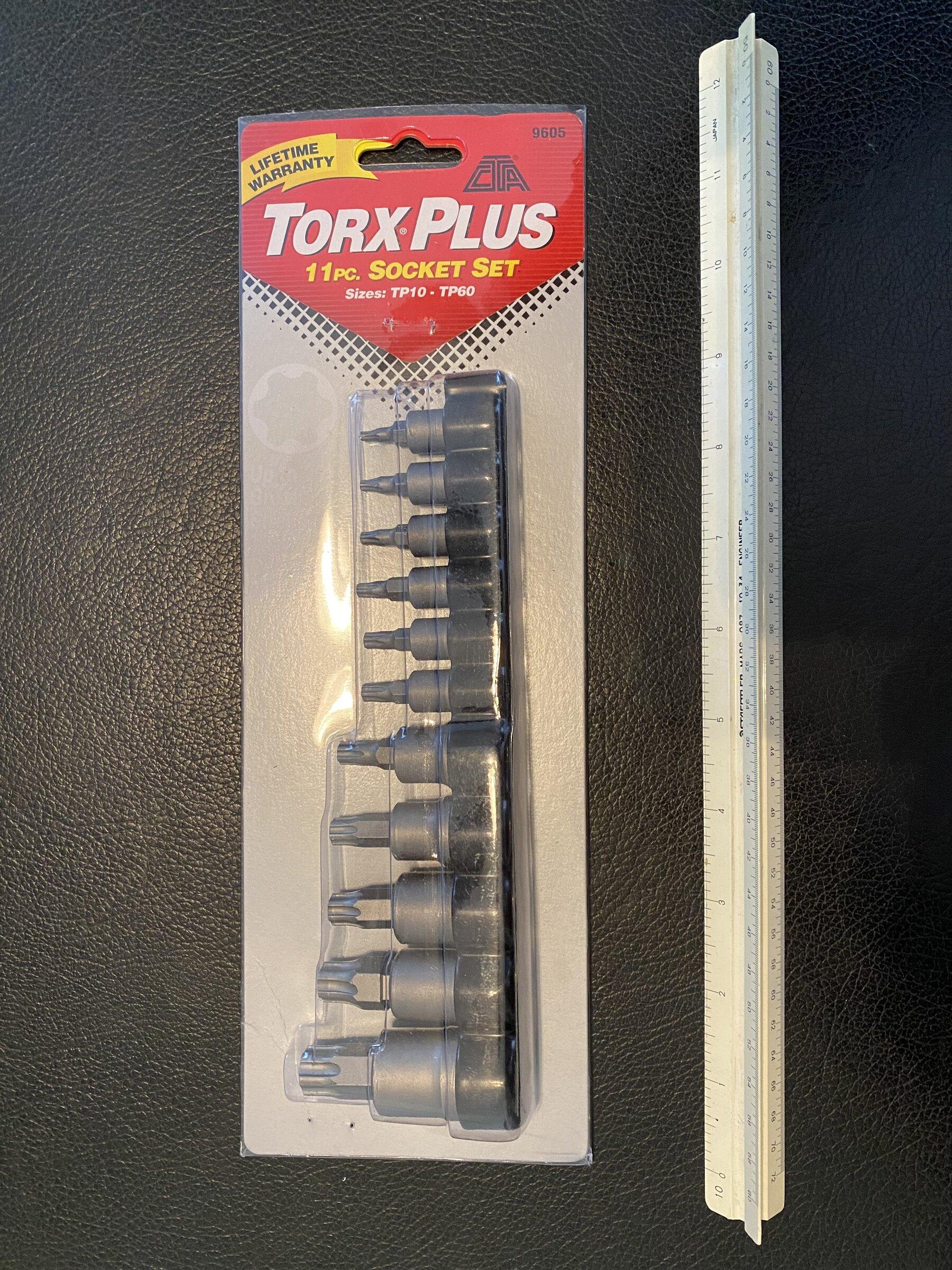

This is the Torx Plus set that I ordered, and I’m very happy with it…
https://www.amazon.com/gp/product/B005OH0MES
Unfortunately, it’s not currently available on the original Amazon link.
Ford Bronco Torx Plus bits not working on modular bumper A21D66BF-A7AA-4B93-89B2-9ABA1BF140BE
Ford Bronco Torx Plus bits not working on modular bumper E5F730AE-FCB6-413E-BCDE-AD339AD502F5

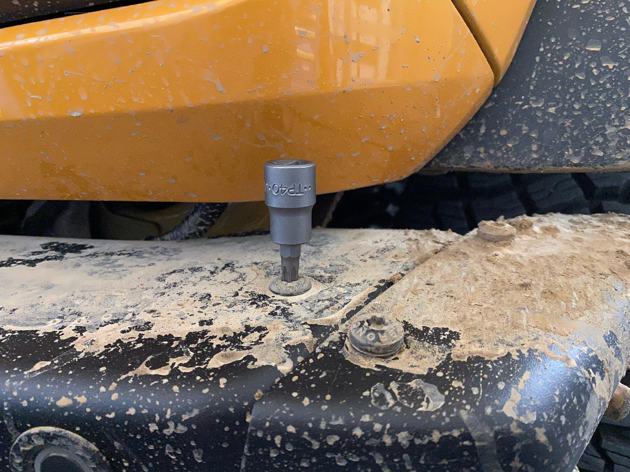

FWIW, the TP40 bit fits perfectly in the Bronco bolts on the Heavy Duty Modular Front Bumper with no slop. (y)
Ford Bronco Torx Plus bits not working on modular bumper 2EA22B91-13E2-46B0-BCB6-0AFAB8E44C47
PS - The regular Torx set I ordered is also made by CTA Tools, right here in the good ole USA.

The bolts they use are pure garbage. You have to make sure the tool is perfectly square and the driver still cams out of the fastener if you're not super careful. I think I'm going to start replacing them all with regular hex head bolts!

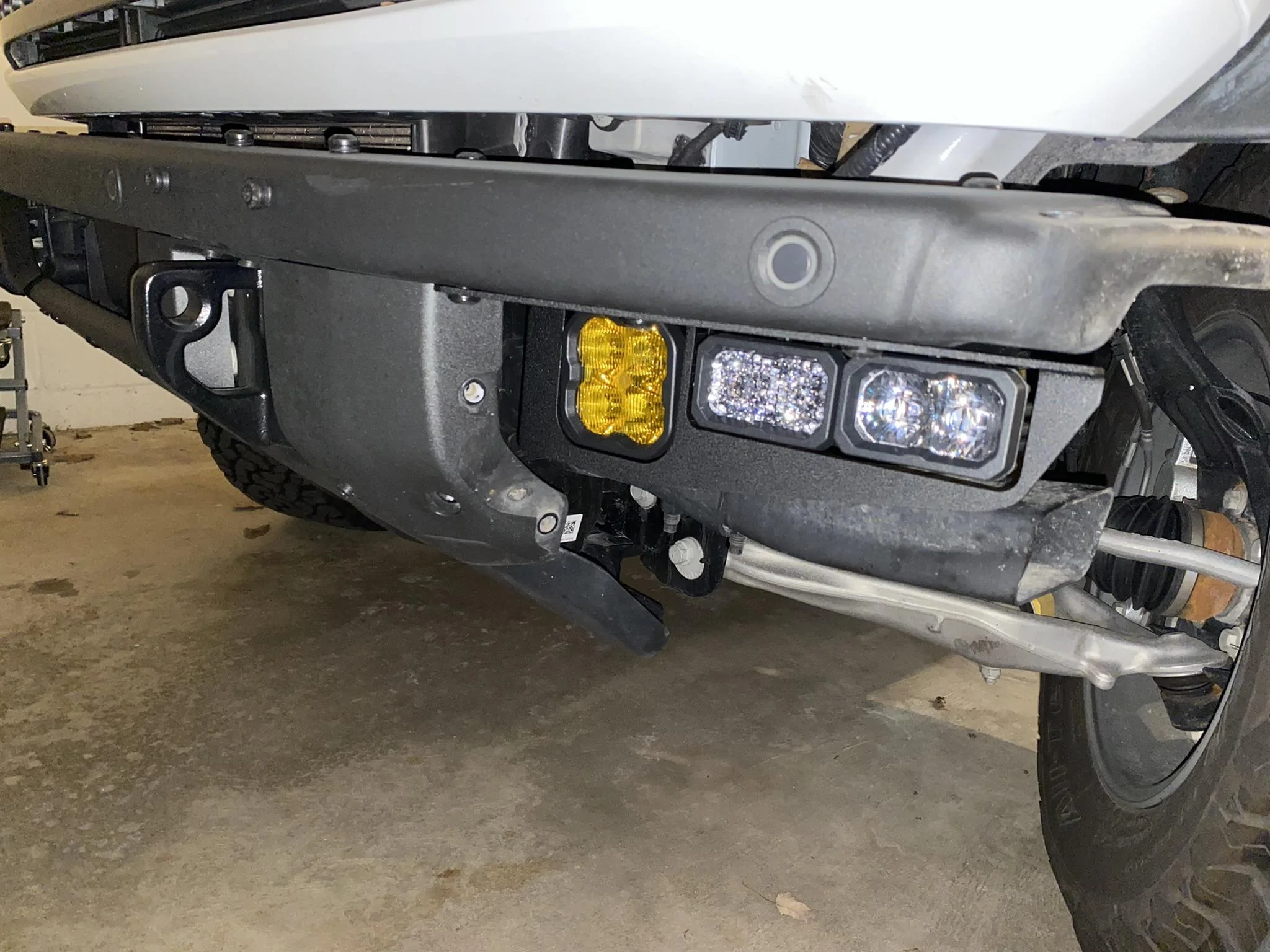

What lights are those?
Agreed! It was the last one of the six bolts and just went a little too fast at it without the bit seated perfect, apparently.
the lights are Diode Dynamics SAE SS3 fogs -pro and the SS2 floods and driving. The kit is the KR from 4’x4’ Truck LED’s who I purchased the whole package from. Smooth transaction.
I’ll post up once they’re working 🤣.

I ordered the 6pt. Torx plus and still stripped out a head last night using #40. The bolts where these fog kits attach to on the modular bumper are soft and very easily stripped.
