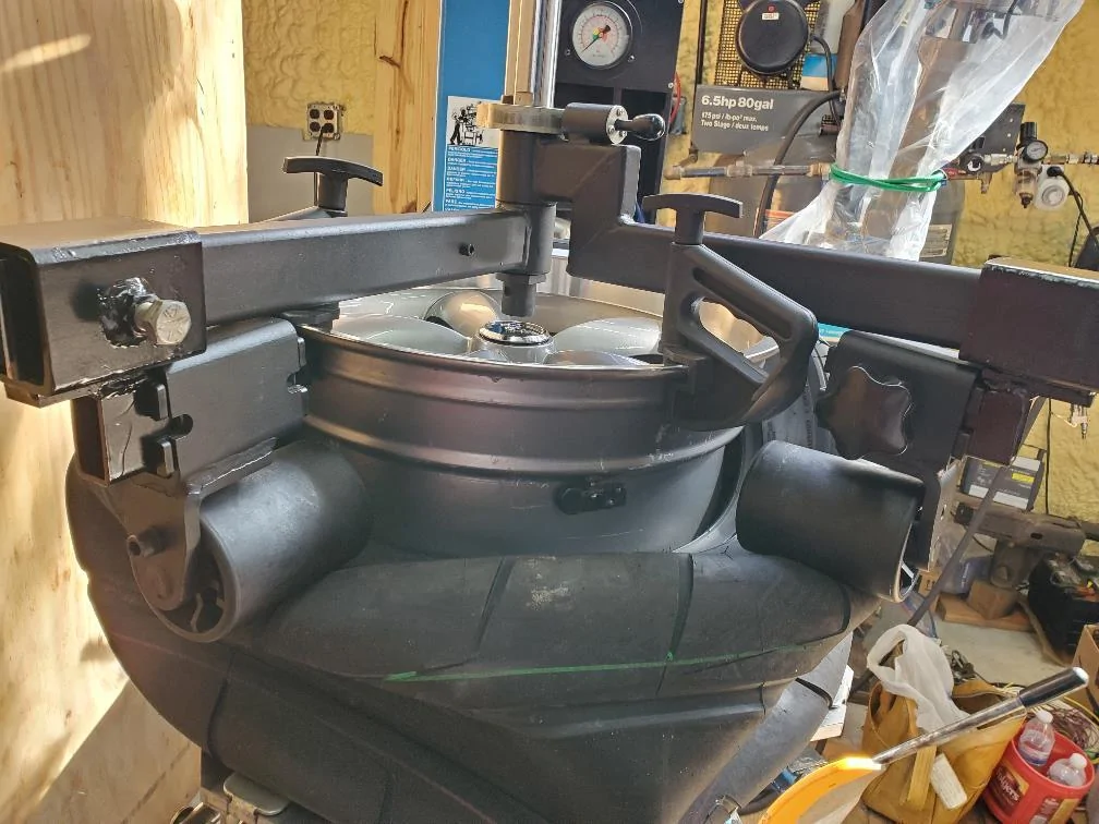

A "good" shop can get sensors out (or swap them) without even removing inner bead. No need to rebalance really (unless you are leaving sensors out, permanently).
Just need a double bead ram/roller setup like this. This wheel is an extreme example, as it is an old school deep dish Bullitt. But can still easily get to sensor, without removing tire or rotating it on the rim (to require re-balancing).
MUCH easier even, on offroad tires with big sidewalls.

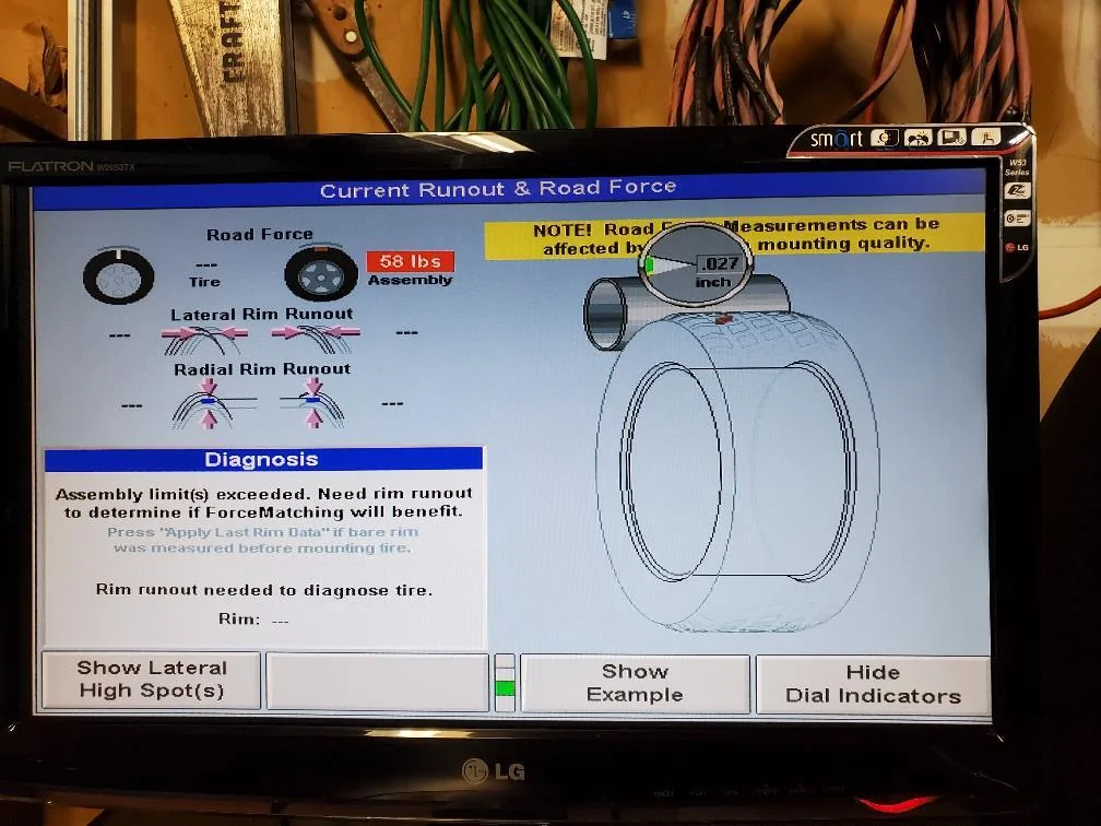

Ford Bronco TPMS sensor questions 20230709_170217
My new F250 though, vibrated like crazy right off the lot, with two of the tires "Road Forcing" @ 58 and 62 lbf.

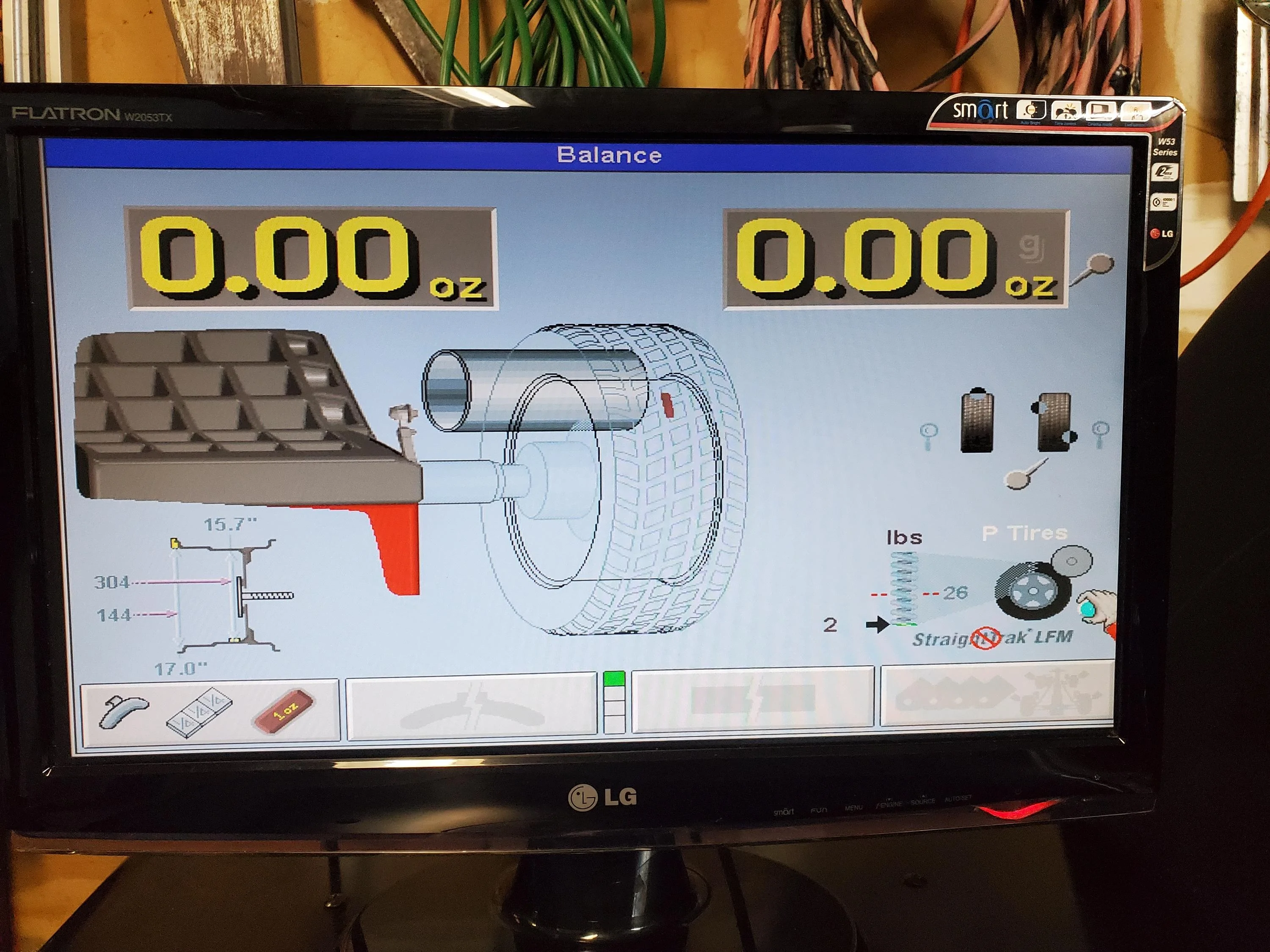

Ford Bronco TPMS sensor questions 20230712_203205
Ford said their limit for the rear tires on a new F250 was 45 lbf (which they claimed they got them at or below that), but vibrations were not even close to acceptable for me. I ended up buying two tires on my own dime, as Ford would not do any better than those numbers. My final numbers on the 4 tires for this new truck were 7, 11, 17, and 22 lbf. It is 1000 times smoother then the day I picked it up.
