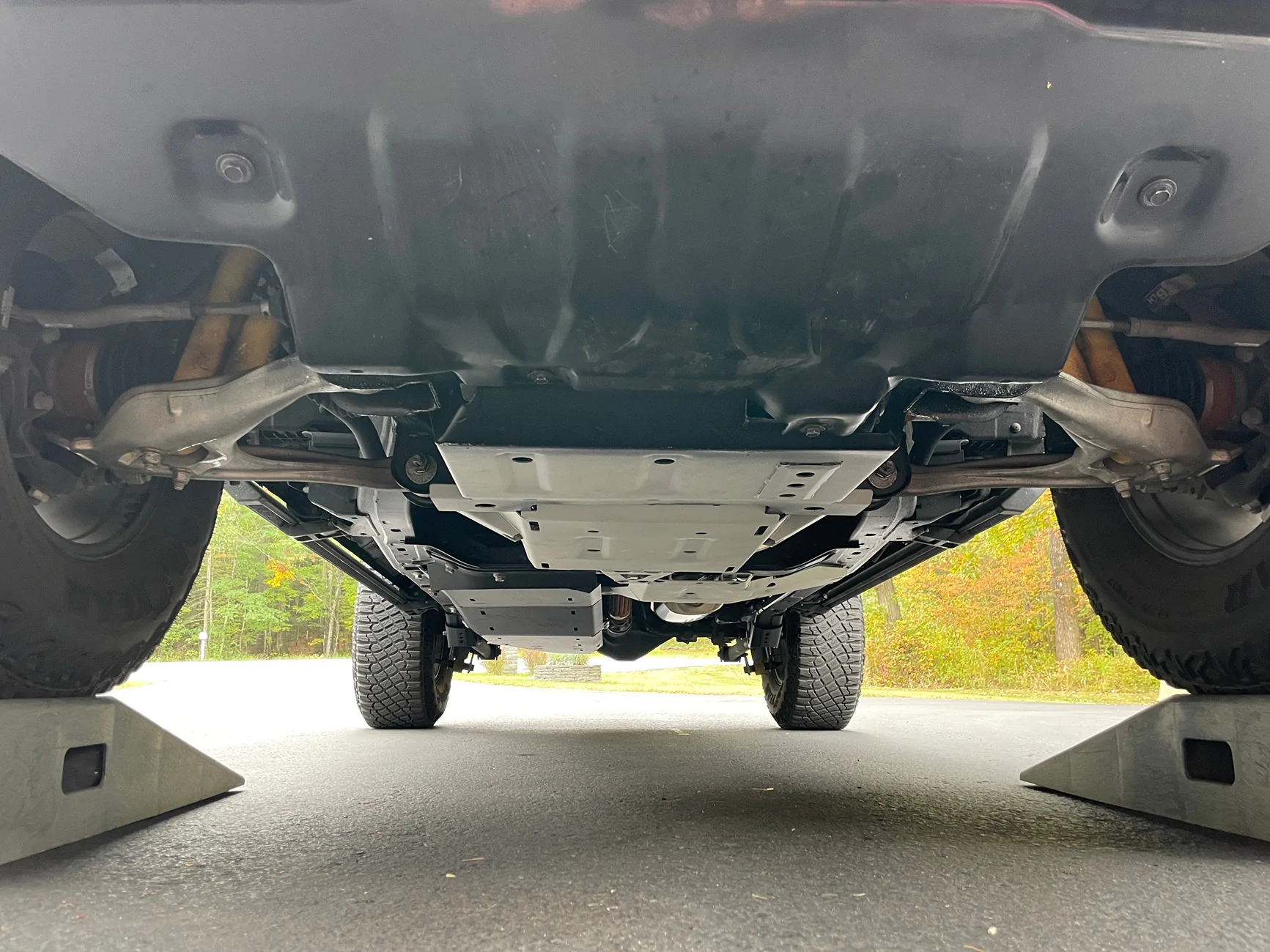

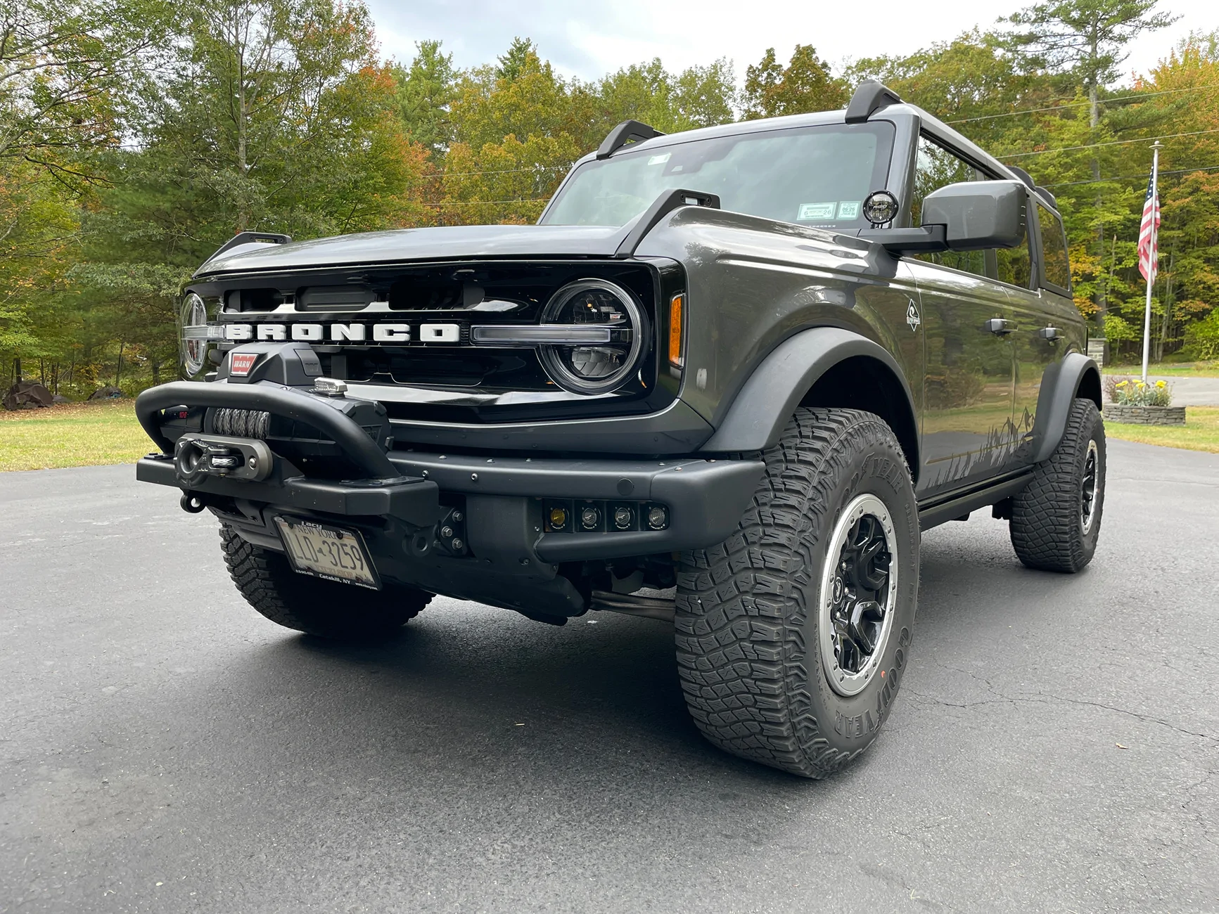

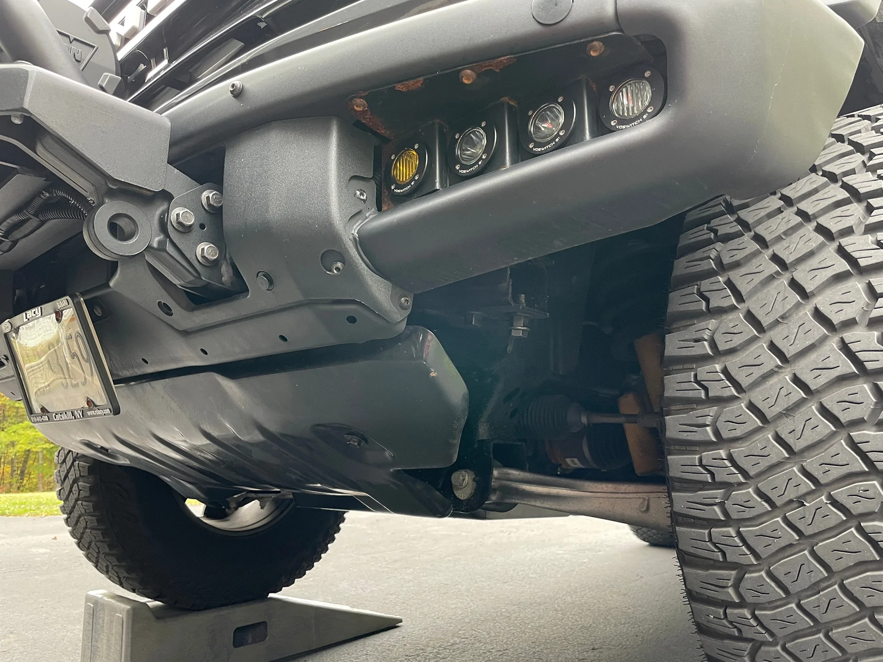

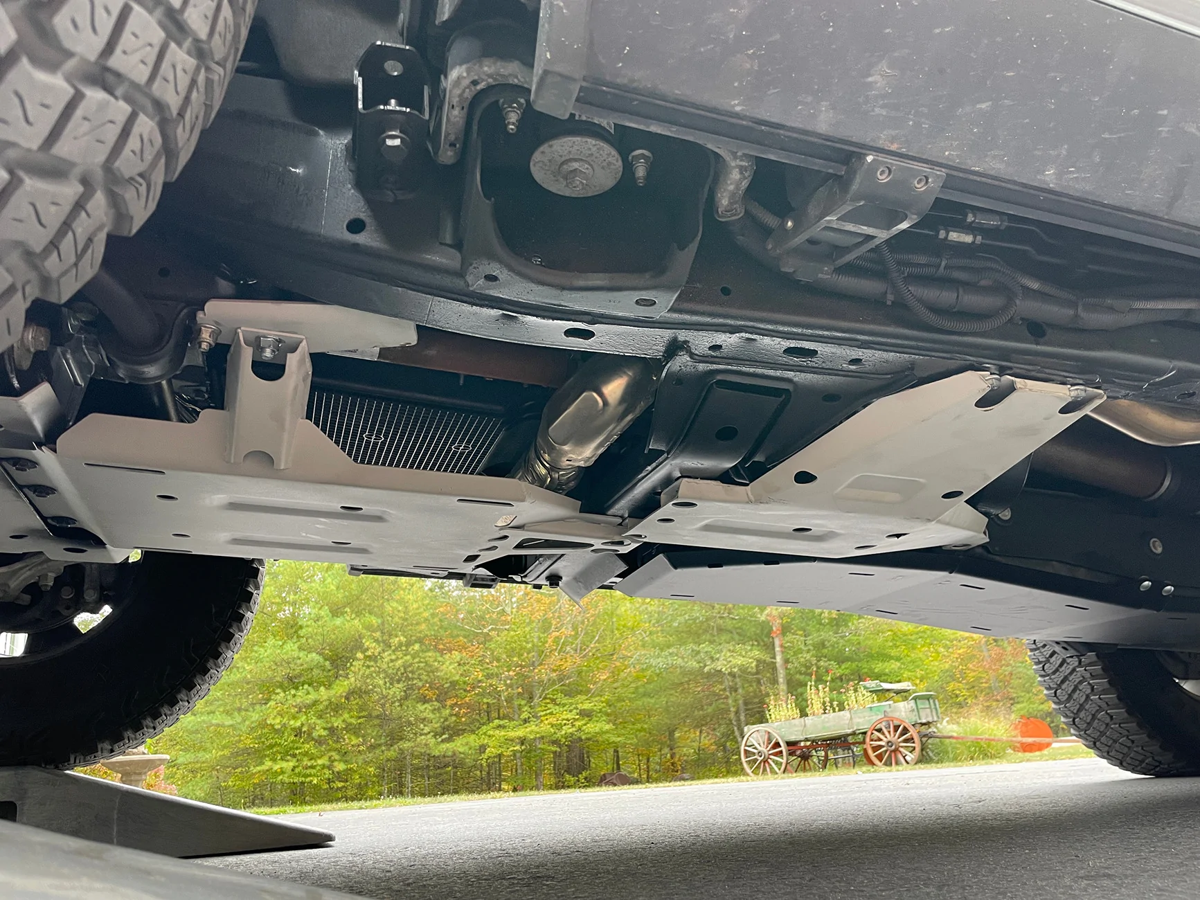

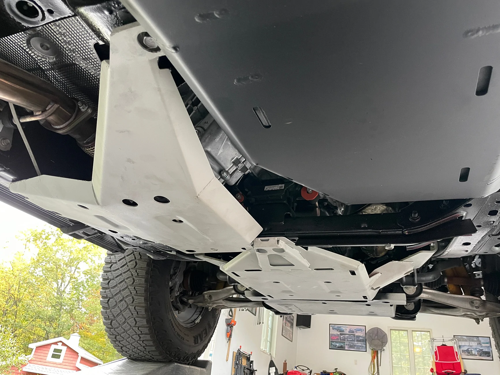

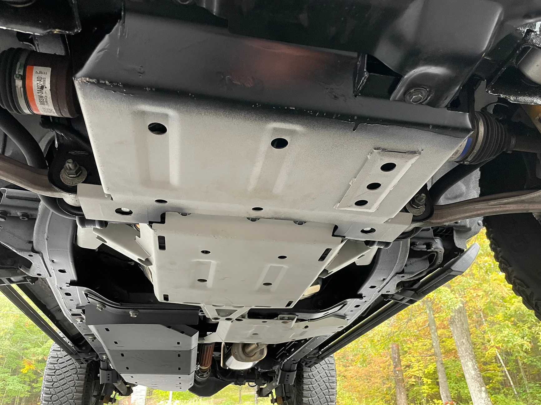

the bumper and bash plate have been installed like a year, not 100% sure ... they are holding up fine, slight rust where i chipped it putting the fog lights in, but otherwise, very good ... the cheap fog lights i put in are rusting more than anything else ... i forgot to say, but you will need to cut off the factory hooks (angle grinder) ... doing this has been talked about in other threads on here when switching from the plastic bumper to modular
i just put the skid plates on about a week ago, so time will tell ... but they were cheap and i fluid film the underside, so have no real concerns honestly
now, all this said, mixing the mis-matched bash plate (amazon) and skid plates (ebay) did require some modifications on the engine plate by cutting of the gussets they have for their bash plate ... wasnt hard, but thought i would let you know

@PoppaPops - yeah, wow - that doesn't look bad at all.
I am curious if you have to cut the factory hooks if going from Capable to Modular as well. I guess I need to do some research on the Capable bumper itself. I am just psyched to have factory fog wiring.
