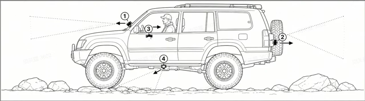

We all know that choosing the perfect spot to mount your dash cam can make a huge difference in the coverage and clarity it provides. Some of you swear by the traditional windshield mount, others find creative spots that work even better for their vehicles.
Now, we want to hear from YOU!
  • Where do you think is the ideal place for a cam if you can put it anywhere you like on your vihecle? And why?
  • Do you have unique placement tips, or lessons learned from trial and error?
  • What factors do you consider when mounting?
Your experiences and tips could help someone out in their dash cam journey. Plus, we may just feature some clever setups in our next post!
Can’t wait to hear what you’ve got to say. Let’s keep innovating together.

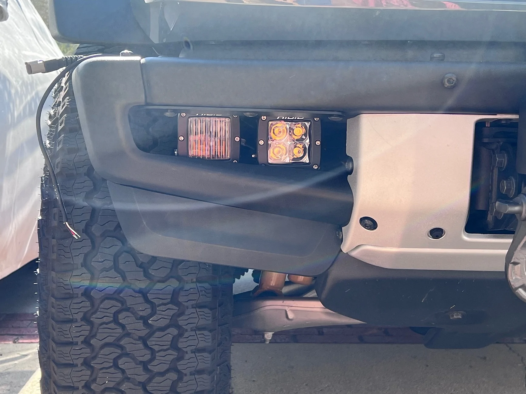

I like your spot 4… maybe more forward pointing rearward.
looking to place one in the front Ford HD bumper in the light pocket corner to have clear visibility forward @ tire (driver or passenger??). I wheel solo

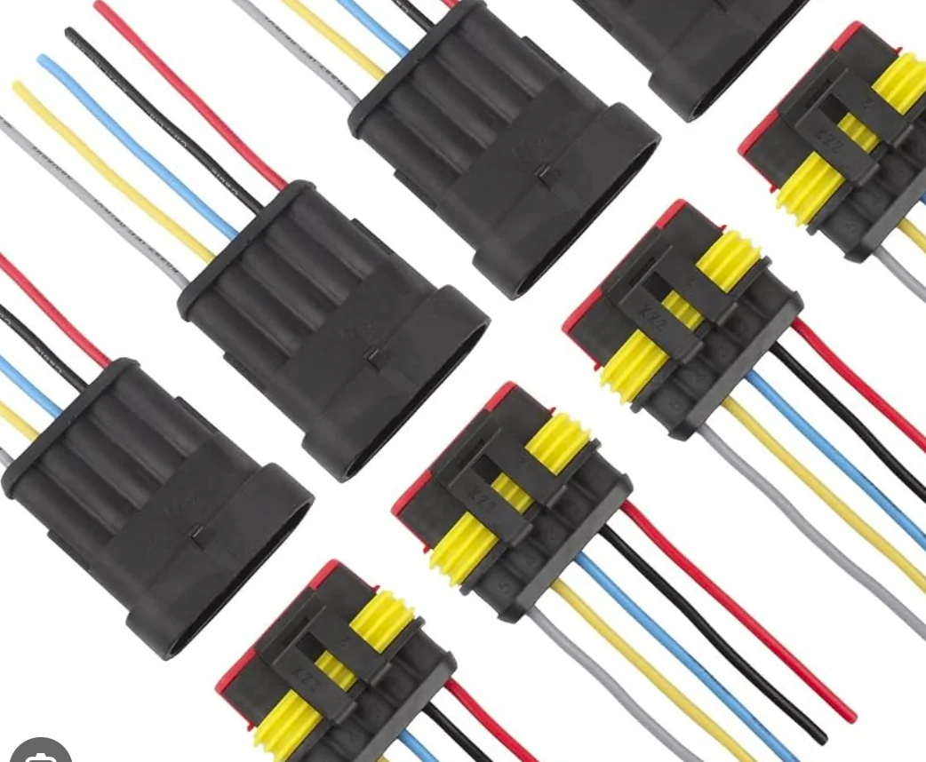

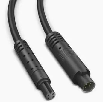

EDIT: They've apparently replaced the connector in question on my unit with a waterproof one, and they offered to send me a replacement rear cam with the waterproof connector since I started having connection issues! :)
I just want to throw it out there, the connectors between the camera and the wire harness really need to be made waterproof - I've unfortunately had a lot of connectivity issues with my rear camera either disconnecting or going into "reverse mode" while driving especially when it rains, despite loading dielectric grease into the connector and wrapping it with electrical tape and even trying heat shrink. Thinking about snipping off the connector and soldering in a replacement waterproof 5-pin connector. Just something to be mindful of when mounting your camera - make sure the connectors are waterproofed as best as you can. The included connector are this style:
I'm probably (just for the rear cam) going to solder in this style:

Thanks for your feedback. We have improved that connector.

Glad to hear it! You guys have some of the best customer service that I've seen from a car tech company in a long time - just reached out via email and got a response right away about getting a replacement rear cam with the improved connectors. :)

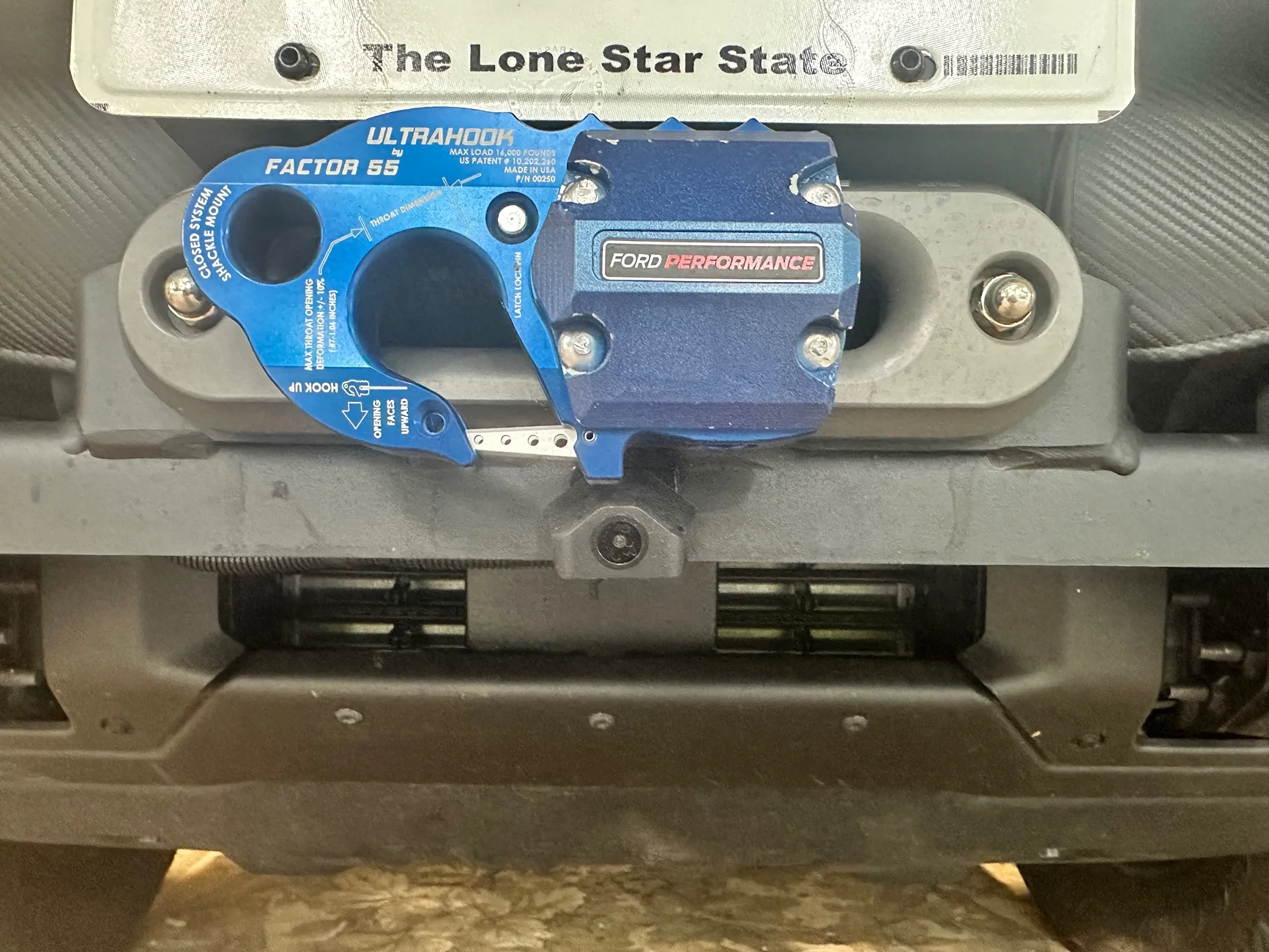

I like the main camera in the rear view mirror. That's the one for collecting evidence. I originally had the rear camera on the roll bar, which was great till I put my top on. Then I could not see more than two car lengths behind me. So I moved it to inside the spare tire. it works well there, but I would be happier if it didn't complicate mounting the spare. I have the front camera right under my winch hook. I think it's fairly well protected there, time will tell. I would mount it lower, (the lower the better.) but I don't think it would survive.
