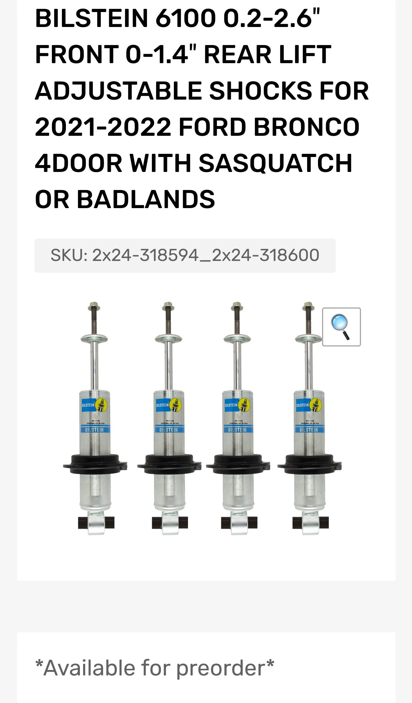

I've been starting to see these pop up... Bilstein 6100 0.2-2.6" Front 0-1.4" Rear Lift Adjustable Shocks for 2021-2022 Ford Bronco 4Door with Sasquatch or Badlands. They look good. Litebrite did a video on them, I looked at a couple pre orders and looked like November Delivery... But I'm seeing they are now available. Maybe that's just for preorder. Looks like the same lift as the perch collars when maxed out. Would like to see number on wheel travel. They do re-use the factory springs. Who else is waiting for them? My trigger finger getting itchy to hit confirm order. But November?

I just received a set, waiting on the sasquatch springs and bumpers to come in for install. Can tell you they are certainly heavy and look to be of good quality. My experience once installed maybe slightly different than yours as I am going from OBX non SAS to this setup.

Where did you purchase them from?

https://www.suspensionlifts.com/ although it looks like they are out of stock now. The rear springs have been a real pain to find in for the setup I want, albeit I have not seen clear distinction on what one letter code vs the other for the MB3Z-5560-* spring is.

FYI, there are 4 fronts and 2 rears in stock at Summit last I checked. I almost pulled the trigger on these until I realized that the compressed length is same as stock. That won't help me fit my 37s. I was hoping they were a little bit longer. That and the travel is also very slightly worse.
I'm going to stick with my zone 2" spacer lift for now until something else comes out with the option for more travel and about 2" of lift. Especially on the rear.
Edit: Summit also has $100 off right now.

I have them on preorder. I have a Badlands Sasquatch and I decided against trying to fit 37's. But these look to give you better performance and a couple of inches of extra clearance, which will be perfect for off roading.
35's are already amazing for 99% of the trails out there and with a couple of inches extra of clearance, is a killer setup and great value for an extra $1K in my opinion.
And you could probably actually fit 37's with a 1" strut spacer and a UCA combined with these shocks.
