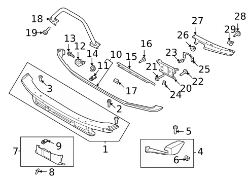

Its pretty straightforward, but it is involved.
If you are not the type to : " cut, and remove parts. I don’t want to have to do all that. It’s too much of a hassle "
Then, you would not install a 3rd party bumper yourself either.
Sounds like you need to go 3rd party bumper shopping, and pay a mechanic.
The Modular Steel has many components you need to order individually, and you need to figure that out yourself. Its not a "package" from Ford. And if you find one out there, likely it doesnt have everythigng.
https://www.fordpartsconnect.com/v-...2-7l-v6-gas/body--bumper-and-components-front

If you piece meal a modular bumper together via Ford, it’s about $2,300+ best I recall. Stupid expensive IMO.
You might get lucky buying a used, like new, takeoff from someone upgrading. Seen prices from $400-900. The catch is which parts you get. Some have skids, some don’t for instance.

and all the brackets on the back side, and specific fasteners....
its a chore, but if you make a spreadsheet and research you can get parts from multiple locations and cut that $2,300 to less than half. I have. I got the bumper cover for $100! - its been a mini-hobby sourcing all the other stuff at a discount.

I did not have a capable but had the other one with fog lights and rather than cut I bought the proper brakets.
easy, time consuming and a 2 person job as the Mod HD bumper is 82 lbs.

If you got the capable bumper you can buy one of the Amazon or EBay mod bumpers and it will bolt right on in no time. Only issue I had was the bumper sloped a little down when I bolted it up using the OEM bolts so I put a few washers behind the bracket on the lower bolts. It also hit the crash bar on the drivers side without the washers. I swapped it by myself in about 30 minutes. 3 bolts per side and one clip to undo on the capable bumper.
Edit: I also only had to swap the bumper and no sensors as mine is a Black Diamond.

The earlier linked youtube vid addresses the plastic bumper, not the capable, which has different hooks and connects to the frame, not bolts.
I had a BD with a capable bumper, bought a modular takeoff from a guy who put a custom one on with a winch.
It's unbolting six bolts, uncliping the fogs harness pulling the capable bumper off, and then putting the mod on and putting the 6 bolts back in. It's really easy to go from capable to modular. Get a second set of hands though. I was able to do it by myself in about 45 mins. Most of that 45 mins was figuring out how to get the modular bumper up there and hold it while being able to screw the bolts back in.

Good to hear! Any other quirks or differences to note?
IF you're coming from a Capable bumper, you will need sensor retainers.
M2DZ-15A862-MA
M2DZ-15A862-MB
M2DZ-15A862-MC
M2DZ-15A862-MD
If you have sensors, you will need to decide if you will retain the capable bumper wiring harness or buy the modular wiring harness about $60. It's on backorder as of 2 weekends ago when I inquired.
The two outer sensors ($250ea at my dealer) from the capable bumper will fit the modular but will push out the front when you reassemble the bumper. So, you will need to decide if you will buy new ones or just drill a hole in the back. I opted to drill the holes and it gave me more slack.
My research indicates that the part number for the sensors is LU5Z-15K859-AAPTM. AAPTM being the paint code which means these come bare and you will need to paint to match the bumper, but any LU5Z-15K859 should work. They may be a different color.
