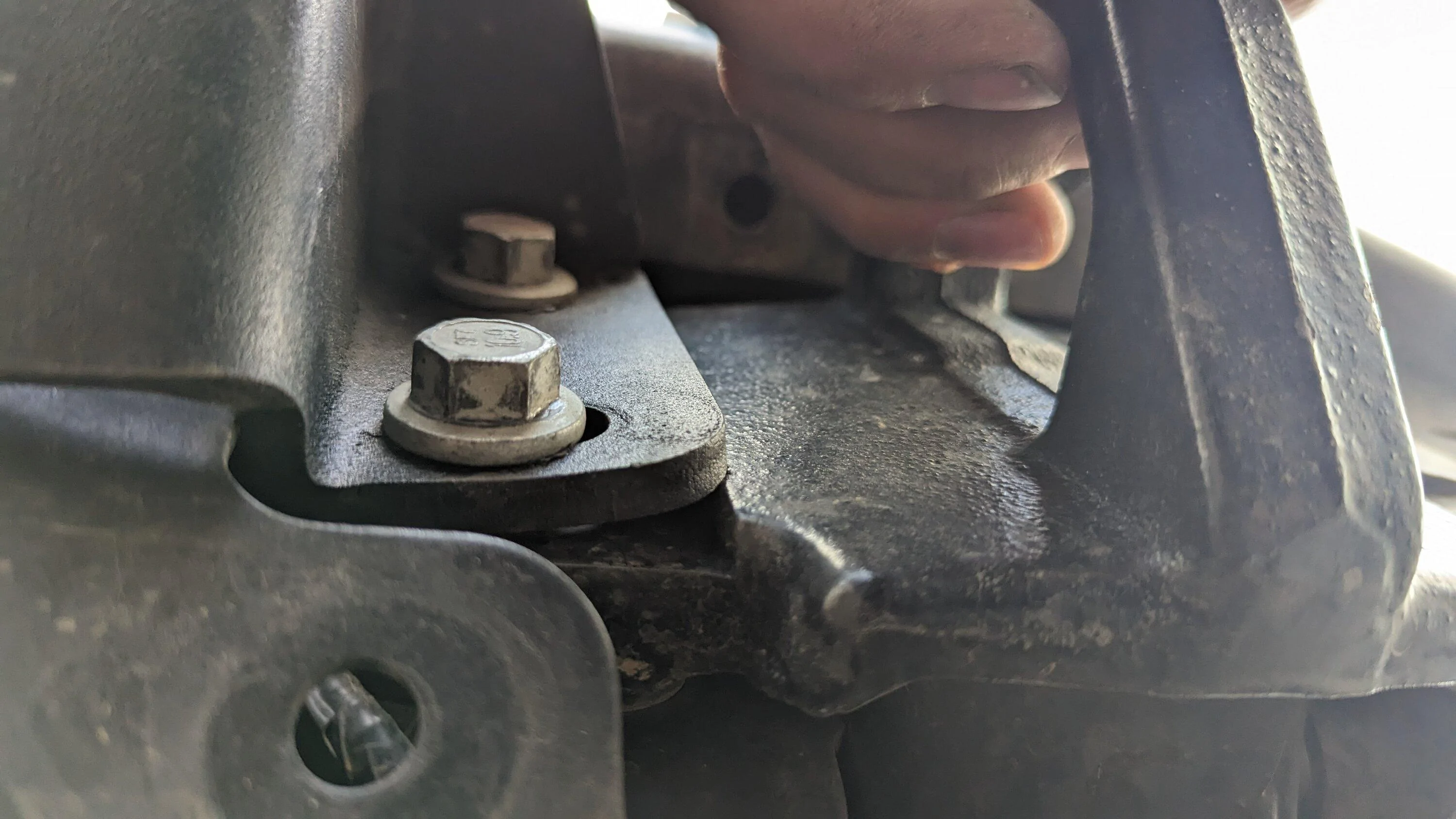

There is damage to the frame horn face plates in addition to the RC mount ears.
**********EDIT*********

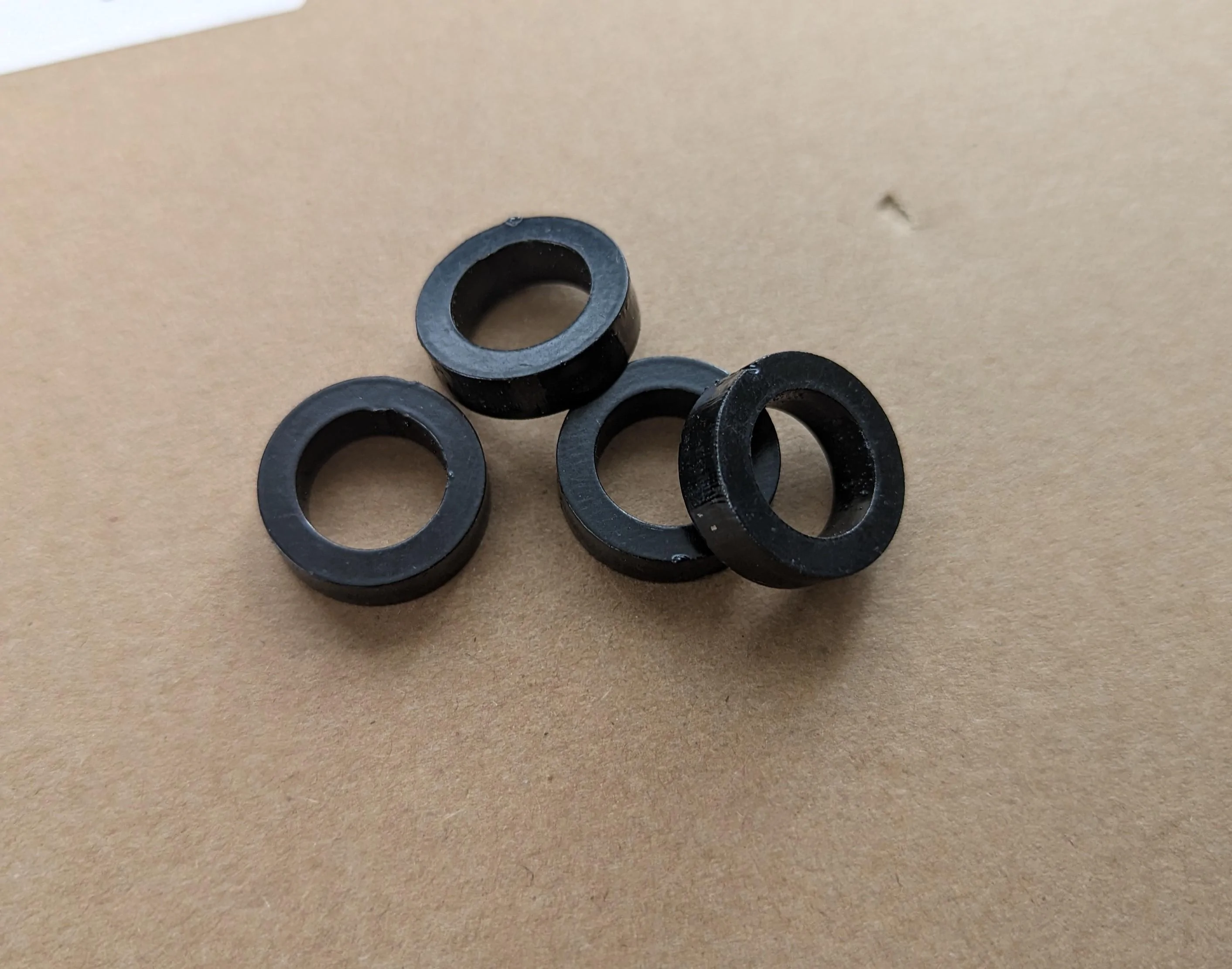

OK....so this is highly embarrassing and I feel like a total idiot but I need to come clean. At least some good discussion became of it and my Bronco is undamaged. I still believe after seeing the DV8 bumper video, this scare, and how Ford does it from the factory, that LOD plates or similar are wise.
I got it dissembled and it turns out this is 100% on me.
I left out some very crucial parts.
Ford Bronco Damage while using winch on improperly installed Rough Country High Mount PXL_20230413_000539455_2
Ford Bronco Damage while using winch on improperly installed Rough Country High Mount PXL_20230412_233502124

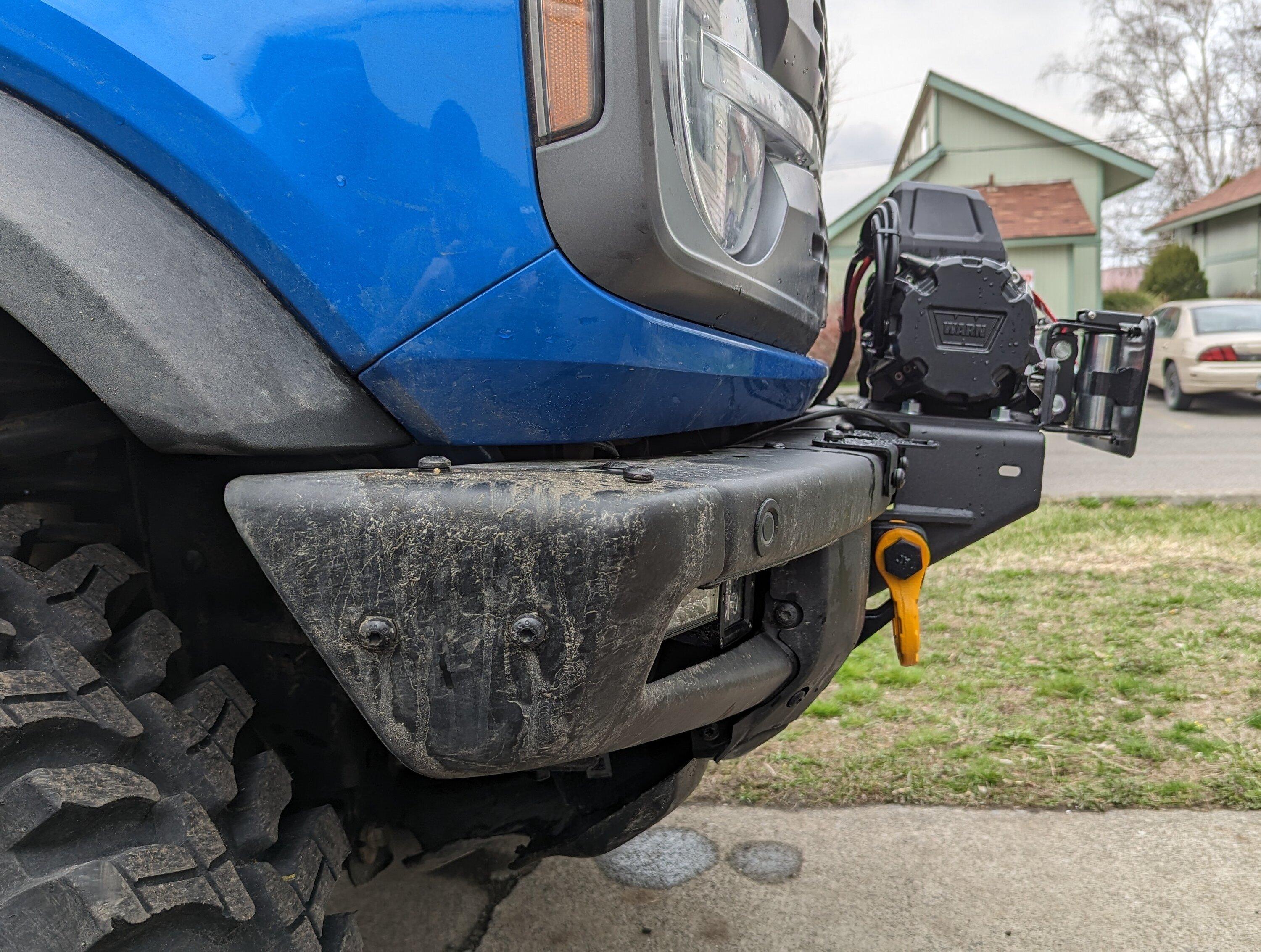

Nope, don't like that. The whole bumper and mount is pitched forward. There used to be 1/4" clearance between these wires and the grill.
I'm going to have to shim it back out and add some kind of reinforcement.
Ford Bronco Damage while using winch on improperly installed Rough Country High Mount PXL_20230410_231546208~2

It happened during a winch pull.
Ohhhh... yeah. That makes more sense—don't know why that didn't occur to me.
Definitely sucks, and it confirms my fears. One of the reasons why I've been hesitant about the JCR mount is for the same reason. I had a feeling if you got a winch pull at the right angle you could bend something.
Just seems like a complete bumper replacement is the right way to go so you don't create a level-type setup that'll bend the front end. I just haven't seen an aftermarket bumper I really liked yet.

Buried to my frame in wet snow. Nose uphill a little so it pulled downwards. 10k winch didn't even bog down.

I don't think it would matter but maybe? I might have only bent that inner ear.
Did you bend the frame horns or stretched the bumper mounting plates that are welded to the frame horns?
It miiight be just the plates. I won't know until it's apart.
Vivid Racing has the LoD brackets in stock, I just ordered a set.
