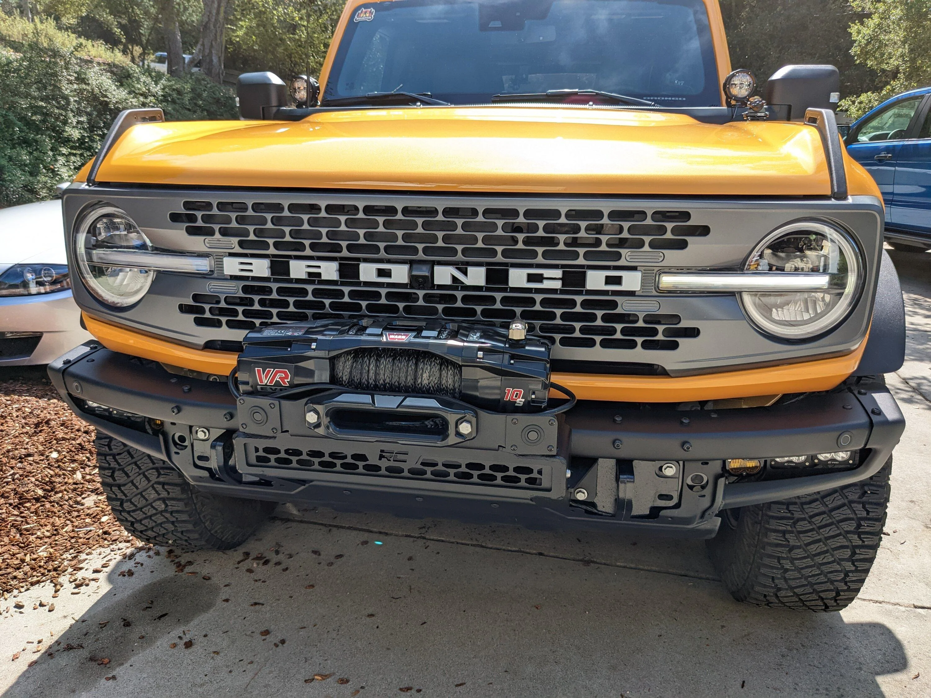

I decided to just leave the caps off - for that tough(er)-guy look ;-)

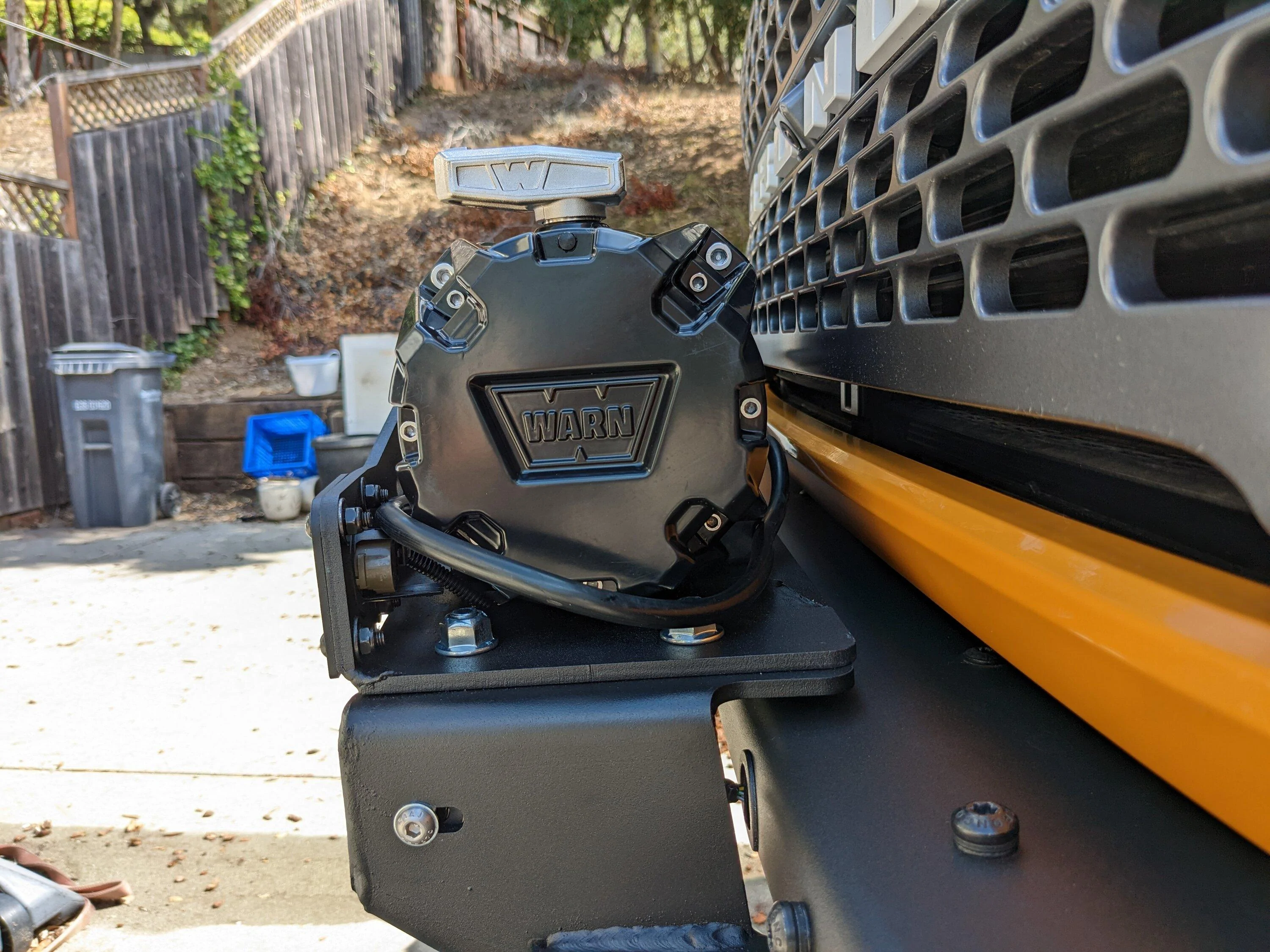

Can you expound? The 10S is what I got to go on this mount.
No amount of trimming the end caps that go on the back of the sensors was enough to make use of the caps, as the winch has a larger side profile than others, apparently. My sensors are on there without the caps holding them in. How did you make it work?

So I have the cart before the horse so to speak, already have the RC high winch mount but don't have the Bronco. I was planning on mounting the winch plate as soon as I get the vehcile, which will be before I buy the winch. Based on this I will probably leave off the trim pieces as Wheelme did. I was thinking of going with the 10S as well but now I am wondering if it will fit. I have the factory bull bar on the modular bumper, do you think there is enough clearance that the bull bar will go over the winch? I may have screwd myself if it sits to far back.

I sold my bull bar to a guy who had this setup, it fits just fine
Ford Bronco High Mount Rough Country Winch PXL_20220925_201031285
where did you mount the Evo 10S “brain”? I’m looking at this same setup (Rough Country mount+ Warn Evo 10S)…I don’t have sensors for my BaseSquatch so less to deal with I think.
I really like the look without the “brain” on top of the winch… does it work with and without it relocated ?
The "brain" is under the hood, typically secured with a mount made by BAMF, located in a crevice just fore of the battery (in a V6 model). The relocation requires that an extended-length wire kit be purchased from Warn, as the wires that come with the 10S aren't long enough to snake under the grille and into the engine compartment. As long as the controller is wired to the winch (regardless of wire length), the winch will work.
