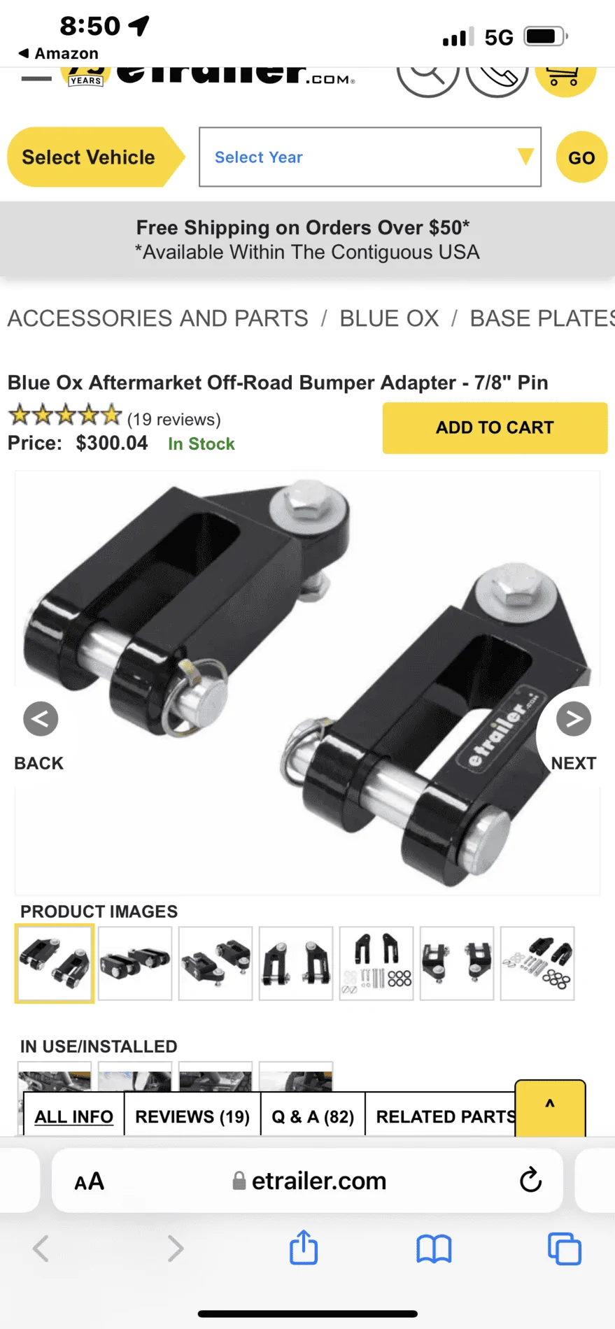

Blue ox says I have to use a baseplate to attach the tow bar. Why can’t I use this adapter and attach to modular bumper?

Someone needs to try it and report back. Go for it.

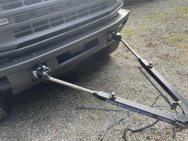

The loops on the Ford modular bumper are designed for flat towing. Those are exactly what I would use. Soounds like you need to talk to somebody else there

Because Blue Ox wants to sell you $300 fittings and a base plate. The Mod bumper will be more than capable for flat towing. We need someone to come up with a diode kit for a simple taillight solution and answers on braking kits.
