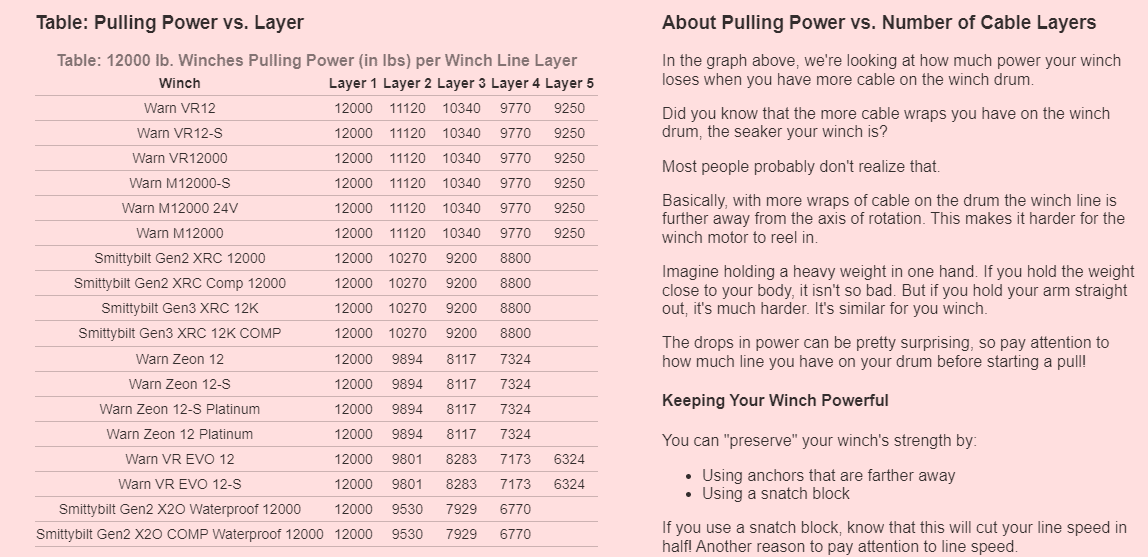

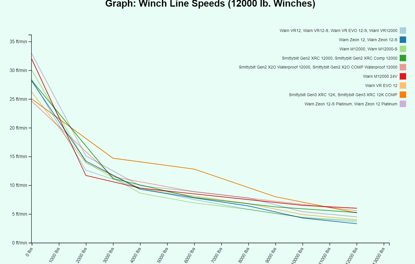

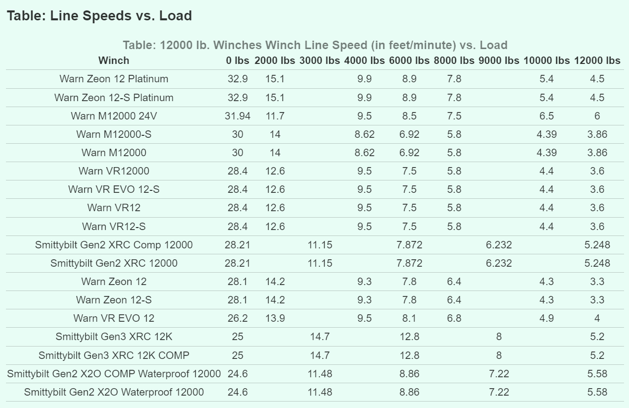

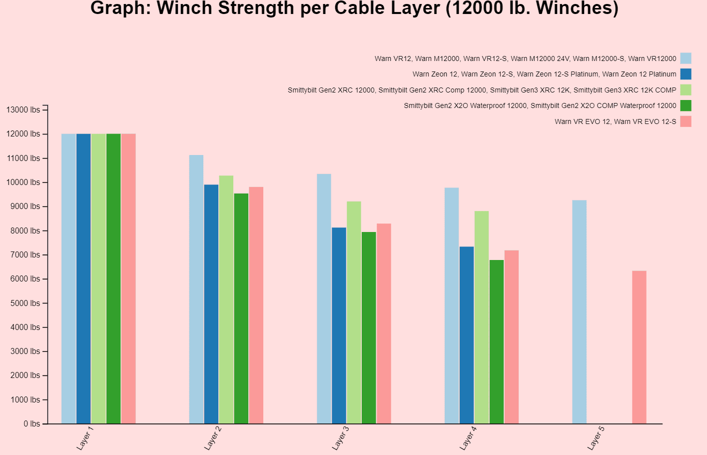

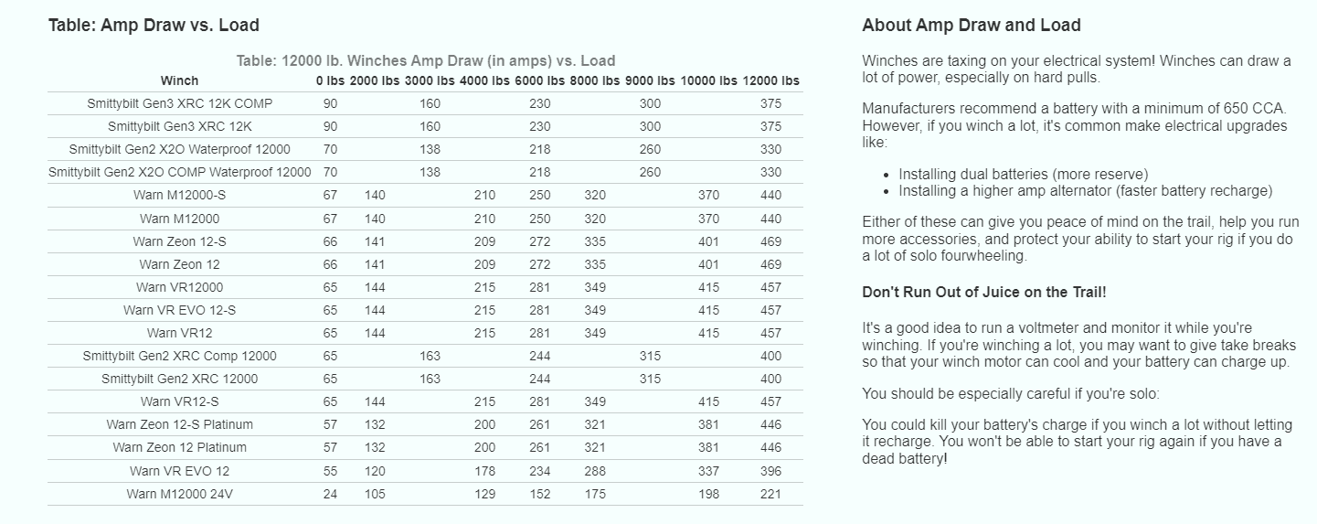

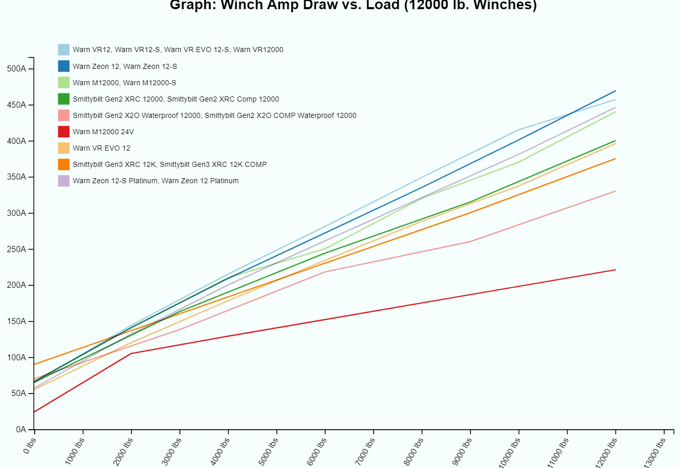

Obviously Badlands Apex is a contender. It's larger but I've seen some BAMF installs work. Got me thinking about the Smittybilt and Superwinch variants as well. Found some chart data on the Smitty's and they seem to actually perform better on paper than the EVO's.
I can't find charts on the Smitty's or Badlands. Can someone point me to them?

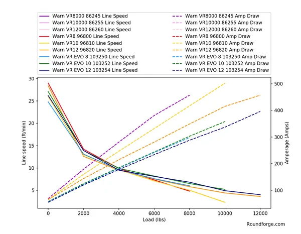

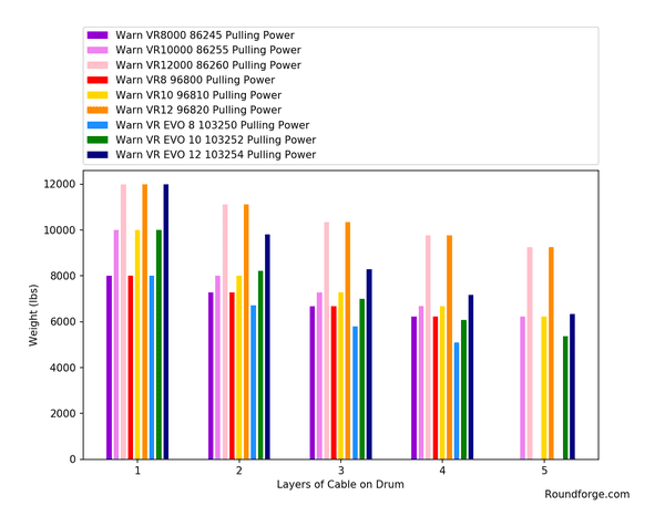

FYI...saw an interesting comparison of the VR (gen 1 & 2) vs the VR EVO (gen 3). Short version, the EVO has faster line pulls and lower amp usage but loses some pull strength on the various wraps around the drum. Obviously single layer, you hit the advertised max strengths. But when you have multiple wraps you see degradation from the VR (gen 1 & 2) winches, which is a little disappointing. Also the EVO-10 seems to degrade less than the 8k and 12k variants.
https://www.roundforge.com/articles/warn-vr-vs-warn-vr-evo-winch/

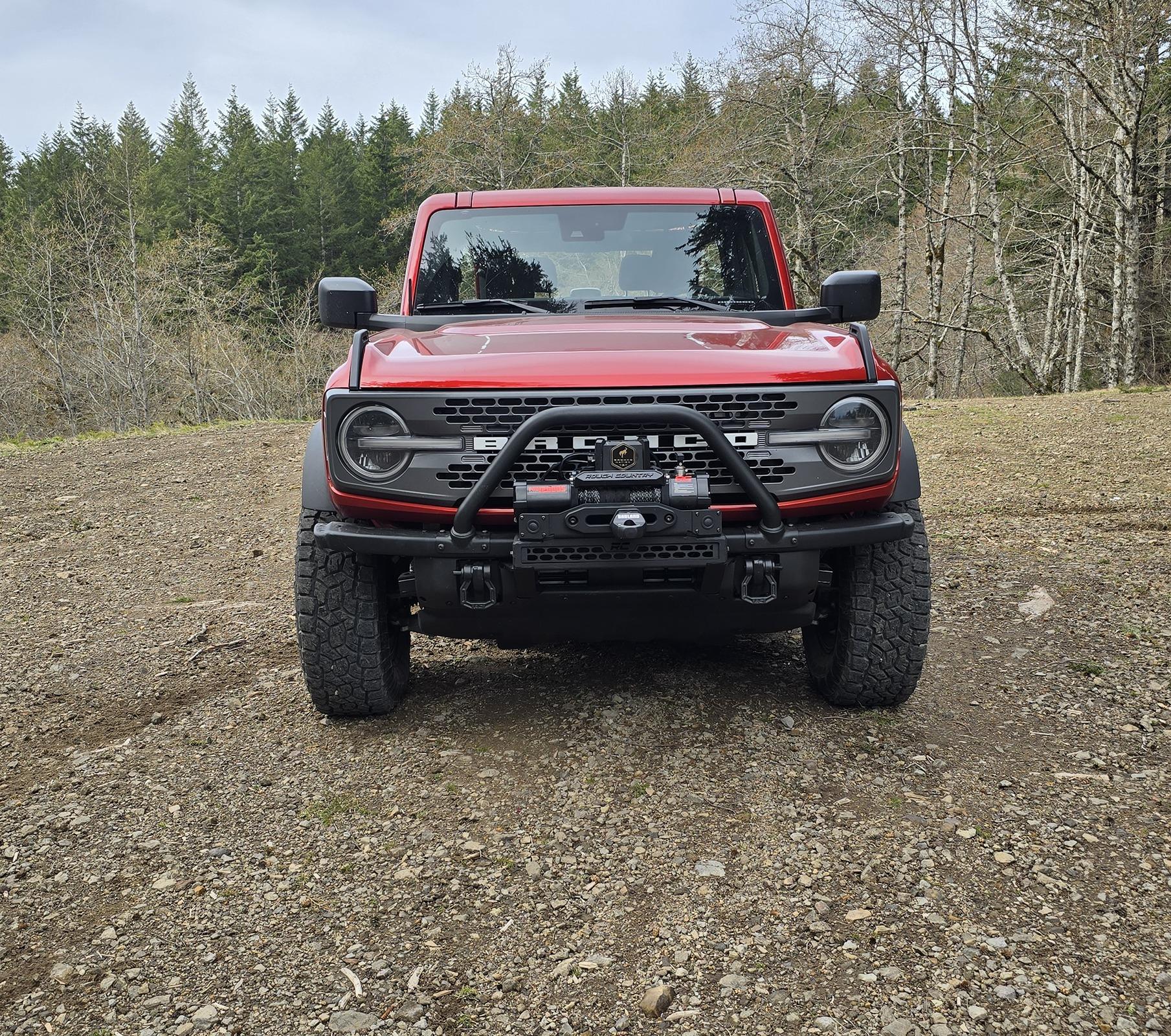

If you are going to buy a Chinese made Winch then there are plenty of good options, for much less. I considered a Badlands 12K and a Rough Country 12K. I went with the RC 12K and their high winch mount.

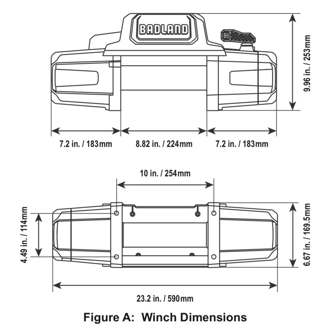

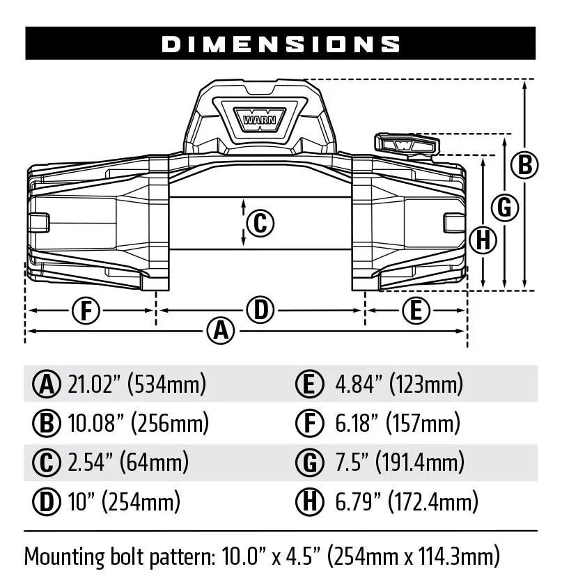

FYI, here are dimensions on the EVO it was designed around and also the Badlands Apex which I understand is probably the largest I can squeeze in. Both have 10"x4.5" bolt patterns, which I think most do.

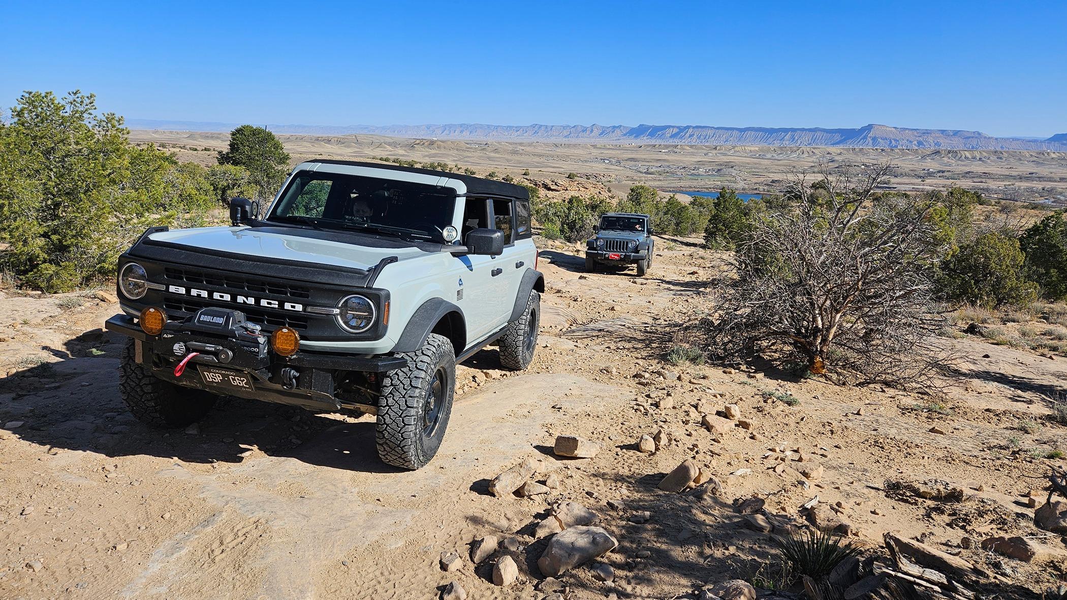

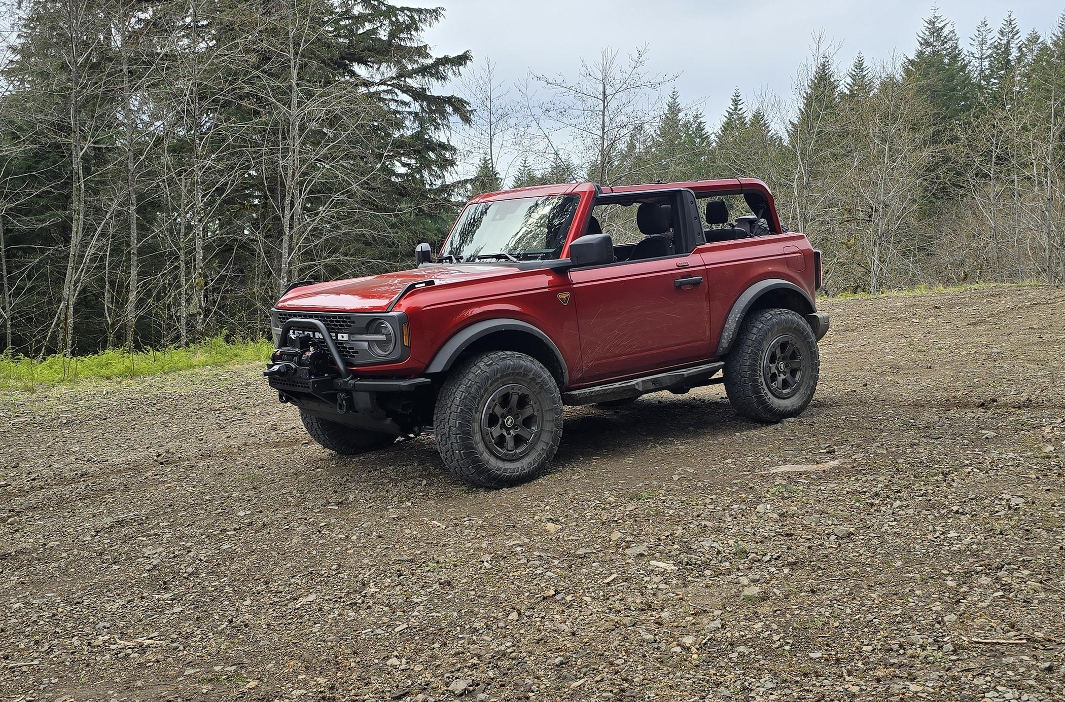

I and many others have had no issues with the Badland Apex winch!
Ford Bronco Here We Go...Which Winch? 20240414_093028
Thanks for sharing, Iā€™ve heard lots of good things about the Badlands Apex.
Occasionally HF gets it right. While many of their things are what I consider ā€œthrow awayā€ tools, I currently own 2 of their 44ā€ toolboxes. Not a SnapOn by any means but superb quality, especially since I paid $325 for one and $345 for the other.
Back to the matter at hand, I would just like to see some performance chart data similar to what Iā€™ve shared above on this winch. Just to see how it compares numerically. Guess thatā€™s my inner nerd crying out, lol.
