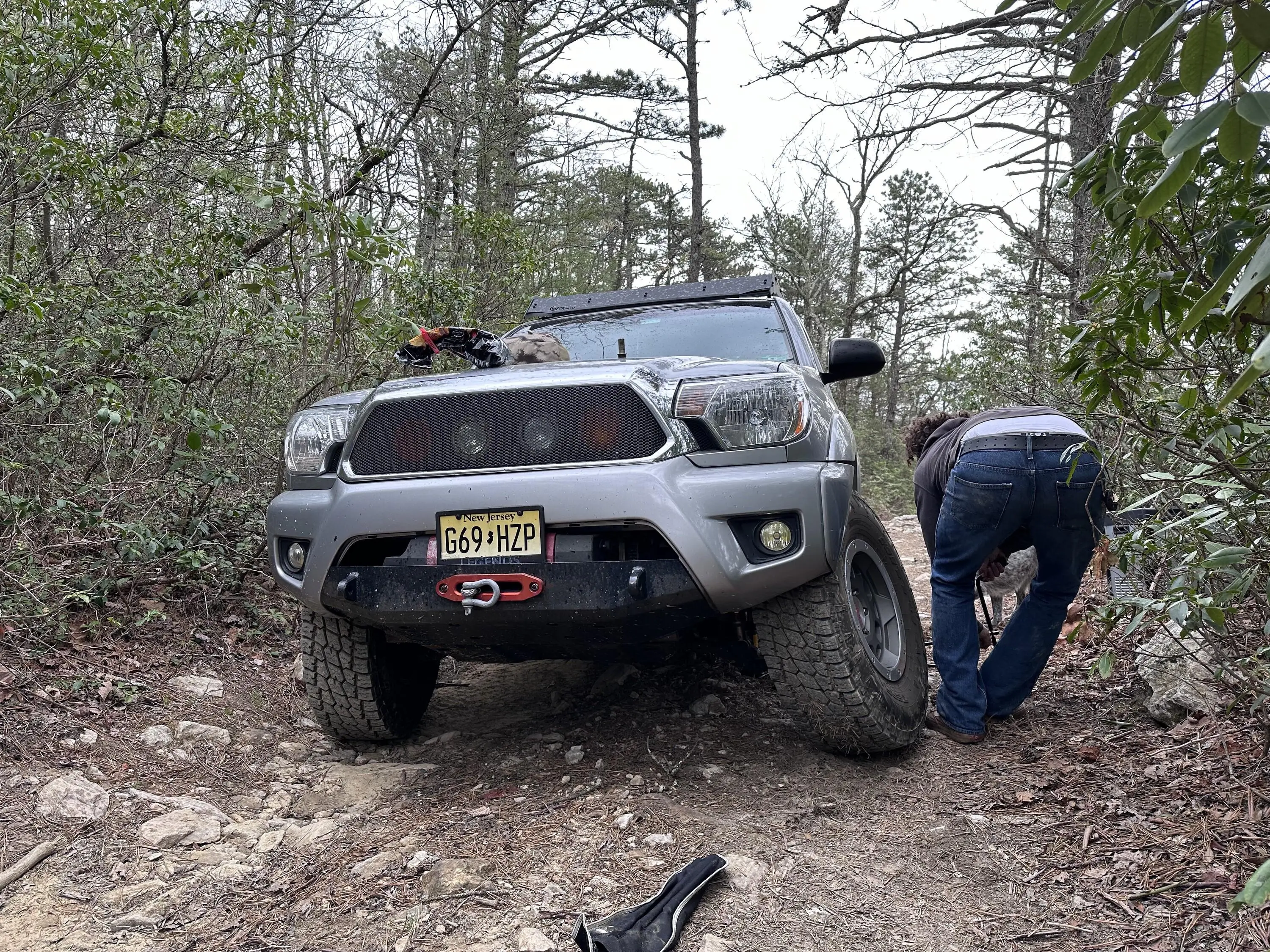

The next day we started exiting the trail only to have my buddys LBJ bolts back out on the trail. Thankfully they didn't get lost and nothing got damaged.
Ford Bronco IM A HORSE - Definitely not a build. 53692200579_baf648cf1b_4k
Untitled by MJH Creations, on Flickr

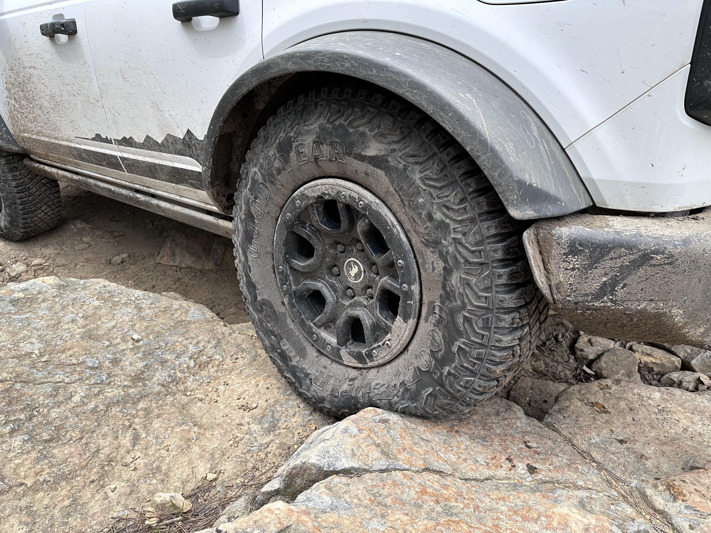

I was curious on what would be ideal pressure on these tires on 17's and it looks like 16-18 or so seems to be the sweet spot. I need to go down to 10-12 psi on my Tacoma with 315/75r16's to get the same sidewall flex.

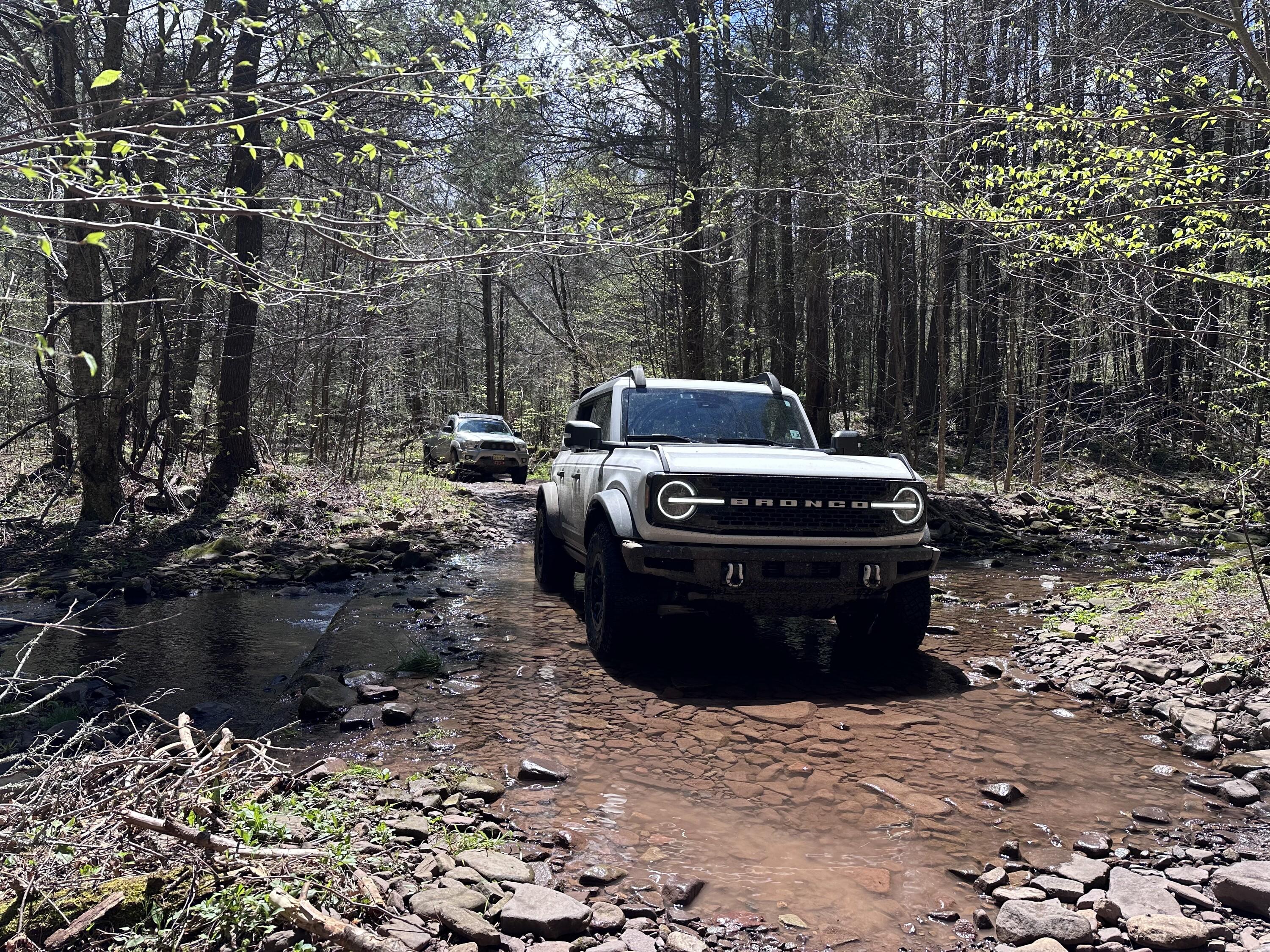

Some of the many creek and stream crossings:
Ford Bronco IM A HORSE - Definitely not a build. 53692293545_37f212d3e6_4k
Ford Bronco IM A HORSE - Definitely not a build. 53690969452_6aaed0d6b1_4k

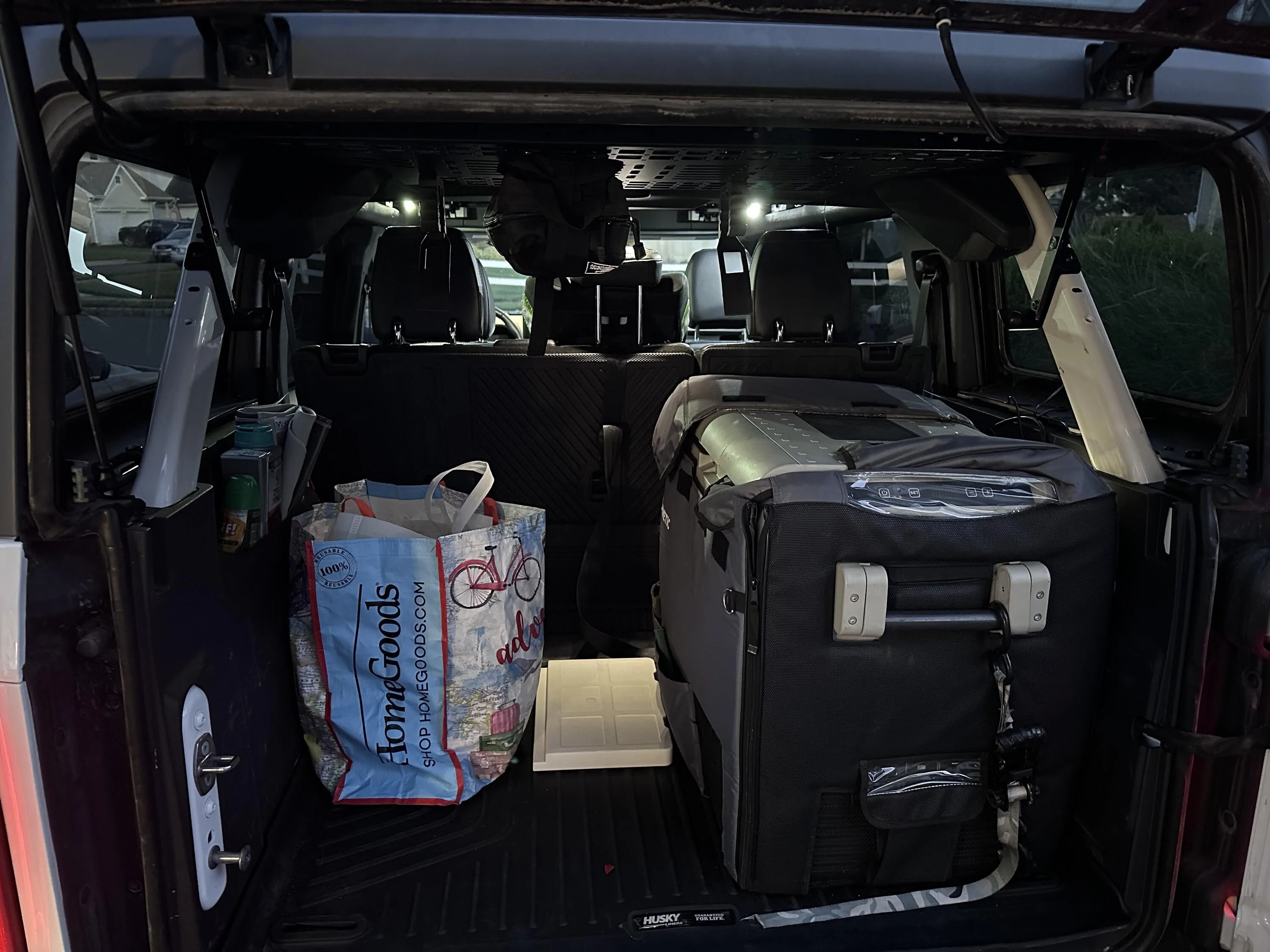

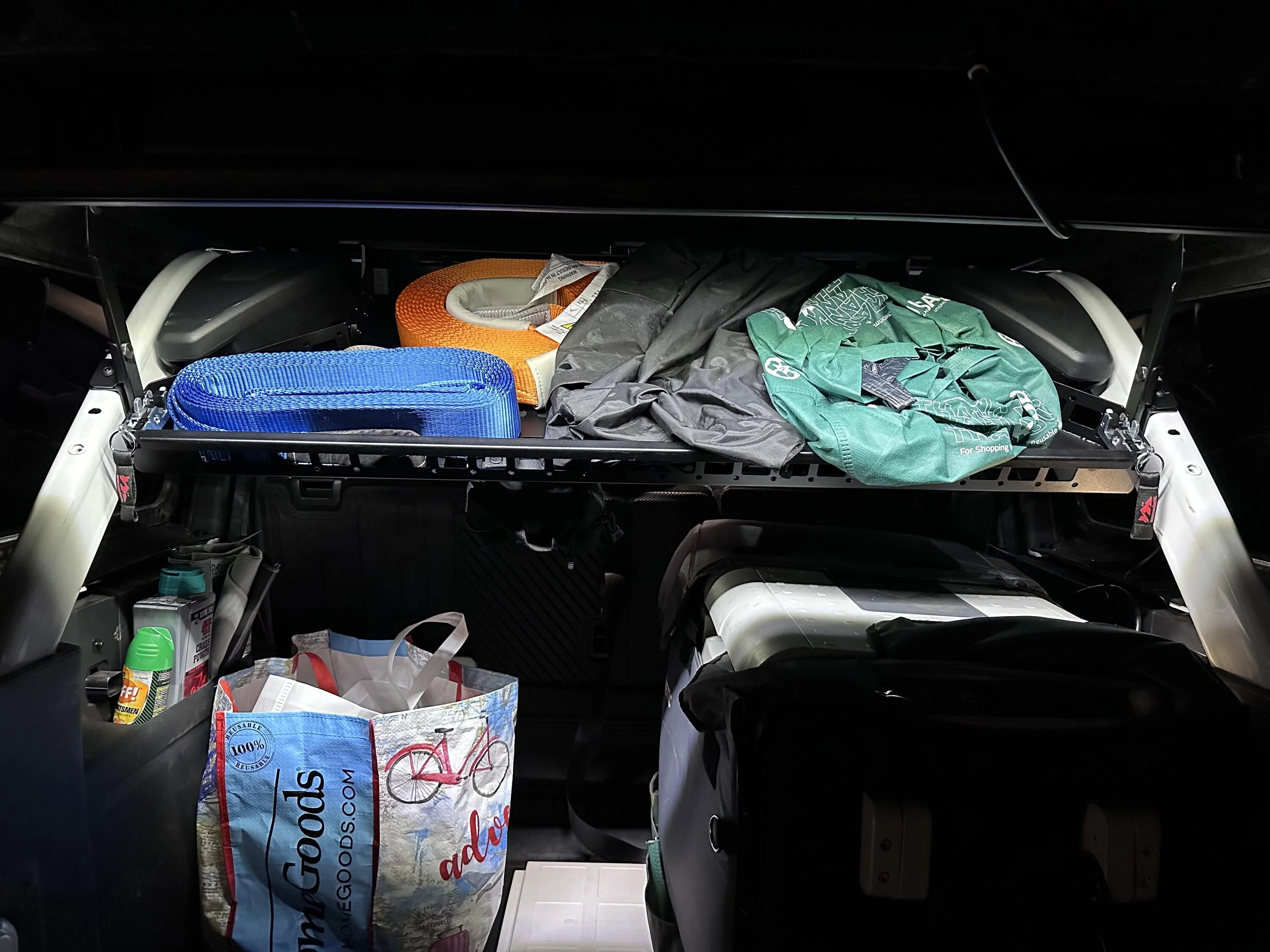

I need more storage/better organized storage. For only myself, my son and my dog we were packed to the gills.

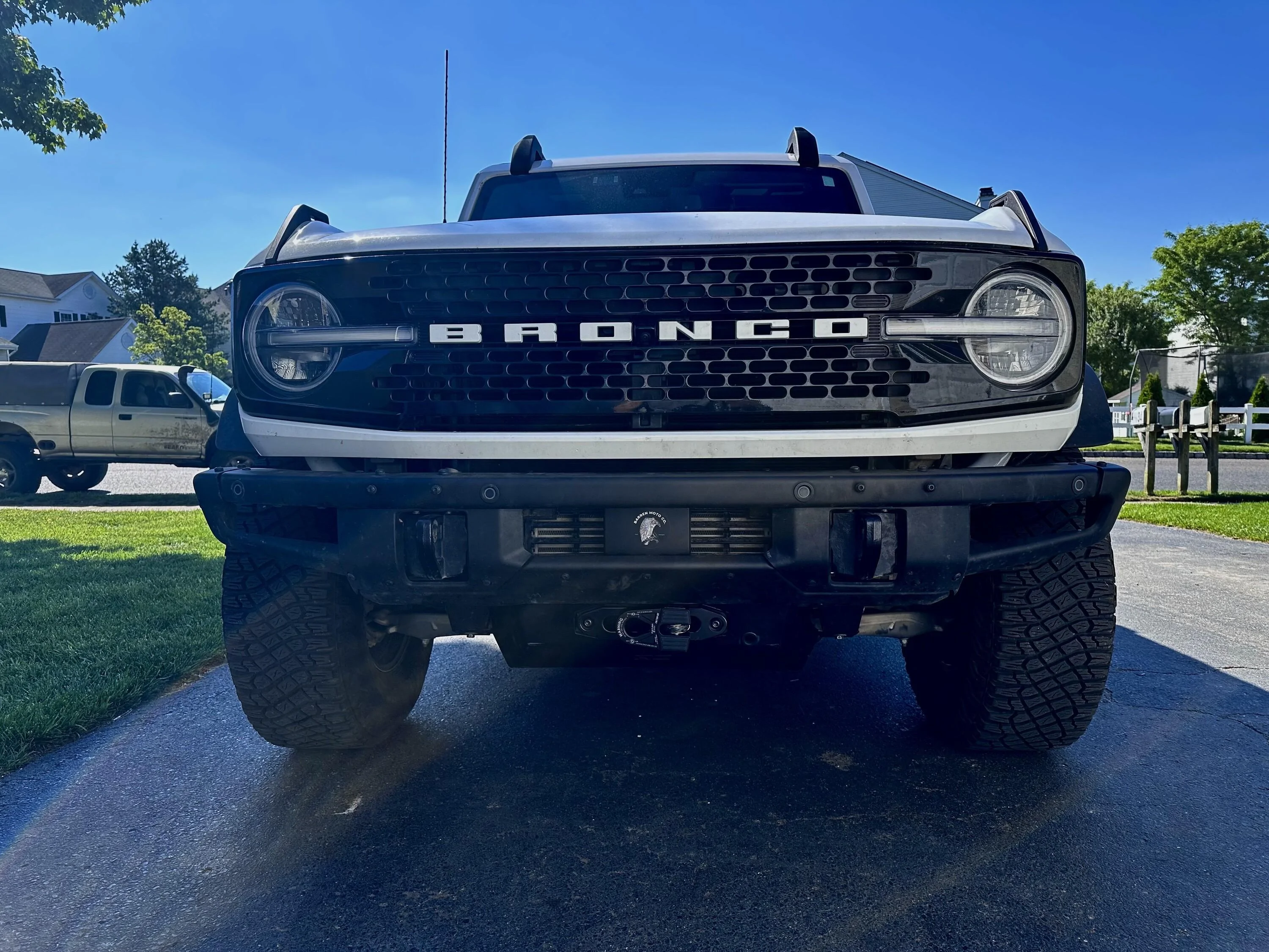

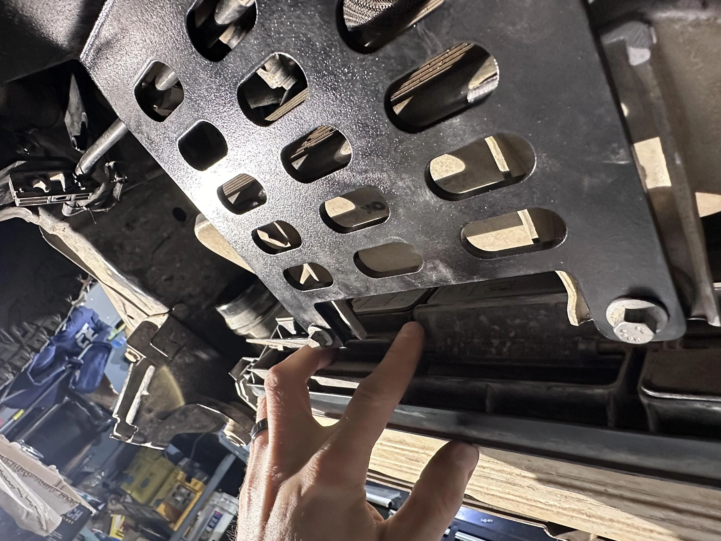

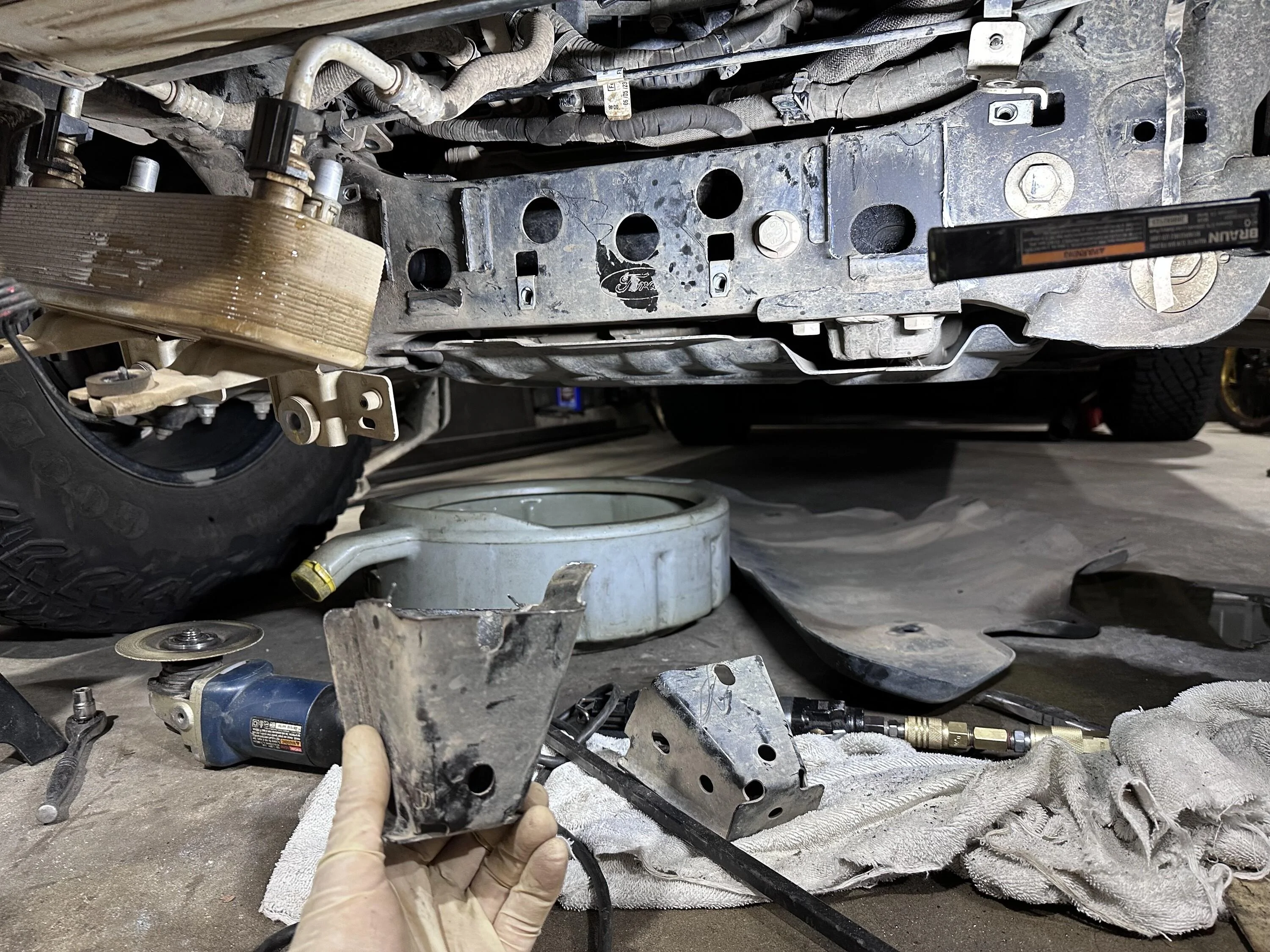

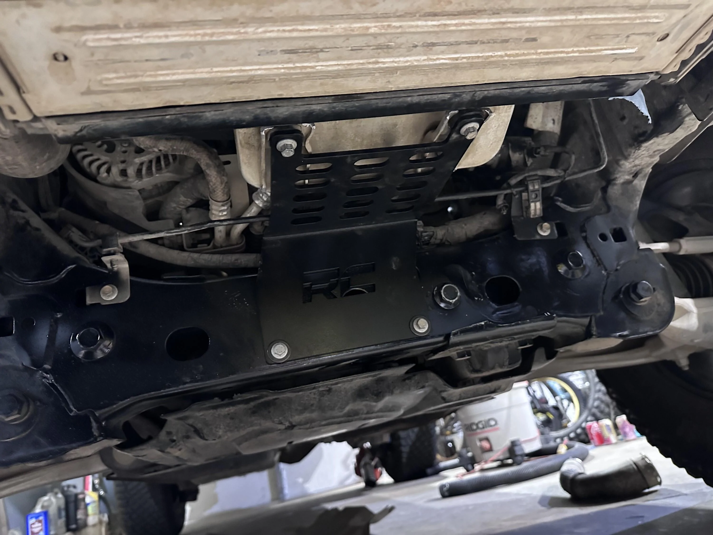

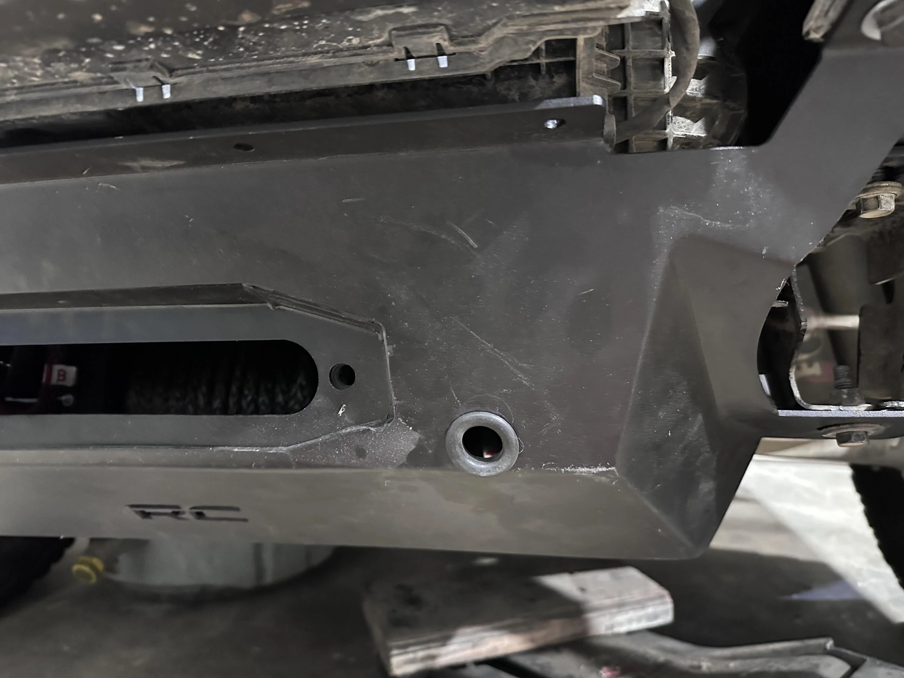

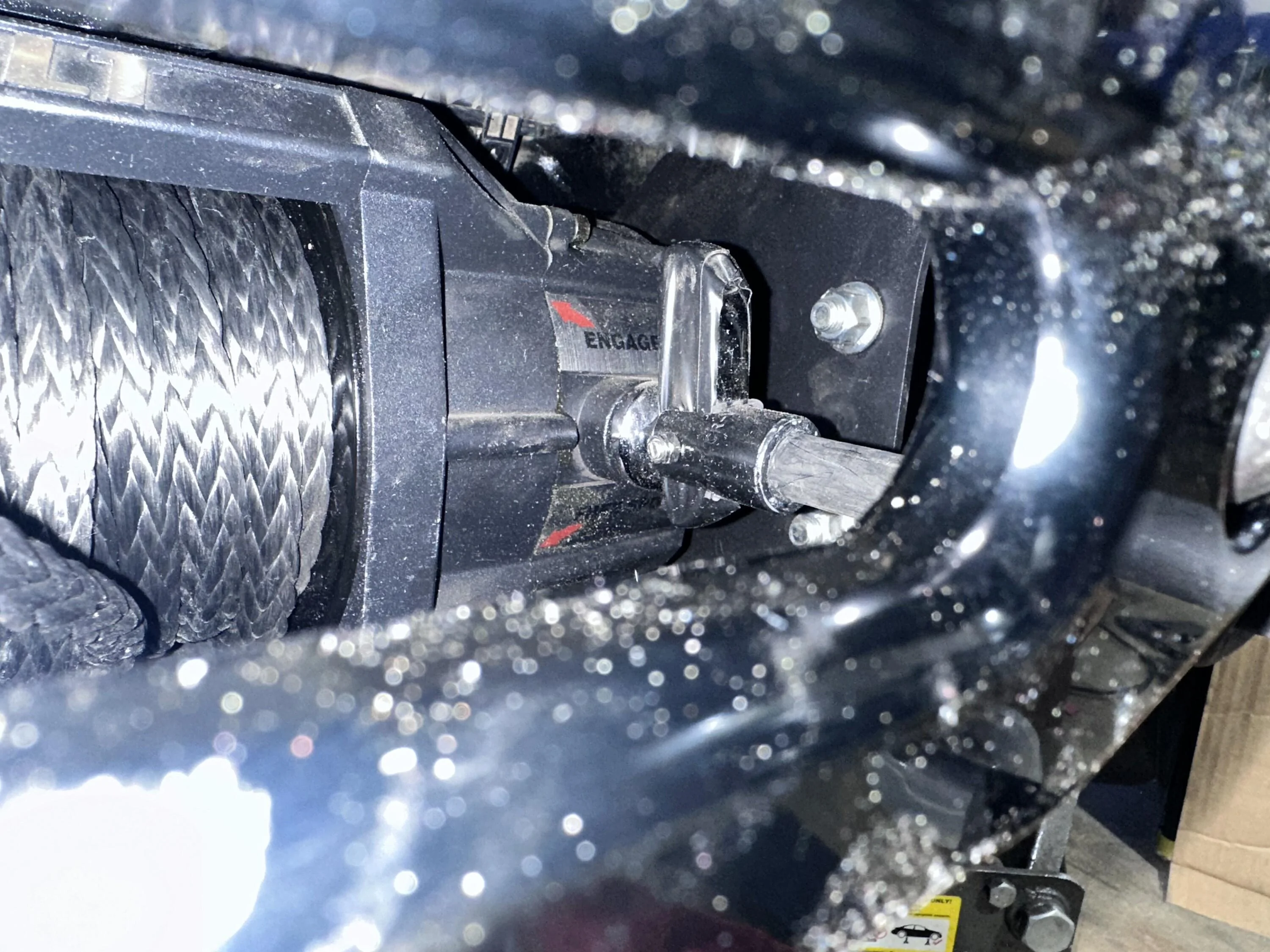

The current next project is getting this RC hidden winch setup installed. I spent the majority of the time so far fabricating mounts for the solenoid and isolator, as well as finding a solution to actuating the free spool clutch without opening the hood.
Brackets in design/testing:
And the completed products:
I am really trying to think through my solutions and not rush anything. Half the work on the Tacoma I am redoing came from not knowing better or rushing before a trip.
^^ Quoting above since that was part 1. ^^

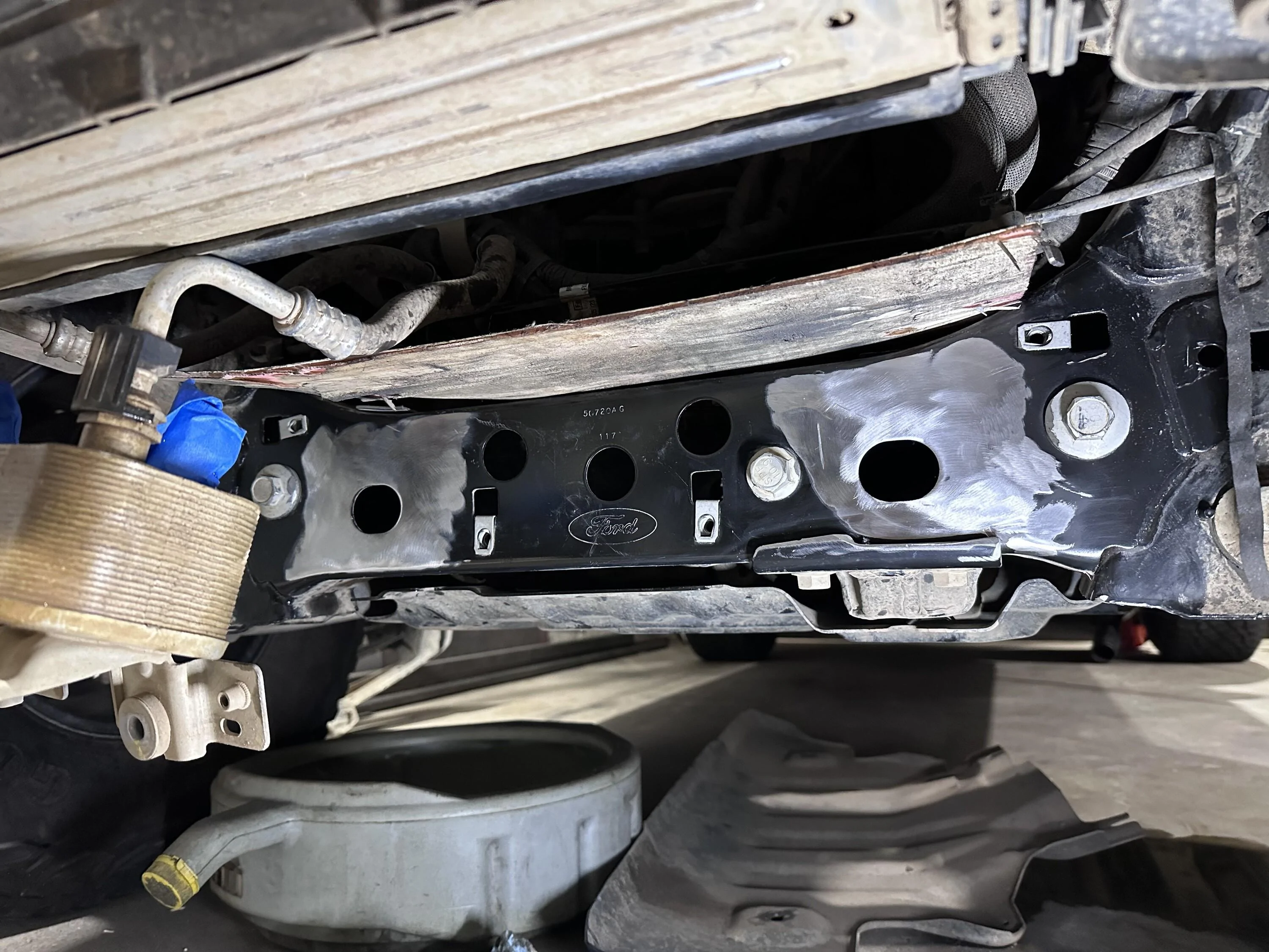

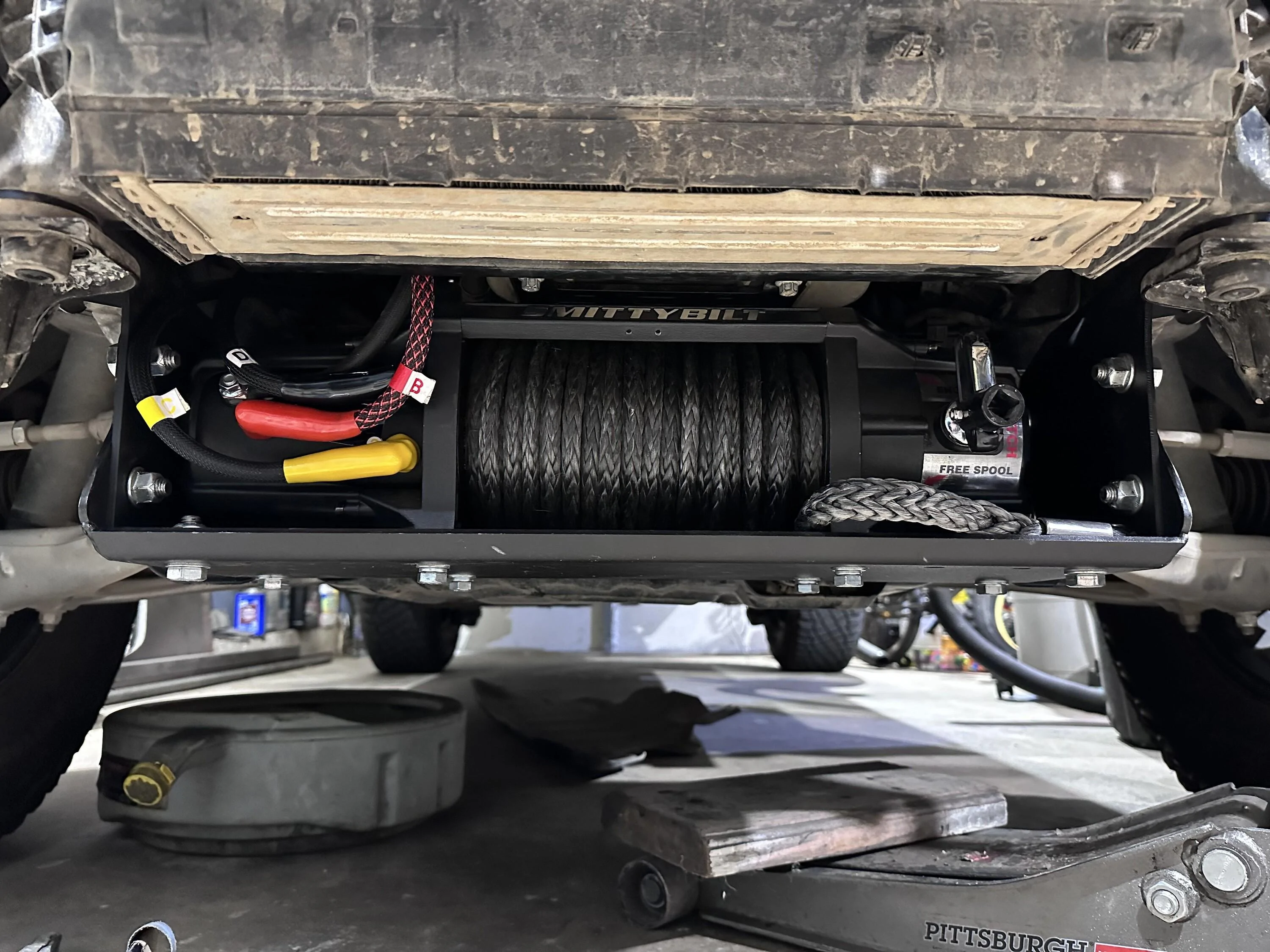

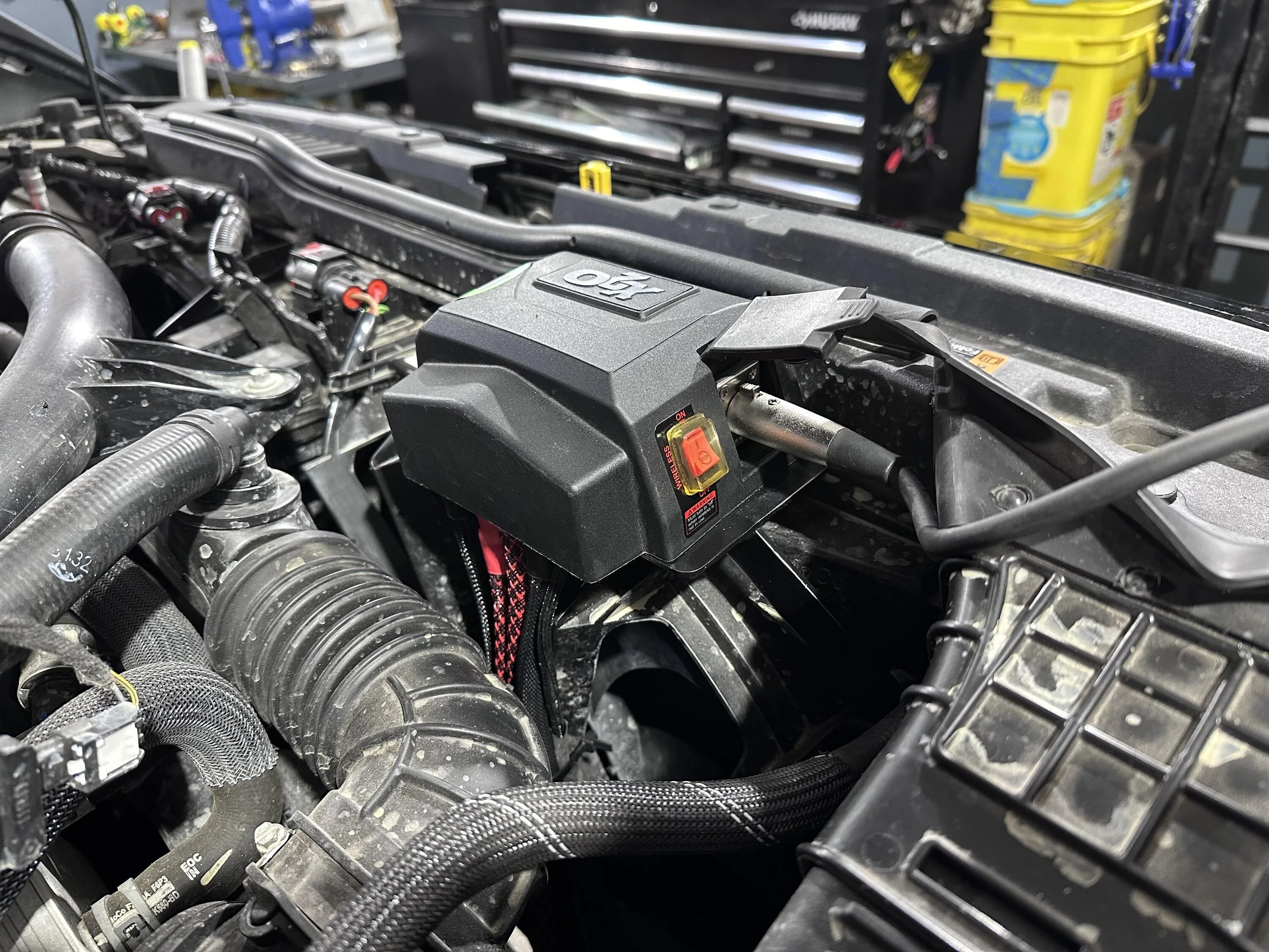

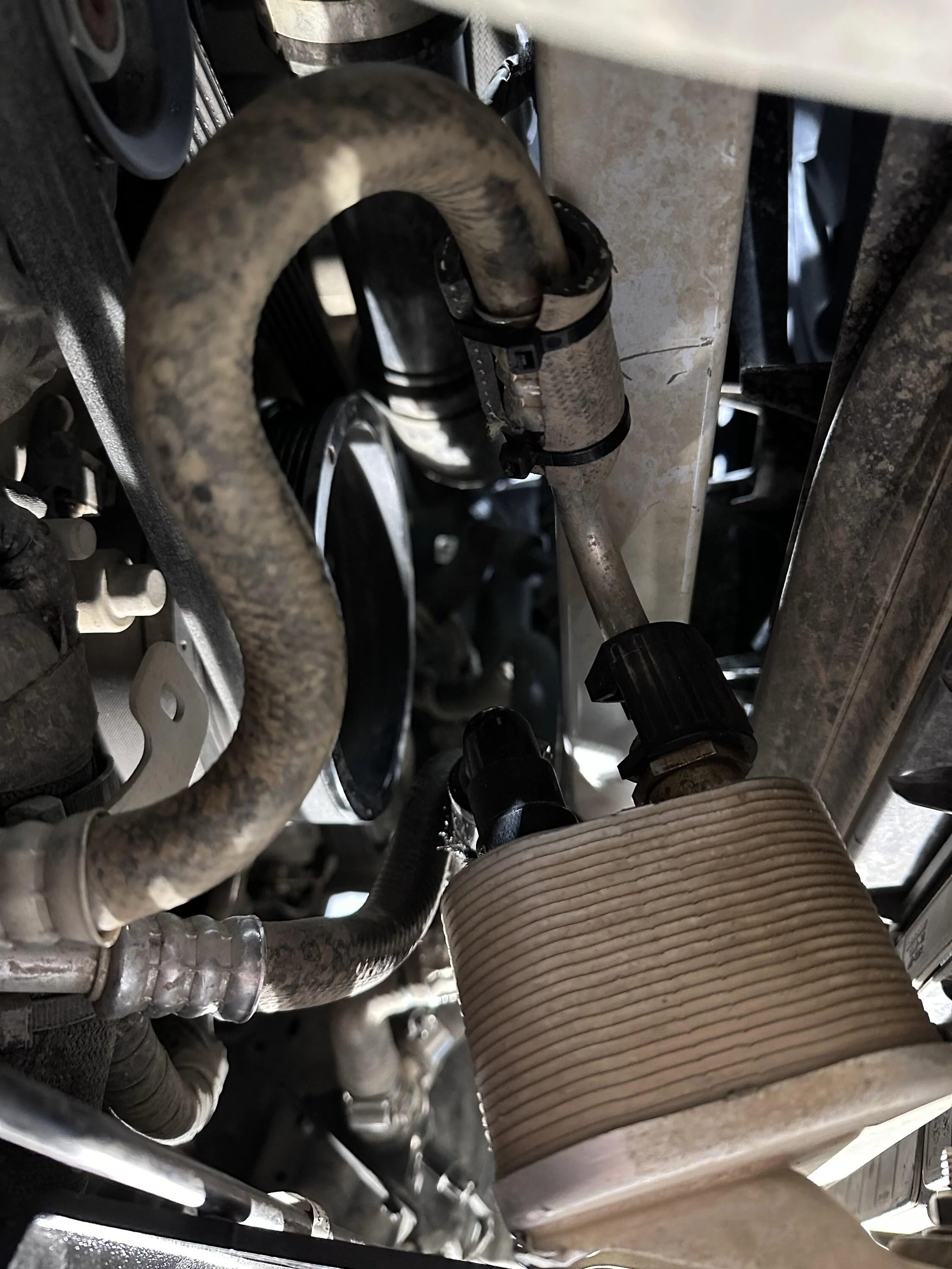

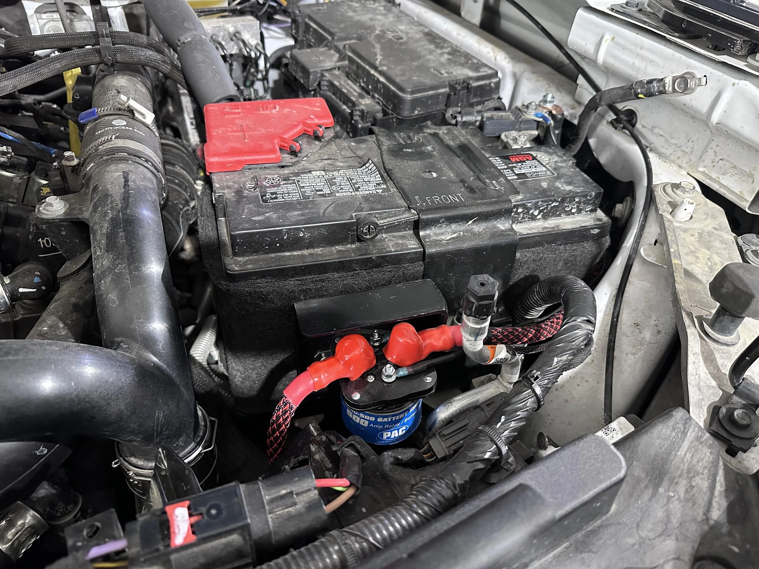

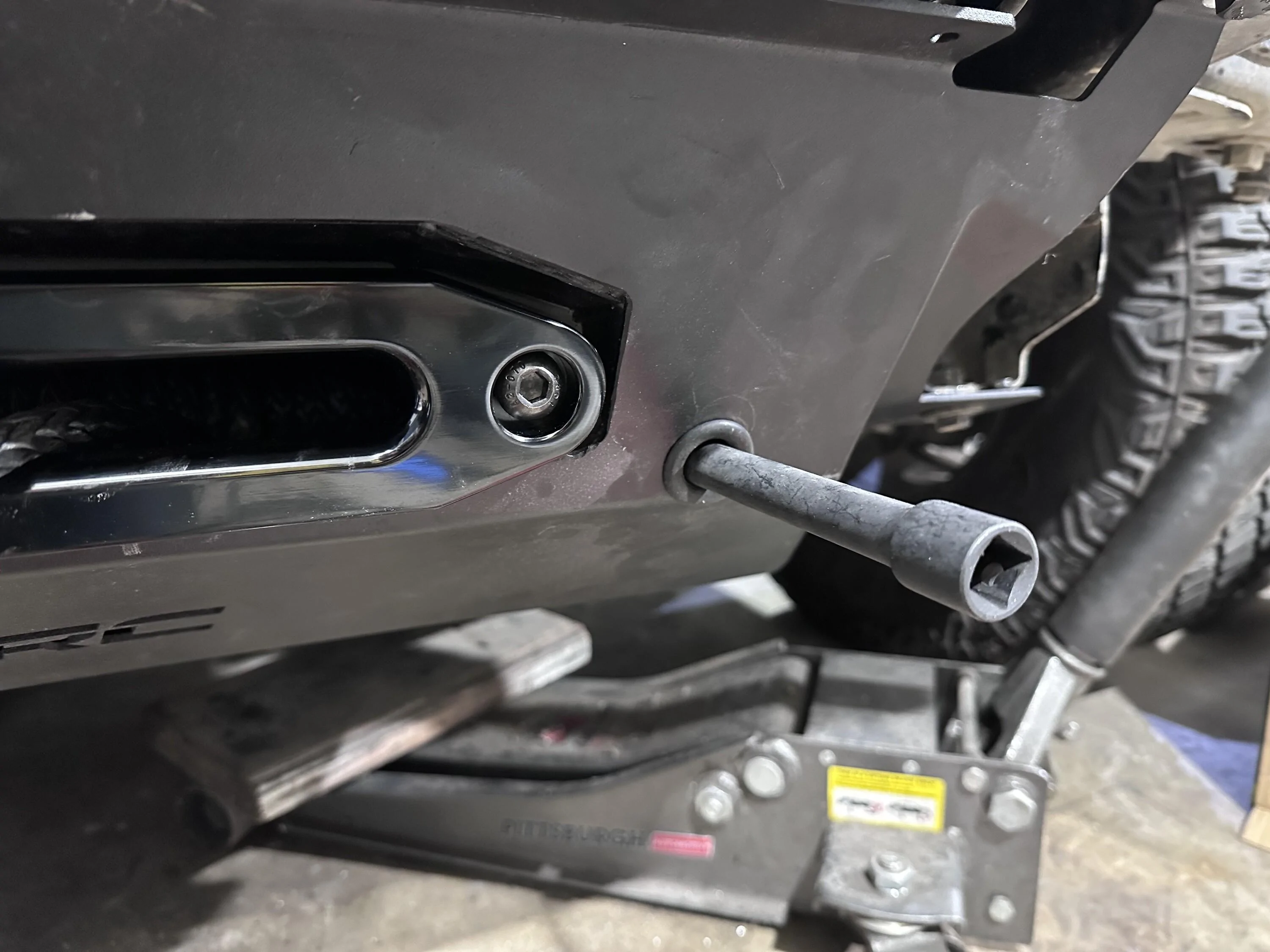

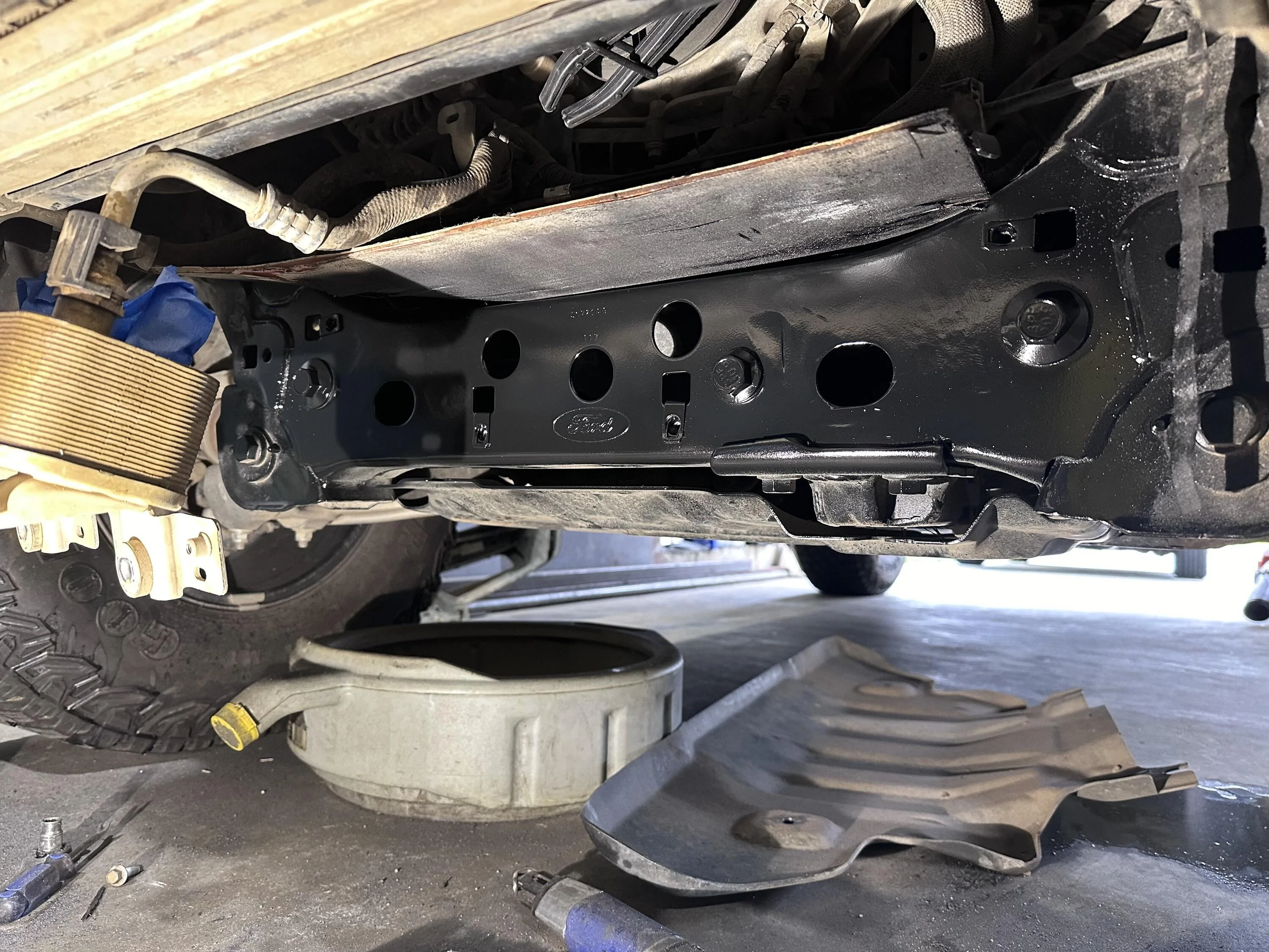

I finally got this winch install finished. Being that I have the 2.7 relocating the oil cooler alone took about a day. Big shout out to @xtreme_exploder for pointing out the modifications he needed to keep the rear shutters. And another shout out to @tobyw on the idea of how to mount the solenoid.
I had a couple goals for this project and reasons why I didn't want to go with a high mount. First I felt like high mounts on modulars look out of place to me. They stick out too far for my taste and block the grill. But the downside to the hidden winch is not being able to easily free spool.
So my solution was to clock the clutch forward so I can drill a hole in the skid and get something in there to turn the clutch. Ultimately I cut a socket into a shape of a tool, drilled a hole through the clutch handle and bolted it on, I was trying to keep the setup lightweight so there wasn't a bunch of weight hanging off the handle.
Overall it came out exactly how I hoped it would. I can activate and freespool the winch without ever needing to open the hood, the solenoid is up high and away from the majority of dirt and mud, and it's power is not on constantly, only when triggered via an aux switch.
Enough rambling, here are some photos of the project:

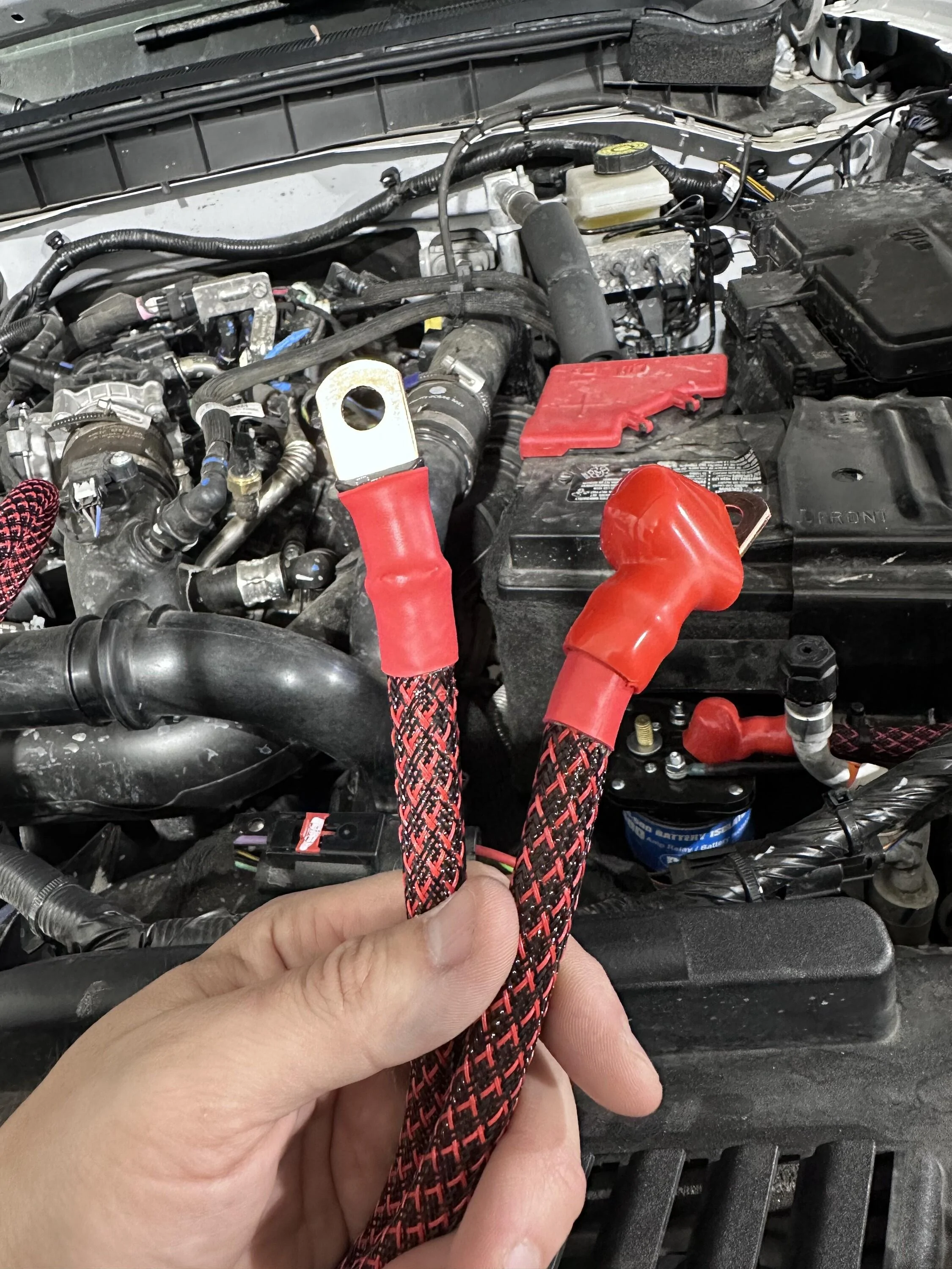

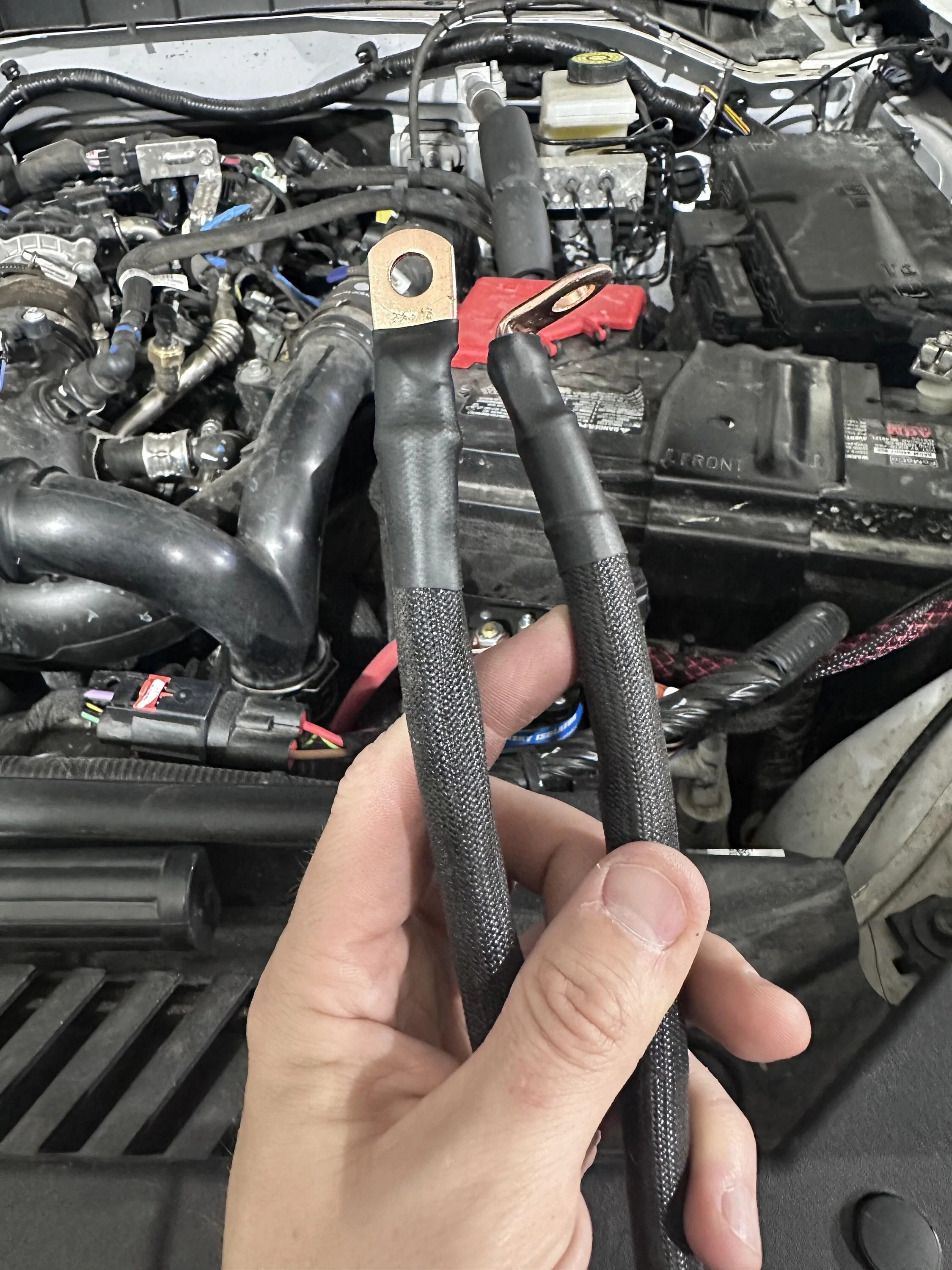

I'm a stickler for clean wires. It's nice to be able to make them myself at the required lengths. Went with 2 AWG welding wire (Smittybilt uses what would be close to 3AWG) :
