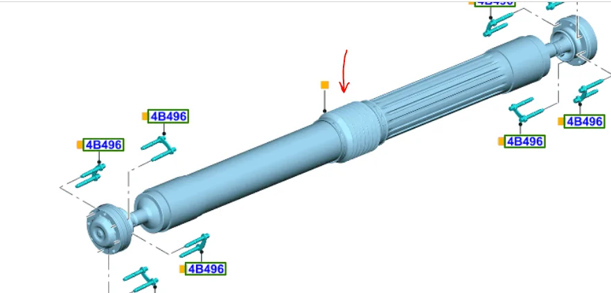

Don't have pics from way back but at one point they were coating the splines with some kind of coating to help with the sticking but didn't take care of the problem so it was, and still is to some degree, to pull the shaft, pull apart and smear a bunch of PTFE (XG-8-A) on them and call it good.
The clamp isn't serviced by Ford but I'm sure it's easily obtained on Amazon once you figure out what size it is. I've never figured out if it's the spline size/number of splines, tolerances, or something else that's caused Ford issues for multiple decades and across several models.
