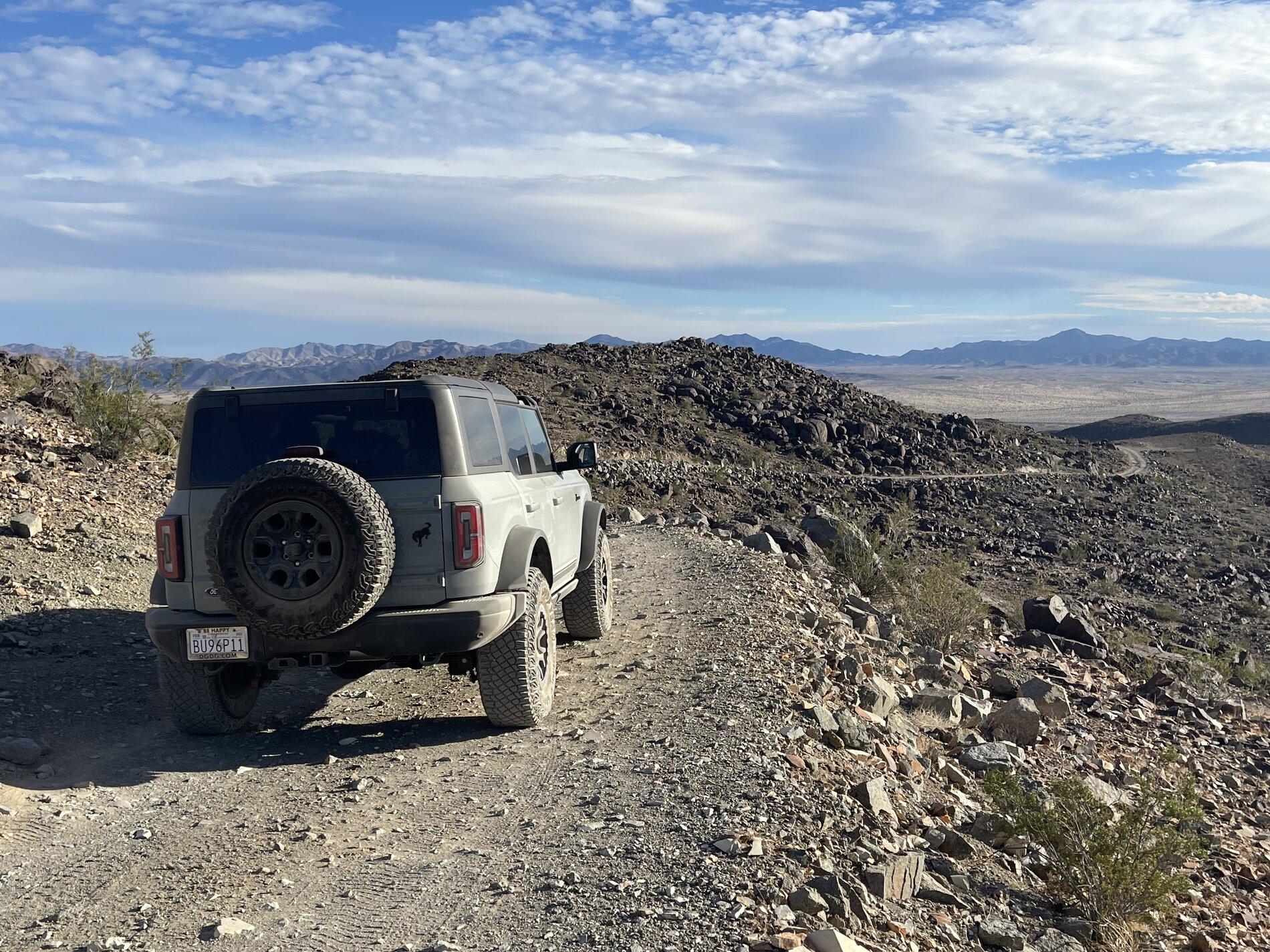

Hey all,
I took delivery of my FE last week and now I’m down in Joshua Tree giving it a proper break-in.
It was mostly flawless on the drive down from San Jose. Today I hit the trails and for some reason GOAT mode is only serving up Normal, Eco, and Slippery.
Previously all the modes were available, even as of last night when I put it in Baja to head up a long dirt road to the place where we’re staying. After discovering the issue today I tried to cycling through all the 4x4 modes a few times and turned off and on the ignition several times. I’m still only getting those 3 modes. No other issues or errors messages have popped up. I figure I’ll try it again in the morning and if the issue persists I’ll disconnect and reconnect the battery.
It’s a damn shame because the trails I was on today would have been a blast to try all the modes on - ranging from high speed packed surfaces, to deep sand, to slow and rocky. It still handled it all great without most of the goat modes.
Let me know if you have any ideas about what the issue might be or how to resolve it.
Also, this thing rocks!

Great pictures!
