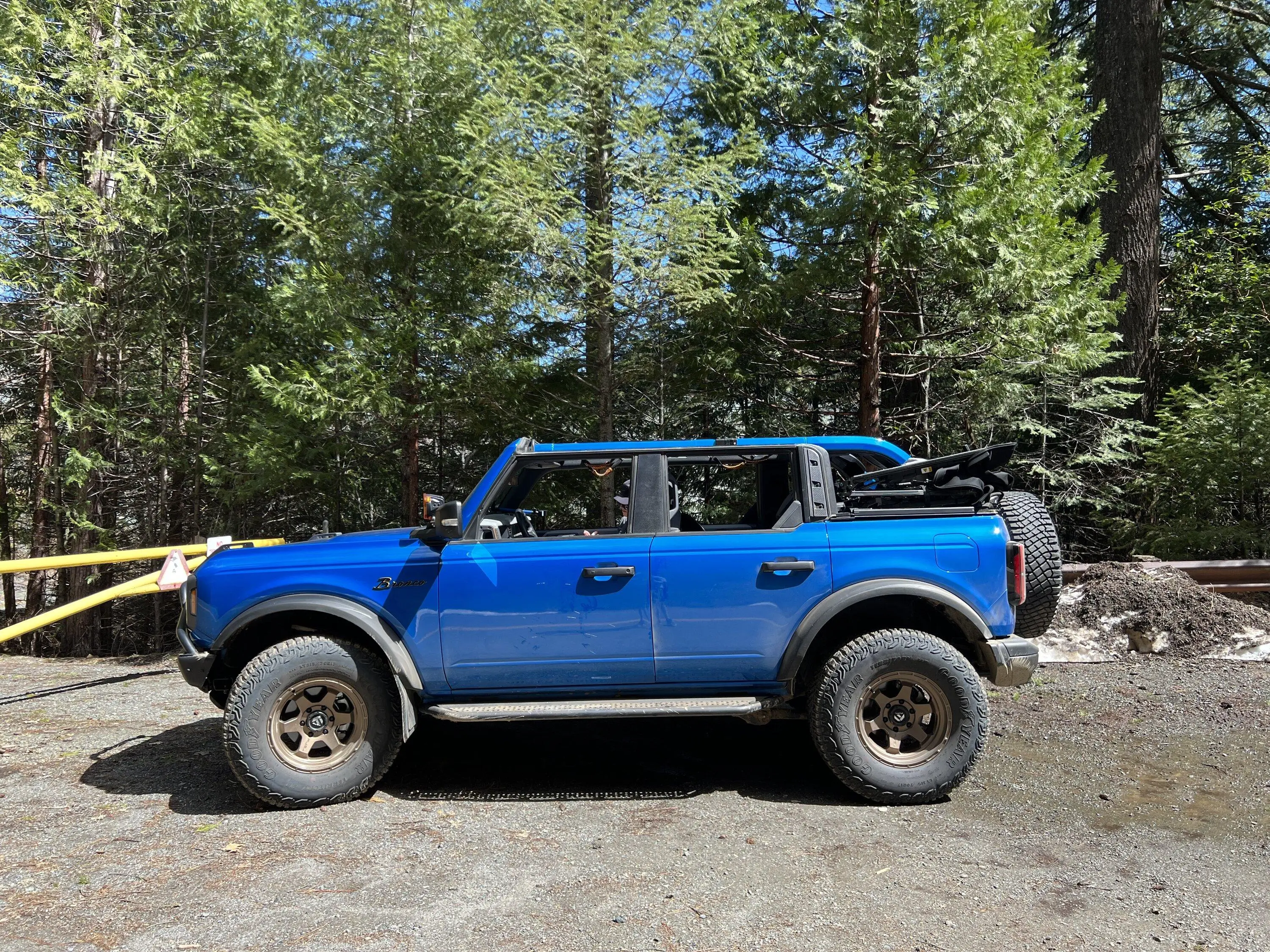

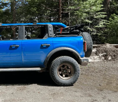

I have FINALLY been able to put the soft top back (it was 75 degrees today), but I notice that going over bumps and stuff on the trail, that the top bounced around when in the 'back' position.. I know it comes with the velcro straps, but I haven't figured out EXACTLY where to put them to help secure the top and prevent it from bouncing up and down as I'm going over bumps and stuff. any tips?

in looking at some videos, it looks like it's supposed to 'lock' into place when you fold it all the way back... mine doesn't.
You're right, it’s supposed to. Mine takes some finessing on both sides to finally latch into place. Frustrating for sure but better than all the slant back options from @Bestop_Team. I’d love to see them offer something that comes all the way down without this hassle!

Only the bottom portion locks in when all the way back. You still need to use the velcro straps to keep the front most section secured to the rest of the top.
yeah, the bottom part won't latch in on either side... I wonder if it's because I've got the @IAG Performance soft top lift struts in there?

Has anyone used anything besides the straps Ford provides? I purchased my Bronco in December and live in Alberta so I've only had 2 days nice enough to try out the top in the half back position since getting it. I watched the video above, but it's almost like the straps provided are too long to secure it the way he does in the video. To get the Velcro to catch I can still get 4 fingers in the strap. If I move it up further I can't get it tight enough to keep it from sliding down
I figured it was just there as a safety and just went with it, but even just city driving I found the top was bouncing around a lot. I used a bungee cord the second time but doing that there wasn't enough space to get the bungee through the arms on the top so I ended up just wrapping it around the outside. I think if I were to continue to do that though I'll eventually damage the seal which I don't want to do either

that only shows where to put the straps when it's in the first position folded back... I'm talking about when it's all the way back... I haven't found a way to keep the top from flopping around back there .. and the straps are too short to go around the entire assembly

It shows the lower section locking in place. I place the strap though a hole in the upper frame in the lower section. I haven't had it move it, next time I put it down I will take a picture. Next day or two it should be nice here in TN.

yeah, I think that's the problem, my lower section doesn't lock in place no matter how much I try to slam it in place or put my entire 200 lb body weight on it

You'll probably need to take a trip to the dealer to have it adjusted. I'm able to get both sides latch to the bottom part of the frame.
That forward section has a spot that the straps get fed through, make sure not to pinch the weather stripping on the top.
I installed IAG struts last year, same thing. Just takes readjusting some of the brackets for where the top latches.
