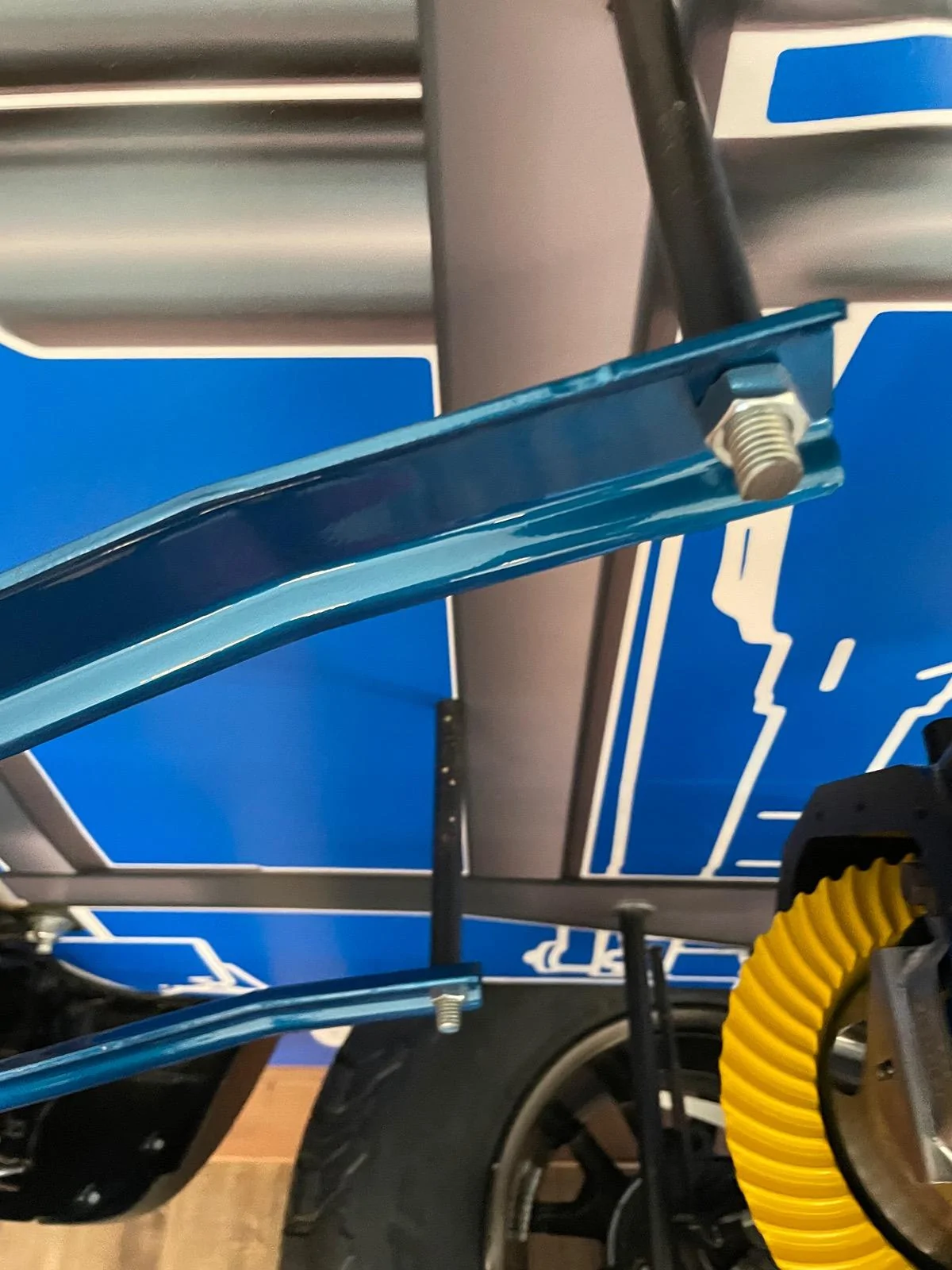

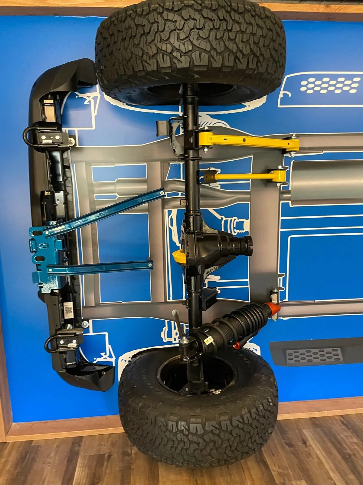

Hi,
the Engine/trans/brakes can easily handle it. The problem is mainly the rear crossmember that the hitch is attached to. Keep in mind that 3500 was standard tow rating with two 150 lb passengers, the FE weighs more with skid plates/sway bar disconnect,etc (like the badlands) so the actual capacity is around 3200 And remember tongue weight is only 350 lbs. Ford increased capacity on the Raptor by adding two braces in the rear from the hitch/rear crossmember to another frame area. These go where the muffler is located on standard Bronco. Plz see attached pic
