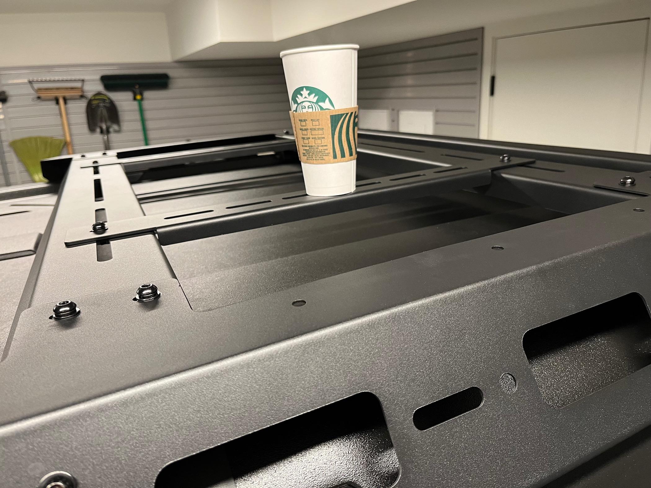

Just for additional clarity, the below picture shows the rear cross member incorrectly installed the first time. The nut insert should be closer to the rear of the vehicle, thus I needed to unbolt and flip it around.
Knowing this would have saved me quite a bit of time, as I had already started to bolt up the side pieces.
