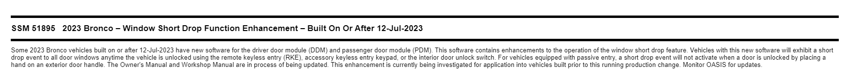

Software had to be updated manually by the Ford Store to add the feature. If your Bronco was built on or after July 12, 2023, you already have the roll-down feature.

To schedule this, is there a specific TSB or Customer Satisfaction Program that you told thee dealer about to get it fixed?
There is no information about this feature other than the older SSM that @Cactus Jack posted, so most dealerships won't even know that the programming is available.
You can ask them to check for a DDM and PDM update and some dealers will help out and reprogram it for you. But technically isn't a warrantable concern, so don't be surprised if they say there will be a charge.

I would just ask them to check for a potential DDM and PDM module update.
You can reference SSM 51895 also if you want and tell them you heard that the programming may be available for previous model year vehicles already.
I don't believe the programming is available for all model/packages yet though, as my 2022 2 door does not have this feature and also does not have any updates currently (which is probably why Ford hasn't updated the old SSM or released anything new yet)

There is currently no TSB that I am aware of. I do know the Ford store spent a considerable amount of time to figure out how to add The feature. I believe they use Ford’s OASIS database. They also replaced the wiper components per Ford’s recall.
