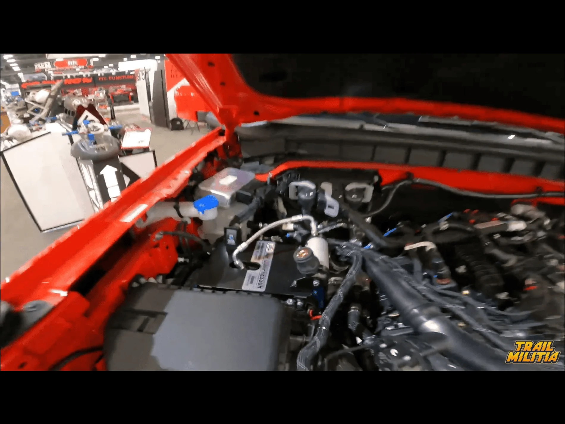

This was at sema I think this was 2.7 but abr doesn't wont to say anything...
6:34 if the link doesnt work.
That's not the dual compressor. Dunno what that is, but it's super clean.
That's where they showed the double compressor in the prototype vehicle they did 6 or so months ago, but that was clearly for looks. I'm curious if that's a functioning unit.
Yeah somethings not quite adding up with that. That plate isn't supporting the compressor. It's just holding some accessories. The compressor is right side up so the mounting points would be under it, and as you know, there's nothing under there but a piece of felt on to of the springs.
They also removed the computer module thing on the side by the washer fluid. You can still see the ground able attached going out to the module burried/tucked away.
It looks like they did this just for SEMA and it's not actually installed 100%.
I could maybe see a single under there, no way it's a dual. I also have no clue what that box they removed is, but it has a huge connector on it. Seems important.
