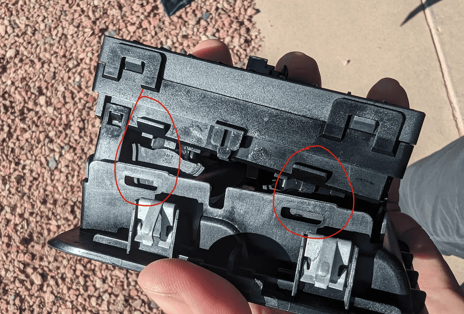

Pry up on the side of the housing to release the clips (they're in line with the switches themselves vs on all four sides):

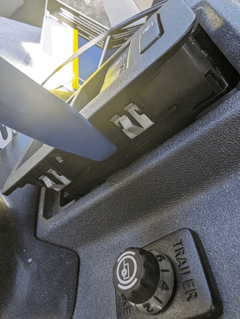

Pull the harness off the back of the assembly, and then pry up on these four clips on each side of the housing, gently. handy dandy pocket knife was perfect for this:
Ford Bronco Armrest Window Switch Replacement 1685749093179
Then just snap the new one back in place, plug the harness back in and press it back into the armrest and off you go.

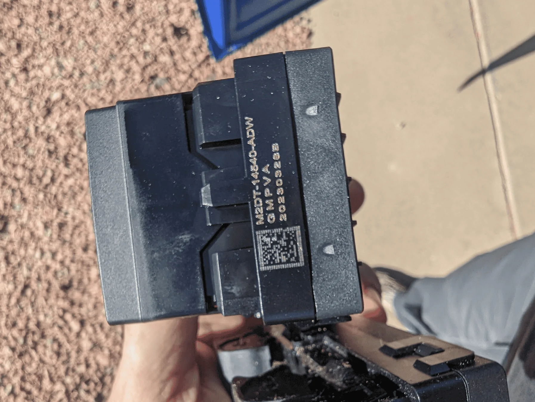

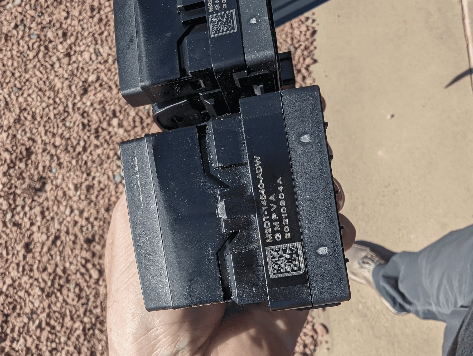

For those curious, here's the part numbers for each to be able to order from your local parts counter if need be:
old:
Ford Bronco Armrest Window Switch Replacement 1685749222726
new:
Ford Bronco Armrest Window Switch Replacement 1685749251826

Thanks for sharing! Rubber on mine are also starting to peel, so will be doing this as well. Can I confirm the part number is M2DT-14540-ADW?
pretty sure that's what's on it, yes. Check with a parts dept tho, my camera kinda went full potato for that picture
That’s an engineering number.
The service part number for a 4 door switch is M2DZ-14529-AB and 2 door is M2DZ-14529-BB
