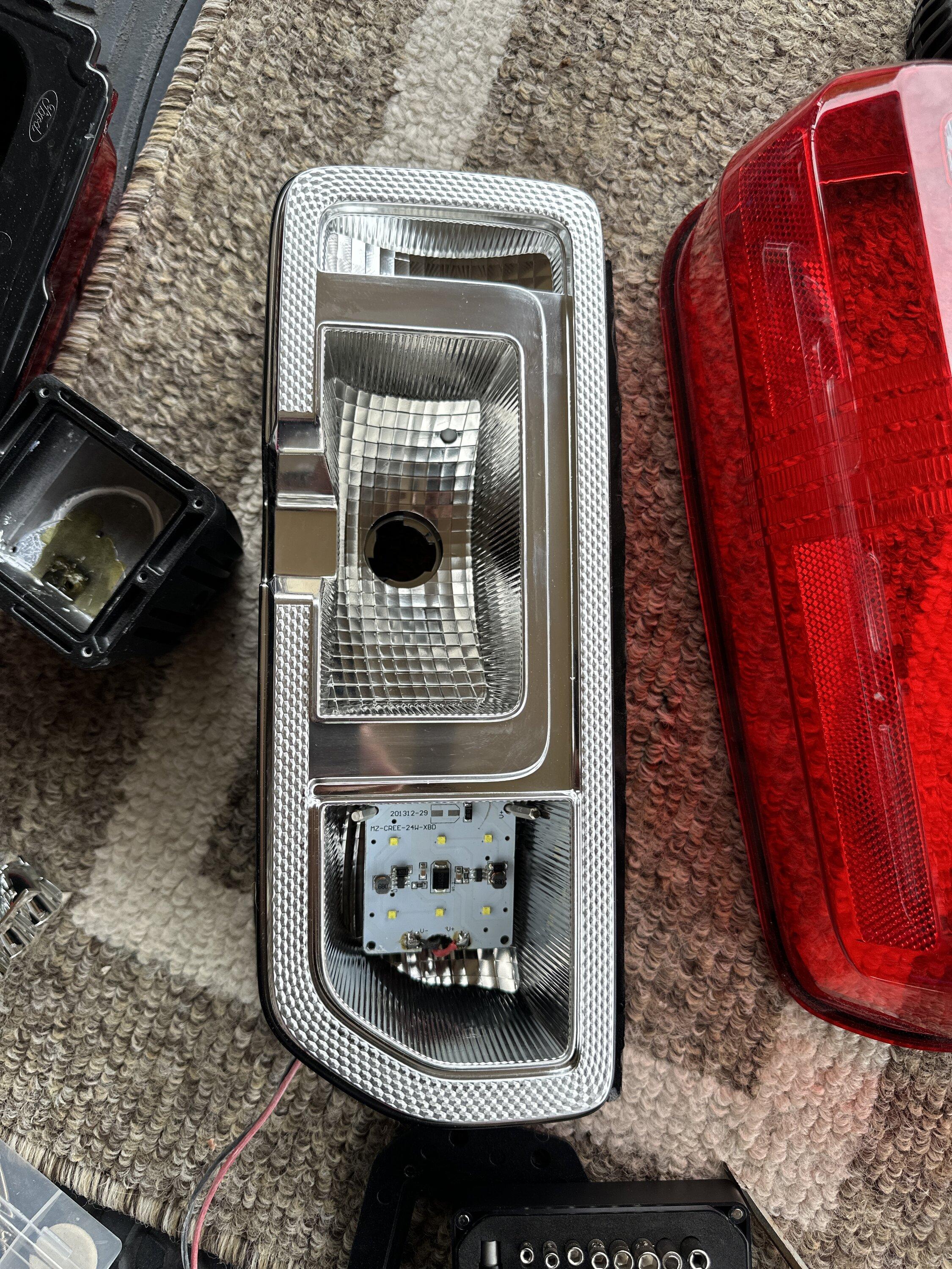

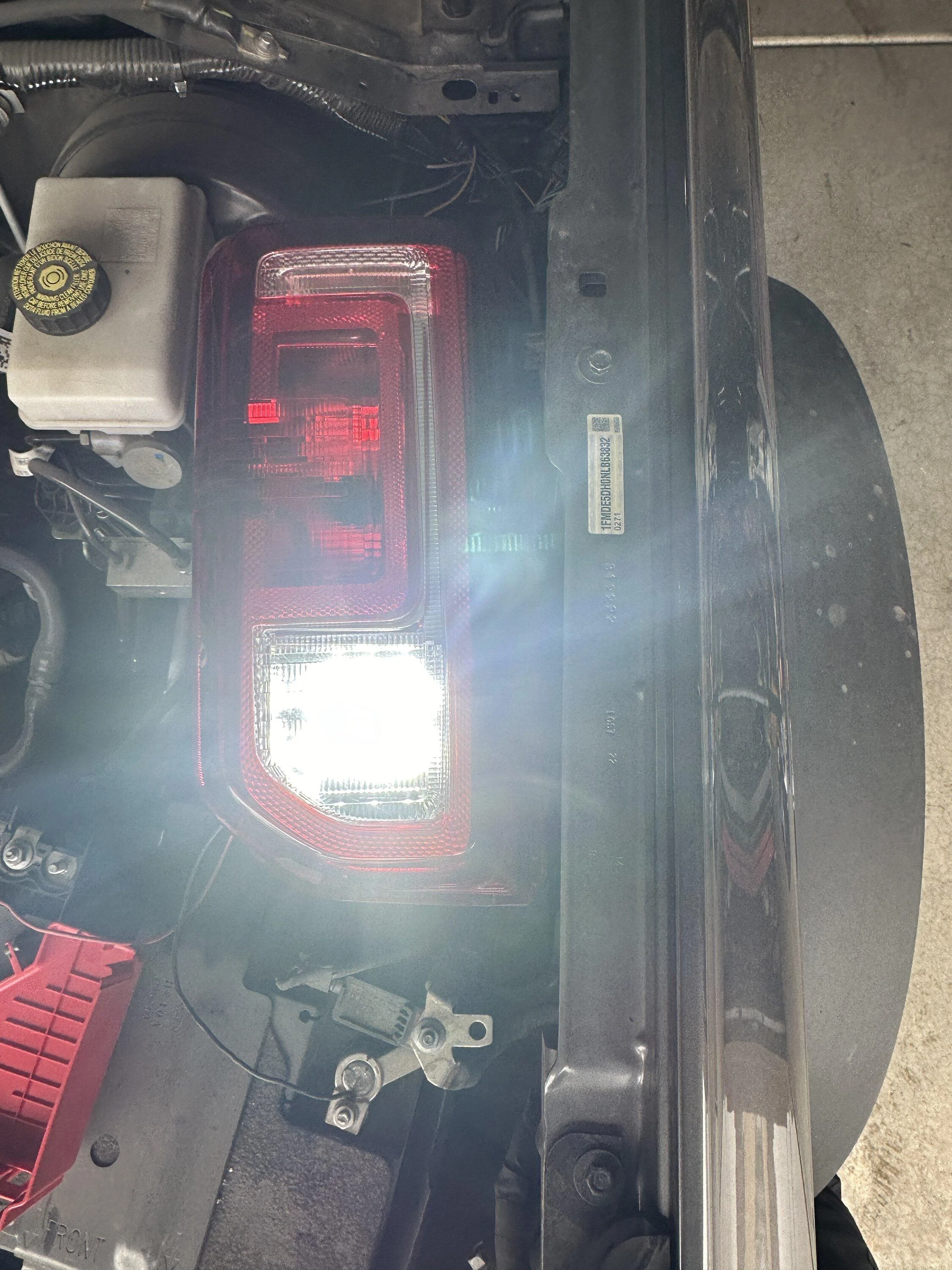

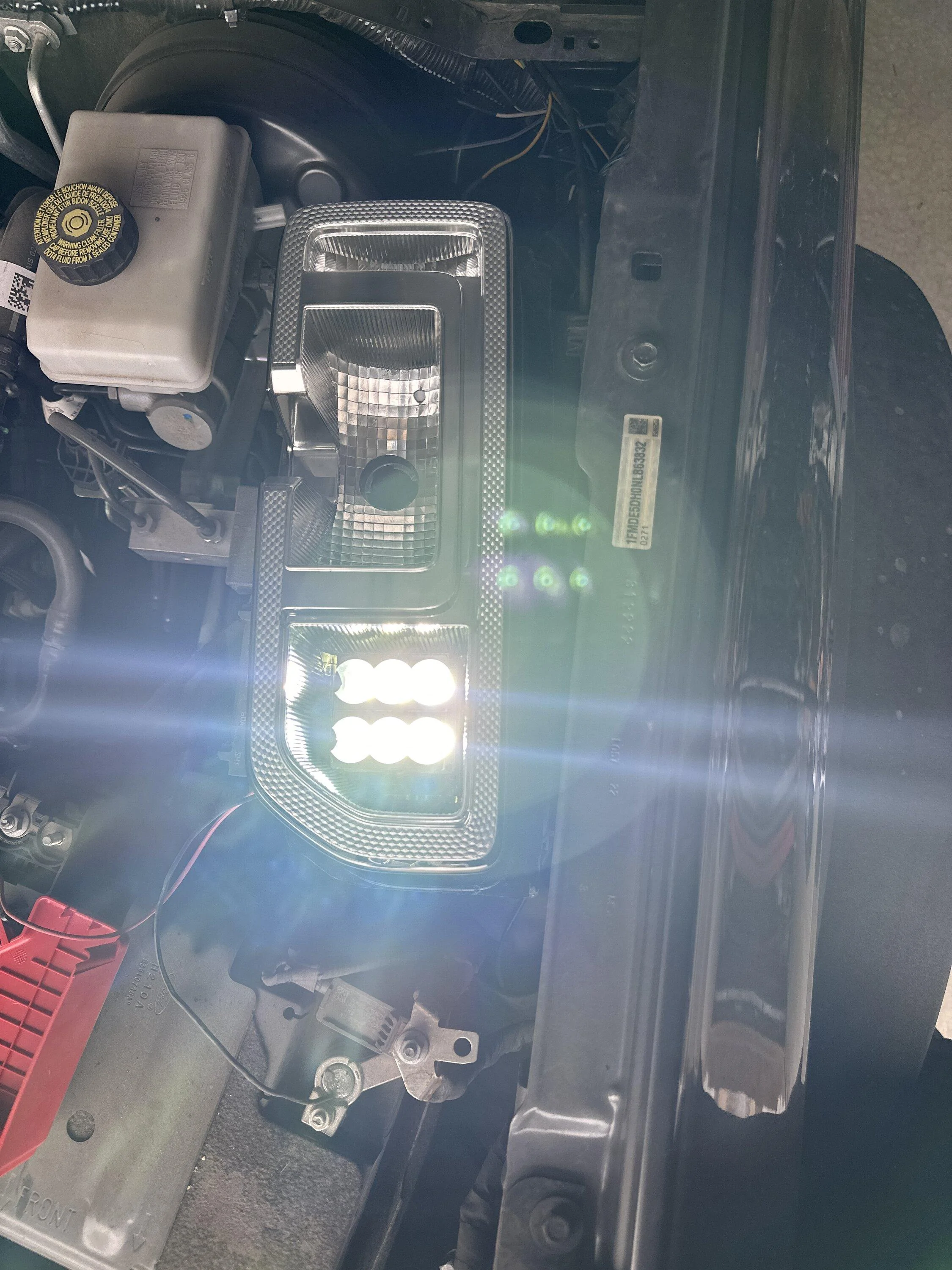

I’m currently in the process of redesigning the light output and design of the base taillights. Still thinking through how to eliminate the red tinted clear cover and then switch to red led’s for the brake and potentially use a 2 to 3 wire adapter to have a dedicated turn signal instead of the combo turn/brake light. Really wish I knew someone in the lighting industry (@ORACLE Lighting , @Quake LED , any other LED Manufacturer that isn’t coming to mind rgiht now) that would go in depth on the ins and outs of wiring and the way tail lights (and head lights too function?
pics are of the led pod light (broken down to just the PCB and wires coming out the back) in the housing where the reverse bulb was, it turned on with the reflector that comes with the pod light that sit on the PCB, and finally as it would be assembled with the cover back on. (Thinking about putting a diffused cover over it to knock down the brightness but it’ll still be more white than yellow)

Hey!
Looks like quite the project!
There is a lot to unpack in terms of the way that the factory taillight communicates with the computer, and it changes depending on if your Bronco is equipped with the halogen style bulbs, or the signature LED taillights. The programing can be changed with forscan as well, so there are ways to make your bronco think you have the signature taillights that do have the designated turn signal circuit for the amber blinker.
If you have any specific requests I might be able to help you out so feel free to shoot us a DM, but in your case scenario one easy way to hack the system would be to tap the front blinker light in the headlight and run the wires to the rear on each side for the turn signal. You could then tap the third brake light over the spare to get the designated brake circuit (i.e. wouldn't flash with the blinker like the current circuitry currently designed to do).
