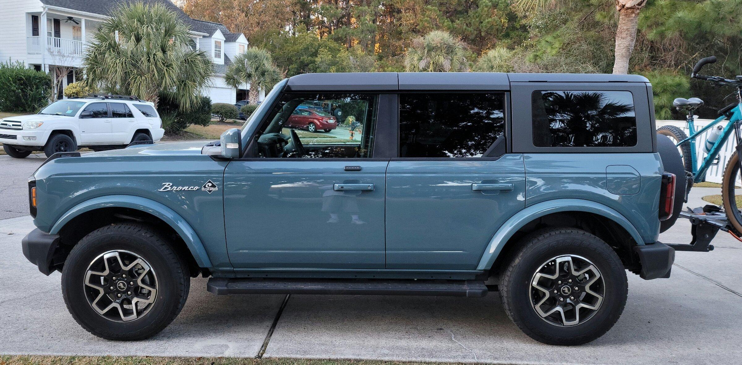

I looked more closely for the "rake" in my Bronco, and I can't find any. The front and rear wheels are the same distance from the fenders. This is not my F150, where the rear was perpetually, obviously higher than the front. It only got level when towing or carrying a heavy load.

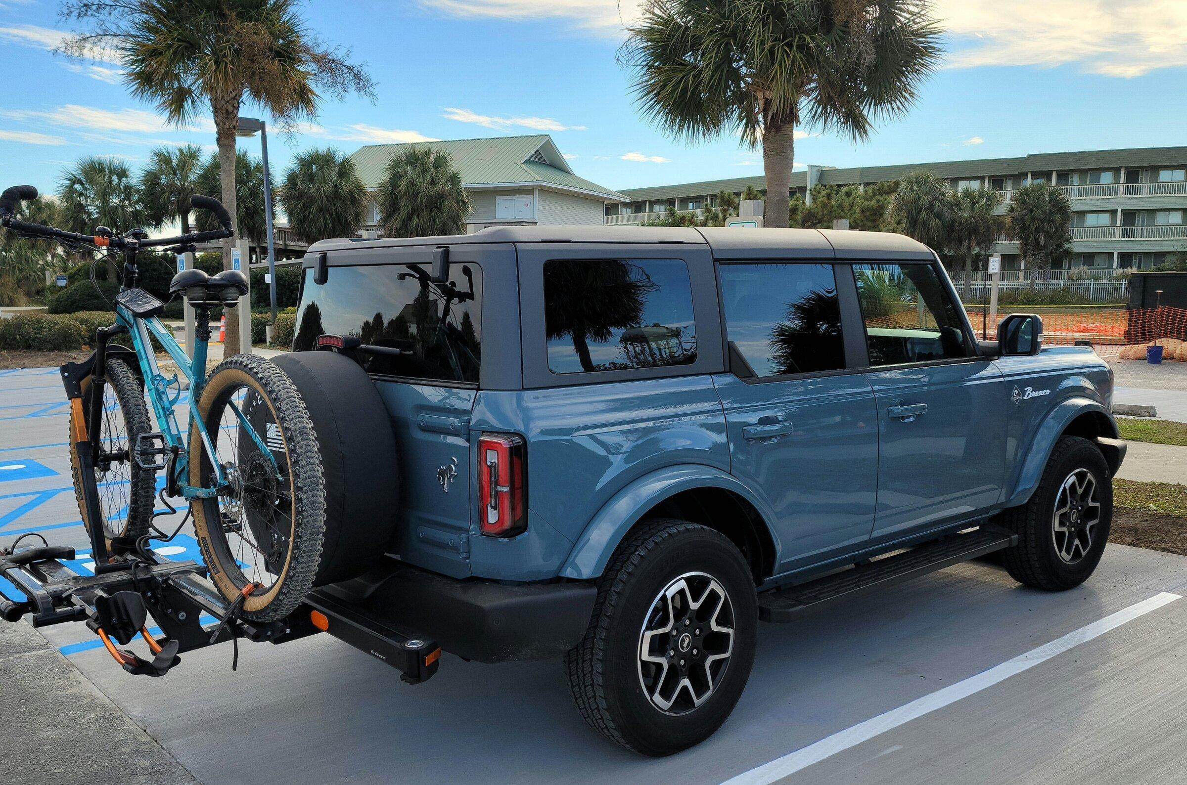

I measured. They're within an 1/8 inch of each other. Granted, i have A heavy Kuat bike rack with a heavy Pivot, a swing-out accessory, and a bike. So with all that gone, I suppose the rear would be a little higher. But, it seems the dealer is correct, that a 4 corner lift would be best. Your thoughts?

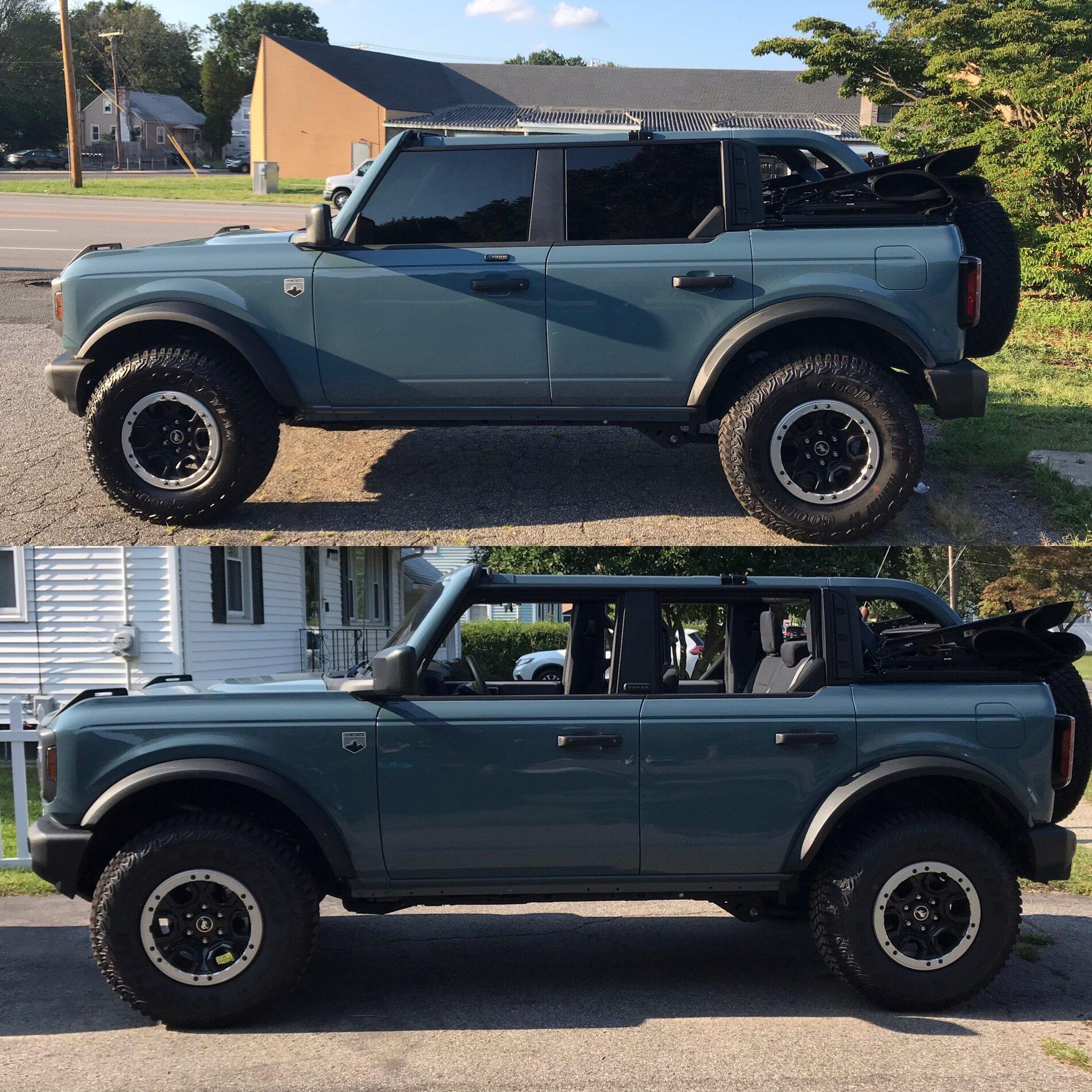

The non Sasquatch suspension might be different but on the Sasquatch set up there definitely is some rake. I plan on doing a 1in level soon to mine. Here is a comparison picture I found on the forum.

Rake definitely has a purpose. To help keep the vehicle level when approaching max trailering or load weight. If you do not plan on towing or loading it down with overlanding gear then there is no real purpose or design function for the rake. So it all depends on your particular use of the Bronco.
Ford Bronco Broncos "Rake", level vs lift BCFE3F86-A60C-488E-AE83-124C11AEE56C
Yes, it does seem from the photo that the SAS has more rake, thanks. Nice color choice! Its like a living color, changes shade with the lighting, day and night!
