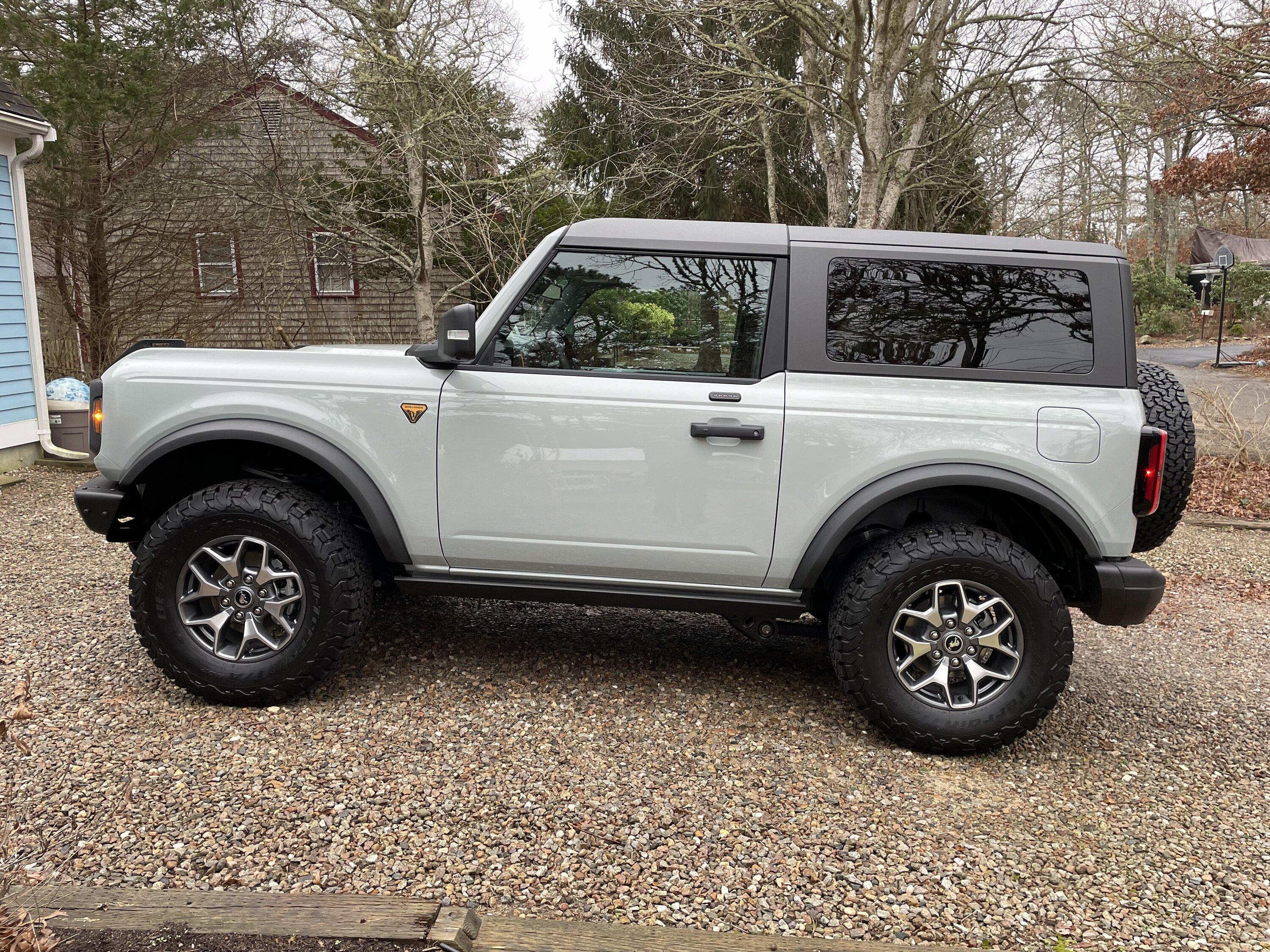

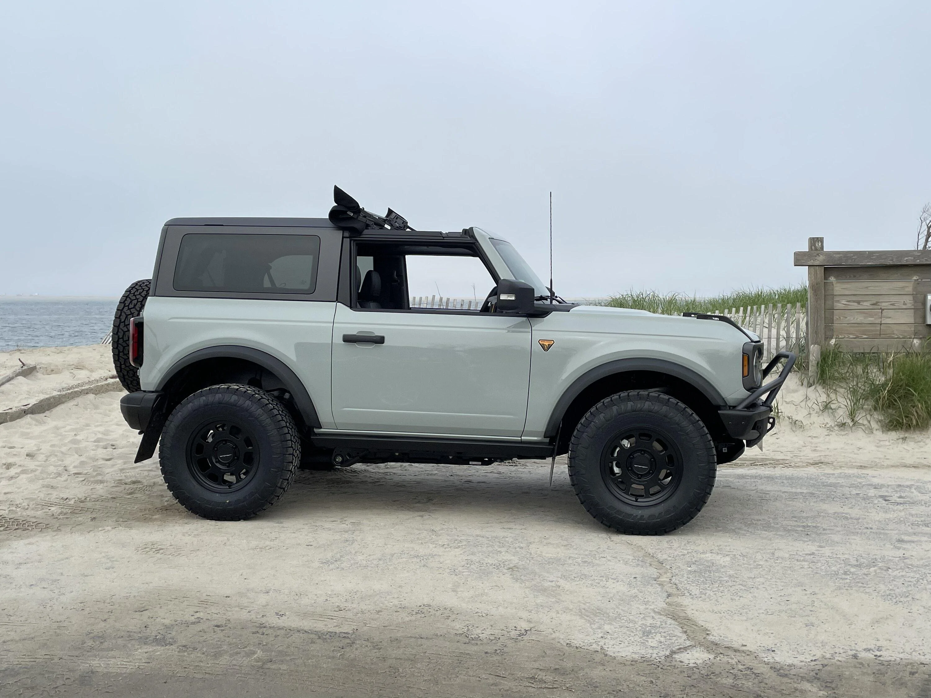

The 285/75R17 you list in the title are closer to 34”, they measure at 33.9” tall. My 2 door Badlands is 1.5” lower in the front than the rear, I’ll be installing a 1” or 1.25” leveling kit for aesthetic reasons.
I think 2” is overkill since the 285/75R17 will fit the Black Diamond without a lift, but the Black Diamond sits .4” lower than my Badlands. Here is mine stock with 285/70R17 and mine with 285/75R17. No leveling kit in these pics.
Ford Bronco To Lift/Level or just Level? 82A4962C-A5DD-4167-AA19-CEBB7906F80A
Ford Bronco To Lift/Level or just Level? 098BE326-6E8D-4E44-ADA3-7C09E5976CAF

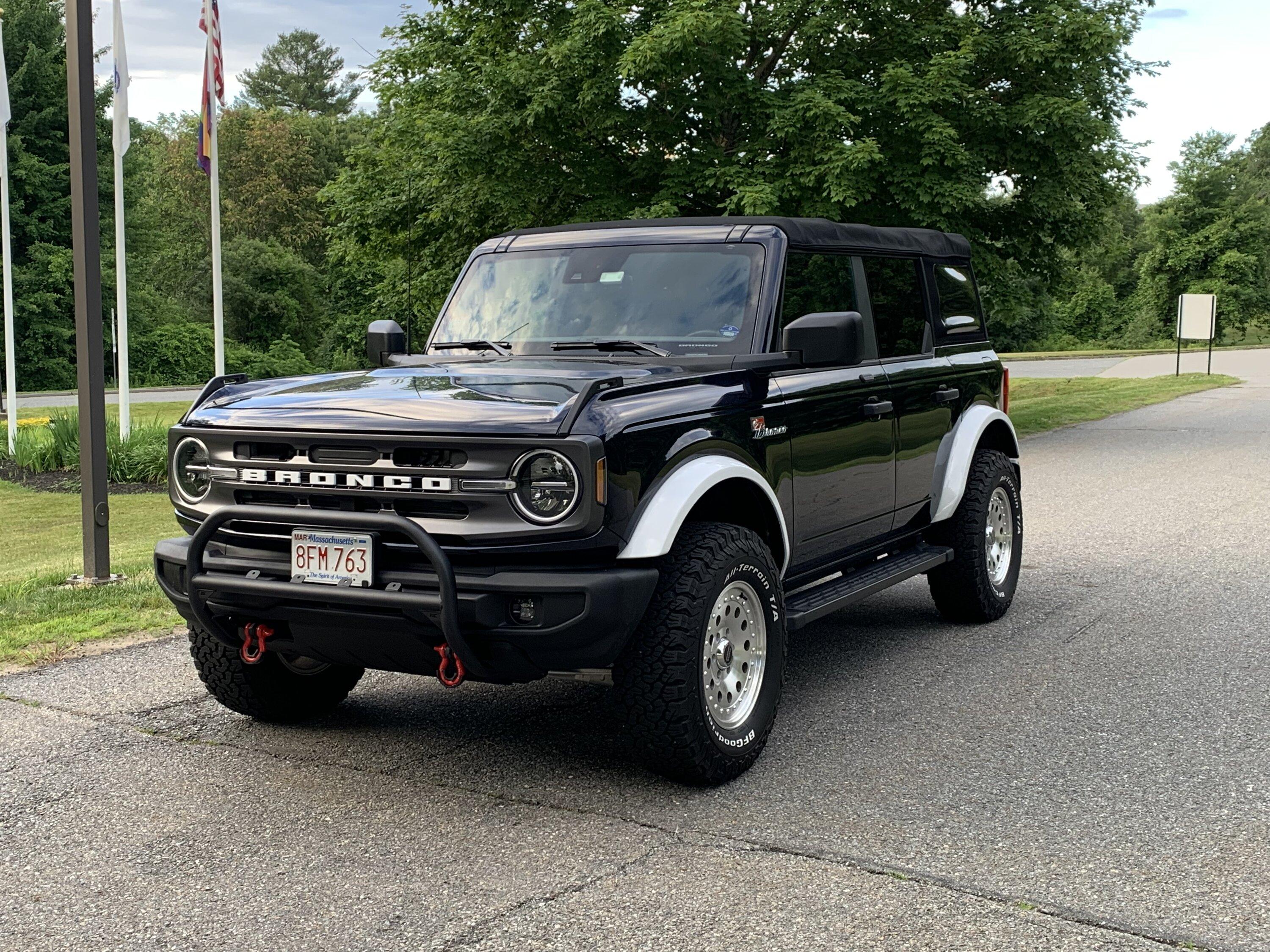

If you’re going with 33’s just do the 1” leveling kit. Works great. I have 285/70/17’s with the RC 1” kit and it looks great. No issues or rubbing.
Ford Bronco To Lift/Level or just Level? 1657292545847

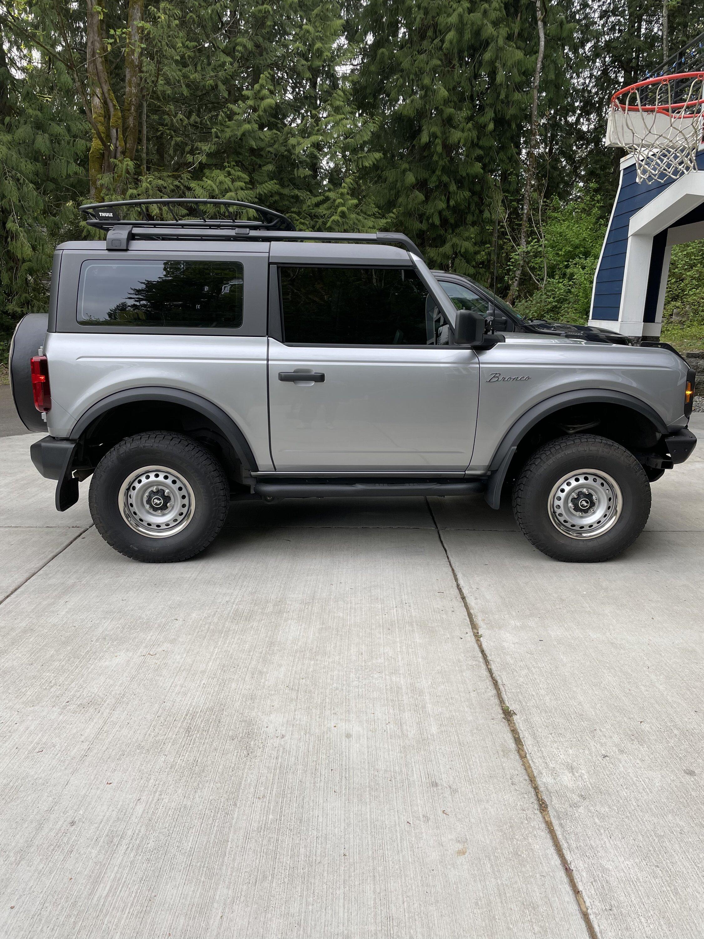

Here is my 2” lift with 32” tires for reference. I don’t think it will make your tires look too small.
Ford Bronco To Lift/Level or just Level? 79E1B191-84BF-4780-9C1F-EF7760F1EBDC

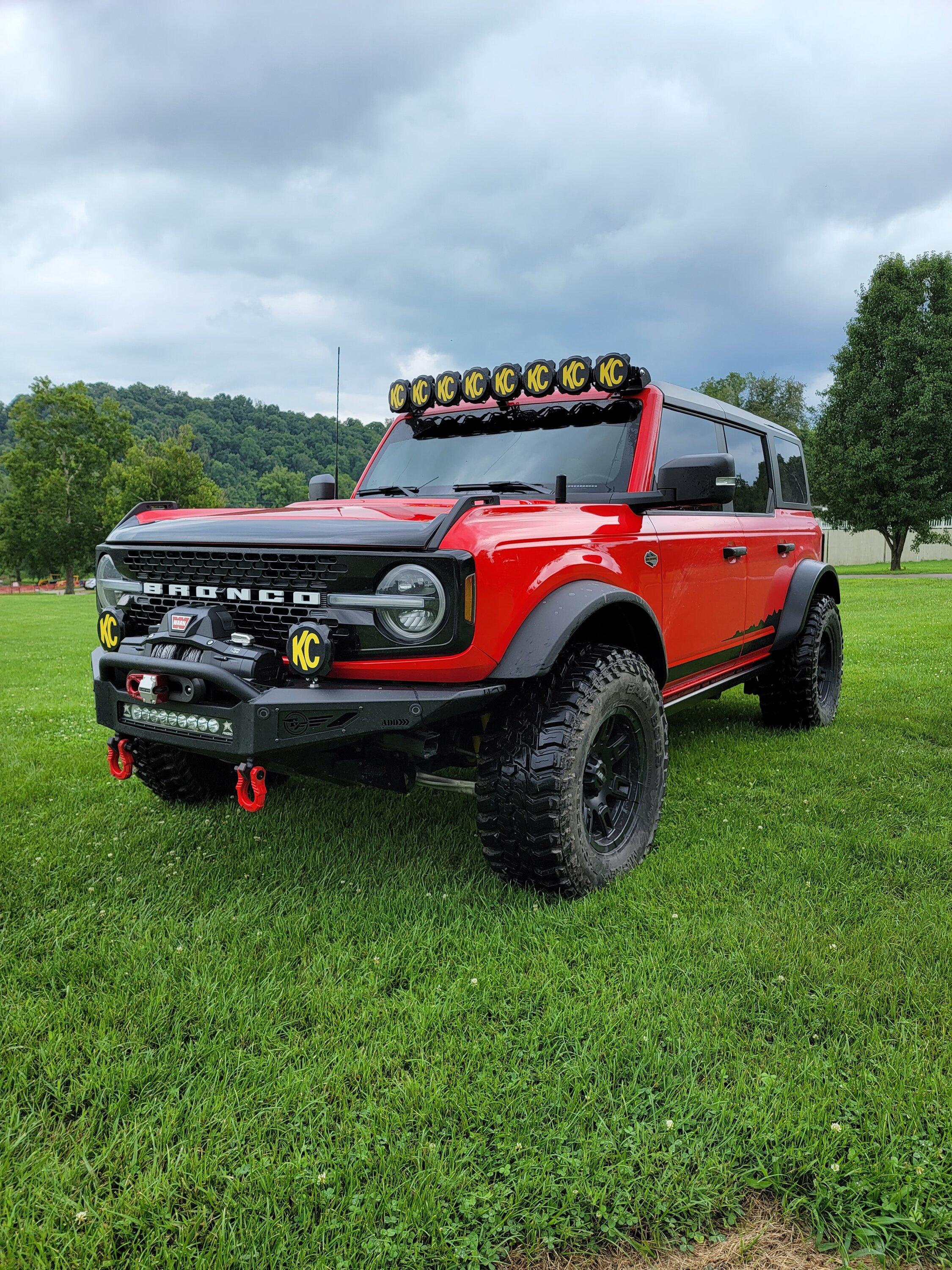

Just did the 1" Zone Offroad leveling kit today. Very happy with the stance. 35" Mickey Thompson Baja Boss MT's, on my Wildtrak.
