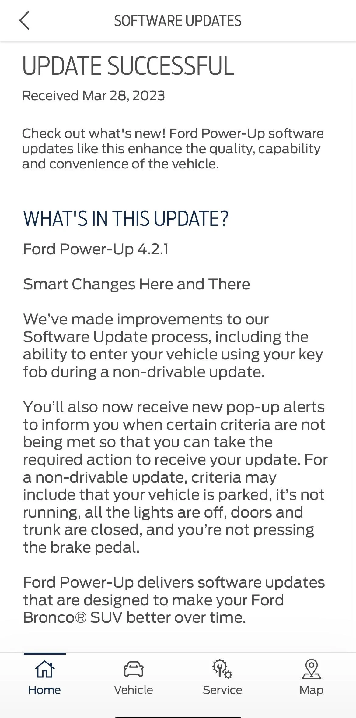

Here's an update y'all (March 28, 2023) I received the update (4.2.1), Modem is working again!
See screenshot:
