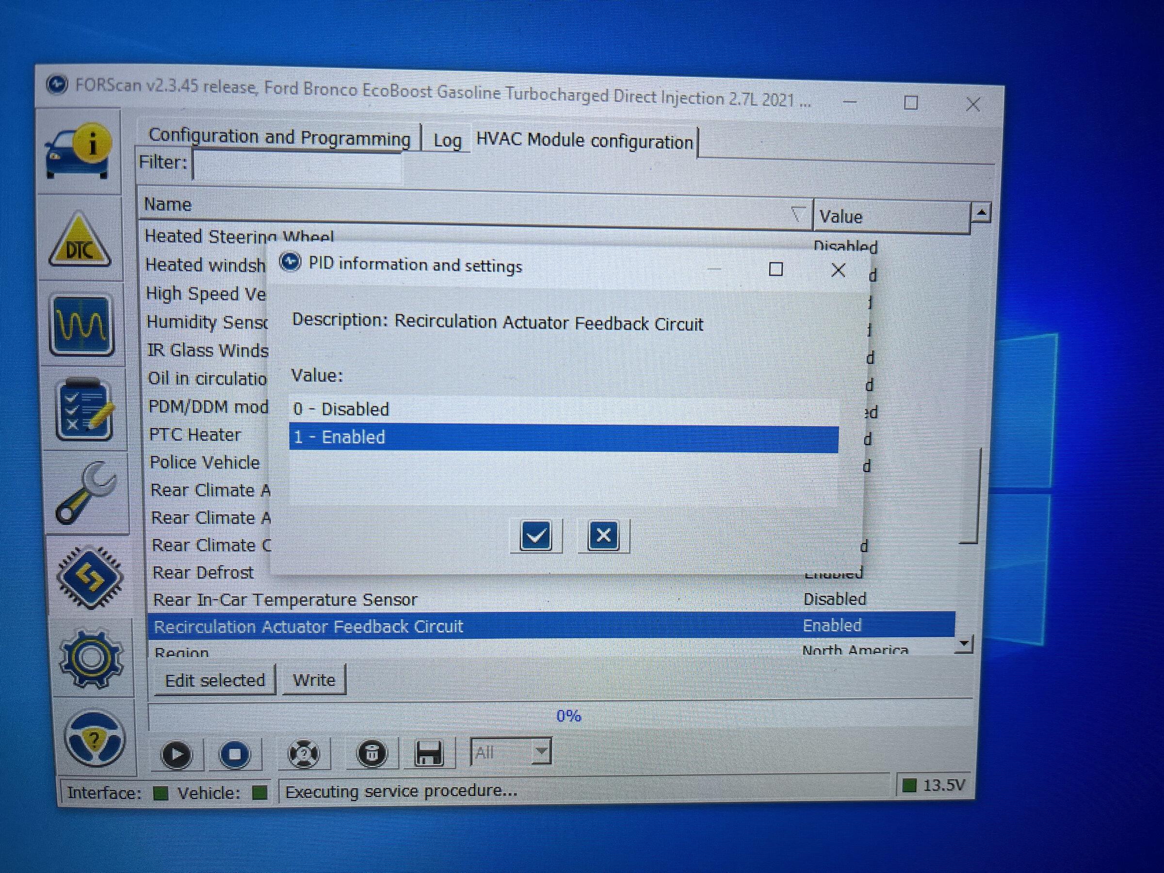

I was digging around FORScan last night and noticed this setting under the HVAC module. I did not mess with it, but maybe it might work. Any thoughts?

Let us know what happens! I added Sport Mode and turned off the key fob honking and saw that. Didn't want to push my luck after my success with those two settings.

Personally I want to know more about that "Heated windshield" option.
Is there a Bronco in Canada somewhere rocking heated front glass? Or Maybe it's referring to "heated windshield wipers"?
I would love for Ford to implement those 2 features one day
I believe this is a requirement in the UK... And maybe other countries.
My Evoque had this and I LOVED it.
Who's got a part number for the Euro windshield? Lol

Does it keep it on until you turn it off, as I hate having to manually turn it back on

Have you ran full diagnostics on your Forscan to make sure you don’t have a bad recirculation motor? Mine was bad and since getting it replaced I have not noticed the same issue as some are posting about it turning on and off. Describe a scenario when yours does, I would like to try and mimic.
Mine just turns off. Temperature below 61 F, any mode. Lasts for 1 minute.
